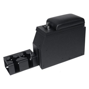

Continuing quest for interior completion and needing to address console, hoping for ability to store more than two pens, lighter, and roll of quarters, as well security for soon to be topless status.
Best I can tell, the only Tuffy that accommodates the floor mounted parking brake and fits is one for a samurai.
Exterior Dimensions:
21 3/4L (including drink holder), 5 1/4W, 13H, 3 1/2 Holes for drinks

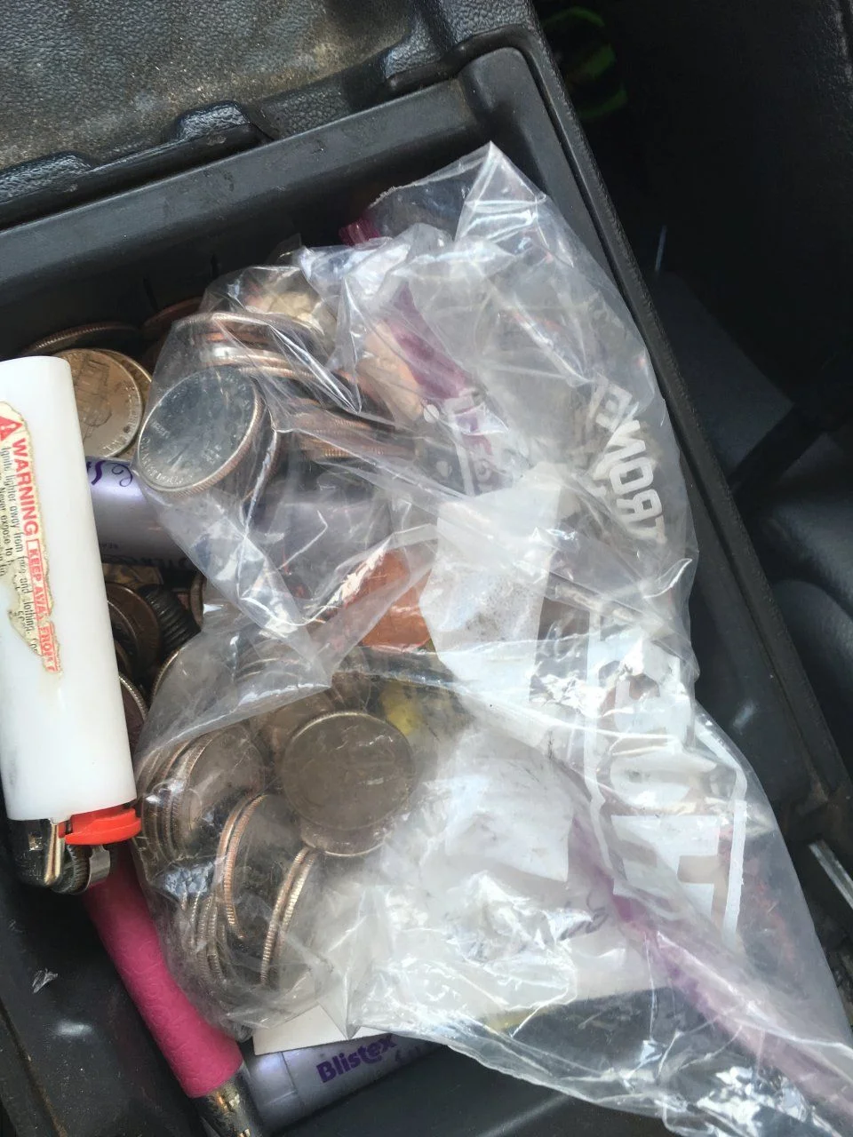

Can you post a photo of how you got the roll of quarters to fit? :)
I exaggerated, just a tad....

It's difficult to determine fit of a product when there's no detail plan given or without seeing a vehicle that one was meant for.
In this case, the Tuffy is 5 1/4" wide, with the cutout for ebrake within that 5 1/4" dimension (have it sketched at home, if anyone wants) so by placing the slot over the ebrake handle, it offsets the console significantly DS, is no taller (to top of metal lid) than the OE, and is pretty small for the effort.
The normal 6 1/2" Tuffy with area boxed out for ebrake would may ideal, if boxing would allow it to slide forward, otherwise fold and tumble seat would be rendered useless. Not many used offerings and no one wants to cut a new Tuffy...... so pondering removal of the used in 40 to cut, then putting new in it, or (as bad as ih8toadmit) since profession centers around steel, may whip one up that suits perfectly, instead of adapting.

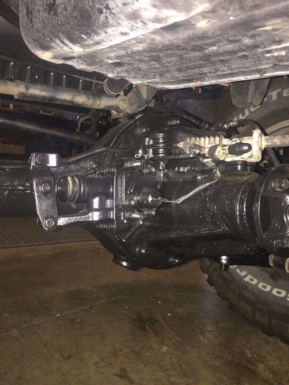

Latest round of refurbishment....

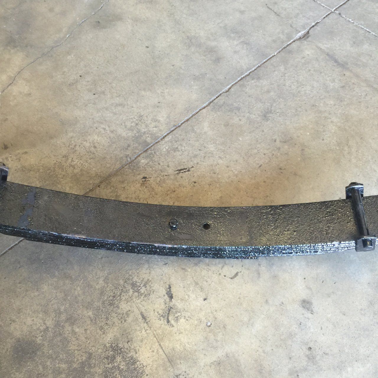

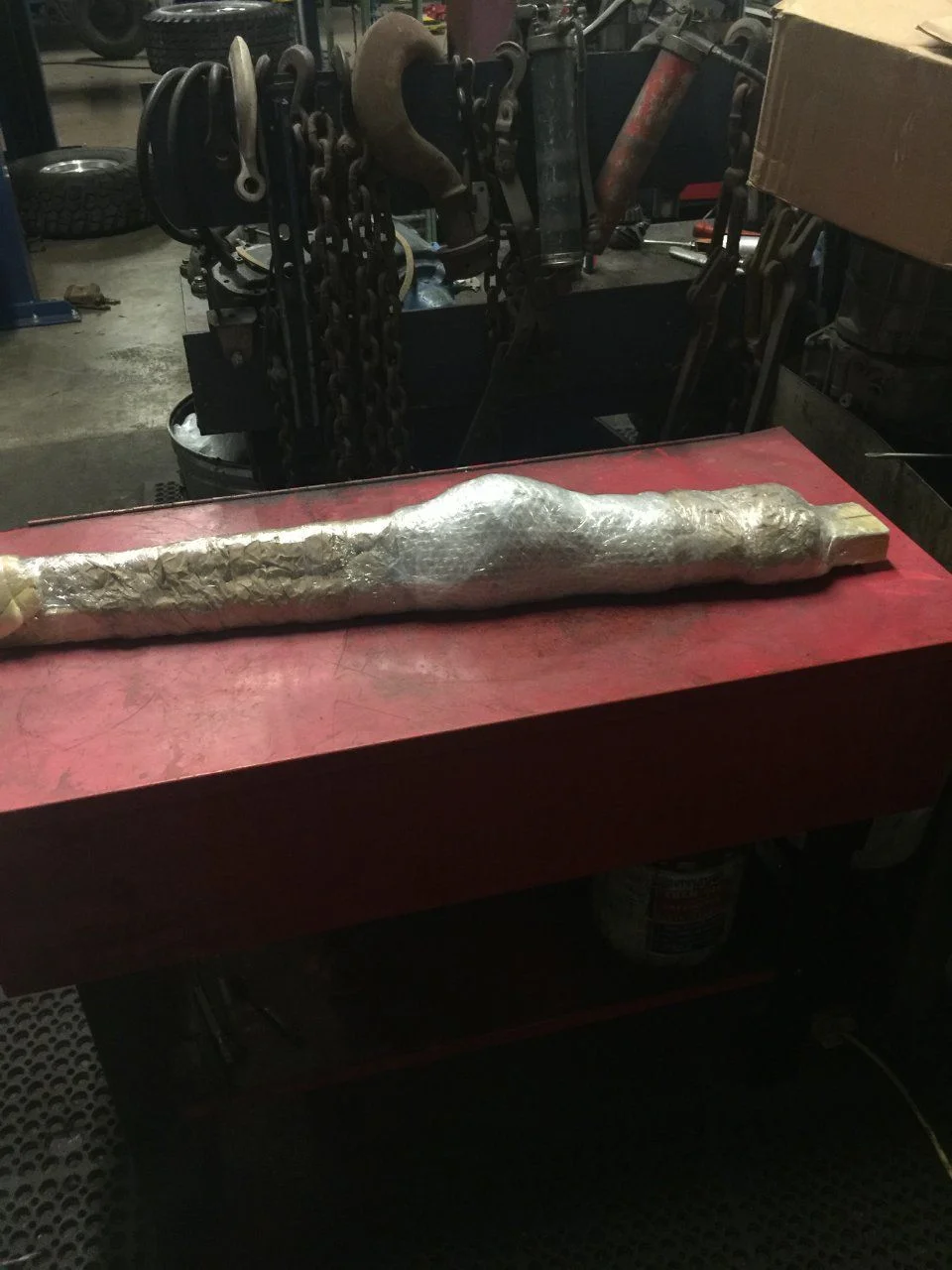

Since the springs are staying, flipped the wrap to the back, re-drilled in the forward location, re-arched springs and spring shop spackled on some kind of black goop that seems unfaded by straight blows from a hammer.

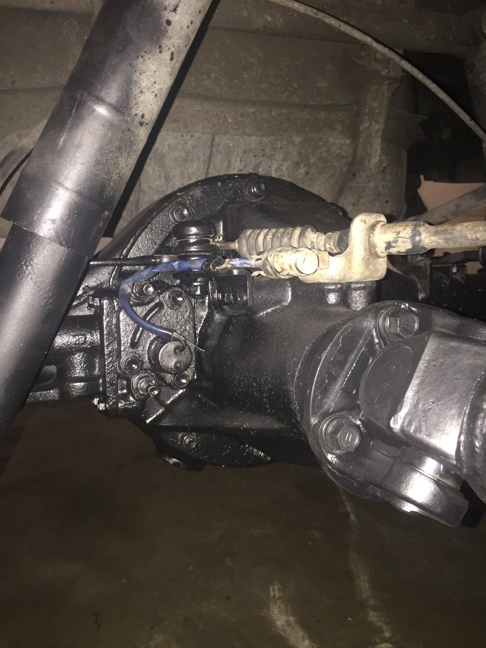

Since axles and steering will remain:
Picked up the longer differential studs from Cruiser Outfitters too.
Front driveshaft extended, front and rear rebuilt, balanced and repainted.
Locked thirds going in fine, but short the retainer....
As seen here in Alberto's HZJ70.

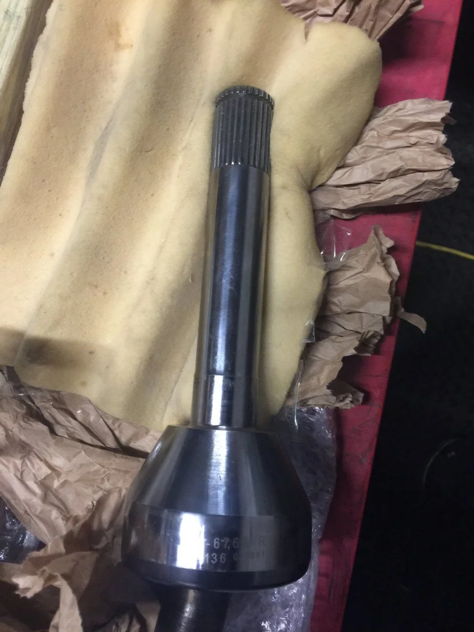

And just to add, for documenting purposes, the long splined front axle shaft is Longfield, and the corresponding CV is a Nitro Chrome-Molly combo. Both are 30/30, 30 splines on the differential and also 30 splines where the axle shaft meets the CV joint.

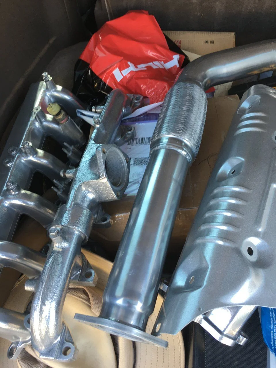

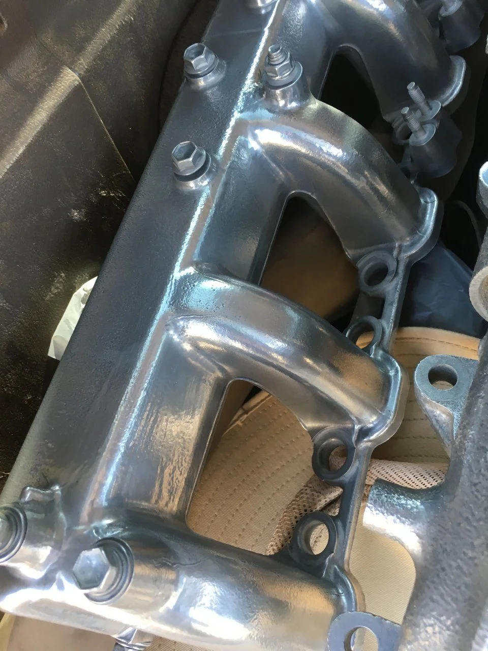

Removed intake, manifolds, few other bits from the 'project' HZ a few months back, to blast and coat, for installation with turbo, with directive expressed that they be the same color/luster as the valve cover, or duller.
Not only does it bring the bling that has no place in the bay, but a crappy job that looks like pitted chrome, to boot.
