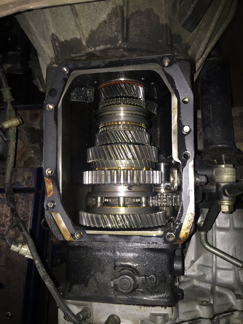

So, off with the top:
I'd originally complained of 3rd gear syncro notchiness. Followed FSM procedure for gauging, thinking sufficient, but if ever again faces with a rebuild, will replace the syncros.
It wasn't a big issue, honestly, and has since been erased, but gap was good and nothing has deteriorated further since rebuild.

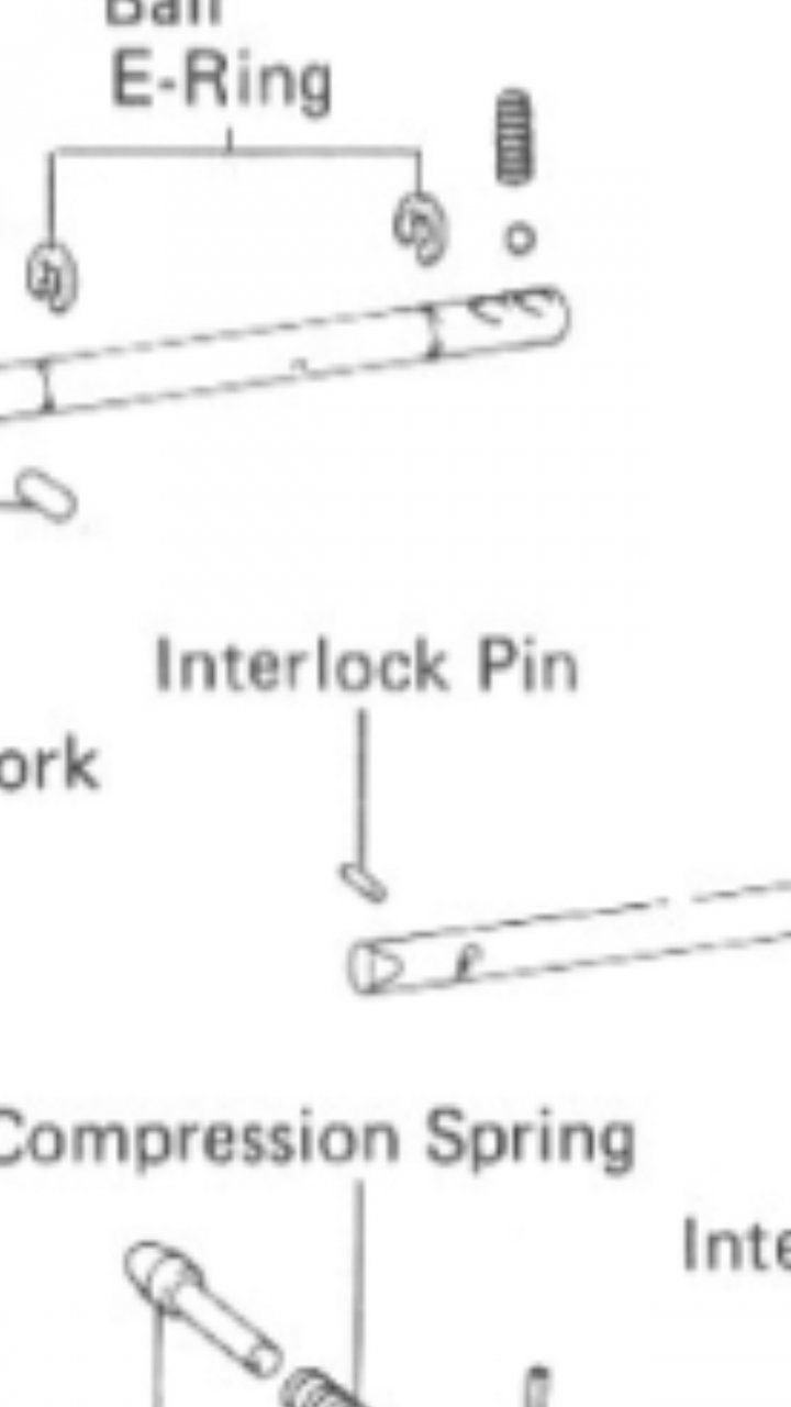

About this time, start hunting a schematic, (I sure as hell don't know what should or shouldn't be there) so hit the FSM on phone, to find:

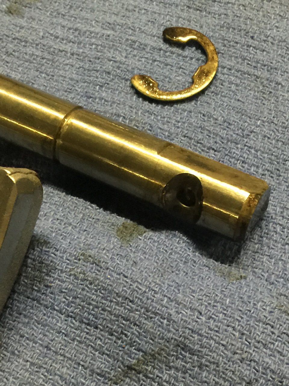

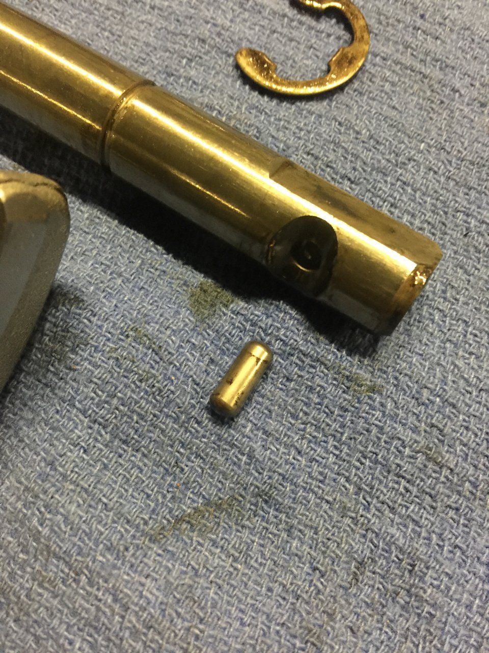

Further tear down reveals the culprit on the reverse rail:
as it's missing the pin.
After hunting through over twenty years of R and G parts bins, determine it to be unique to the H55F, which DIY solidifies.
What I can't figure out is any way possible that this is missing, unless someone's been in here, before.
Not a wear item, wouldn't disintegrate to nothing, and haven't noticed any issues with shifting until this singular event.

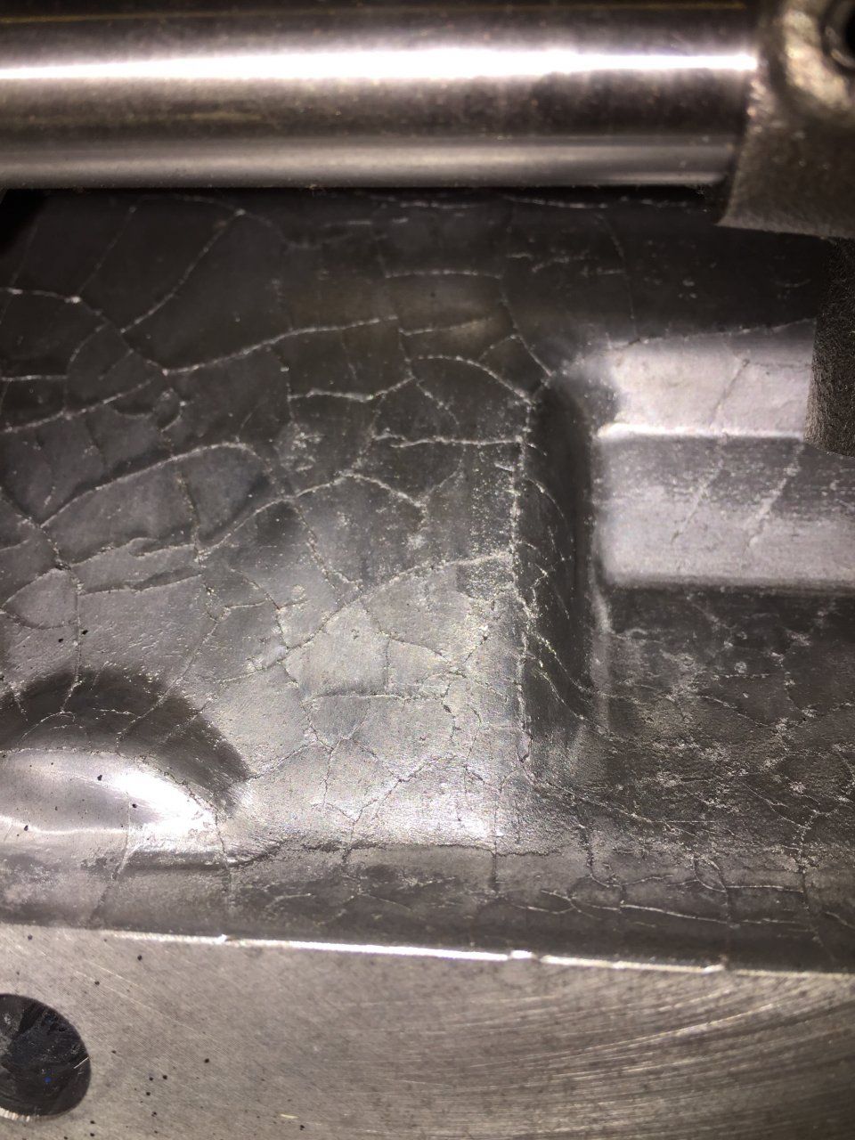

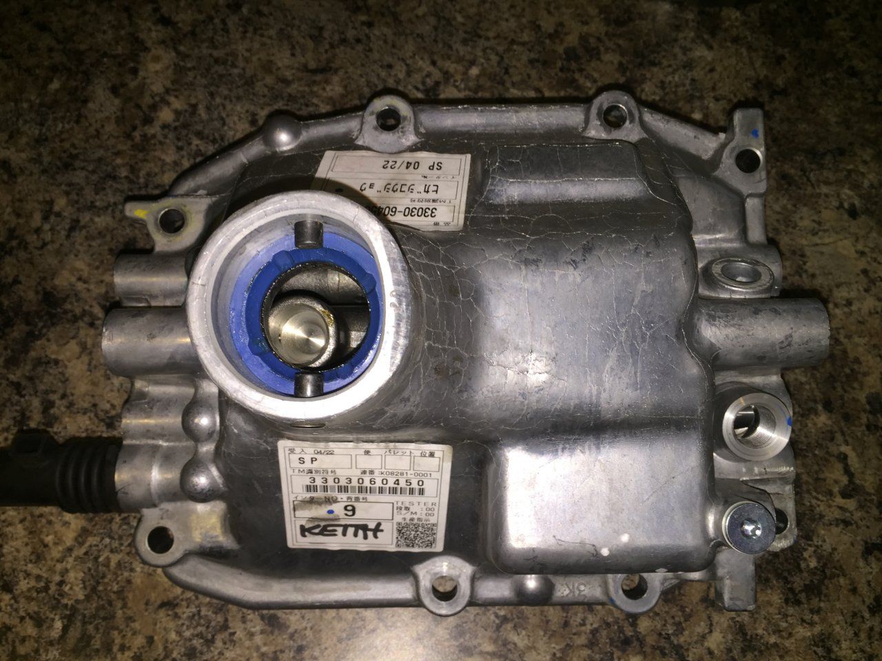

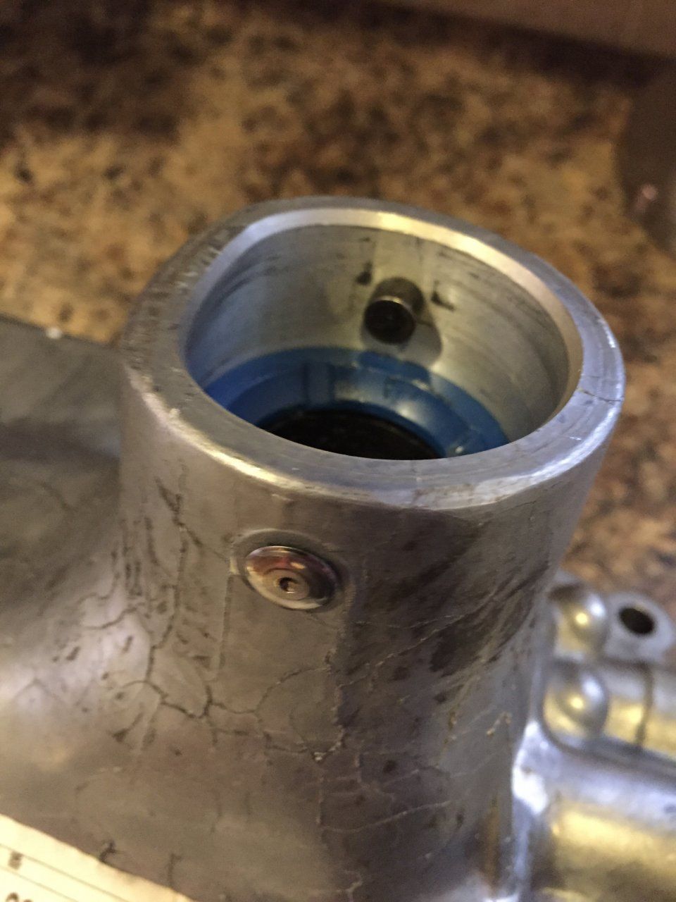

Georg's "damaged when new" top plate arrived, have never seen fracturing like this, so posting up to share my bewilderment.
Incredible how it fractured completely through the housing, but didn't actually separate.
Anyhow, my hats off to Georg. Goes without saying he's an excellent vendor, but he's gone well out of his way on my behalf before, and I know I'm not special.
True asset to the community.....wise enough for many of us.
Top cover normal Chris. Part of the manufacturing process. These dies are now over 30 years old making the same thing over and over again.
Aisin has probably not changed anything about the manufacturing process of something like an H55F.
Detent balls.
We've asked:
"How did the pin, a non-wear item, after numerous miles just disappear?"
since the missing pin was ruled the culprit......and think we now know the only way it could've happened.
When the plate was removed, during rebuild, the detent assembly (cover, spring, and ball) was removed to check.
IF the detent ball hangs up, beyond what a magnet can easily remove and since the plate is on the hard, steel bench, it's highly probable that the cover was rotated and given a good whack.
If this did happen, and if the rail were slid out at the same time (probable) it's very possible that the pin fell out.....unbeknownst to rebuilder.....(will never be unbeknownst again!!)
It's the only way that it's disappearance can be explained, as the rebuilder explained to me, taking responsibility for, even though it's all speculative (unheard of) and saying I owed nothing for his time the last few days...continually refusing my refusal of his position.
Honesty and accountability are rarities, anymore. Good to know that there are still some with solid principles and practices.
