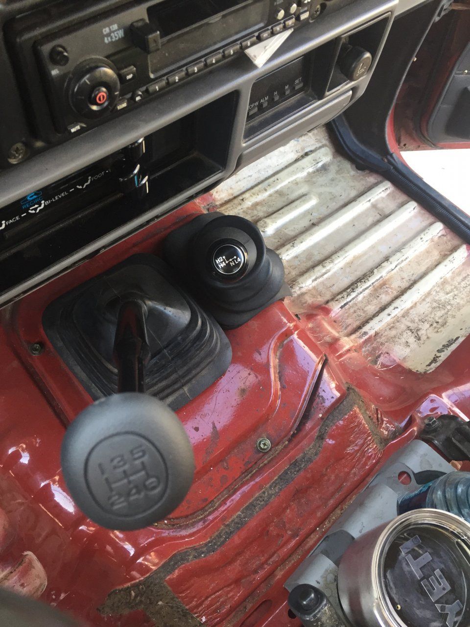

Picked up a few eBay bucks for Christmas and before the wrapping paper hit the trash can, had it wisely spent on a few miscellaneous, 'non-acq in U.S.' goods from Oz, as well a few items from @ranma21 's eBay store.

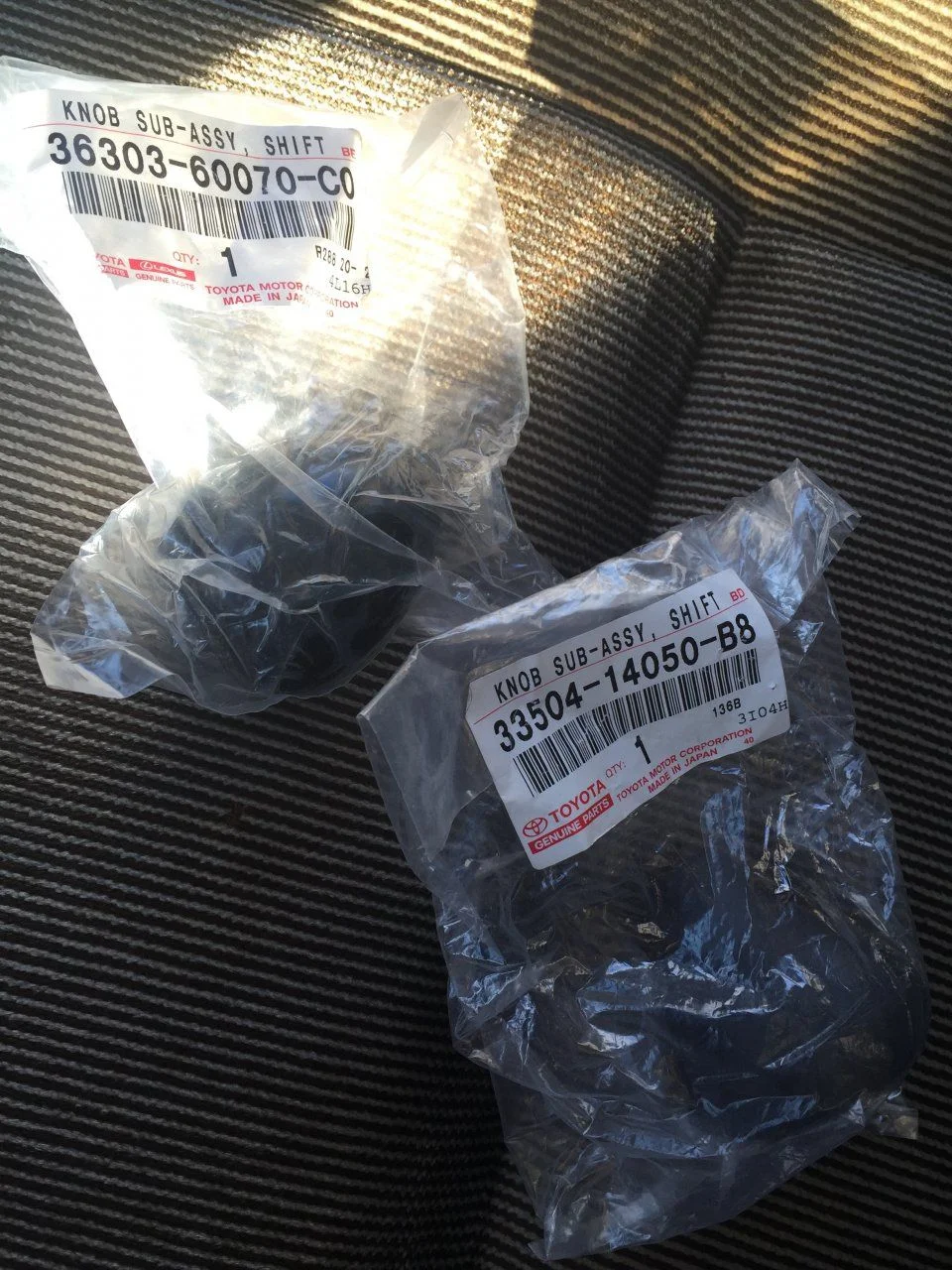

Don't know about y'all (ain't judging, regardless) but disallow other's manhands fondling my knob, nor care for the unknown sticky residues deposited from their groping.
To insure of a pure as driven snow pristine-ness, ordered replacements from Ian, reaffirming an indescribable sense of confidence......
even though my untouched knob is considerably smaller than the previous, manhandled it replaced.

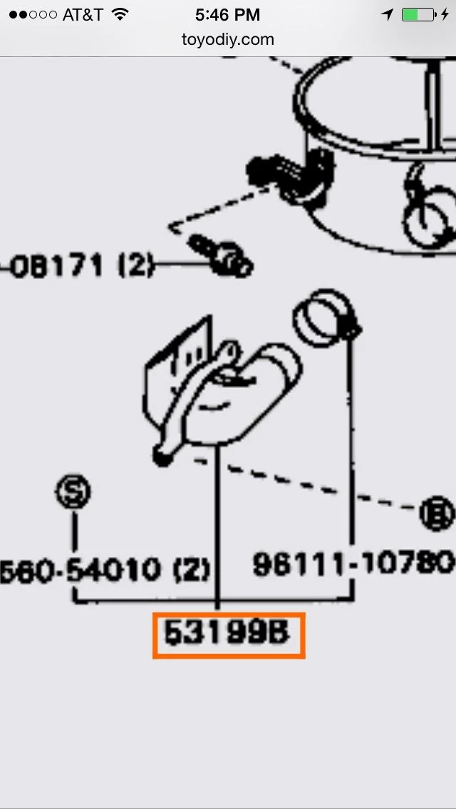

Do you have a pic of this?
Nothing more than the EPC generation...
Oddly enough, it's shown on the BJ73, VM equipped, post '90, as well as HZJ, PZJ, KZJ 7Xs from '90 through 2007, yet it only exists in, what must be the last bastion of obscure Cruiser rarities, somewhere in Russia.
Of course, the same "shop" shows one of every part ever produced for every Cruiser that ever existed, so I don't feel my inability to speak Russian is keeping me from acquiring.

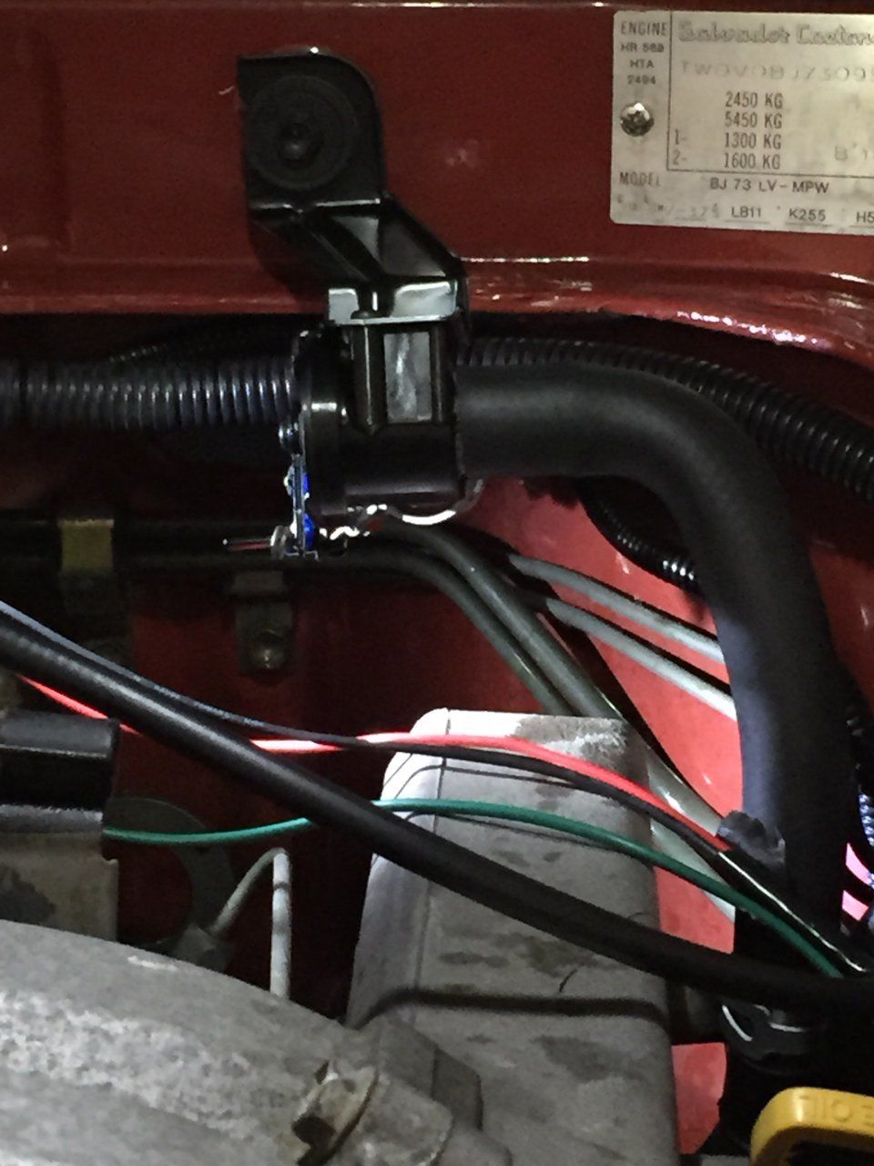

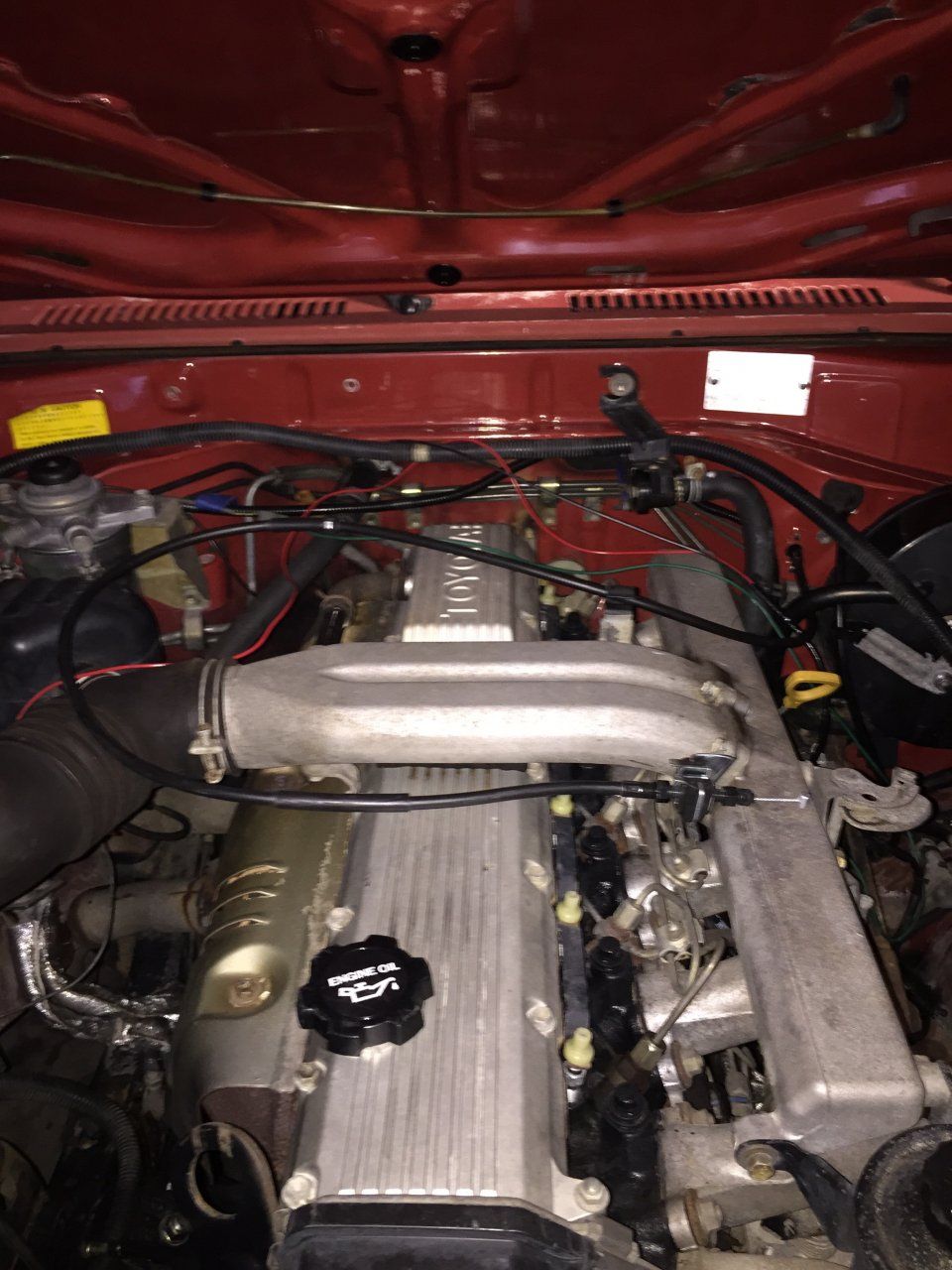

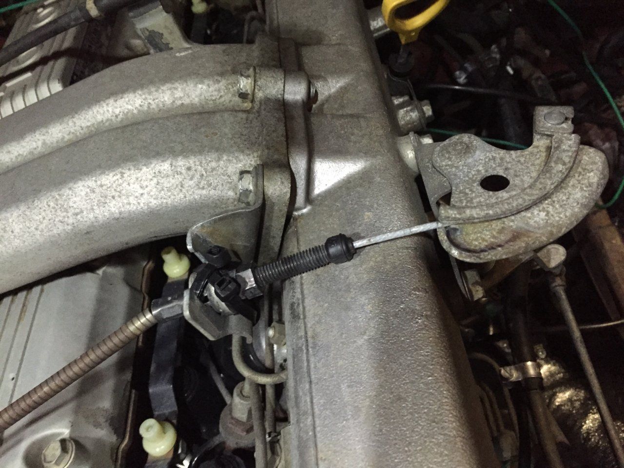

The VM throttle cable had an odd firewall mount, unlike a BJ or HZJ, so Joe did what he had to for a cable.
New cable, new brackets, mounts....
Have since modified an 80 mount that, with forced persuasion, mounts to the head on the exhaust mani side.

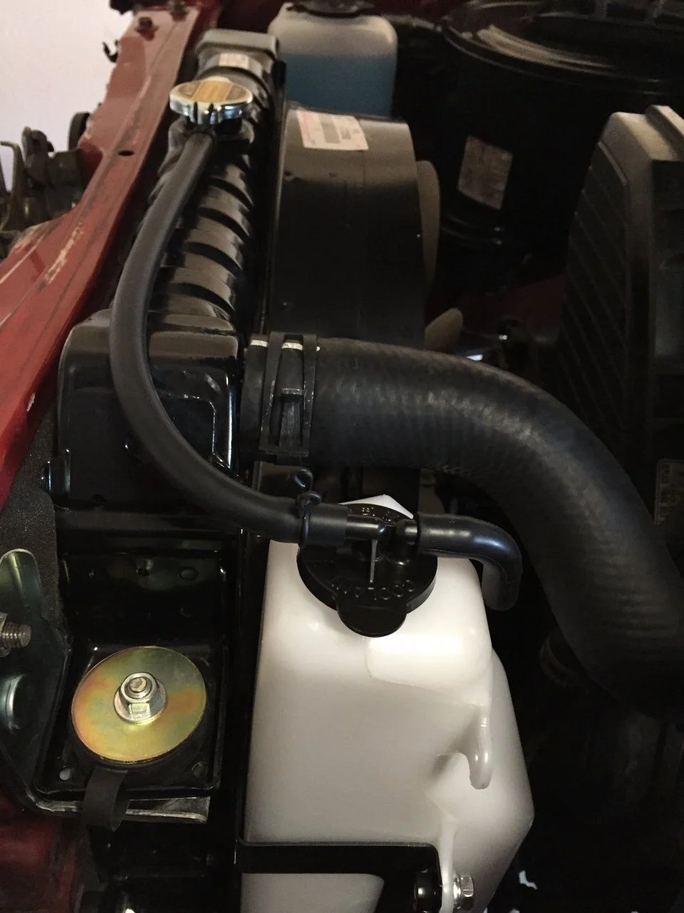

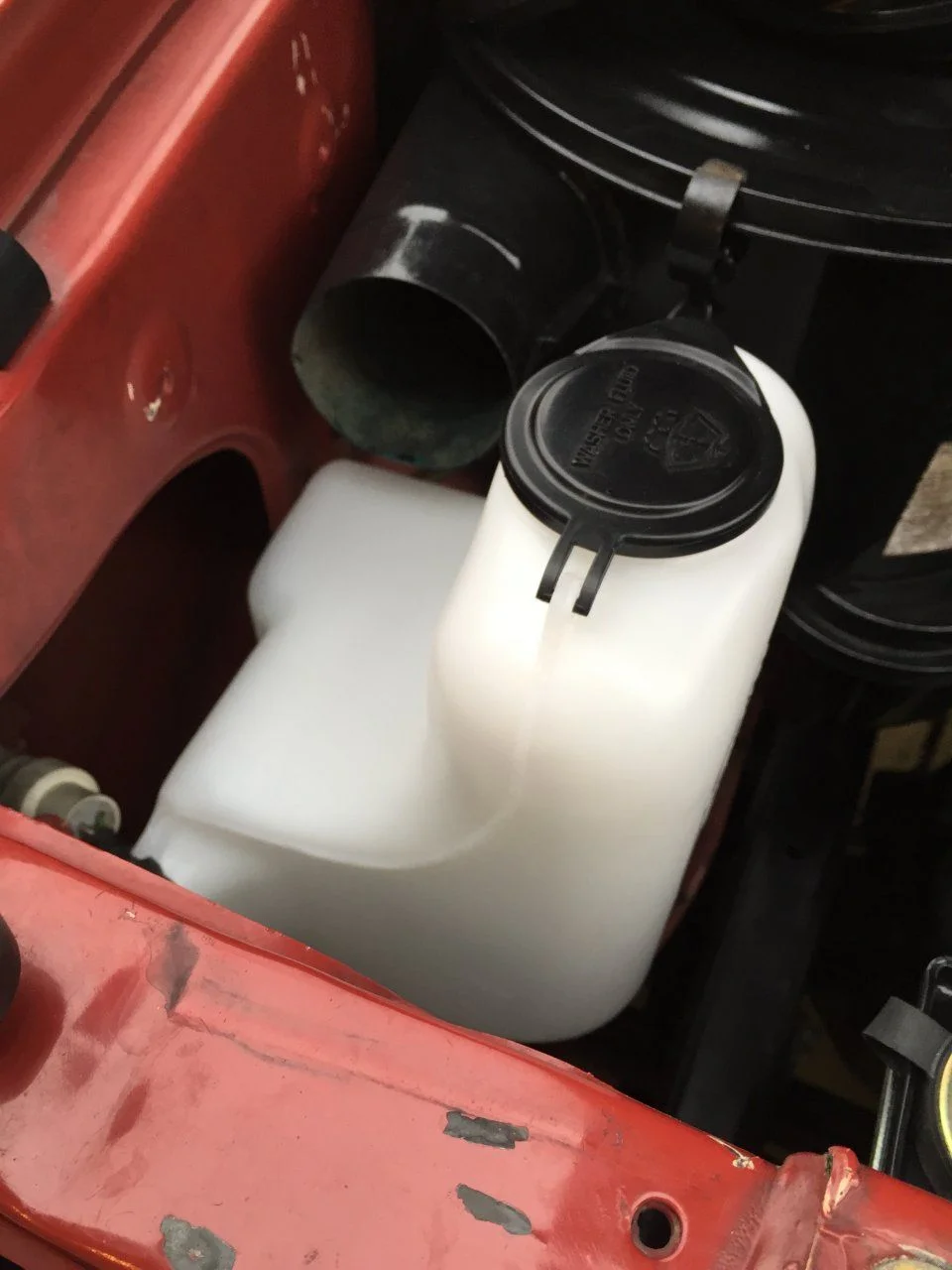

Finished up the cooling system, short of heater core or any heater related piping internal the firewall.
Hoses, shroud, resi, radiator, heater valve......bolts and washers.

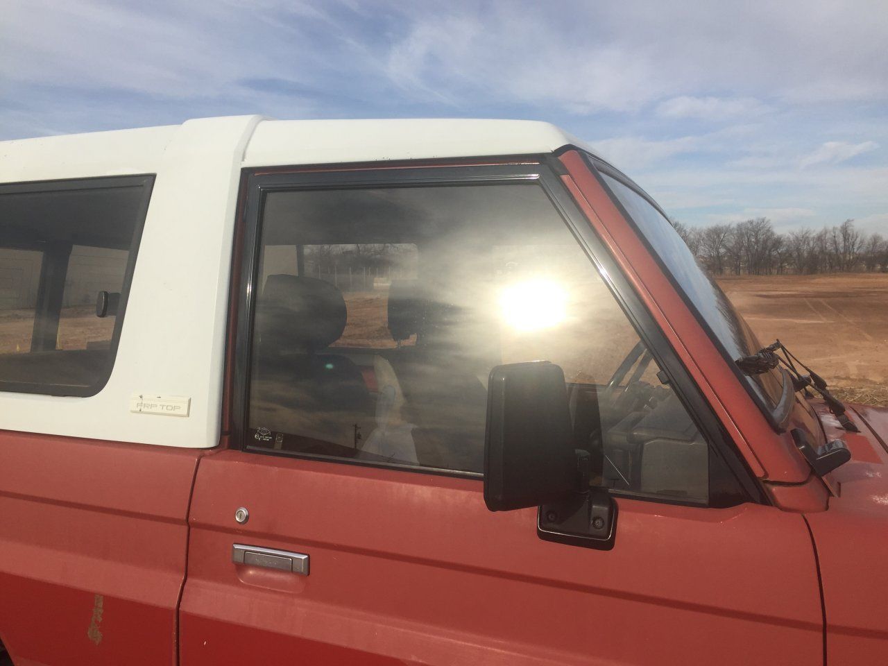

New door tops to replace the rusted (and broke DS)
Can't figure out what's pinching the DS glass rendering it immobile the last few inches of upward operation.

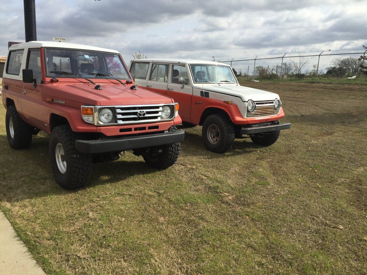

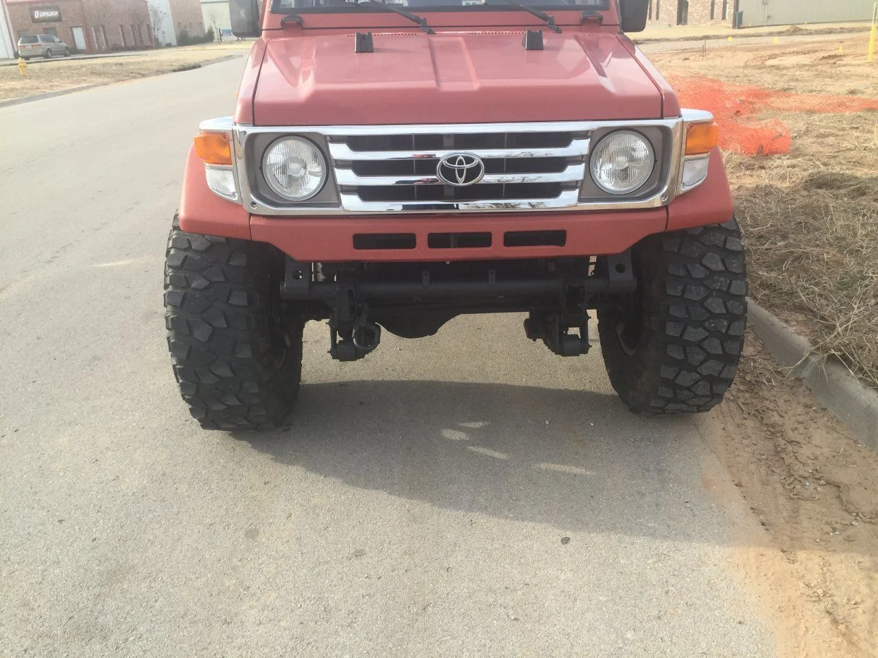

AlbertoSD personally delivered a gift from Joe K, and spent 4-5 hours realigning front panels and hood to get it kinda straight(er).
Now I've more grilles than a '90s rap star....

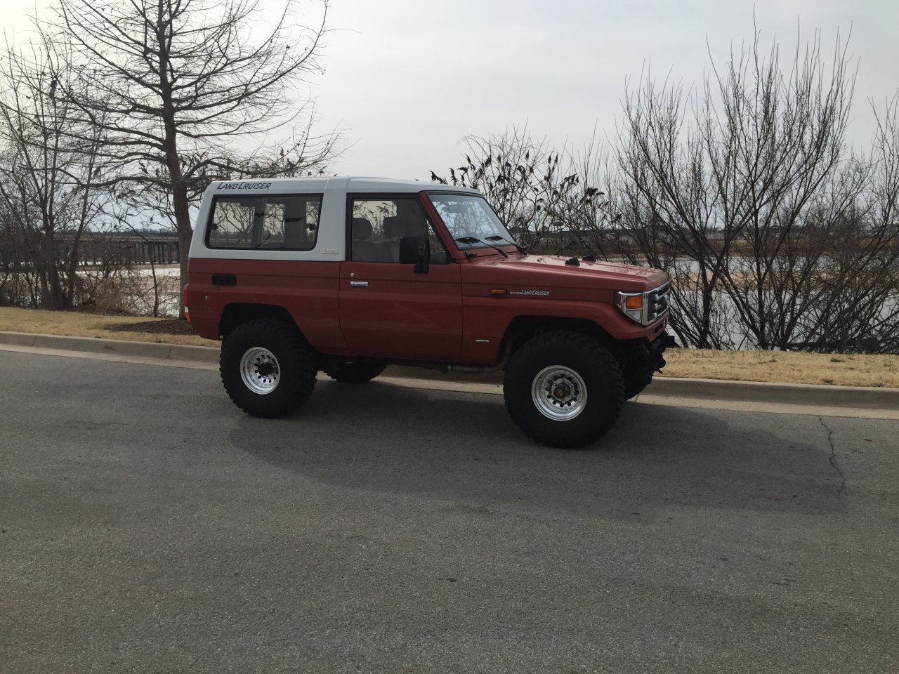

Went down a few shoes sizes a while back.
Worse mileage than the 37s, but swapping thirds (VMs were 4.56 equipped) this week or next. Shifting into 3rd in the intersection, currently.

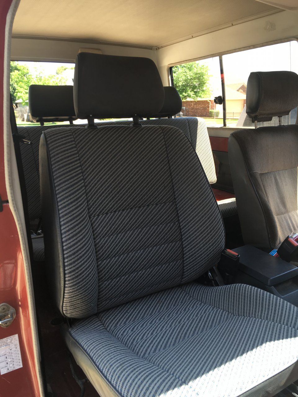

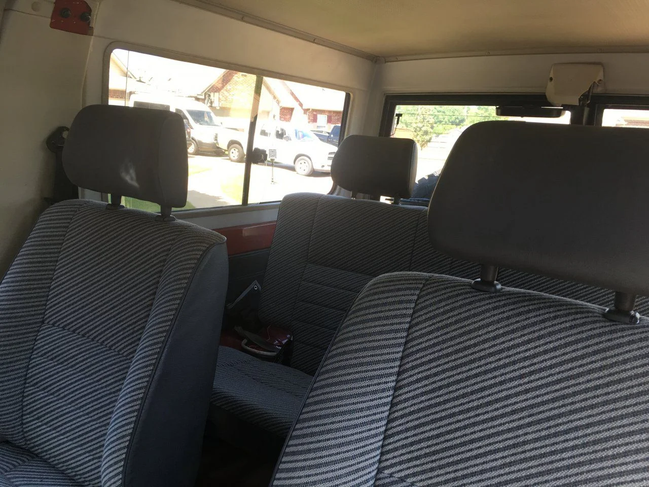

Why go down to the 35's? And are those seats just reupholstered or replaced? They look killer.
And when are you going back to the original front grille? :flipoff2:
Krawlers ain't the most comfortable tire for on road and the 35" KM2s will suffice for the light off road/on road usage this 73 will see.

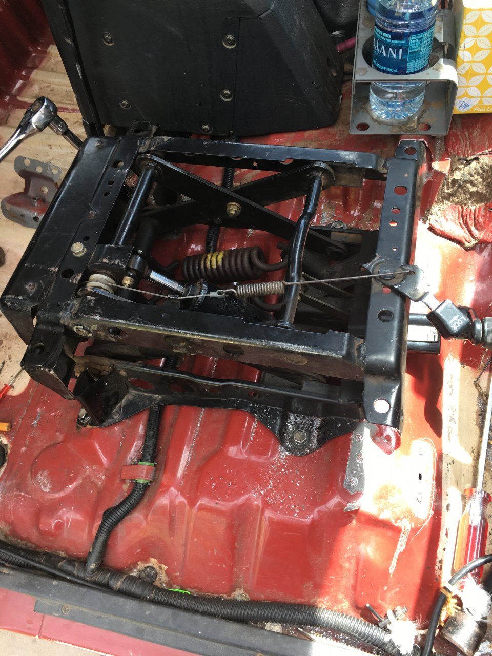

Replaced with new rear and barely used fronts from @joekatana's inventory, along with swapping fixed seats for sprung.
It's a completely different experience, one better suited for the smaller bodied. At no fault to the seat, since 6' and 220, I lose leg room as a drive progresses and have to lift up to allow seat to raise, periodically. Comfy, nonetheless.
Hoping Joe's expeditions abroad turn up the rest of the corresponding light gray interior components.
Looking for chrome signals to match and once conditions warrant the 'turbo' badging.
