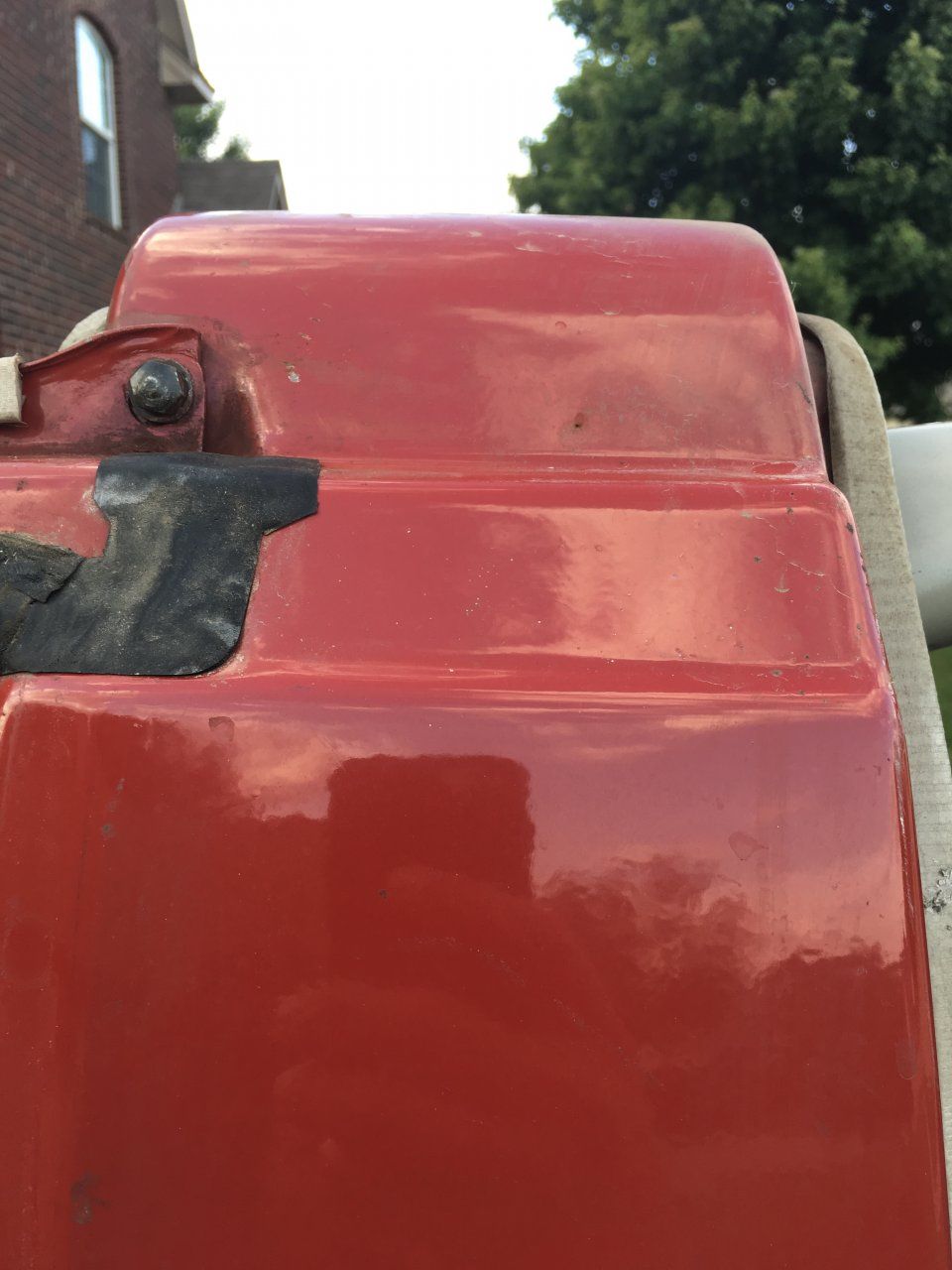

It's not the cleanest, hence the 50 yard pics.
The tops are comprised of a few steel reinforcements, wrapped in foam, then encased in a plastic shell, so not really a good way to cap the cut.
I'm considering more a stuffed bikini top, cutting along this line, terminating above the cabrio, somehow.
Maybe be handsy with some fiberglass.
This is actually a top from Joe K (didn't cut my good top) but think it's worth the time, so seeking new rubber seals for both it and the full.

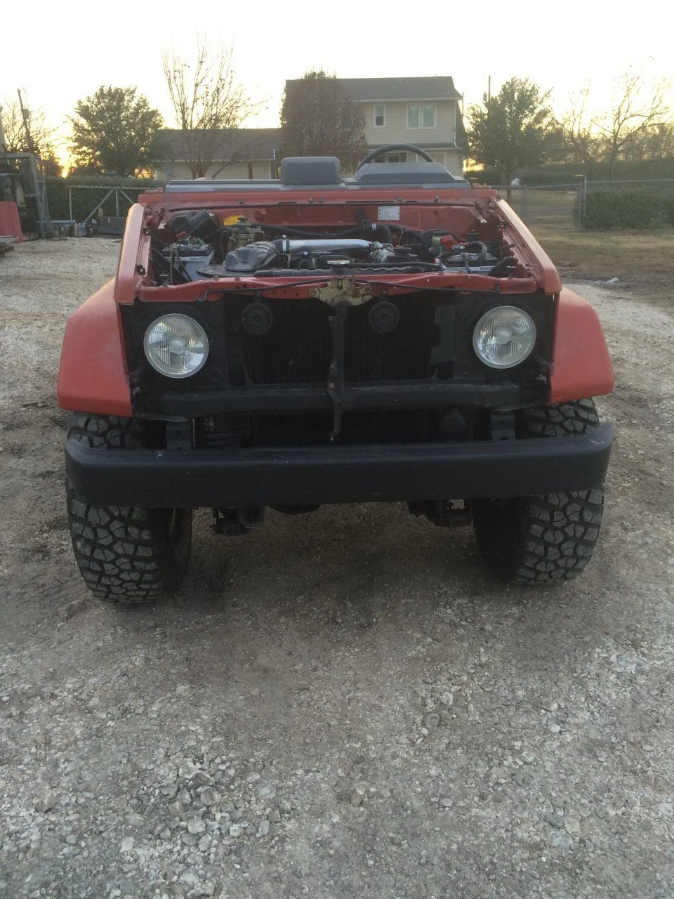

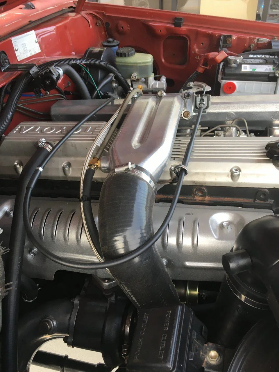

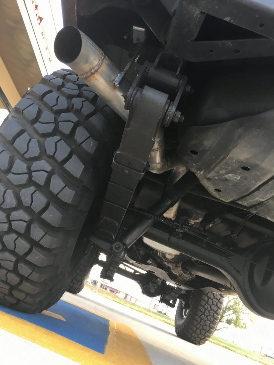

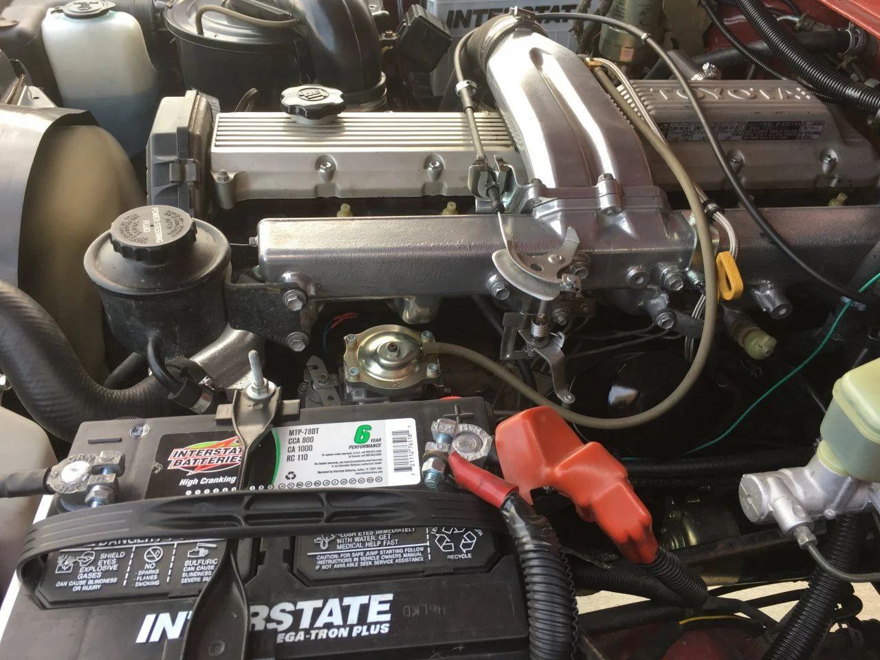

Tuned intially with the downpipe only, and it ran very well, although a flat spot in 3rd.
I couldn't take the looks of pipe, pushed down from OE exhaust, so cobbled up a union between it and the little VM exhaust, and it felt peppier, but smoked.
Had the 3" put on (they suggested and said, up front, it'd need to be tuned after) and it runs ok, smokes more, but needs tuned, for sure. No boost until way late in the RPMs.
where did you source the turbo from?
@sbechtold sent an eBay Australia link that he'd done some degree of checking into, and purchased from them. (Thanks, Sol!)

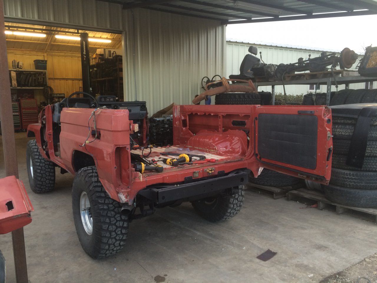

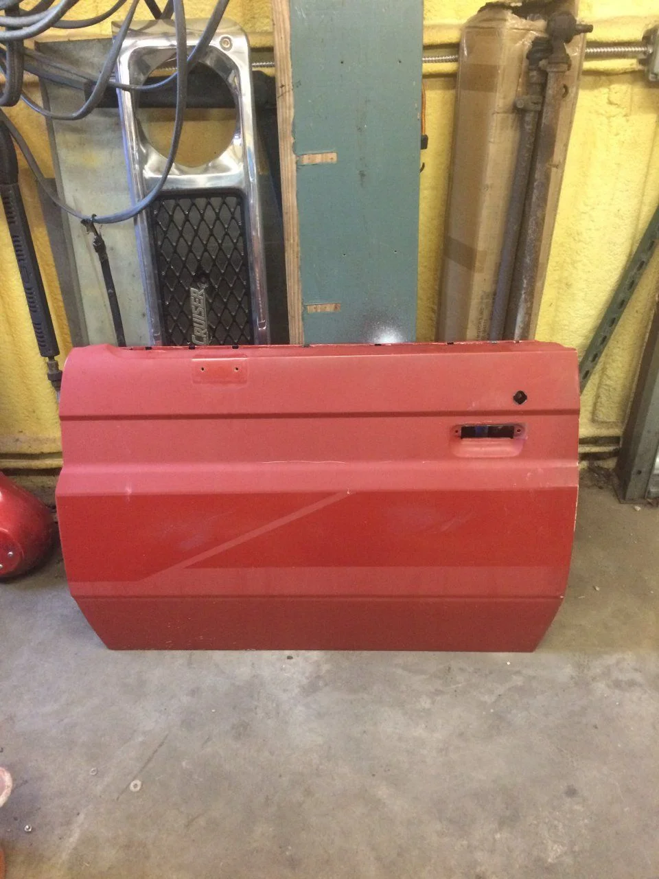

So what have you done to repair the rear doors?
Cashed the insurance check and requested replacement from @joekatana, all I've accomplished yet.

For reasons I shan't go into, (partially because I'm legally bound not to) the IP and injectors were rebuilt before turbo to.
I know that whole 'ain't broke, don't fix it' mentality does bear weight, but post rebuild, she ran considerably better, enough so that I'd say it should be the first step in 'powering up' the HZ.
