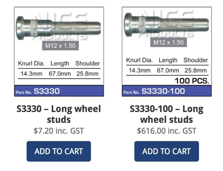

Front extended studs (+15mm over stock) from Australia.
Thanks!!

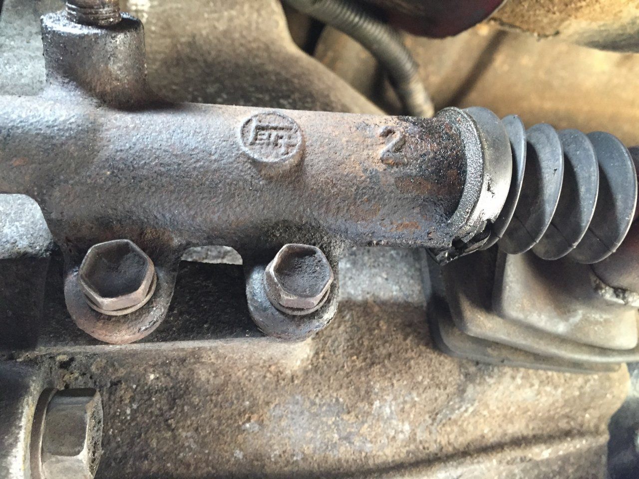

As part of a clutch pedal and line rehabilitation, one promoted by an extremely contrary pedal, replaced all the fasteners, bushings, springs, and clips, along with MC and slave.
Went through a few MCs, in an attempt to find the perfect match and appease the voices.
The first attempt was a "BJ70" MC with a three hole mounting base, that was a fail, right off.

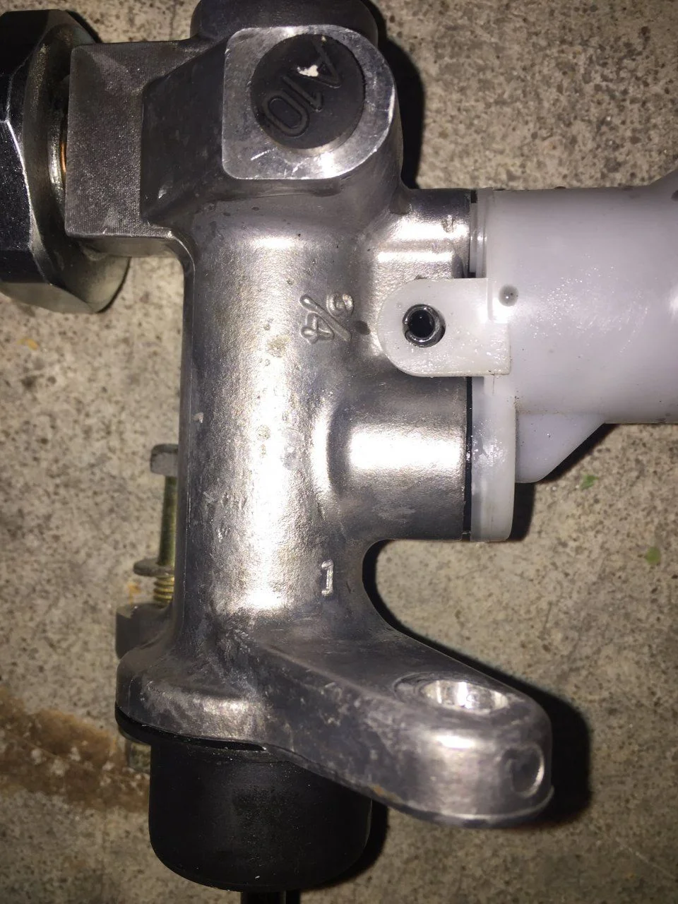

Second was an HZJ7X MC with incorrect stud location. Note the 3/4 and 1" nomenclature.
Relocated stud, drilled out the other hole, mounted up with a new HZ slave.

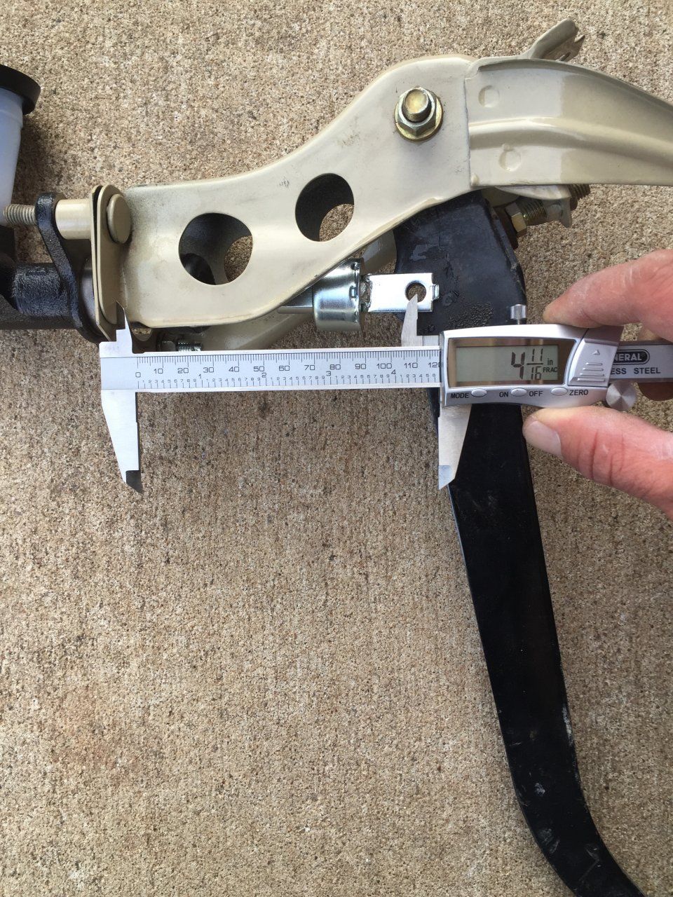

Something was still amiss....pedal travel versus clutch engagement didn't feel right, like the last 1/4 of pedal travel was pointless.
Adjusted in every manner possible to correct, but, if starting a few inches from the end of pedal travel and working backwards, the clutch pedal sat well lower than brake.....didn't feel right.

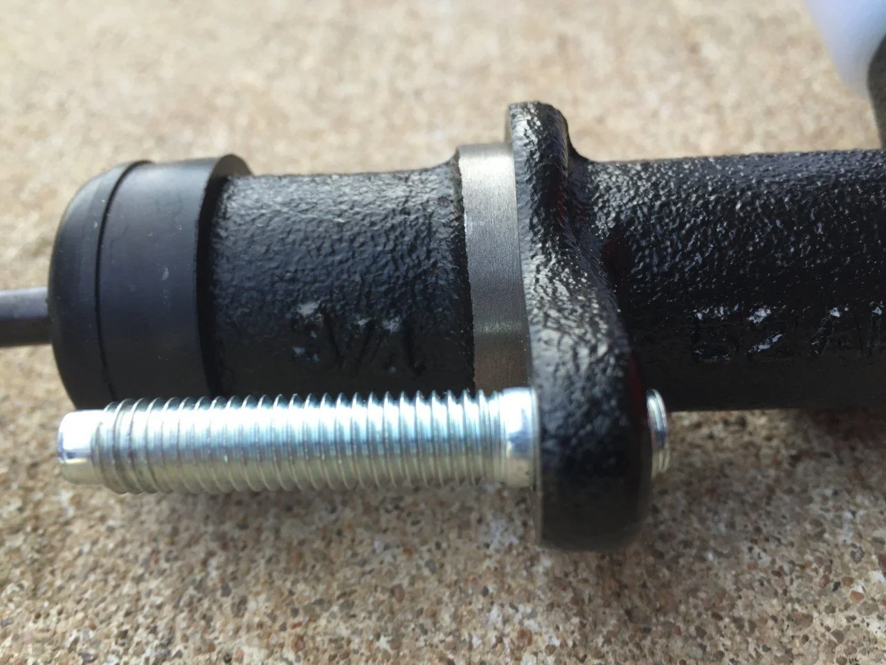

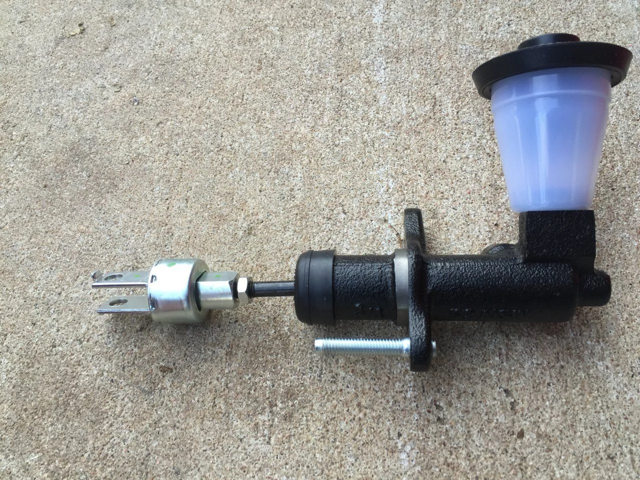

So, rounded up the correct MC for the body and clutch pedal/pedal bucket. Note the 3/4" casting.
First tried to calculate the differences.....
which took longer than it would've to just swap the damn MCs, but, pretty much, the stroke of the BJ and HZ varies and think that and the different bores impact pedal "feel".
Mounted up the BJ MC and was a dramatic improvement than previous, but still a dramatic increase in the amount of pedal pressure with the HD clutch.

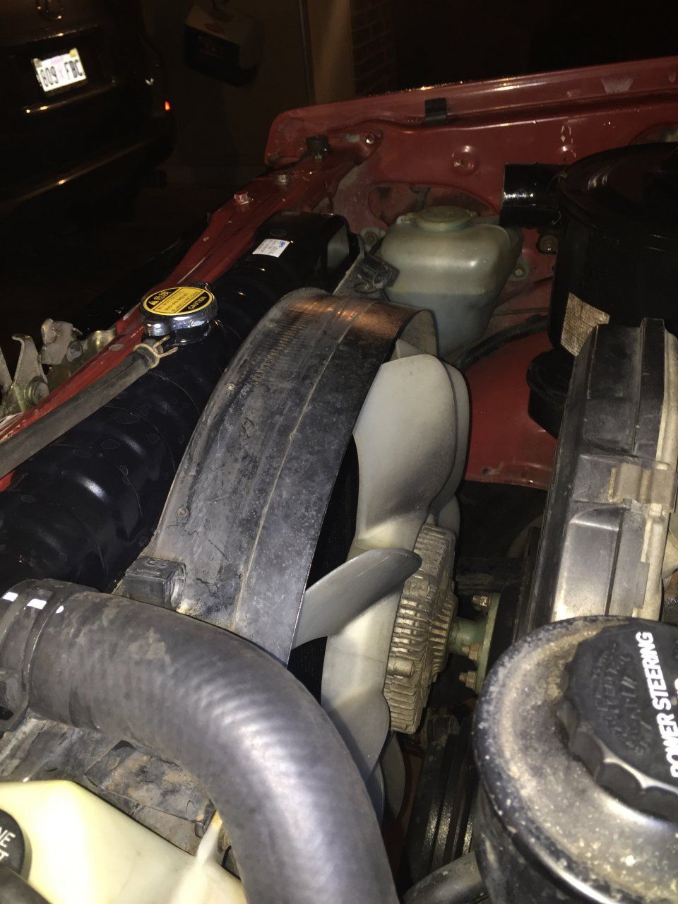

Fan shroud looks fine. Are you doing all this yourself?
I set my clutch pedal up so it engages in the first 3/4" of pedal travel because I'm lazy :D
The pic may not do justice, but there's only 1/4 blade that's actually shrouded.
I don't anticipate cooling issues, because the HZ runs relatively cool and it is a euro spec 24V HZJ73 shroud, but doesn't look, being operative, right.

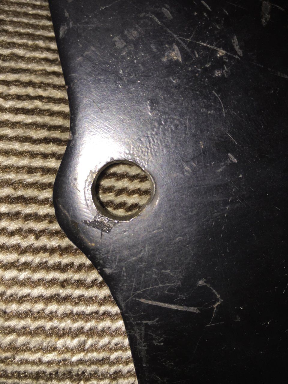

After the HD clutch went in, with the original VM MC and original HZ slave, it was a hard pedal, and I mean very hard, so much so that I think it's probably when the plastic bushings in the pedal assembly cracked and the hole elongated.
In fairness to the HZ MC, the pedal assembly issues may have played a role in why it didn't feel right, I don't know, but it's now as good as it'll get without a booster, not worth the headache of a booster, because I don't mind the workout.
