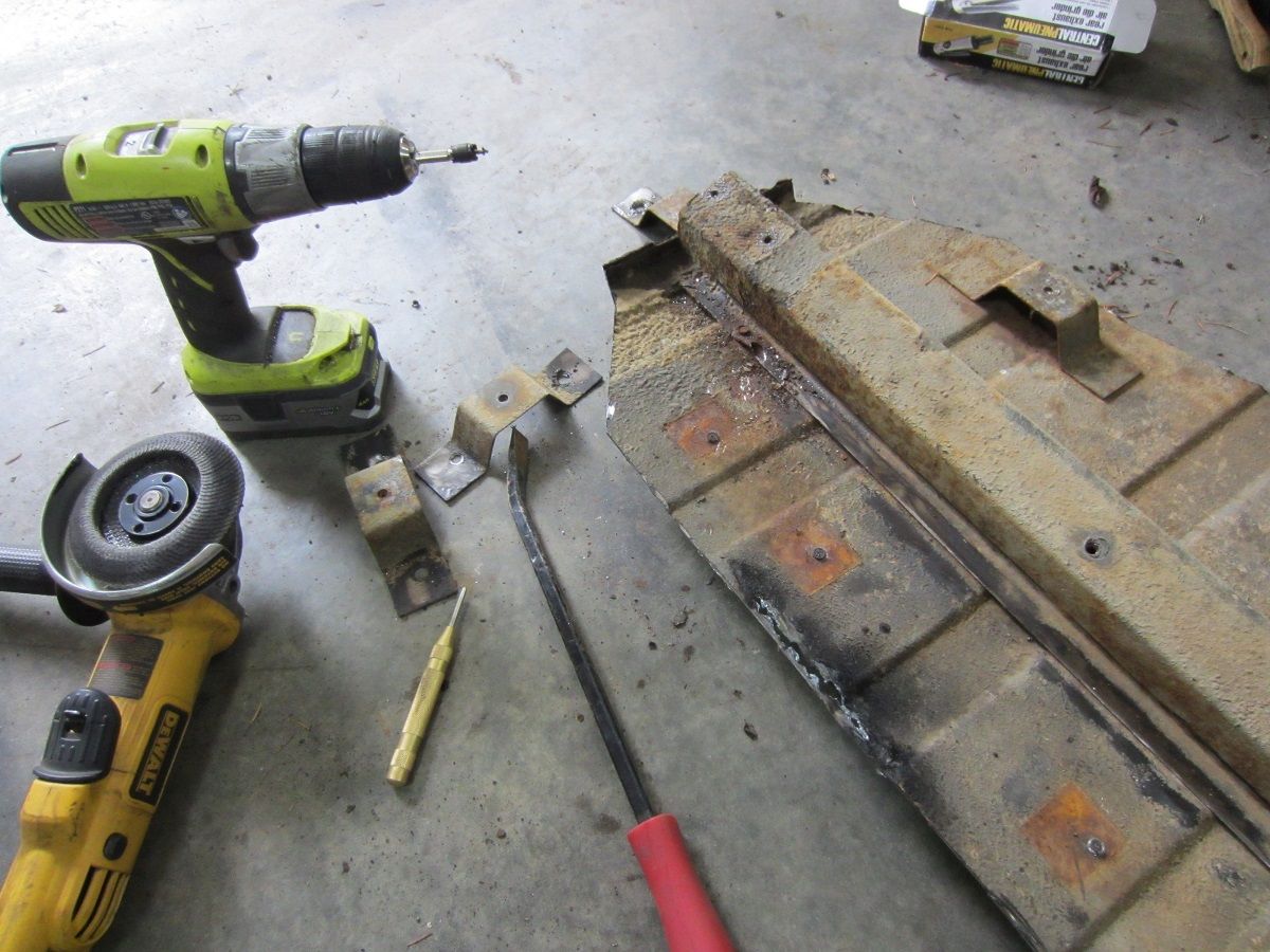

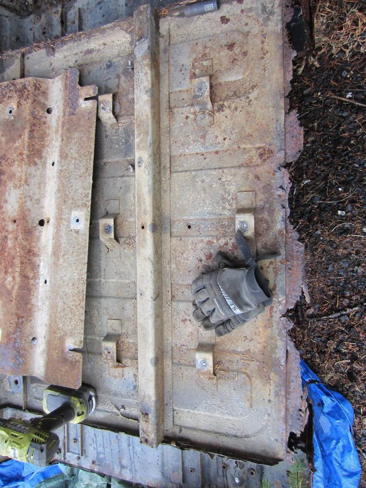

I did take advantage of the break in the rain to cut the brackets off the old tub. Got the "skid plate" off to find them in pretty dang good condition really.
full
So i cut out the section and took it into the garage to work on it. Of course the rain didnt come back so i could have just done this on the old tub. But the old tub is scrap anyways.
I tried out the harbor freight spot weld cutter and have to say it works pretty well. Hardest part is finding the spot weld. The brackets were easy but the channel piece doesnt seem to be as easy.
full

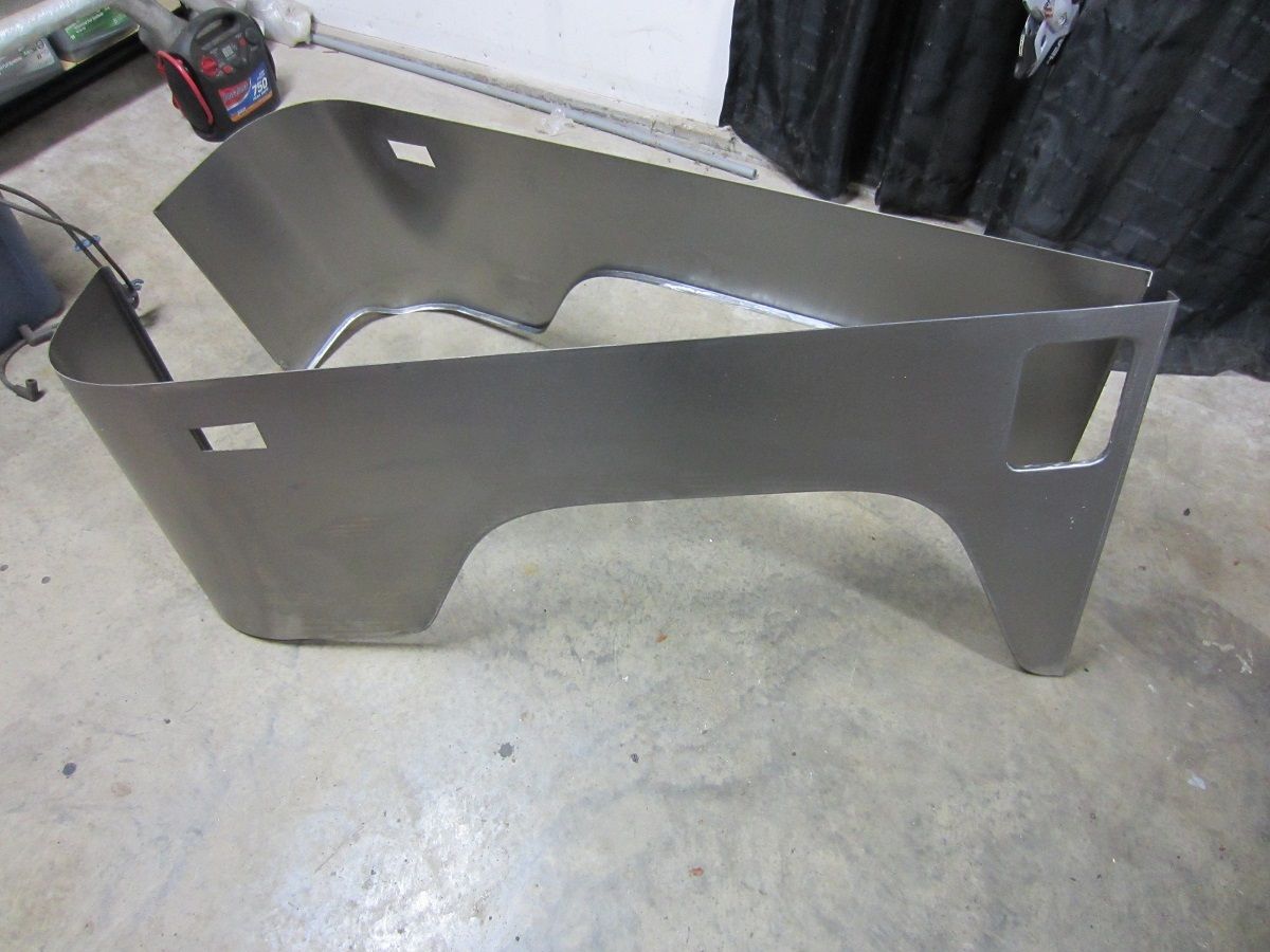

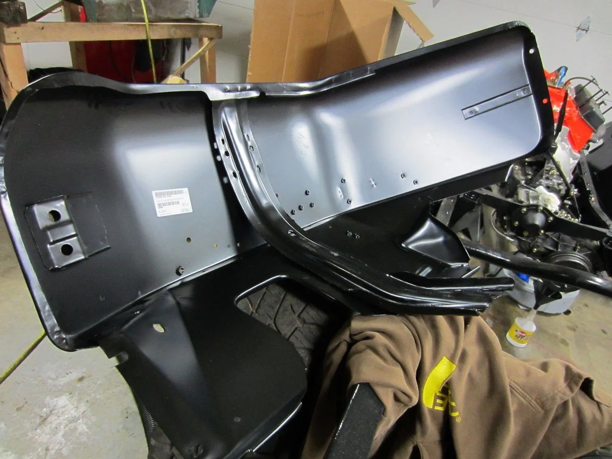

Its sort of like Christmas part 1. Today i got my quarter panels and fenders from CCOT.
The quarters look fine. Comparing them to mine I think I could have been fine without replacing mine but at least now Ill have a more factory wheel cutout instead of the more rounded one the PO did. kind of one of those lots of extra work for a bit of bonus sort of thing lol
full
The fenders....are OK. They will be just fine for my intended uses (ie a not afraid to go on a trail). They look just fine when installed. They get the OK rating more just from the final finishing. The edging was clearing just folded over and that was the extent of it. A simple sheet metal straightener tool would have smoother out the edging a lot. Then a lot of the edges on the non-fender skin portion (ie the fender support i think its called) were left rough. The passengers side was sharp...liek easily cut you sharp. The drivers side wasnt as bad, more just rough. So be a bit of cleanup. Am i happy with them? Yeah (especially since the drivers will be getting cut to fit the power steering) for my use I am. I would be a bit disappointing if i were going for more a OEM restoration type build
full
I should get to work on things tomorrow and Saturday but like everything who knows for sure. Then I have a nice package coming from Marks offroad on Tuesday !

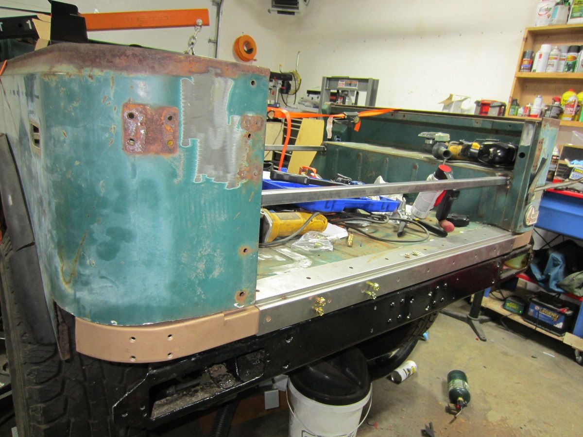

Few more hours spent on it today.

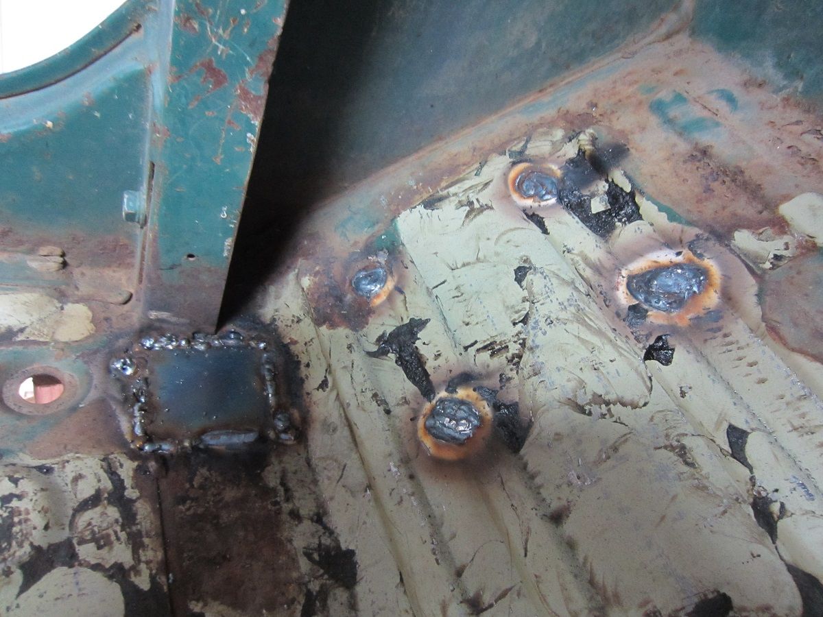

Spent a bit of time fixing a few holes. The cut out section was the PO deciding to make access holes for getting to the body mount bolt. The other holes were from a role cage attachment point.
The first "patch" i dont think turned out to bad given i didnt want to cut to big of a hole. But that piece is welded all the way around.
full
Then I did the top piece
full
The holes were ok. Ill probably have ot go back and redo them though. I started grinding them down smooth and started getting pin holes. I think its cause the metal was a bit bent up and i didnt flatten it back up. I might go back on the other side and add some metal.
Then i played with the rear sill a bit. More cause i tried to fit up the new sill cover piece and was confused by it cause it seemed to long. But got the old cover piece separated from the bed and cut out the old one. The old sill definitely needs to be replaced now that i can see it. I also went ahead and braced the tub.
full
Then lastly I did a find other things. Replaced two knuckle studs with the correct fasteners and torqued them. Finally installed the rear cross member bolts (needed to drill new holes for them) and did another brake line or two. And finally i needed somewhere to put the new fenders so what better place than just install them :) Well got one on and then realized i forgot there was a broken bolt in the passenger side....D'oh!
full
At this point I am thinking my next attack plan is going to be to put the tub on the frame and do the rear sill and quarter panels. Once that is done Ill be able to take the tub off and finish up any other welding then blast the tub, then hopefully epoxy paint! We will see on the paint part though. If im reading the SPI directions right you really want to do the epoxy paint and then other layers within time frames.

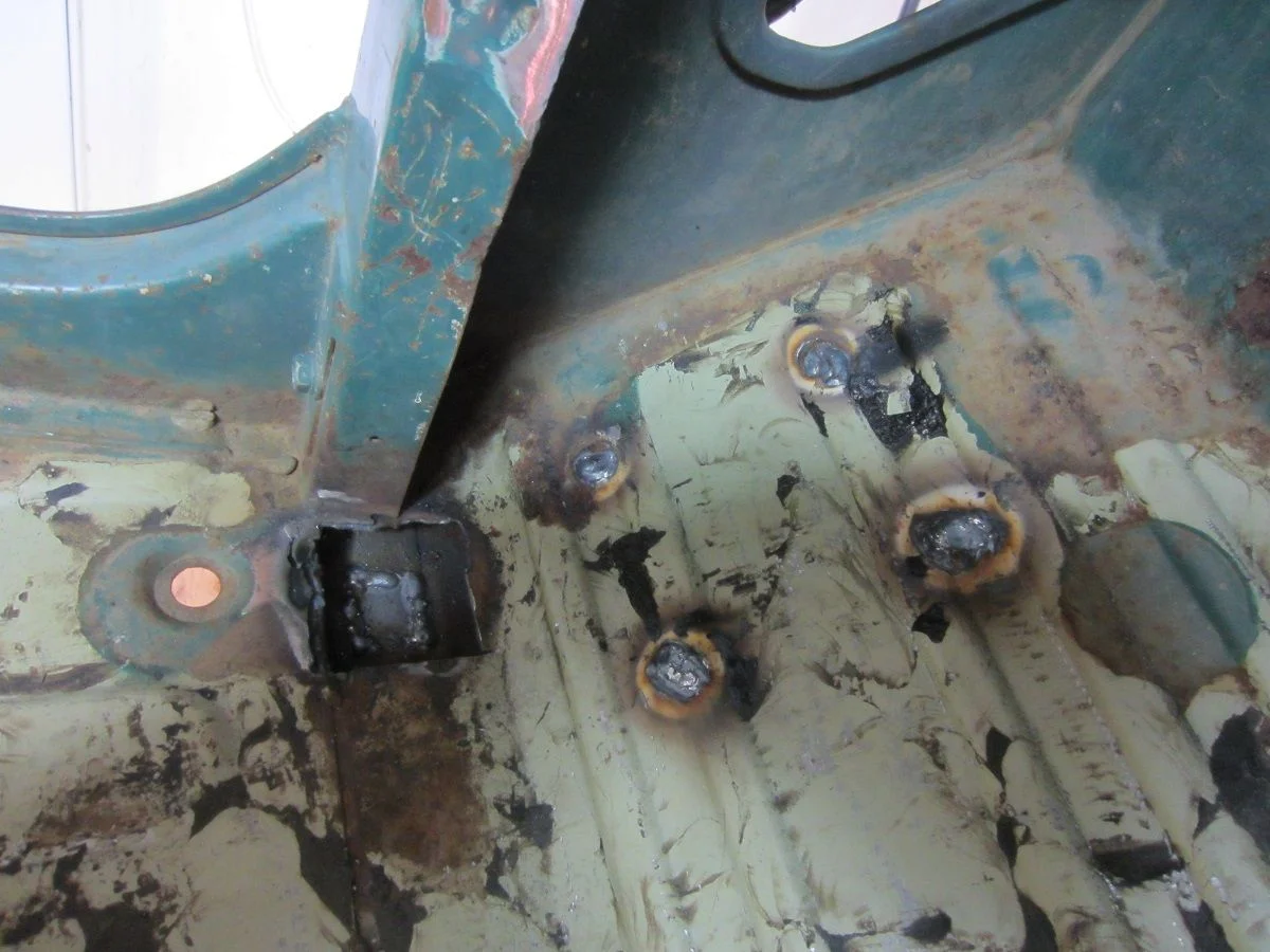

You can use copper to back up the holes you are filling.
If large enough it takes away some of the heat, leaves a nicer botom finish plus you'll get a flatter weld on top.
Yup i did that on the side in the pictures. The other side i tried without and lets just say thats the side that needs a lot more work! It worked fine filling the holes i just didnt prep the area well enough. The PO had nuts on the backside (ie engine side) and when they tightened them down it pulled the metal around the holes in and deformed it.Instead of just filling a hole it was more like a cone. So basically i filled the hole but when trying to make it flush with the floor i was just grinding that deformed metal. So thats how i ended up "grinding through" so to speak.
I did do two holes in the passenger floorboard with the copper backer that turned out great. Hardly any grinding and nice smooth bottom (just needed a touch of the grinder). Of course I didnt take pictures of those lol.
But hey no matter what Im still pleased with everything. Lots of "firsts" for me so not to worried if it takes a try or two to get it the way I want it.
It is always best to find out and learn from your mistakes.
Next time you can flatten the cones first by slowly hamering them back with a dolly next to where you are hamering, hammer off dolly.
I definitely learn best by just doing. Especially real world situations and not just on scrap metal lol.
I was actually just looking at hammer and dolly sets. The harbor freight one actually has good reviews and for the little Ill need it I might just give it a shot.
Another option I have is to just cut the whole section out and replace it with the section from the old tub. I tend to forget i have the old tub that still has plenty of good metal left
Welding in sections is not as easy as it looks.
Take it slow, hammer the welds when they are still hot and let the metal cool after each stich weld.
I might actually give both things a try. Figure it cant turn out any worse lol. I actually cut the sections I would need (roughly) out of the old tub and mocked them up. Lined up just fine. I only really tested the drivers side which is the better of the two sides already so ill see how the passenger side looks. The passenger side would benefit a lot more from it than the drivers side but I didn't have a chance to blast the section to make sure it was good to go.
Ill ponder it so more till the dolly and hammer set arrives and see which route I end up going.

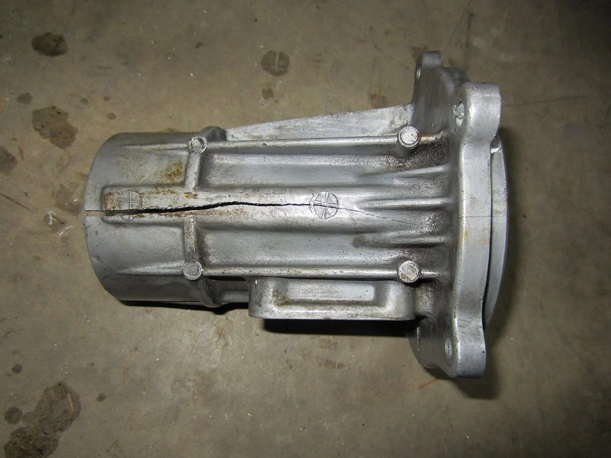

I also got the "new" extension housing for the transfer case. Got it all re-assembled with new bearing and seals. Blasted it clean and painted it too. I also did a heli-coil to one of the bolt holes since the threads were well out of spec (looseness) and might have been the reason for the leak to begin with. Added a single quart of oil to test things out. Was a small drip (1 drip every 10 minutes or so) coming from the drain plug so I tightened it down more and am hoping thats the end of leaks!
full

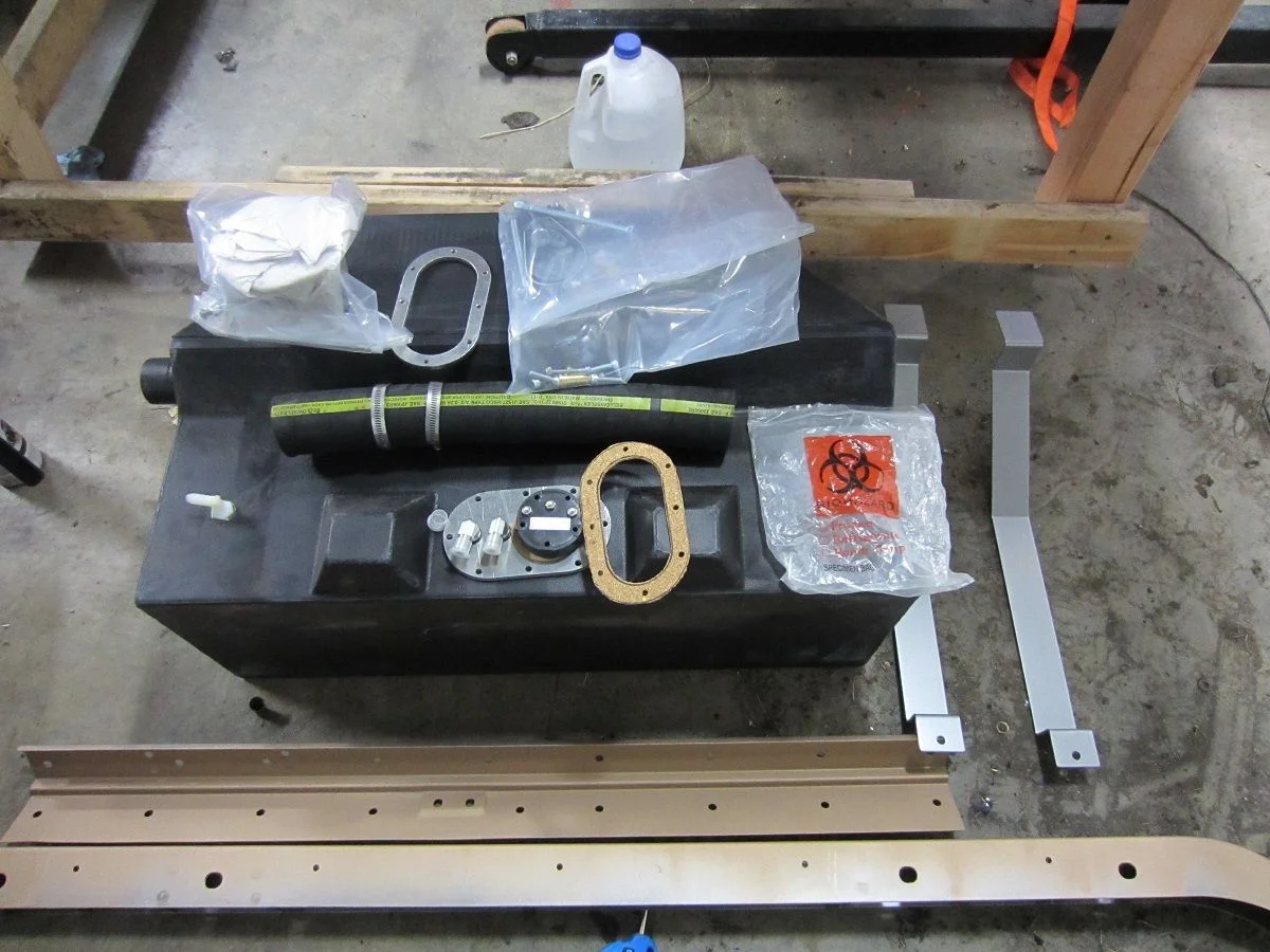

The rest of my order from Marks Offroad was a Aux Fuel tank kit with the sender. Was hoping to get it installed but just ran out of energy today. I did love the Bio-Hazaard bag the seal and retaining clip came in!
full
