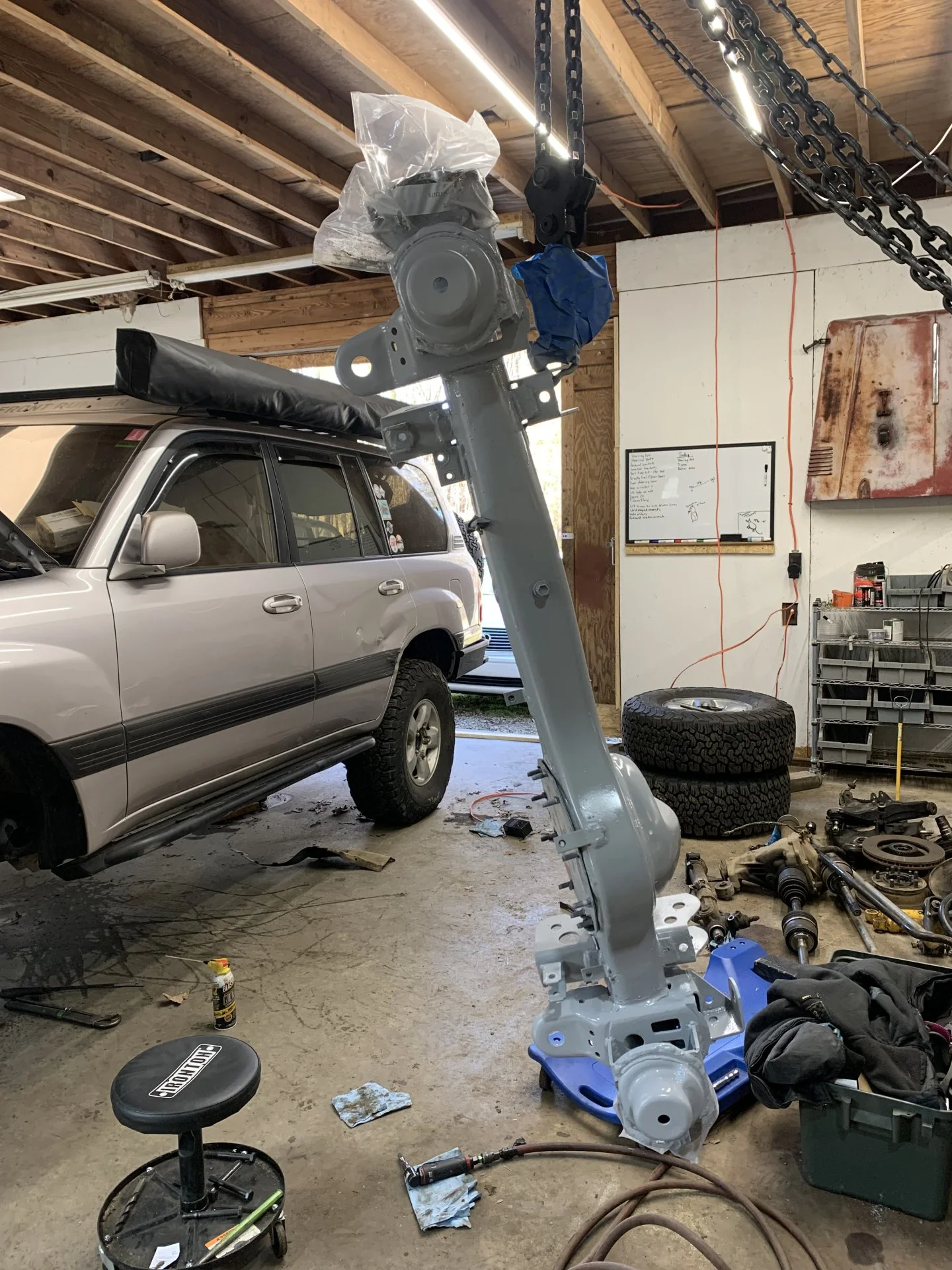

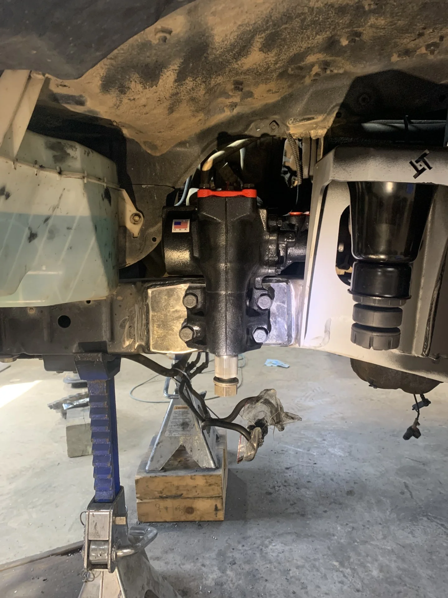

Was able to get the steering box fitted, t-case back together, and the axle painted over the weekend. Trying to work out the steering shaft is eating up a lot of time. I see @saucebox has spent some time wrestling with this.
The issue we are running into is that it appears that it requires three joints in order to work. The problem is the 3 joints create too much play. There is already a factory joint on the cabin side of the firewall. The factory shaft will not move outboard enough to get it inline with the 80 steering box. *wish I had take some pictures of the shafts.
Two options in consideration:
1. cut a bigger hole in the firewall to move the shaft outboard and keep the shaft in place with a bearing. This would eliminate the need for a 3rd shaft (in theory)
2. go the 3-joint route and secure the shaft to the coil bucket or firewall with a bearing or a heim

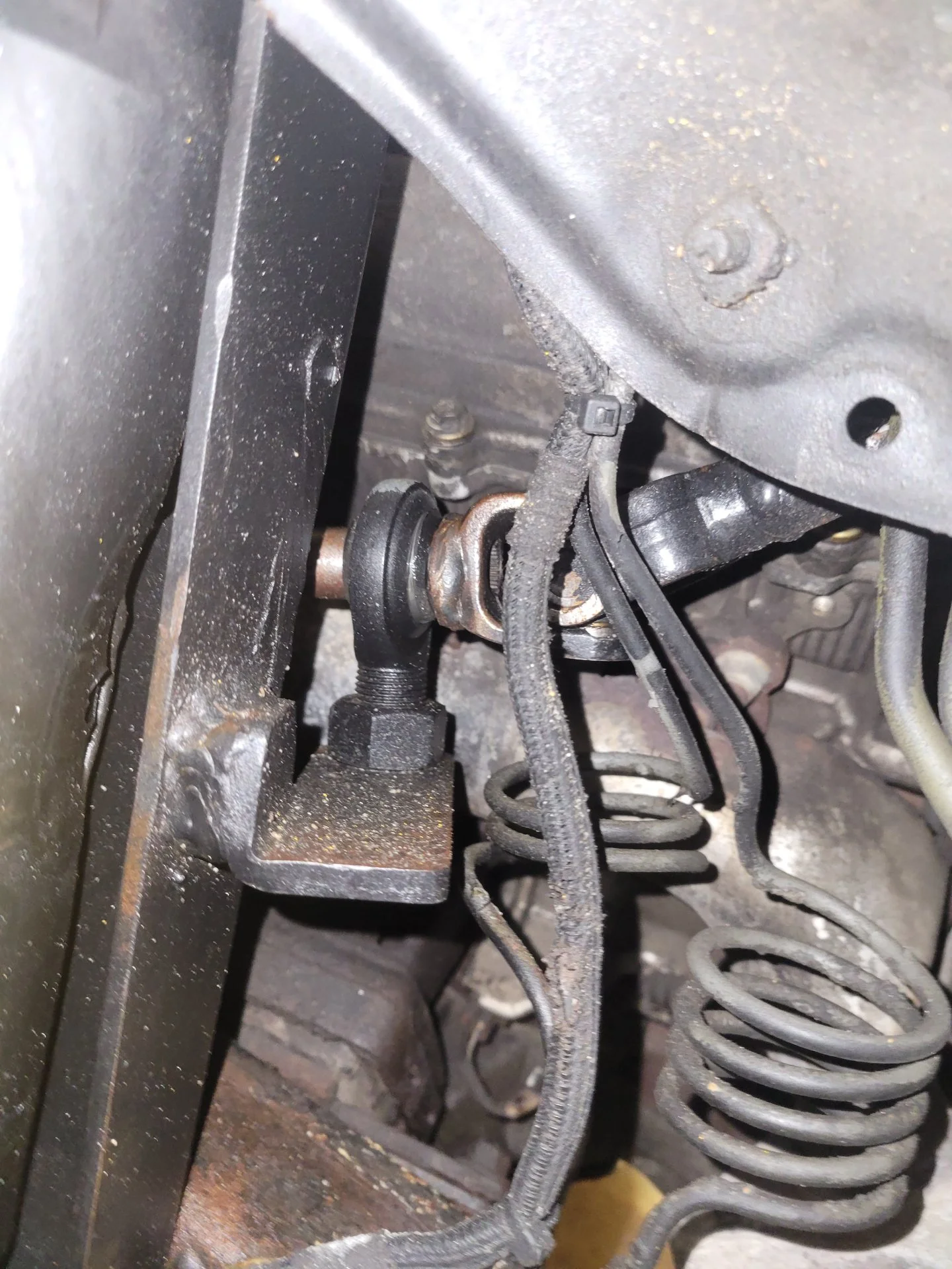

Hmm. Just two joints for me. The top joint does occasionally ding against the DT header (lightly), and I'm sure being that close to heat will wear it out sooner, but no issues so far.
I just welded an 80 shaft to a 100 shaft at the right length. Hard to get pictures of though, also would like to see TT's solve.
will provide pictures tonight. But short answer, heim/bearing on spring bucket moving it over from column.

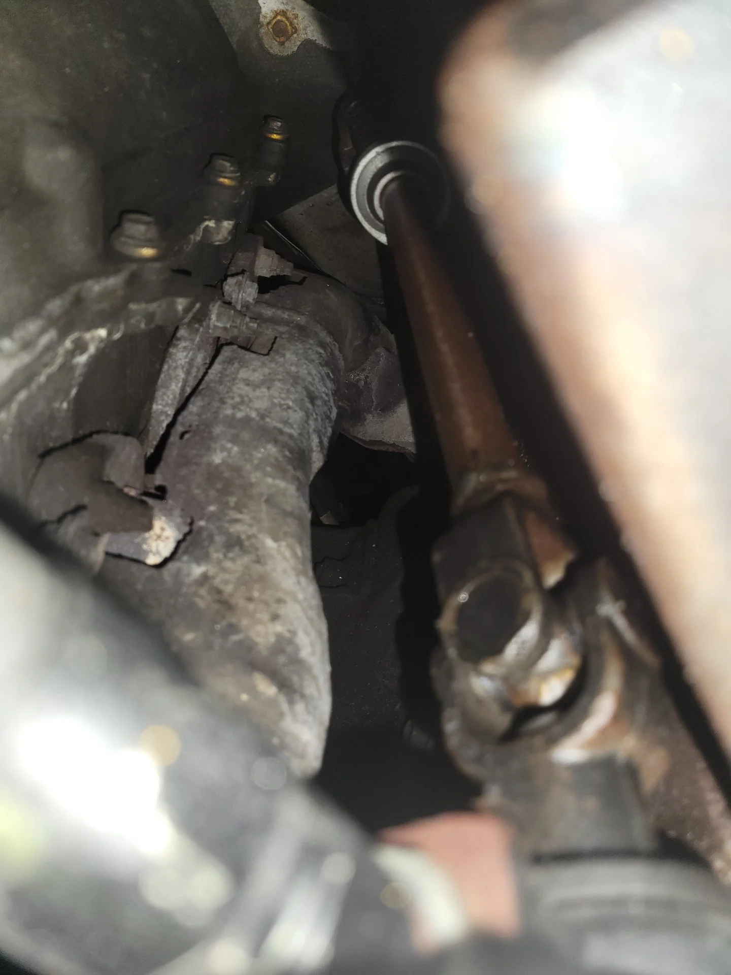

One at the box itself (factory 80 joint) and another at the firewall (factory 100 joint). It works, but I'd bet serious money that @tornadoalleycruiser's will be the better solve.
Edit: there's a 1" body lift in there in my case. Shouldn't affect angles too terribly much, but it may be different than yours.

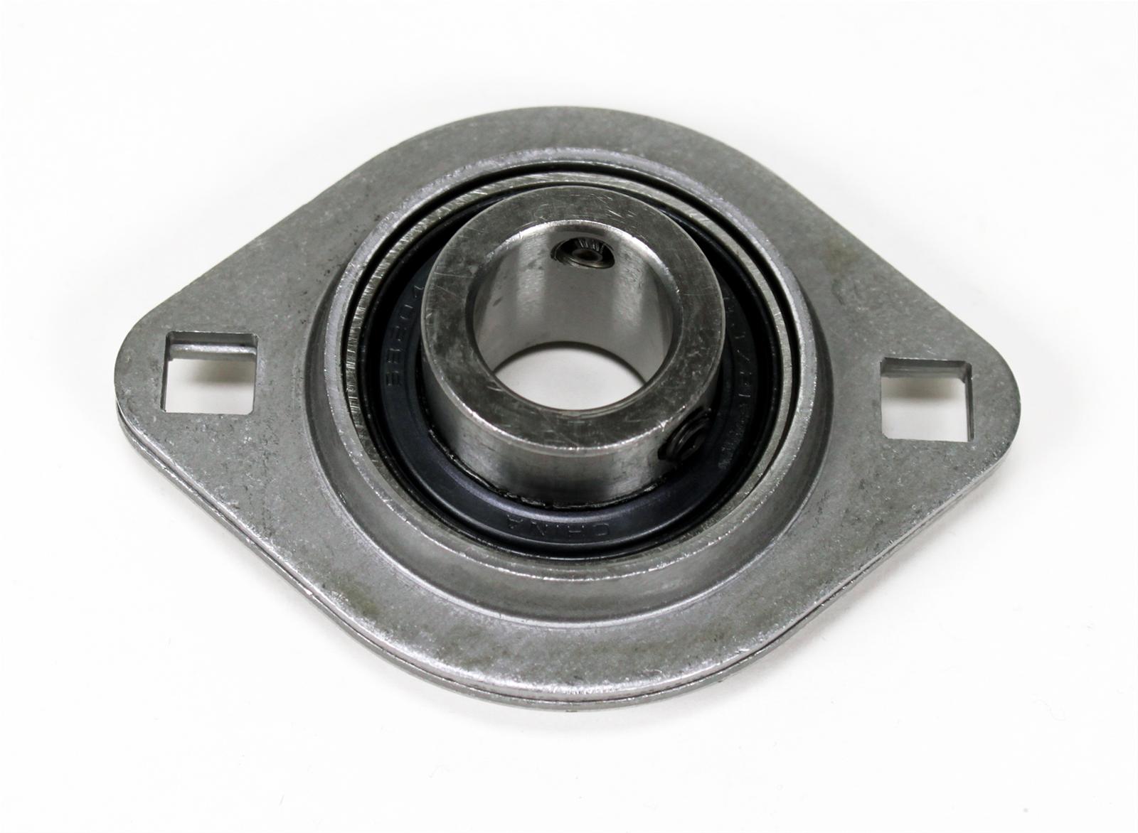

FYI, the bearing that comes in that ididit flange is not sealed like in the picture. I ordered a FAG sealed bearing of the same dimensions. I got the bearing from ebay

Put the carrier bearing on the firewall with a plate or whatever, pointing it towards the steering box as much as you can while making sure the tilt function of the column still operates smoothly at all angles. Then a two ujoint shaft connects the column at the firewall to the box.

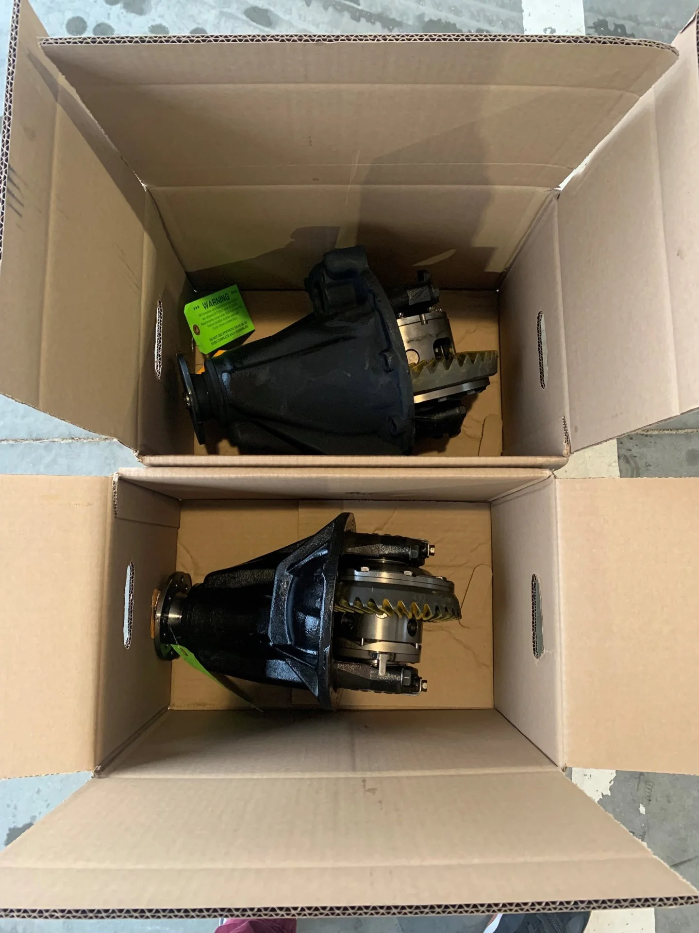

Picked up the front & rear 3rds from East Coast Gear Supply this morning. They turned them around in just over a week. Now running 4.88s.
Harrop e-lock on the front & factory e-lock on the rear, making this UZJ105 3x locked.
