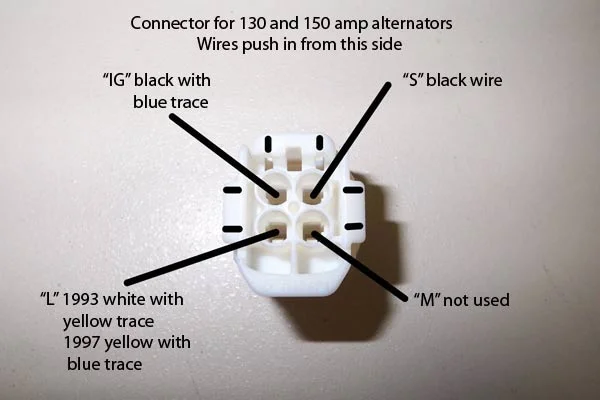

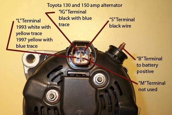

Here are a some pictures showing where the stock wires are on the stock alternator and where they go on the new alternator. These have mentioned and posted in other threads but this will hopefully keep this together in one thread. The pin outs are shown with the color codes that I know of so far. Any mistakes please point them out to me so I can correct them.
The idea is just to pop out the 3 existing wires from the stock 80 amp alternator connector and push them in the holes of the new connector until they click in.
The "L" pin is for the idiot "L"ight"
The "IG" pin is hot with the "IG"nition on. It must have power with the key on or the alternator will not work.
The "S" pin "S"enses the voltage and adjusts output. Always has power to it.
The "M" pin is not used on the cruiser.
Bill

Ok after removing upgrade Im putting old one back took the 150amp to an alternaotr shop and they cant do anything with it, NOW I need to know what sequence the 3 wires go back into factory alternator plug. cant find it in FSM anyone??

yea took it to an actual old school alt/starter shop and he said it DOESNT have a replaceable VR but I called the yota dealer and said bring in the bad alt I bought in oct and he will replace it. so.Im gonna give it one more go. thank for the images above I got it now.

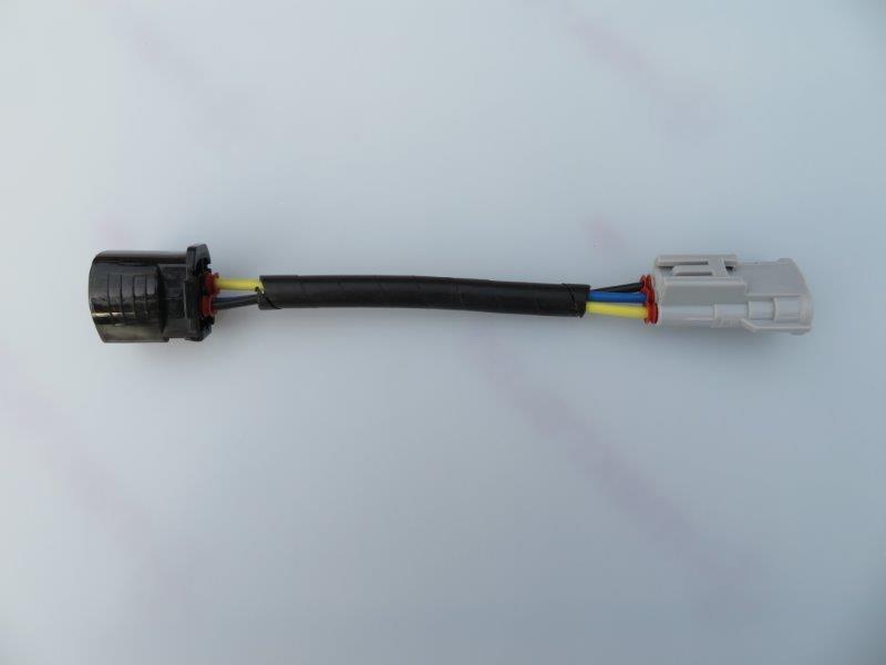

Some people wanted an adapter to go from the stock alternator connector to the 130/150 amp alternators so I made some. This makes the upgrade a plug and play as far as the small wires go.
