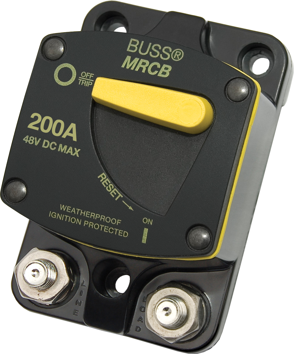

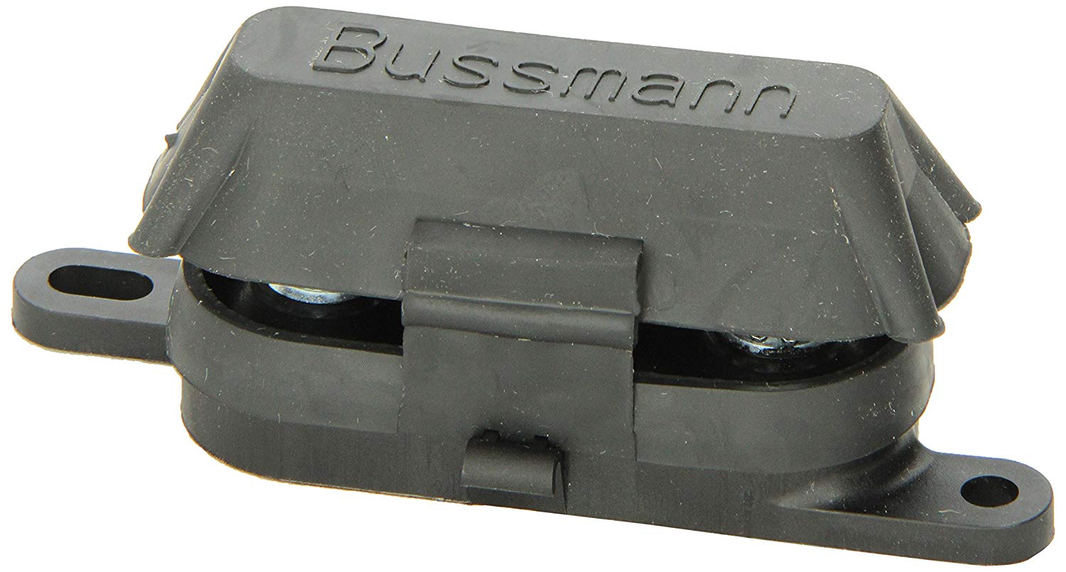

Has anyone used a Bussmann/Blue Sea style circuit breaker instead of a big fuse for the "B" terminal white wire? This would allow you to just reset the system instead of buying a new fuse (if you get a short).
I suppose the downside is that you're committed to a particular sized breaker (200 amp? 175 amp?) once you install it. Whereas with the fuse boxes, you can just swap out a new fuse.
Bussmann/Blue Sea Breaker
Conventional Fuse Mount

I'm using a dual fuse setup from Blue Sea that bolts right on the battery terminal using 1" square fuses. Can't recall the type. I have a 150A for the alternator and a 200A for my 1/0 run to the rear quarter panel. Cant get any closer than ON the battery terminal and there's no mounting location issues.

My battery posts are already cluttered enough! Ha!
I was entertaining the breaker-style protection rather than a fuse, but was curious if anyone had done it before. Or could think of a reason not to.
