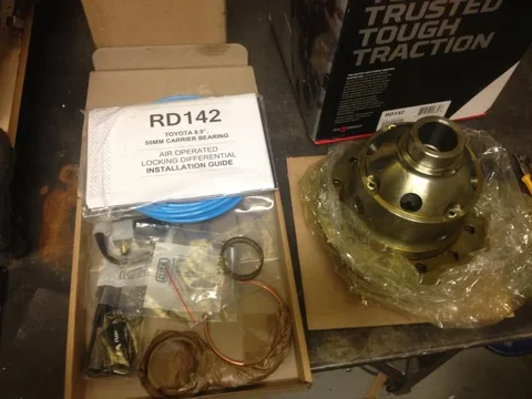

3) Front diff. It's open and I had at least three specific occasions where a front locker would have gotten me through.

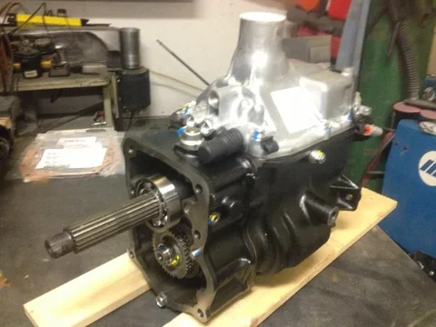

I had a 3B rebuilt at great cost for my 45 project using many new components and a t3/t4 turbo. The 45 project is going another direction and this engine is getting dusty. I sourced an H55f/splitcase (from Behemoth60) out of a 86 BJ70 but it has over 650,000km on it. I also purchased a brand new H55f from Beno and AA's 4:1 gears purchased through Kurt.
This combo does a number of things differently than the stock train did. Turbo for more power. 5 speed gives lower first gear and a 15% overdrive. The 4:1 case gears give me a 77:1 low/low and another benefit. The lesser known effect of the 4:1 AA gears is the 10% under-drive in high range. At first I thought that was a bad thing until I realized that the 33" KM2's give me near enough to a 10% rubber overdrive.
Net effect is a corrected speedo and 5% overdrive with a turbo to power it and low enough crawl to stop a lot of the herky-jerkies.

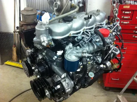

The 3B originally built for my 45

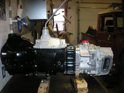

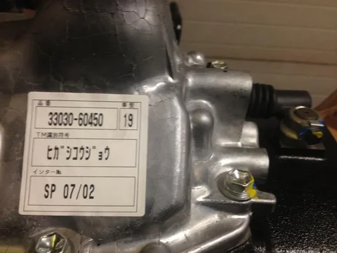

The new H55f from Beno

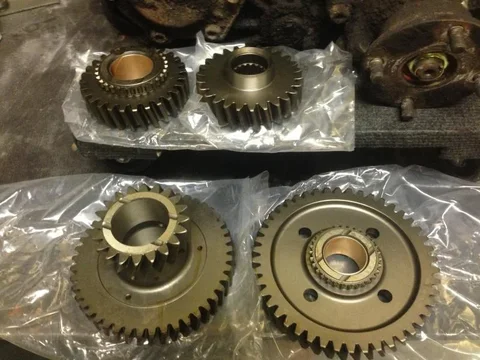

The gears.
The Locker

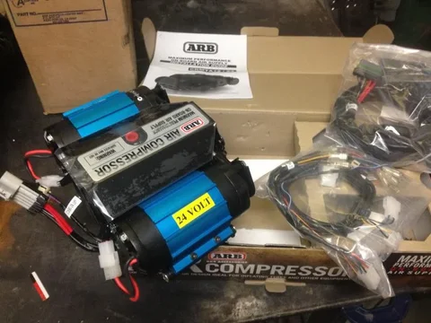

The twin 24V compressor.

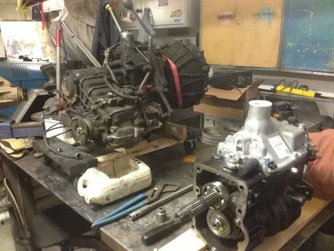

The high mileage donor. This will supply the input shaft and bell housing as well as the cases and a few internal transfer case parts.

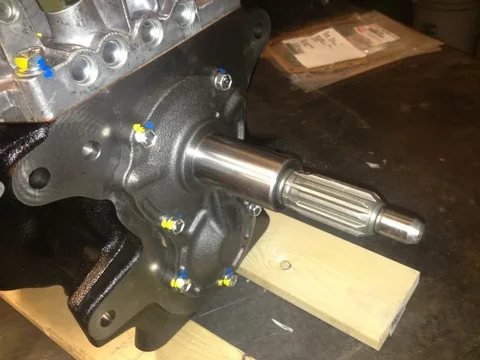

The wrong input shaft

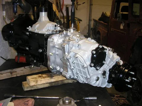

What part am I using off of this assembly. This is from my 45 project. P1010025_18.webp
Thanks Sarge
Damn! First guy to guess got it.
I don't want to cut the 42 transmission cover so I'll use the top plate off of the setup I made for the 45. I may end up making a custom cover anyway because the transfer case shifters are going to move but I'll swap top plates anyway. If the stock transfer shift lever won't line up I will throw on the twin stick setup I got from Georg. May as well if I have to make a cover anyway.
I paid $2089.00 US for the tranny three weeks ago. Call Beno. Canadian dealers want $3800.

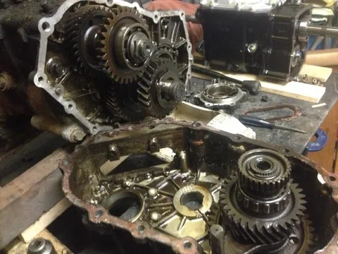

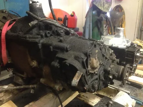

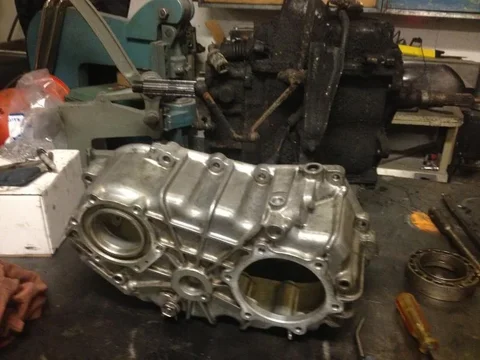

The other day I decided I had better get busy so I started to dismantle the t-case. The back case half need to be clearanced for the larger diameter gears. I have access to a machine shop through work so I will get them to mill down the case.

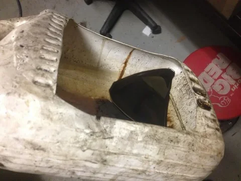

Not a lot of oil in there :eek:

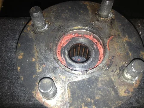

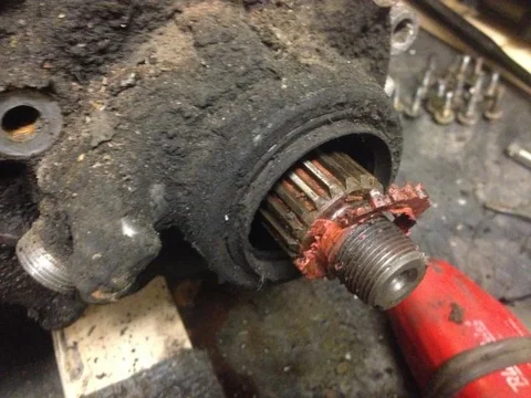

And interesting sealing technique on the rear output splines.

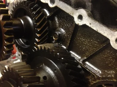

All of the teeth are still there at least. Though I don't really care with all new gears going in.

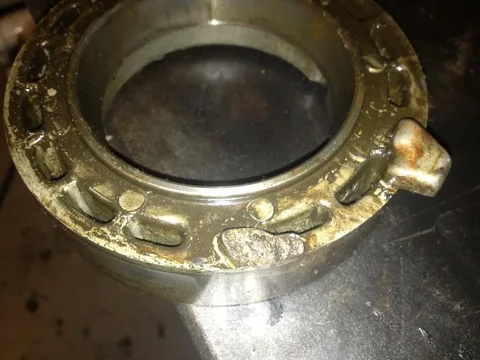

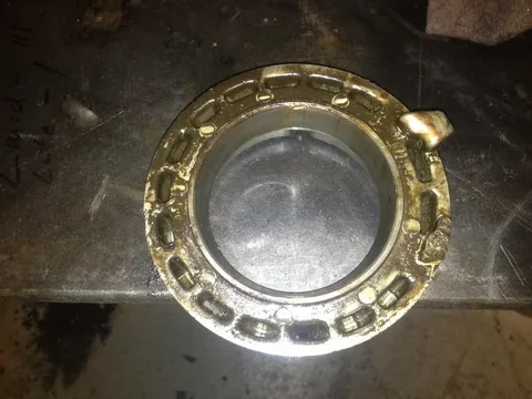

Someone in the past got a little rough on the bearing holder.
Rear case cleaned and ready for the machine shop

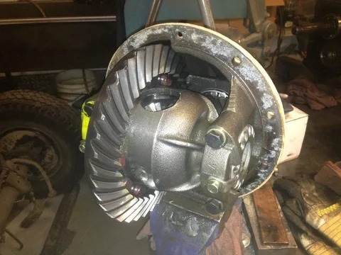

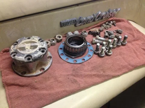

Then I got the jack stands out and pulled the shafts out to start on the ARB install.
After all the work involved to get the diff on the bench I decided it was stoopid not to replace the gears too. So I called Bryce at Cruiser Outfitters and got him to send me a set of 4.11's. These likely have 200k on them and have almost 0.025" of backlash. So the locker install is on hold until the gears get here.

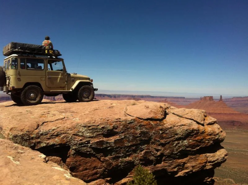

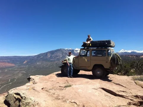

winning pic right there :cheers:
you are likely familiar with that spot but for those that aren't it is the lunch break spot at the end of the Porcupine Rim trail in Moab.
Notice the acreages down in the valley... that's a straight vertical drop.
The view 90º to the right.
