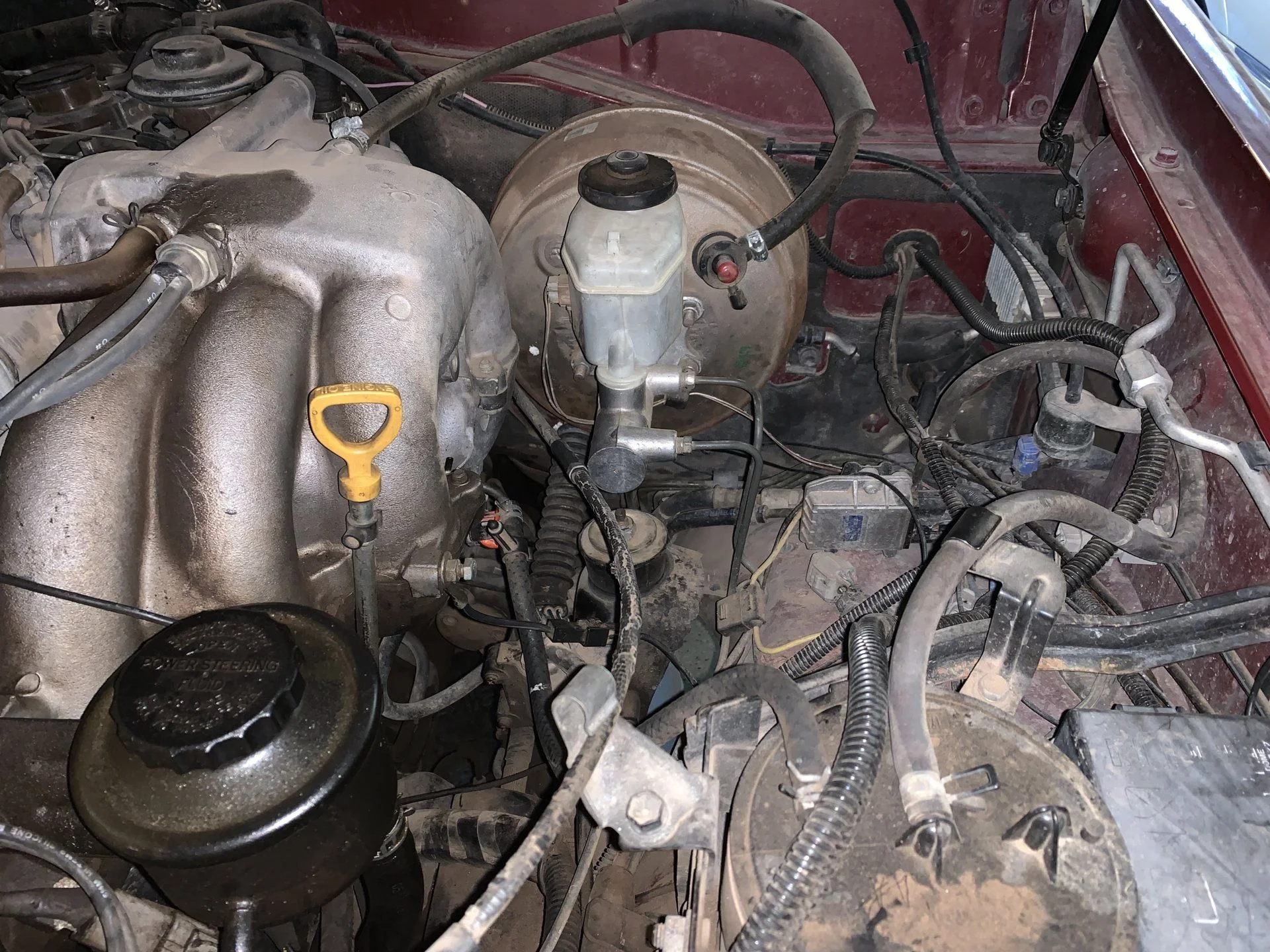

A picture of your Driver Side fender would show your ABS module ( if it was installed.) maybe it's installed, but just disabled.

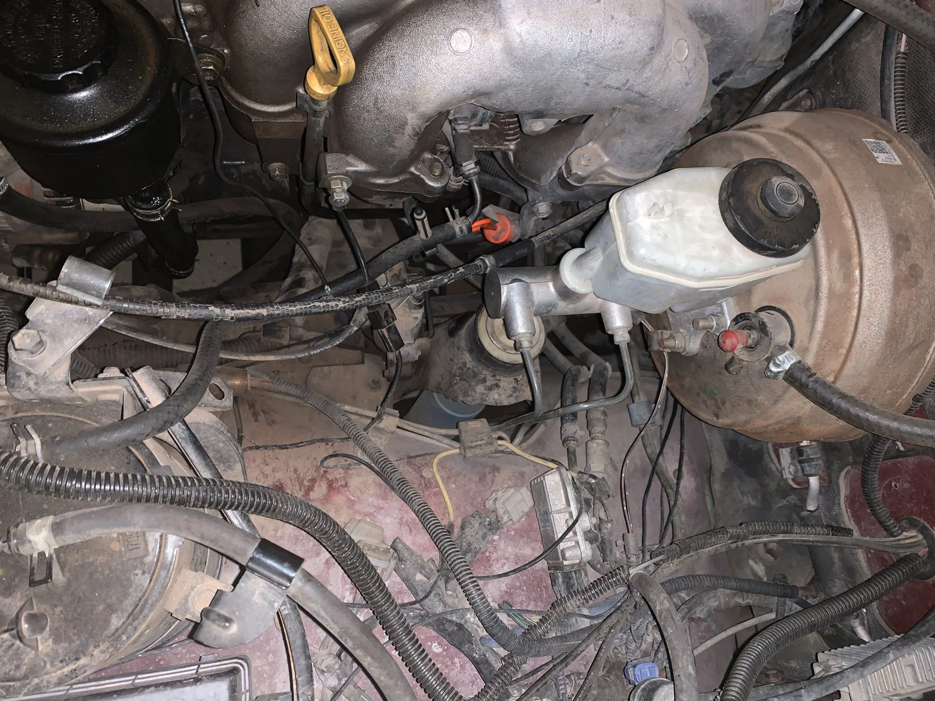

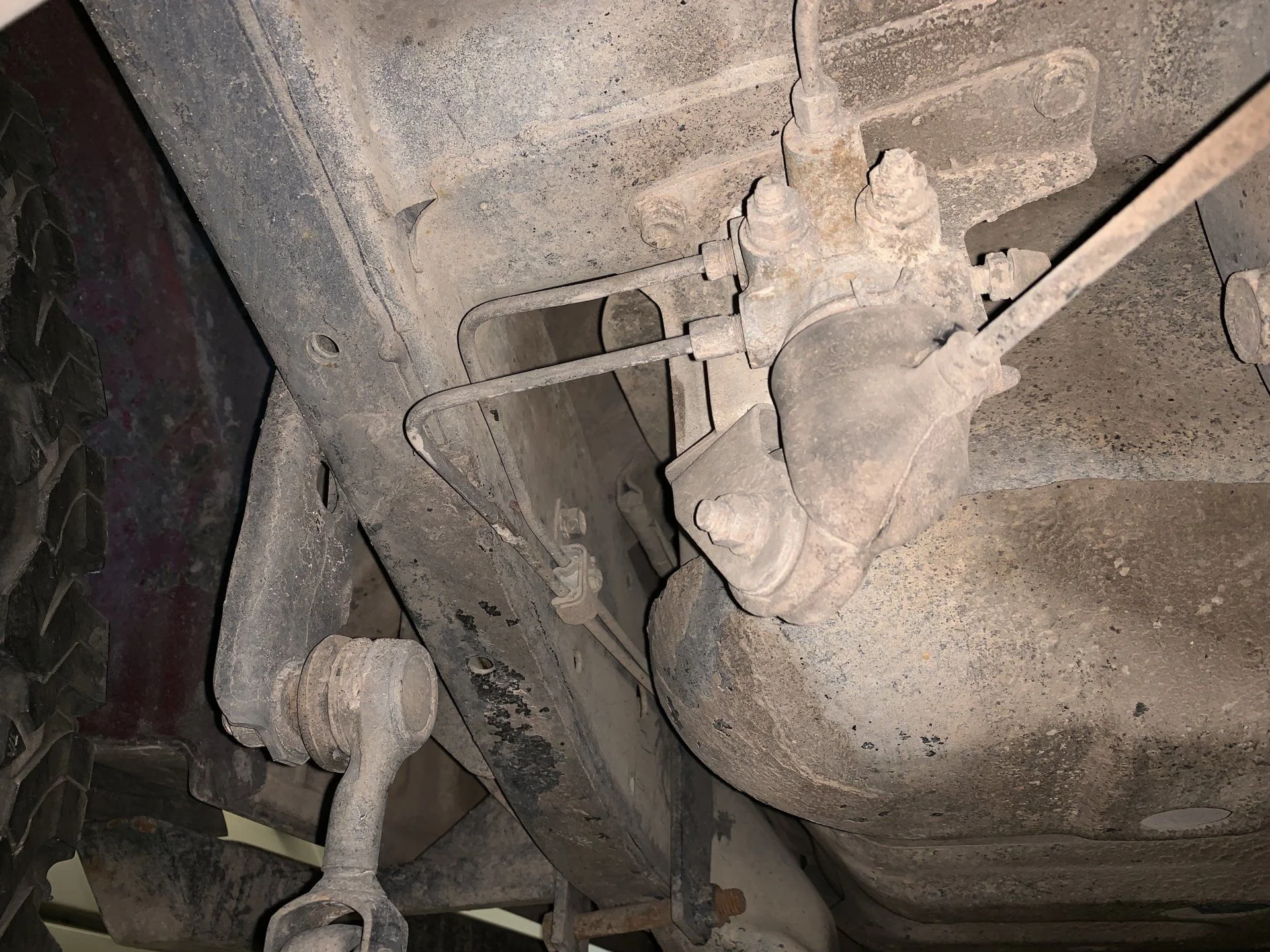

Here are some photos of under the hood.
I am taking it the last picture is the LSPV?
Your second picture would have been a great shot of your ABS, if it were installed. :(
I am taking it the last picture is the VSPV?
i think your best bet is to play around with your LSPV. start by adjusting the end of the rod ( attached to the frame near your spare tire mount) all the way up, then all the way down. Hopefully you can feel a difference in the braking between the two settings. the LSPV itself can be slid up and down on it's mount for further adjustment, but those bolts are usually a PITA, be patient with them.

Try adjusting the LSPV (the gizmo in your last picture) by lowering the gizmo or raising the arm that is attached to the axle. Many of us have removed the LSPV alltogether or disabled it by cutting the arm and fixing it in the "all the way up" position. AKA the LCP adjustment method Lspv optimal height
I'm not an 80 owner... but to my eye that brake booster doesn't have a Toyota look/shape/color to it (not to mention the clamps on the vacuum line feeding it). Replacement unit that doesn't match specs with the rest of the system? Maybe the brakes are over-boosted and lack finesse in the pedal?
booster looks OK to me. May be aftermarket replacement, but many of us are running them without any problems. Booster problems would affect pedal pressure, not braking differences between different tires.
Booster is from Autozone, 2nd one, didn't get any power assist from the first one. Have taken the Cruiser to BrakePlus and had a flush also. So I will try and play around with adjusting the LSVP, worse comes to worse, I will take it to Camelback Toyota before selling it.
Adjusted the LSVP all the way to the top and hit the brakes pretty hard today without lockup, but wasn't a panic stop, will have to try that on non-busy street within the next day or two.
Update, adjusted LSVP all the way to the top, also replaced front pads with medium grade Autozone pads and so far have not been able to lock up brakes. Still doesn't stop on a dime (which these never do) but does stop without skidding. Feeling a little better at this point. Will continue to play around to dial everything in right.
