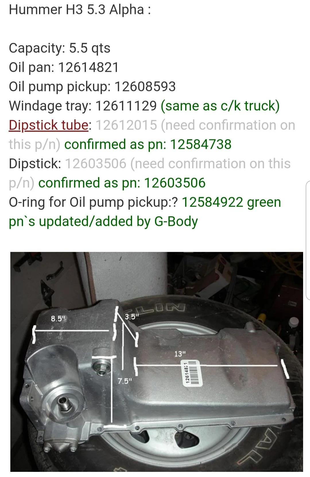

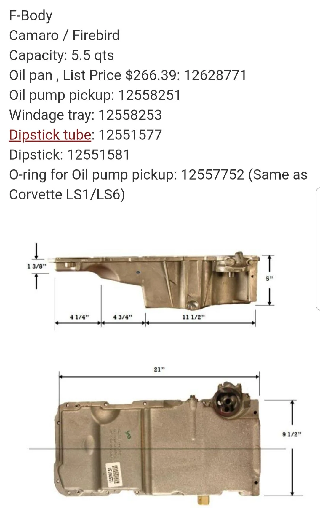

Oil Pan:
Get Chevrolet Performance 19212593 "Muscle Car" pan kit. It's a new pan, gasket, dipstick tube, bolts, everything. If you shop around you should be able to get it for about $200 to your door. It works great.

The GM "muscle car oil pan" is literally just the factory oil pan used on the H3 Alpha. Here are it's dimensions:
Here is the F-body pan's dimensions and the part numbers for all it's peripherals:

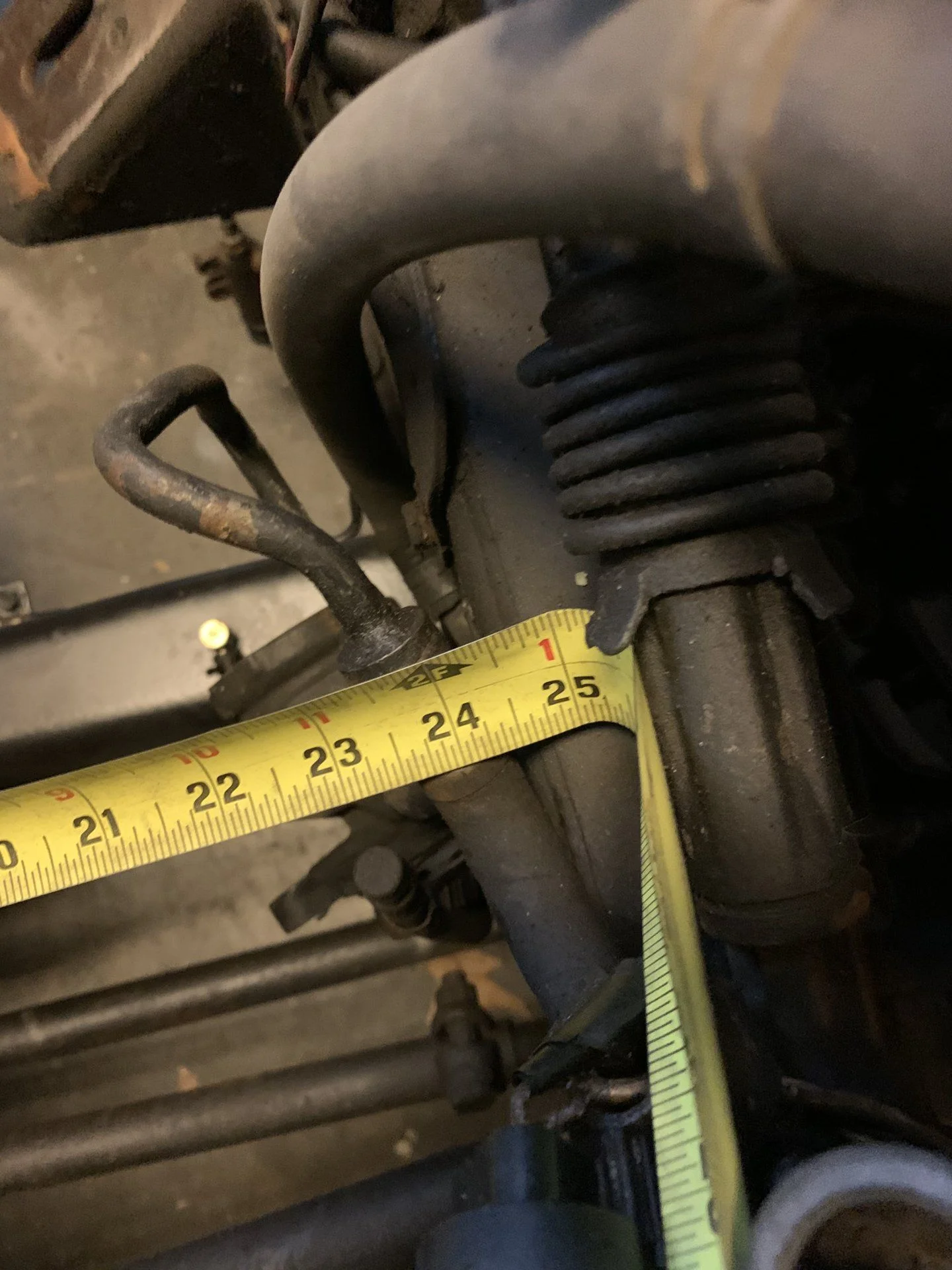

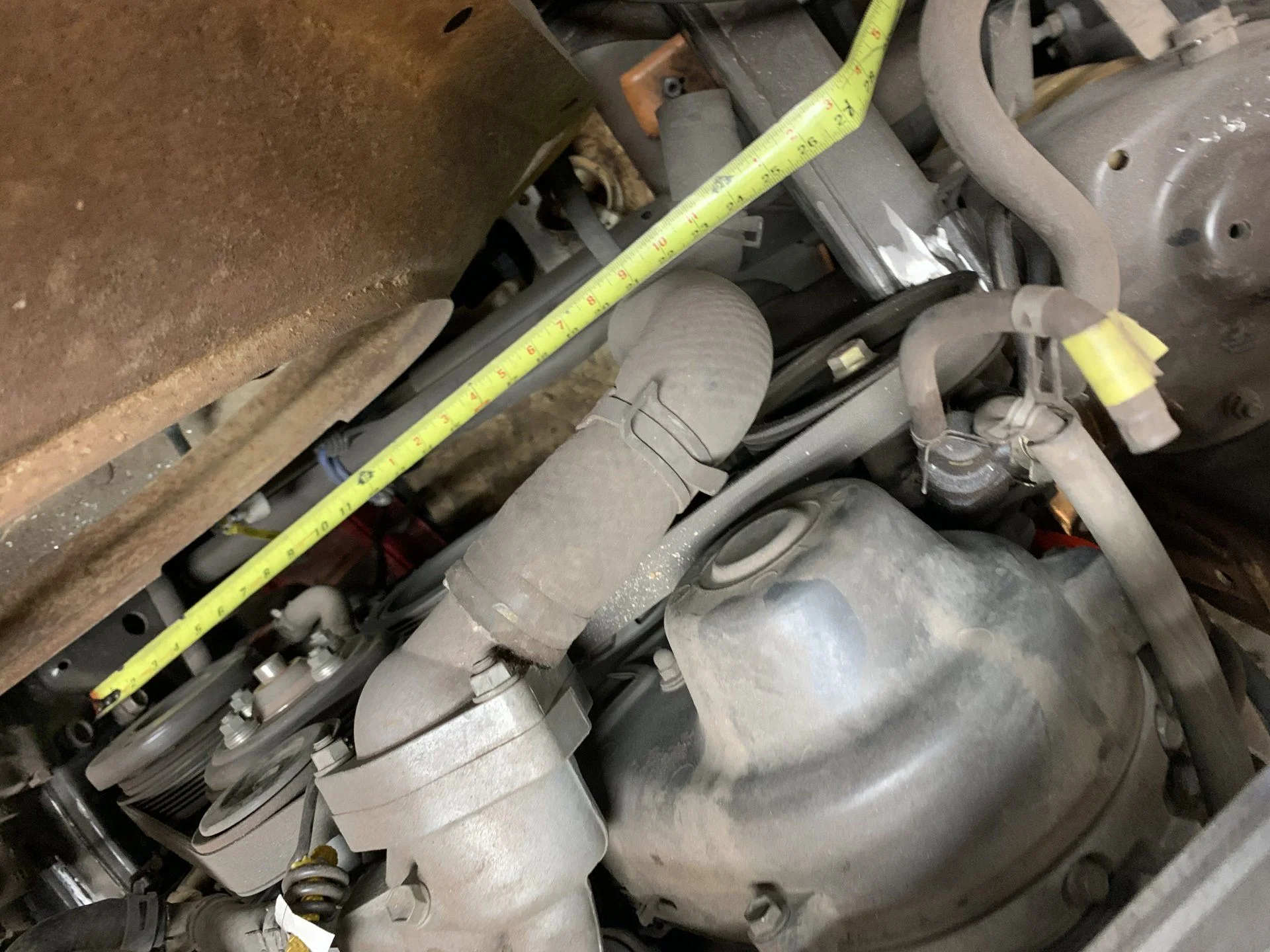

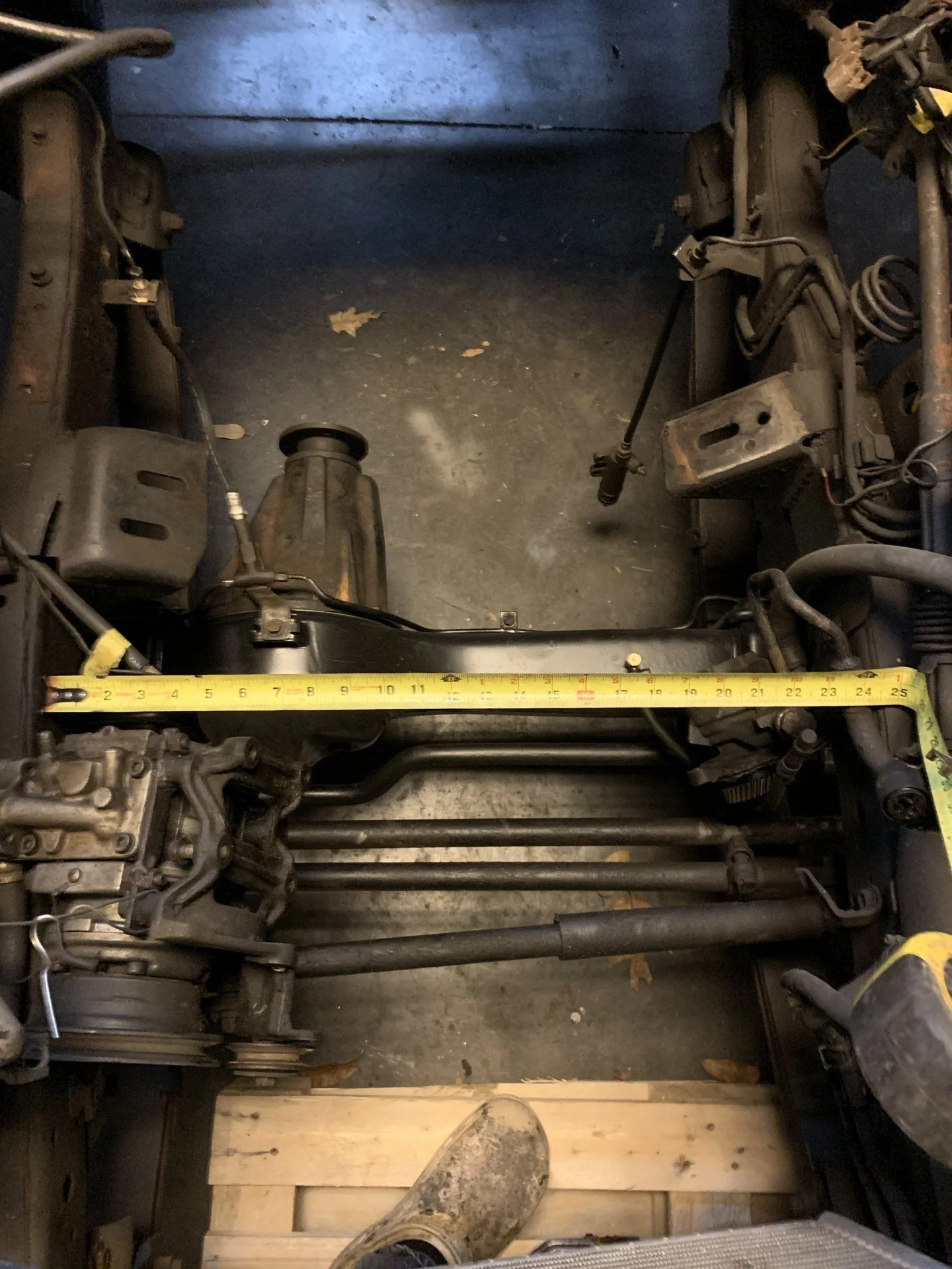

I'm very interested in what the width of your frame rails are. If they are any closer than the 80 series, the AC compressor is definitely going to be an issue in the stock mounting location. Of course you can have it sit just above the frame rail, but then you run into hood clearance issues with truck intake. The Trailblazer SS intake does sit a little lower than the traditional "truck" intake also, so that's another plus for it. The TBSS engine cover is a bit of a clusterfuck though. Vanity I know, but these non-car intakes are so friggin hideous when bare.

The frame is 1 inch narrower than an 80 Series.
This is an80 with 2UZ in there
I think you’ll be fine. I have ample clearance between the AC compressor and frame rail on my 60 and a 60 frame is about the same width as an 80 frame up front.
If for some reason you do run into an issue there are a plethora of aftermarket relocation bracket options.

Trying to track down this GM muscle car oil pan. That part number for the alpha is not easy to get. do you have a place you get parts from, or what else should I search for?

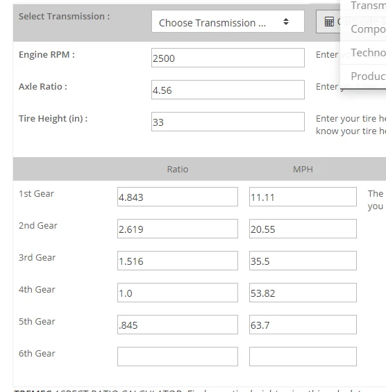

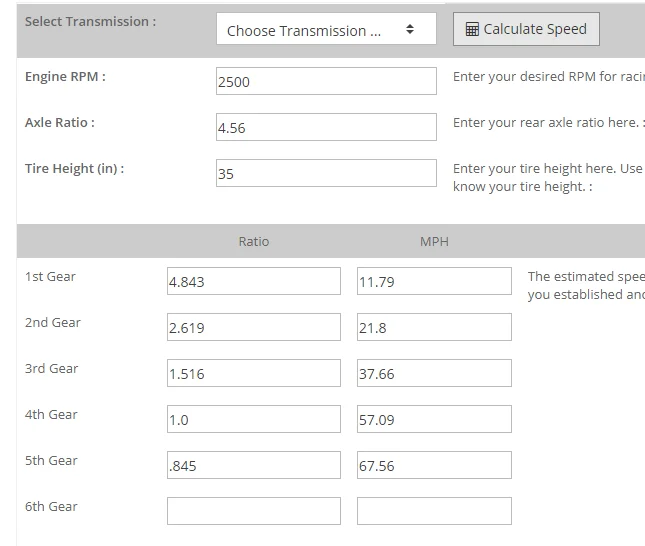

second project is to figure out how this car will travel at highway speeds.
So, gear ratio in rear is 4.56
Found this for the h55f - I don't find anything saying that the diesel had different gear ratio than the gas engine... so these are assumed correct.
Here is what the calculator pumped out at 2500 rpm
With 33" tires.
With 35" tires,
Thoughts?
