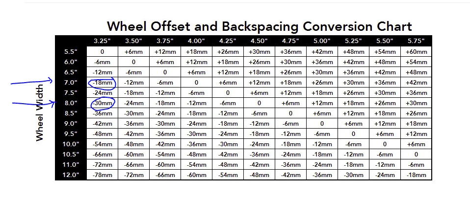

I keep getting more questions that I am unsure the answers for. 3.25 " backspacing vs. offset.
Is this accurate that a 16x8 would be a -30mm offset and a 16x7 would be a -18mm offset to be a 3.25 backspacing?
Those numbers are essentially correct. It will depend on the given wheel's actual flange width. It took me a very long time to wrap my head around backspace and offset.
Wheel width is stated as "bead-to-bead" meaning this is how far apart the tire bead contact surfaces are. The wheel outer edges are usually one inch wider than the bead width. This means that an 8 inch wide wheel is actually 9 inches wide.
Offset is the relationship of the wheel mounting surface to the over-all width of the wheel. For example an 8 inch wide wheel with zero offset means that the mounting plane is dead center. This wheel would have 4.5 inches of backspace because that is 1/2 of 9 inches. This same width with 3.25 inches of backspace would have 1.25 inches or 31.75 mm negative offset. It could be that the flange-to-flange thickness on the wheel in the chart is 7/8 of an inch wider than the bead-to-bead, or they are rounding the offset.
