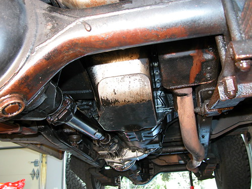

After 3 weeks of driving I really needed to get the oil leaks fixed. It was making a mess of our driveway, and my wife was getting annoyed. So I parked her in the garage, jacked her up, and went at it. Even though I had cleaned the underside, it was already a mess of oil again. I could tell it was leaking from at least
- The oil pan
- The rear diff cover
- The front diff cover
- And probably the t-case/e-brake
My plan was to take care of the oil pan first, drive it some more and see if I could pin down where else it was leaking. I had ordered a new gasket from SOR and I figured it would take me a few hours...

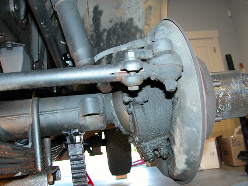

After pulling the front wheels (not strictly necessary, but I knew it would give me more light) I noted my knuckles were seeping a bit, particularly on the left side. No biggie, but noted for future reference...

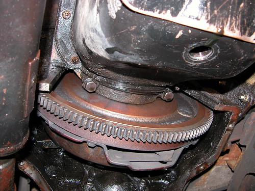

I also discovered that to take the oil pan off I had to take the clutch cover off. So that's what a clutch looks like.;)
Note to noobs draining oil: Buy a large oil catcher and several 5 gallon plastic pails with lids (Home Depot) and lots and lots of paper shop towels. You will spill oil and cleaning it up with rags will not endear you to your spouse.

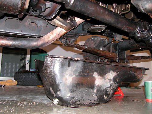

I then removed all of the bolts holding the pan in place and pulled on it, kinda expecting it to just drop down. No joy. It was not coming off easily.
After consulting with Mud (thank you Poser) I went at the gasket hard with a broad flat screwdriver and crowbar. I was initially careful about not bending the pan, but then I realized I was going to dump the pan anyway and replace it given the general feeling that the spot welds for the skid plate give up over time. I had no way of knowing whether my pan was really leaking through these welds, but better safe than sorry...
Once I got penetration in between the gasket and the pan, I was able to wedge the pan free and it came out nicely.
Below you can see the cork gasket. It's pretty obvious where oil was seeping under it and where it wasn't.
What isn't obvious from this picture is how stuck the gasket was to the block...

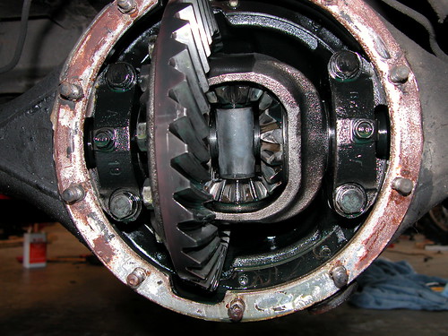

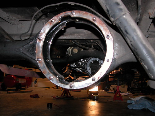

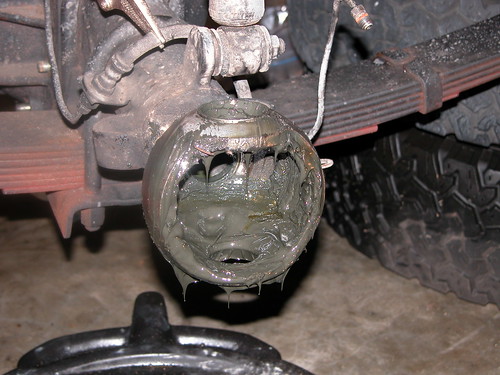

So while taking a break from the gasket...I knew the rear diff was leaking from both gaskets (pretty badly) and the front was leaking just a bit. I figured...dive in. So I pulled the rear diff cover after draining the oil.

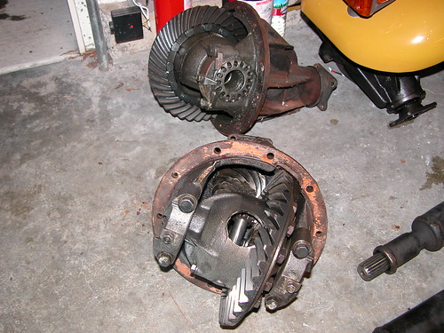

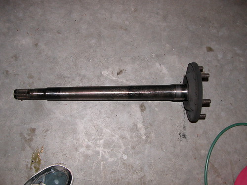

This is when I realized I needed to remove the rear axles to remove the 3rd member (and I also learned that it's called a 3rd member because the crankcase is 1st and the tranny is 2nd). Getting the rear axles off was a snap.
Getting the 3rd member off was easy too. The FSM was clear and somewhere on Mud I read that a few rubber mallet whacks on the 3rd member would knock it loose. I had also read that it was darn heavy and to be prepared for that. I'm glad I read that.;)

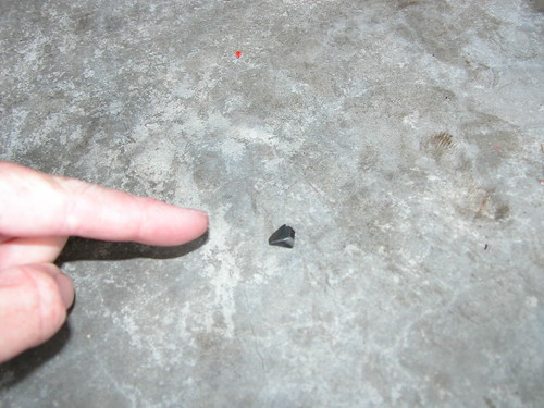

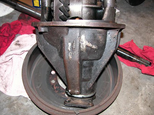

Some of you have already seen my thread on this, but to summarize:
  • One of the side gears had a massive chip missing from a tooth. I found this tooth in the bottom of the axle casing.:crybaby:
  • The 3rd member cover had been welded and the crack through to the inside was deep.
The 3rd member really needs to be replaced. I also figured out at this point that replacing the front diff seal would require removing the front axles...this would require removing the front hubs and knucles. Wow.
This put me at a key decision point: Patch it back together with just a new side gear, ignore the weld in the 3rd, ignore the front diff leak, and be back on the road in a few days. OR, go big and fix it all.

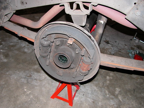

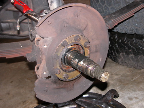

Hub Tear Down

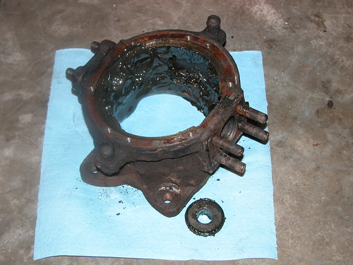

I was pretty nervous about tearing down my front hubs and knuckles. The FSM used lots of terms I didn't know and there were sooo many parts. Bull pushed me over the edge by starting me on the left one and I completed it and the right one on my own.
Hub and disc brakes off:
One of the hubs. Mechanically these look fairly sound, but they are pretty beat up. I tried a wire wheel to clean them up and they look somewhat better, but will still look like crap inside of my shiny new hubcaps. So I'm replacing them with new ones. These are for sale.

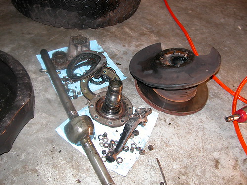

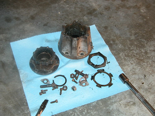

Components out of the right one. I've since cleaned everything up ('cept the bearings, bolts & gaskets which will be replaced). Quite a few studs both on the knuckle and the hubs were stripped or otherwise beat up, so I'm replacing them as well.
Knuckle housing. Getting the bearings out was tough without the SST. I knew I was replacing them, so I used a bit of brute force. Yes, I tagged the spacers per the FSM....

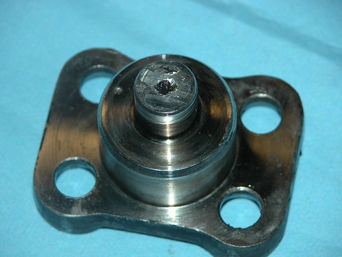

One of the bottom knuckle plates looks pretty worn where it fits inside the bearing. I think I should replace it. Thoughts?

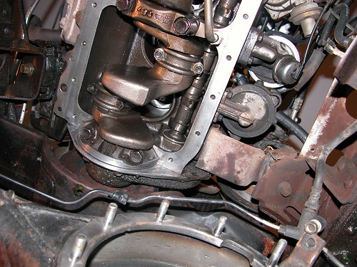

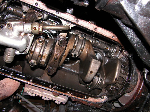

Oil Pan Gasket Off!

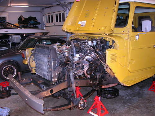

I finally got the damn oil pan gasket off last night. Having the front 3rd member removed made accessing the arched portion at the front of the motor easier. I used acetone, a screw driver, a razor blade, a gasket scraper, a wire wheel on my drill, and a ton of elbow grease. I do not think I could get the mating surface any cleaner.
I feel like I really accomplished something:flipoff2:

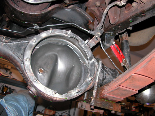

I also cleaned the faces where the 3rd members attach.

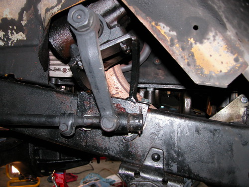

It was fun taking the fender off. I can see how people tear these rigs apart so quickly...once you start...

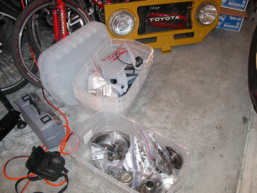

And I've got most parts tagged and bagged.
That's all for tonight...

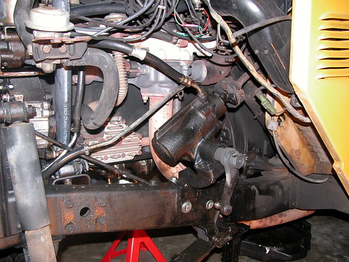

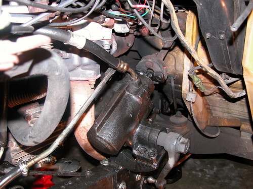

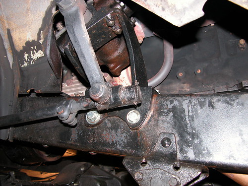

Just noticed the CCOT PS add-on.
I tried to buy their pump mount brackets for my '78, but they said no dice...
Do you mind posting some pics of the PS pump mount? As you probably know, we missed being able to have factory PS by one year!
Here you go. Plus a bonus shot proving that this is a family activity (that's my 10 year old son CJ) or at least indentured servitude.

That ps is the mini truck install, really easy for those of you who are watching, and iron pig off road has nice brackets. So much for another of ccot's "exclusive" items....sheesh. Nice truck, for sure.
