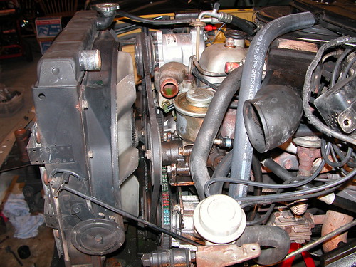

Here's the best shot I have. I will see if I can take some more tonight.
A few observations. You really dove into this project fast for never having turned a wrench beyond changing your Porsche's oil. :beer:
It looks like you have a massive exhaust leak somewhere based on how much carbon is all over the drivers side of your engine, firewall etc. Since you are into it this far you will probably want to track that down. Also somewhat exhaust related, the fuel leak you plugged due to the juryrigged previous owner fix on your carb is supposed to be the fuel return to the tank. If you are not going to hookup a return line make sure your fix will hold. If it fails again and leaks onto your exhaust manifold... poof.

PO had the manifolds taken off and machined last year. In addition, it WAS leaking gas on the manifolds and I think that contributed to the carbon build up.
I don't think I still have the problem, but I will monitor it.

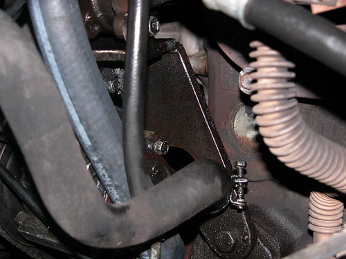

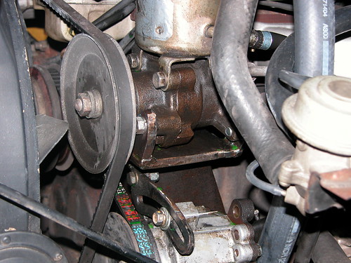

It is the pump bracket CCOT sells or used to sell. I cannot find it on their site again. I will confirm the next time I'm breaking stuff on TEQ's cruiser.
Here, I think this is the piece CCOT used - wanting TEQ to verify w/ pics...

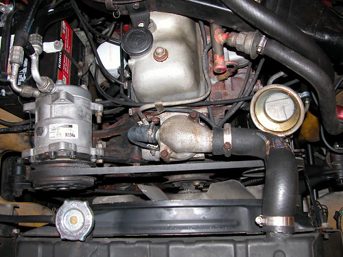

Off the subject a little, But is the Oil cooler missing?
Wow, you are right. I didn't even know there was an oil cooler. I guess I did notice a oil line running along the passengers side of the valve cover in other rigs, but I figured it was a year-year thing.
Is this a Bad thing? Or a non-issue? Would CCOT have taken it off when they installed the A/C?

Mine is a 12/78 CA model and it has the cooler. Thought maybe it was a CA thing but I've seen it on federal models too. Maybe it was a mid-year add on.

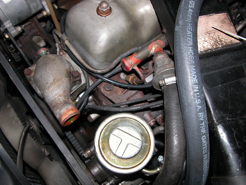

Did some digging around on the oil cooler thing...
The thingy that the water hose goes into in the middle of this picture is called the waterhouse (according to SOR).
The waterhouse top comes in two versions:
054-16B TOP WATERHOUSE-1968-1/79 NO OIL COOLER
054-16C TOP WATERHOUSE-8/76-1/79 W/OIL COOLER
So clearly Toyota made some rigs with an oil cooler and some without. I am guessing it was an option.
FWIW, This diagram shows the components that make up the oil cooler. And this page shows that there are two different oil filter assemblies (one for oil cooler equipped rigs and one for not).
