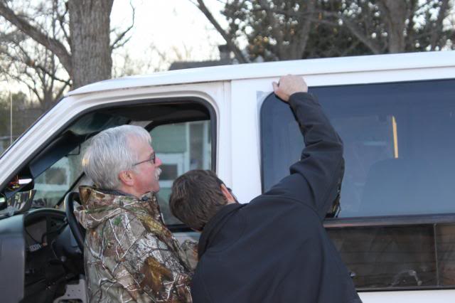

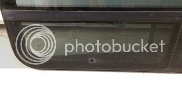

The window I ordered off eBay for just behind the driver. It looks nice, I tried to get a general idea of where it will placed. Hope to get it in in the next few weeks, definitely want to have some help. I could do it but want to have a second opinion and set of hands.
I will need to lower it at least 1.5" from where I placed the template, the window is ~ 1" wider on each side from the template, I wish it was ~ 2-3" shorter, but it will work, especially for $85 shipped from California and its new (Open Box).

Had some time Friday and Saturday to work on the van. Decided to forgo getting it running since my stepdad was around and could help with the window install. No way I could have completed it alone and it was good to have some support when you put a saw blade on the body.
Since the window I purchased was an open box I was missing 2 things.
1. Screws - No problem I went to the hardware store and picked up some hex headed self tapping screws.
2. Template - This one was a little more tricky, I made my own to one dimension but knew I would have to trim a little more in order for the window to sit down into the hole as there was a lip around that portion.
Laid it out inside and drilled through in 3 places to get it close on the outside. Then pulled out the jigsaw....
No turning back....
There's a hole in my van!
Testfit, trim, testfit, trim.....why didn't I spen an extra $300 for a template and screws????
Finally got the hole where I needed it, did I mention trimming the inner panels ended up being rough, used a grinder, not the best tool, but it worked and only coated everything with metal dust. As well as put a nice biscuit joint in my right pointer finger knuckle....thankfully it only hit skin, no ligaments or bone.

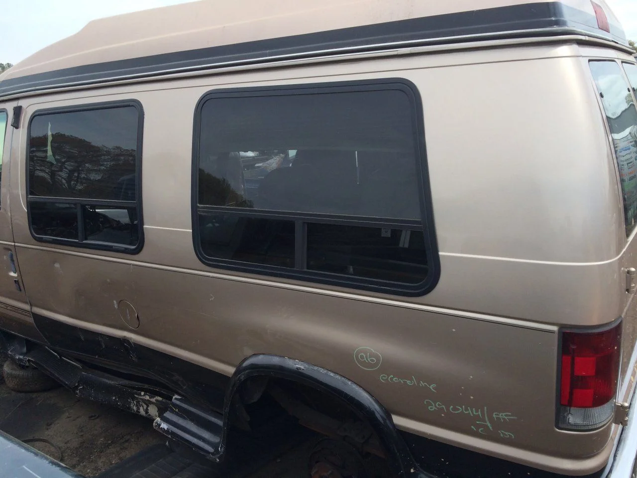

Looks nice. I noticed on the inside it had what looks like cutouts for a smaller window? Do they not have factory windows that fit those cutouts?
Took some balls to make a hole that big. Looks good.
Not exactly, factory windows are made to fill those holes, however they are inset and not just a cutout. Its a process they do at the factory and cannot be easily replicated. It would be much easier to mount a window in that smaller area. Finding nice windows for an affordable price has proven to be a challenge. I hope to put a smaller window in each side further back for the rear seating. Being patient on finding what I need usually works out, just takes me longer to complete everything.
