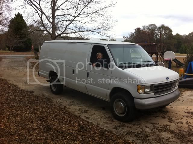

Well this followed me home today:
Thanks to Joel for helping me look it over and provide CL security. :)
From the CL Ad
Once I got home:
Specs:

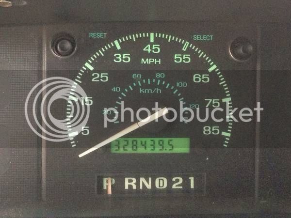

1995 E350 EB 7.3 Powerstroke Diesel 328K miles reman trans, no rust, some damage from being a work van.
Needs... glow plugs(included in sale), vacuum pump or pulley, AC repaired, and fix some of the doorways. Might go ahead and do injectors and valve cover gaskets when I do the glow plugs.
I get home and my wife says, " It looks like we just killed someone and dumped the body" I told her to appreciate the base, the bones of a build up. She then says, " I think its that I can see the bones." I don't think she is liking the cargo concept. I guess I better find some seats and windows quick. Should be fun. Kids and I washed out the back after we unloaded the "free" window a/c unit, dead mouse and all.
I know it doesn't fit everything I was looking for, but the price was right and will leave me enough $ to get everything repaired as well as get the interior done in my budget. I'll try to get some pictures of our "clean" interior in the next few days, definitely not spotless, but much better.

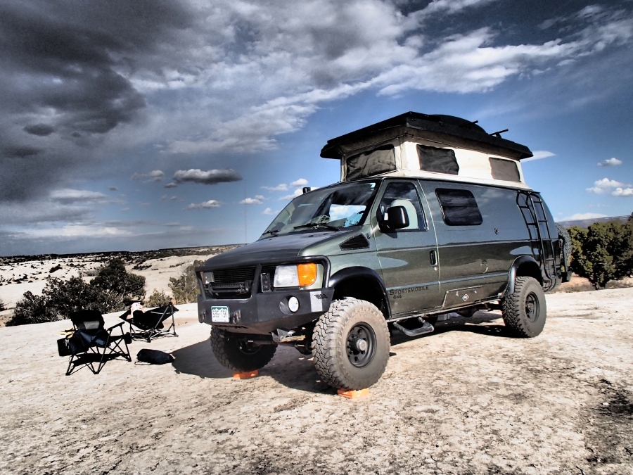

Ujoint offroad woulg be my ultimate dream. Not so sure that the 4wd will happen, but we shall see.
He has pics of some of his builds here: http://www.expeditionportal.com/forum/threads/55074-UJOR-Build-Thread as well as on his web page: http://www.ujointoffroad.com
Wanting to do the interior something like this:
If I can find the Sienna seats cheap enough. If not I'll find some conversion van seats for the time being and run those. Plan is for 4 buckets (2 on each of 2 rows in the back) followed by a bench in the rear that lays into a bed. Leaving ~ 20" or so for luggage in the rear.

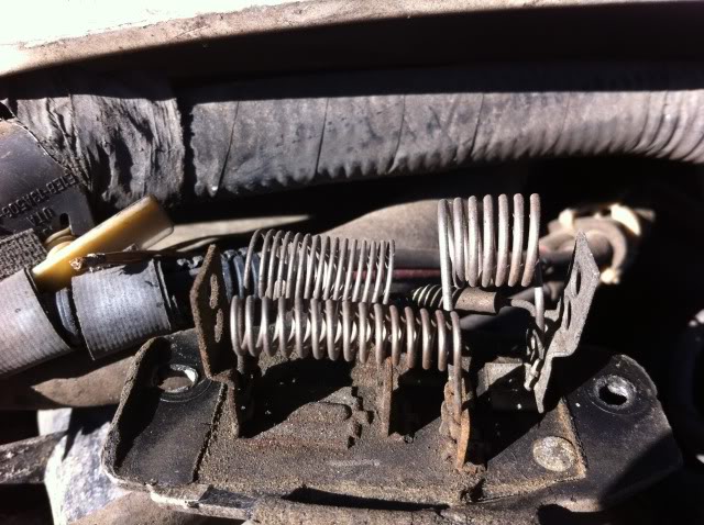

Got the fan relay from the JY installed. I now have 2 speeds. Maybe another or new one would get me all 4 speeds.

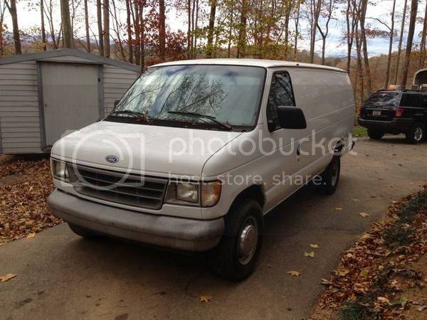

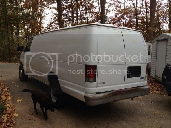

I went back and bought the Parts van last Sunday. Here are a few pictures:
Plans are to swap all doors, bumpers, trailer hitch, seats, and most if not all of the front clip. Still debating on the running boards and the rear body windows. After I get everything pulled I will probably take it to the crusher.
Unfortunately it does not have the 2nd row of seats of rear heat or A/C. SO I will have to keep an eye out for those items.

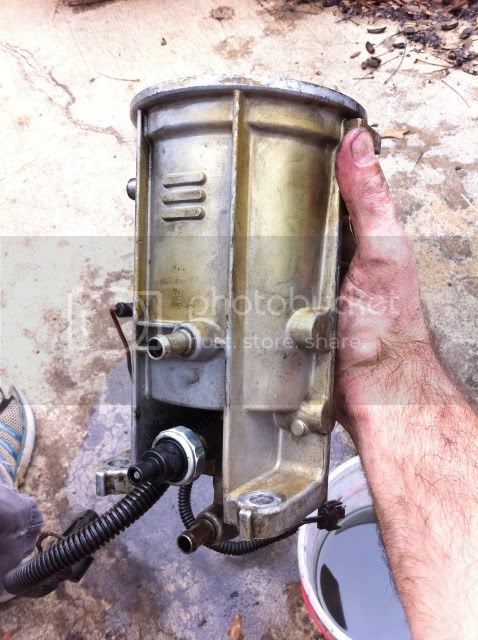

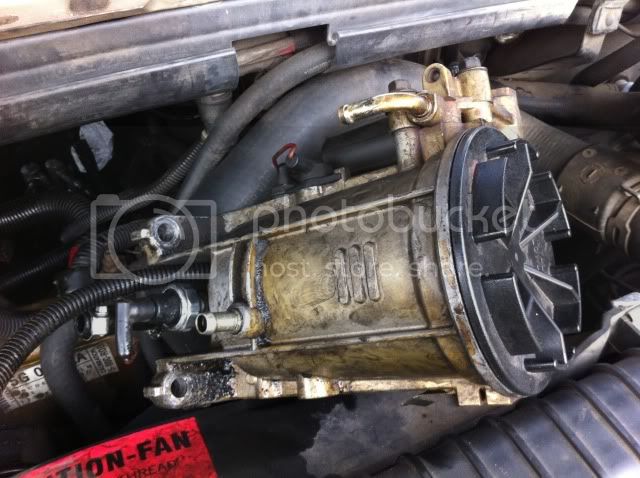

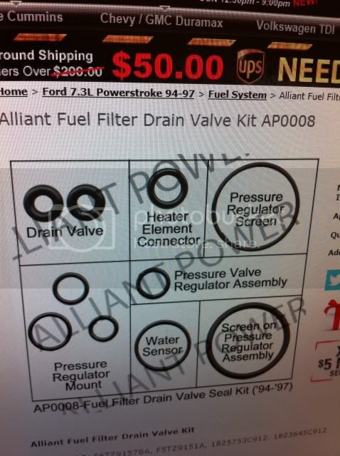

I have been having a few issues with idling and running when I come to a stop (very randomly). So I decided to start troubleshooting it. First step was to change the fuel filter.

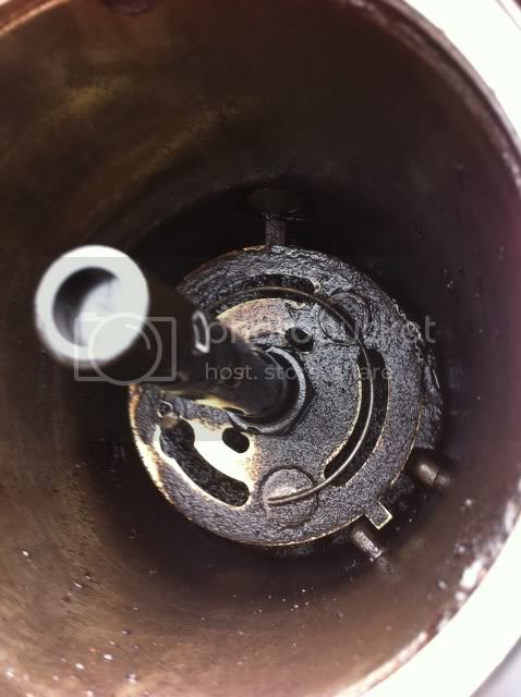

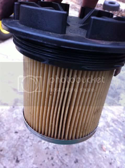

Pulled it I did not think it was too bad, so looked into the fuel bowl.
Yeah it was dirty, so I dug in and pulled the entire fuel bowl.
Rebuild kit:
Cleaned:
Then reasembled. The fuel pressure regulator screen was almost completely clogged, total of probably a teaspoon of crap in the bottom of the bowl.
I accidentally dropped a hose clamp down one of the intake tubes that runs into the head. I hope to get it pulled out today. Worst case senario for it is I have to go ahead and do my valvecover gaskets and glow plugs.
I also ordered a LPOP through Advance Auto, with the coupon code it was $65.
Hope to get it installed soon as well. My oil pressure is a little low at first startup and this is the fix for it as well as some idleing issues. Hoping a combination of these plus pulling my fuel tank and cleaning it will take care of the few issues I have had thus far.
In my order of the rebuild kit I also ordered this:

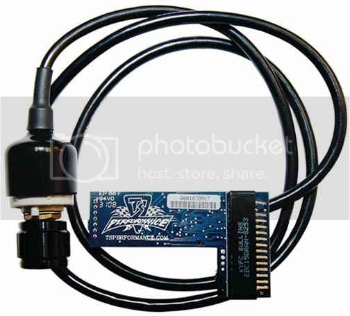

TS 6 position Chip. BF special: $200 shipped with tunes! I got stock, 50, 75, 100hp as well as the security mode. Main reason I bought it is fuel mileage. Reviews looked good so I bit the bullet. I will wait to install after I get everything back together and running well.
Considering how much noise the 7.3 makes and that this is supposed to be a family vehicle I have to do somethign about the db level. I was goign to use some coupon codes for BF and/or cyber Monday but ended up getting a better deal with a guy on eBay who only wanted local pickup. Even with shipping it was cheaper that the discounts.

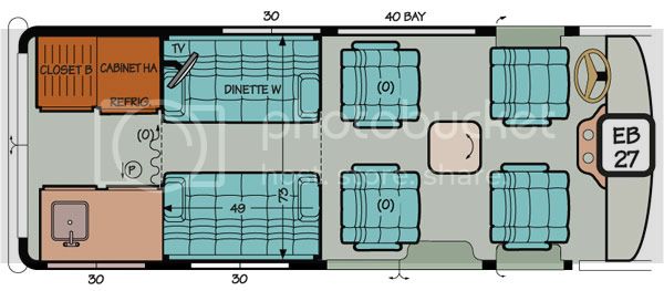

I am rethinking my interior layout. Thinking hard about going with a Sportsmobile EB27 style layout.
http://www.sportsmobile.com/1_eb-27.html
I think it might be a good fit for number of avalible seats while still making it have useful space.

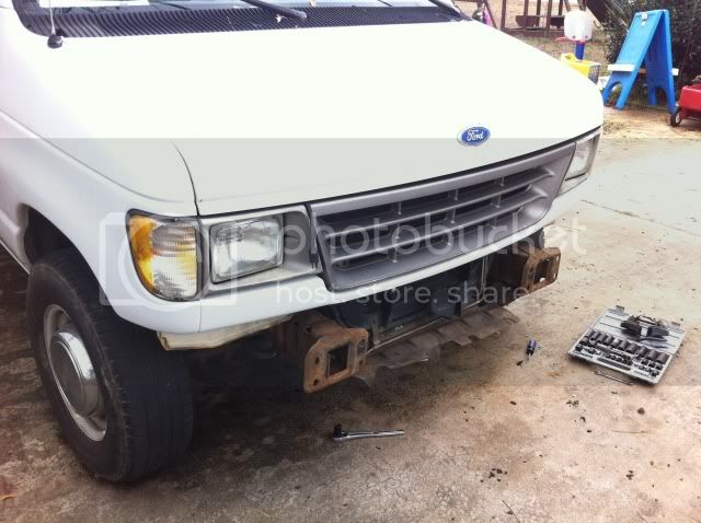

Got a little bit done on Saturday. I didn't feel like being greasy up to my elbows again so I started tackling swapping some parts over from the parts van.
(I'll post some pictures up in a few days.)

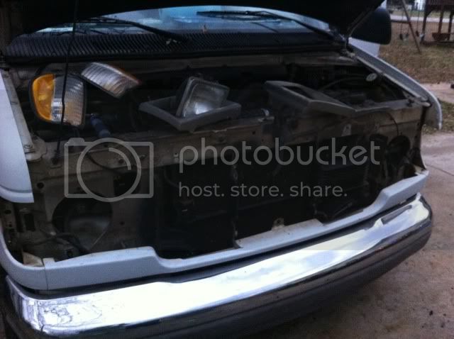

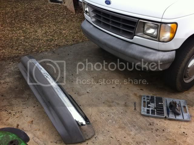

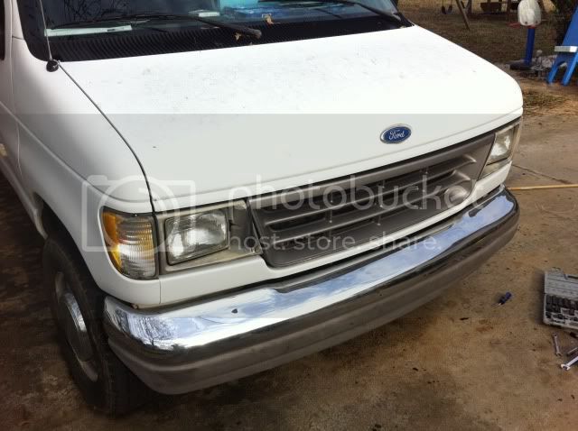

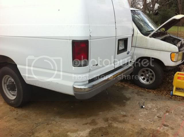

Front and rear bumpers pulled and swapped, Pulled rear hitch, bolt holes did not line up when I tried to swap. Maybe E150-E350 are different?
Headlight panels pulled (Switching from sealed beam to composite beam).
Height difference is not exact with this pic since the driveway is a few inches higher, but its obvious in getting in/out, especially in the rear

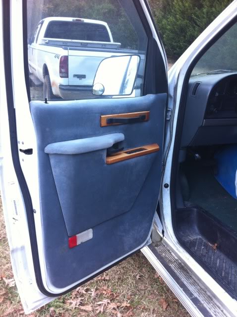

Swapped in the rear floor trim as I didn't have anything back there. My door areas are a little damaged, not sure what I will do there. I do have the parts van so I guess I could cut what I need to fix out and weld it into mine?

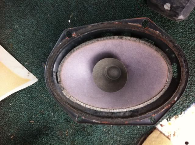

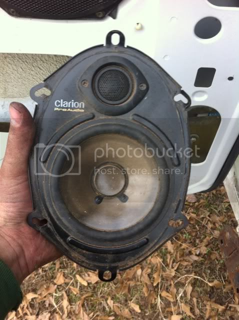

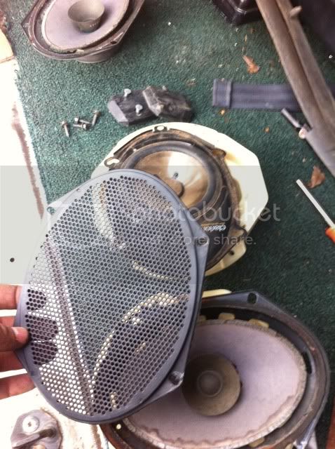

Pulled rear doorpanels, trim and swapped aftermarket speakers (testing fitment). I need to paint the faded plastic window trim at some point and also insulate so I went ahead and pulled everything. I wanted to swap out the rear doors but I figured it would be helpful to have help before I tackled them.
This these are shot?
Not perfect, but I pulled these out of a car at pull a part a few years back. Hoping they will sound decent.
Didn't know if the ford covers would work, but they fit like a glove!
