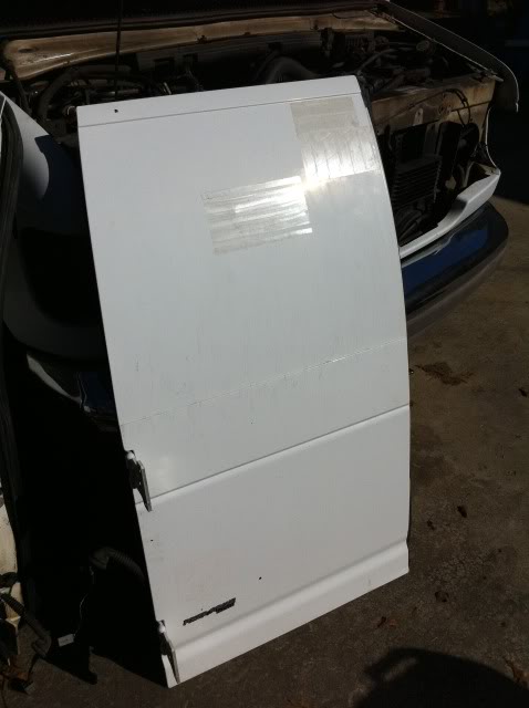

Rear doors swapped:
Had a slight issue with my upper door strike/latch, it was bent from beign a cargo van, had to pull 3rd brake light remove bracket and bend back down with ratchet strap and a hammer.
I have all solid doors for sale, not perfect on inside but outside in decent shape...no rust.

I swapped side doors last week/ this weekend, need to work on alignment, understep was nasty, thought I had already cleaned it with hose, pulled the plastic cover and it was full or crap. I also got the hose clamp out of the intake that I dropped in a month or so back. Never cranked engine, but had to pull turbo and other associated parts to get to it. Need to put everything back together but its been hard when its freezing or raining. Then add in we built a treehouse for the kids ~11'x16' 8' off the ground. Then we got a new puppy over the weekend so I may be slowed even more.

Thanks guys, I live with it. We got the parts van moved yesterday, its just outside of town at a friends place. I was able to get the remainder of the doors swapped yesterday. Actually got my wifes hands greasy. :)

Front doors swapped:
