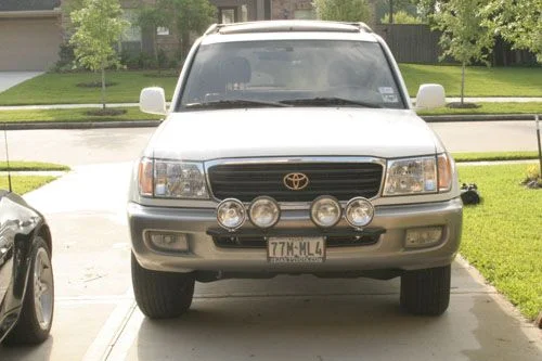

BEFORE
attachment.php

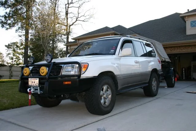

AFTER:
Just about ready to be picked up.

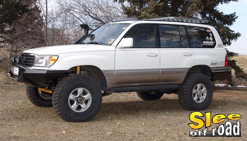

It just looks surreal...since there are only two SAS, more than 2.75" lifted 100's out there.

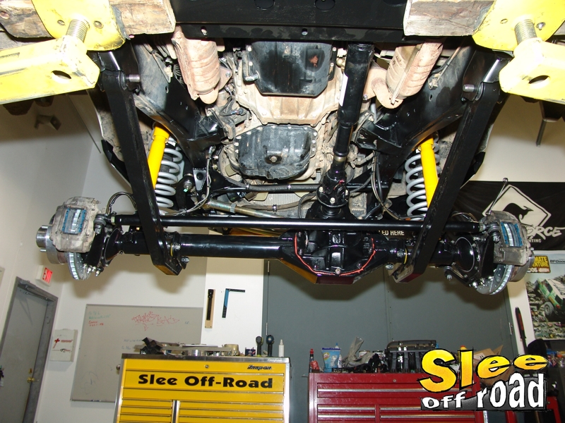

THat Hi9 housing is just incredible. That would eliminate some of the concern with the "Hi8" stock differential.
Are the side gears broached for Toyota splines or is everything including the inner axles custom?
I see wheel spacers. Was that to get the WMS right? Does the axle use 80 series inners or something custom?

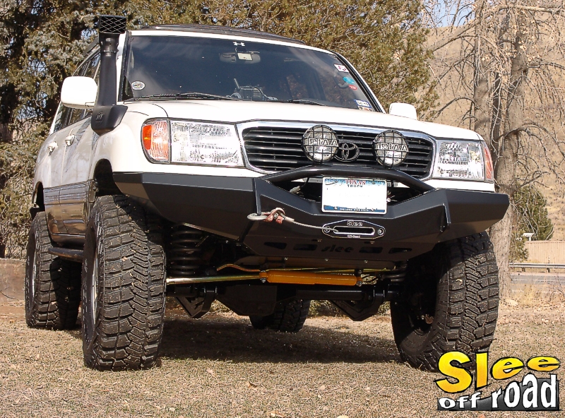

I got to Slee's and pictures do not do it any justice. This is a 100 on serious steroids, its makes a similar set up 80 look just puny. It drives very smooth, not as nice as the IFS, but I would not expect it too either. It does drive like an 80 with more power. I think the gearing needs to be higher than the 4.88, but no one makes one higher. The lack of pep, may be related to the 35 inch tires, or all that extra weight its carrying. But it will still cruise at 75-80 without any problem. Not sure i would want to go any faster than that anyway. Christo and Joe, took care of the little things that made this truck even better, then stock. For example, instead of installing the ARB locker switches, they installed the factor elocker switch from an 80, which makes the interior looks so much cleaner. They also installed a factory fog light switch for my PIAA lights. All of the attention to detail, just pays off.
All I can say is that this rig has far exceeded my expectations, and if you would ask me would I do it again, I would have to say " what took you so long, in the first place" This thing is a beast. I can't wait to take it out on the trail.
