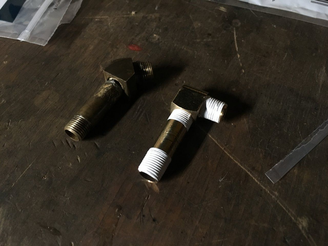

After the changing the valve cover gasket's for a third time and not fixing the leak I dug a little deeper to find the true culprit. Brass plumbing fixtures for the oil pressure sending unit had cracked right at the base of the Coupler
Now to see if the sender still works running at a 90° angle
