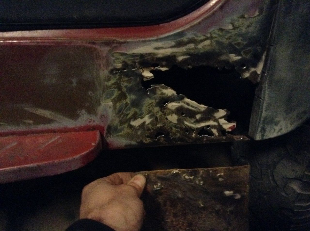

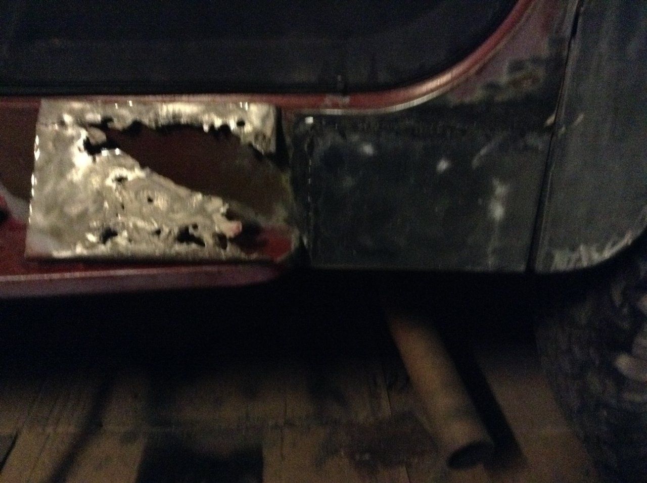

Decided to peak behind the curtain on my DS rocker, to address the bubbling. Much like the quarter panel the PO's hack job rust "repair" only made things worse. Here's the progression and where I'm at, far from done but I felt compelled to show progress since that is a rarity these days.

What I found behind the bondo curtain... The owner seems to consistently weld a plate behind large rust holes that then get covered with thick layers of bondo so the rust can continue un-noticed for yrs to come... Yes that's a hole

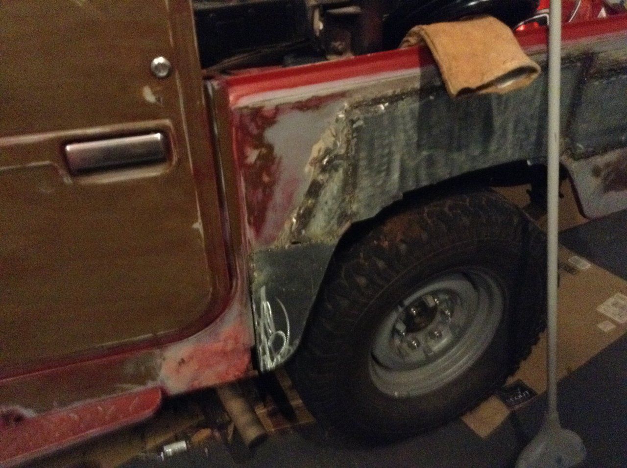

Hers how she sits now (still more to do)... Might need to address the seam, maybe cut and rebend and reweld, or more likely, just shoot in some seam sealer

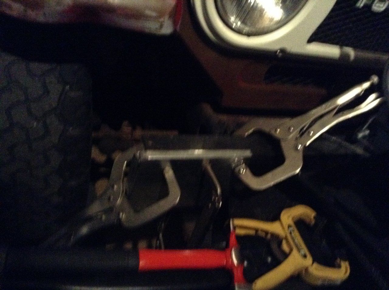

@roadstr6 - good trick with the hammer tap while the tack is still hot!
If anyone was wondering about my metal brake, luckily for me my rig has a custom bumper that has one built in for your ad-hoc trail-side fab repairs
