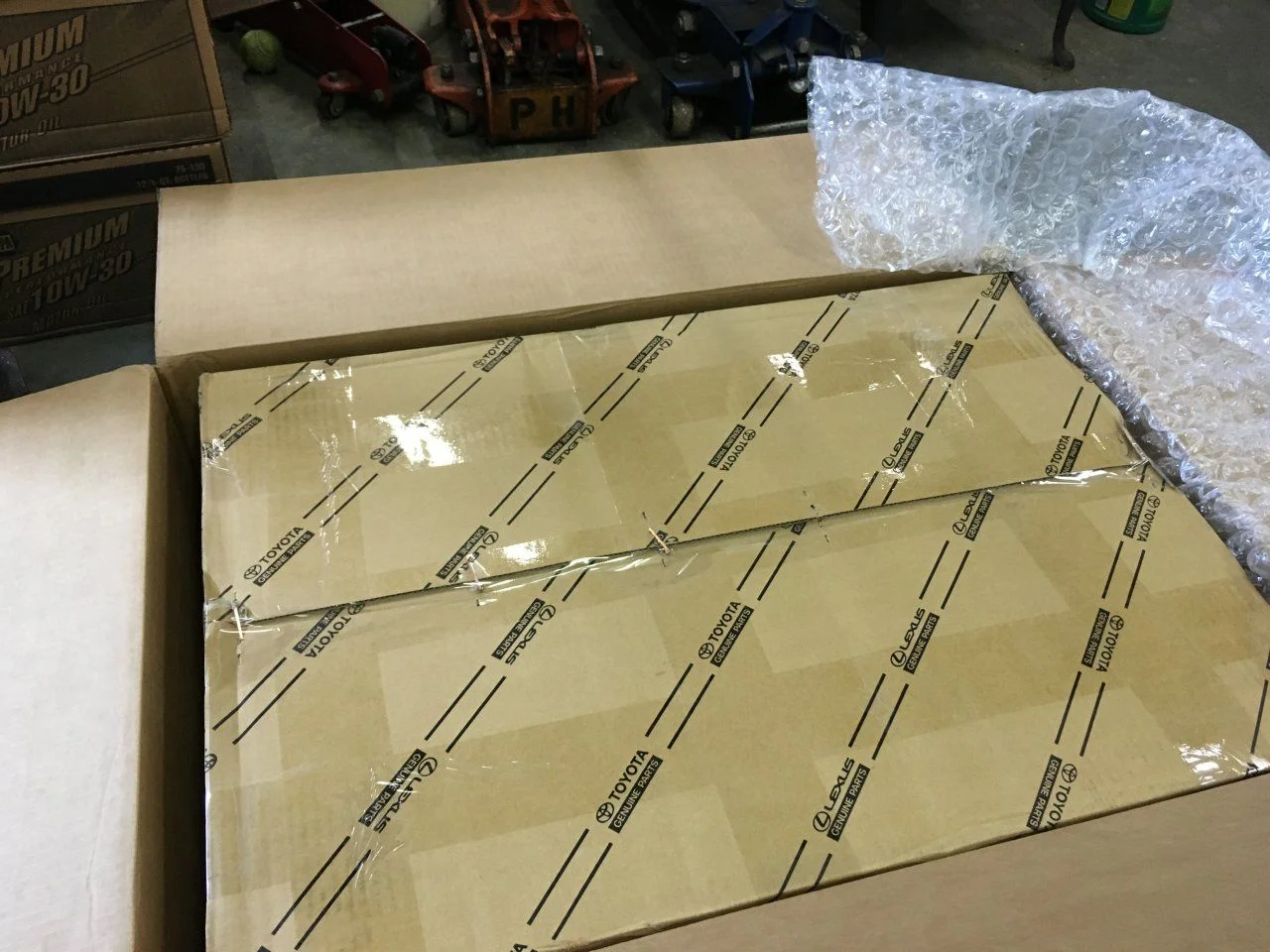

Someone got new belts today ;) It did take longer than 25 min as mud lore predicted but a new radiator and few other items found their way home as well.

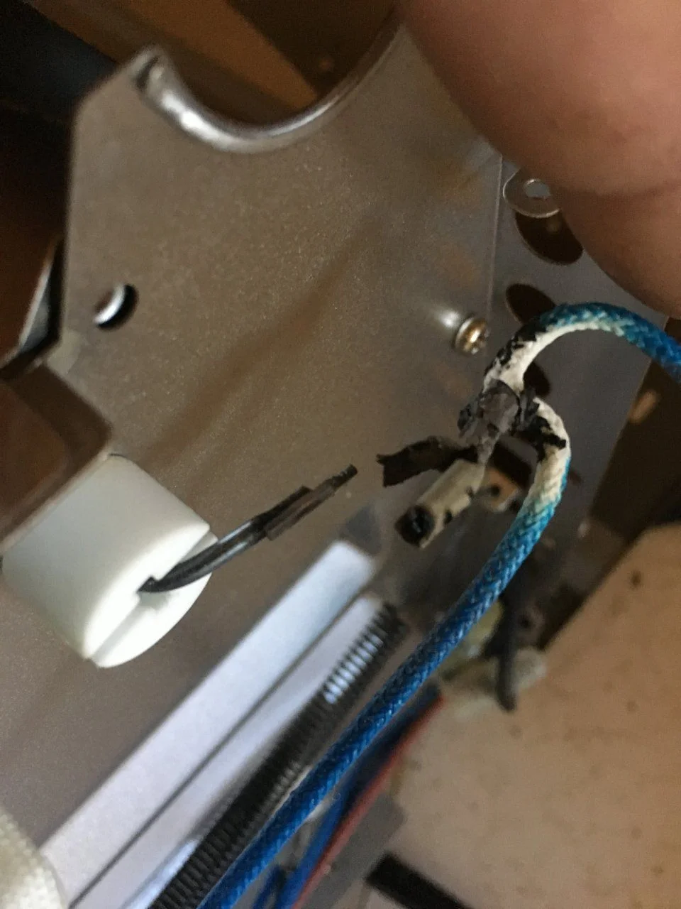

Me? I kept it simple with a toaster rebuild :lol:

Thanks for the hand pal! Also a big thanks to @beno for the OEM radiator and belts hook up.
Like Christmas for a Toyota junkie

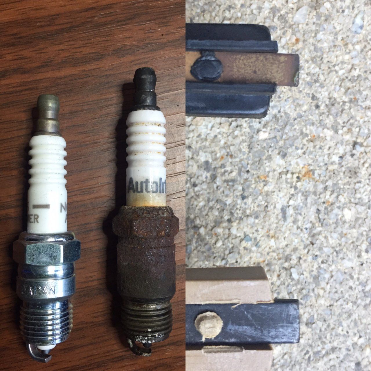

Basic stuff. New plugs, wires, cap, rotor, drained and refilled transfer case and transmission fluid. Transfer case fluid looked pretty great so maybe a waste to throw away but a good sign. Tranny fluid wasn't so hot. Not water logged, but definitely not fresh. Also did a little cleanup, respray of the battery tray, put a couple new batteries in. For an encore, I used an IKEA curtain rail to mount a new coolant overflow tank.

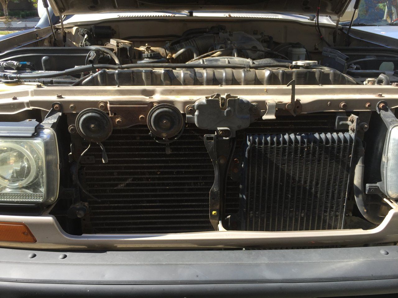

Wired up my dual battery. I have the 91 3FE so used a tray from an FZJ. Made my own battery cables for the first time. Used the Blue Sea ACR. Not using any battery switcher (for now). Ran 1/0 under radiator support at the front of the hood to hide everything.
Still not a lot of room and have to figure out how to bolt the components in. Right now they are stashed and out of the way but not yet finalized.
I took some pics (will upload when back in town) and am intending to do a write up. I couldn't find too many people with FZJ style dual batteries in the 3FE because of the full desk of requirement.
