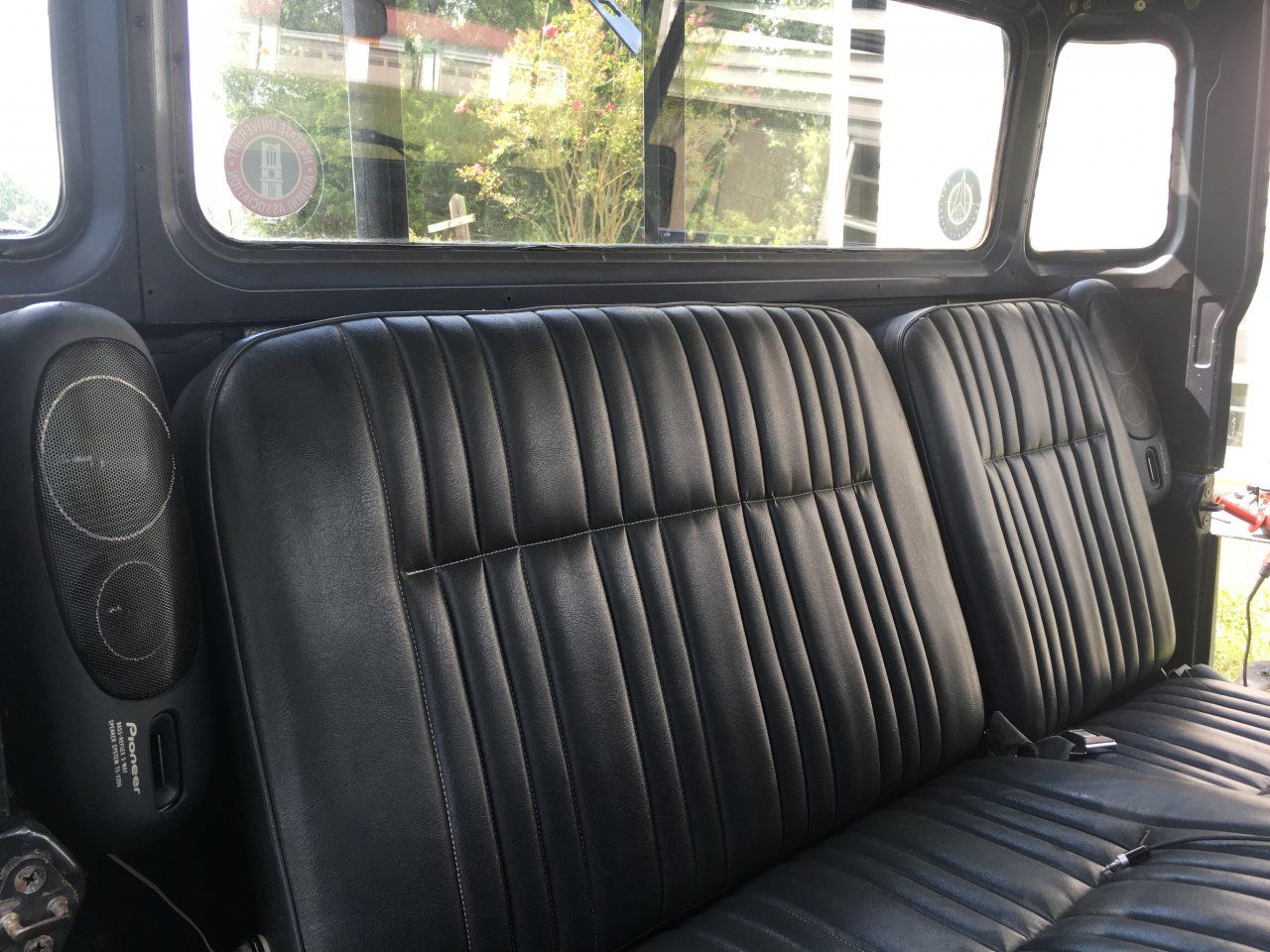

They feel great from limited seat time so far. Trying to find a set of 91/92 seat belt recievers in brown to utilize.
Nice tall position. Had to move wheel up which feels funny but just different. Comfortable for sure. Good thigh support and depth and awesome view of road and dash how i have mine set.

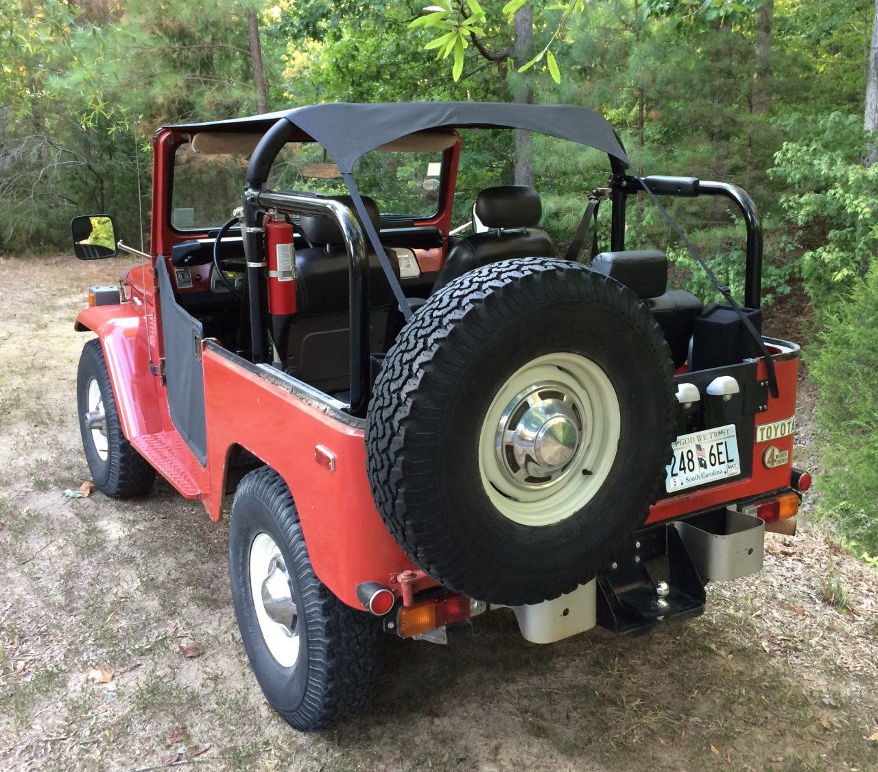

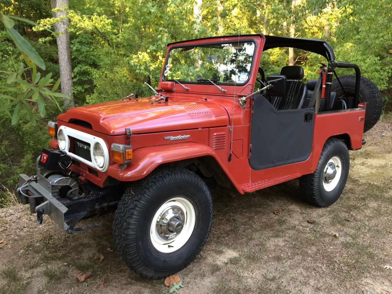

My daughter Allison told me how much she liked the look of Alex's 40 on the Hurricane Creek trip. As it had been so many years ago, she forgot the top came off my 40 as well.
I took the top off a couple weeks back but finally installed the SOR bikini top today. I bought it second hand not long after buying my 40 but had never used it.

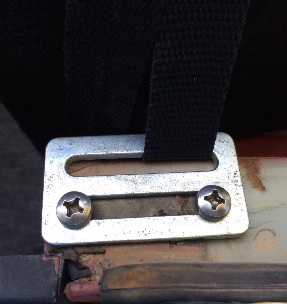

I winced as I drilled holes to mount the channel and instead of drilling holes to mount footman loops, I repurposed some leftovers from some long forgotten projects for the straps.
I think I'll like it during the heat of summer but will ditch it when cooler temps arrive.
I believe I just ran the straps under the rear feet for the roll bar and used a Strap buckle. No holes.
