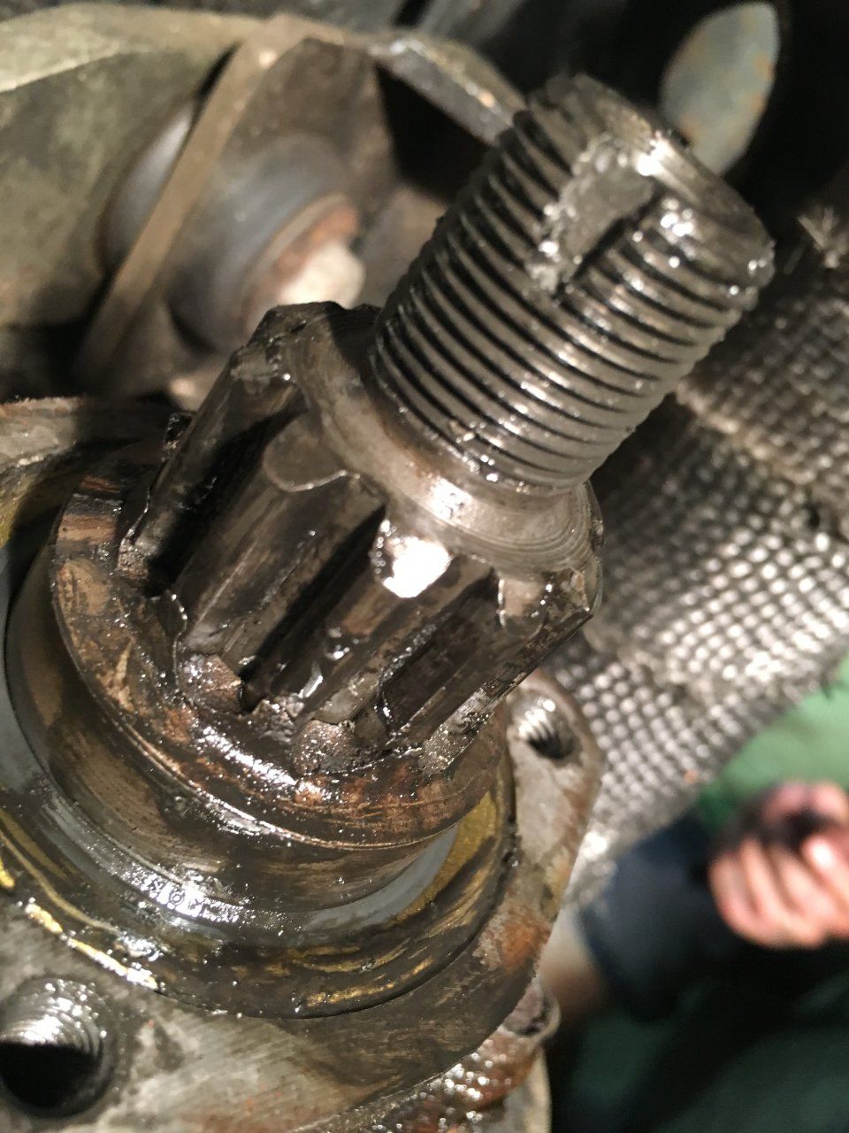

Drill press and drill press vice were purchased specifically for this job; reaming out the J8x pitman arm to the correct taper for Chevy ends. Glorious drill press.
