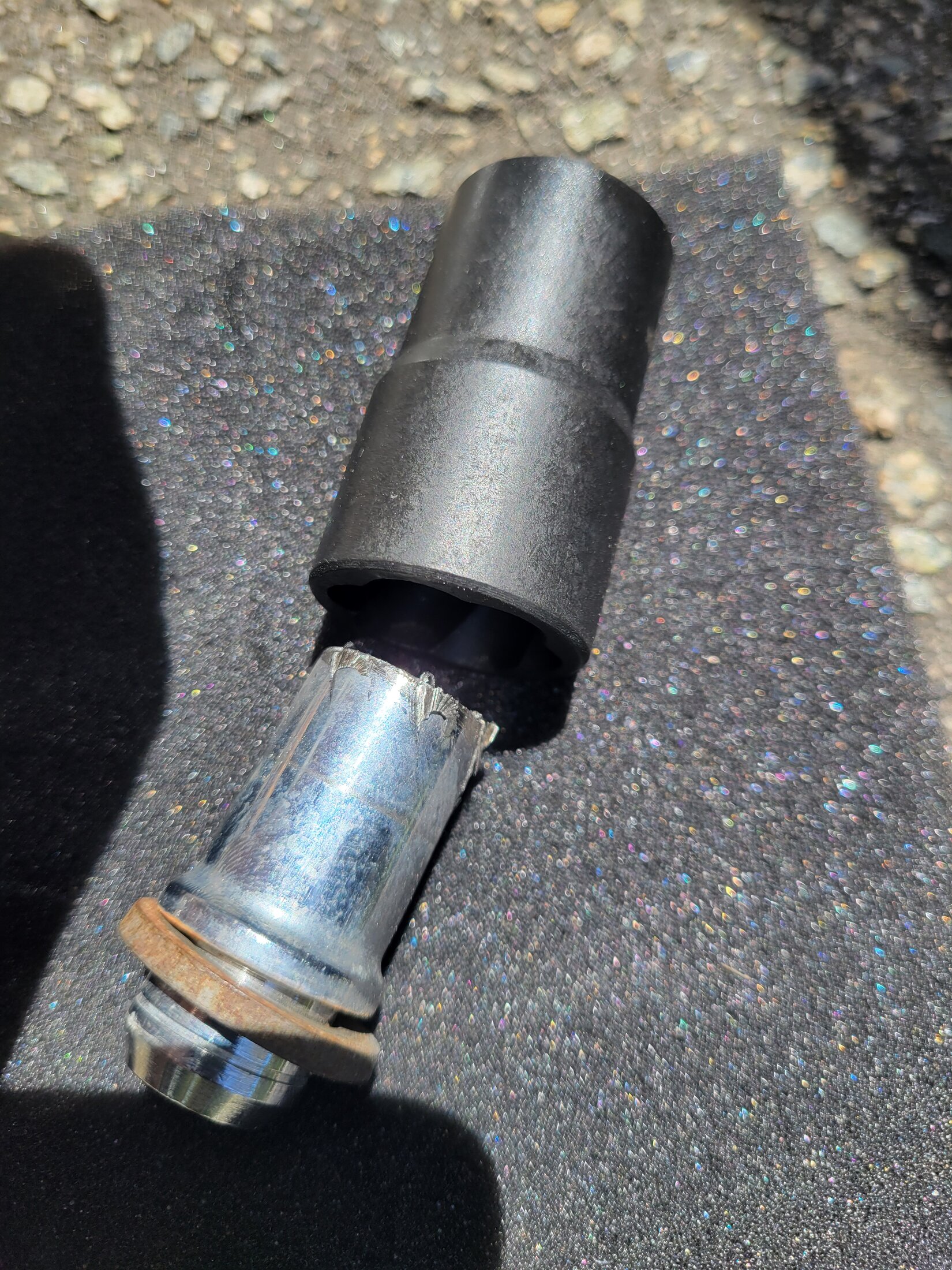

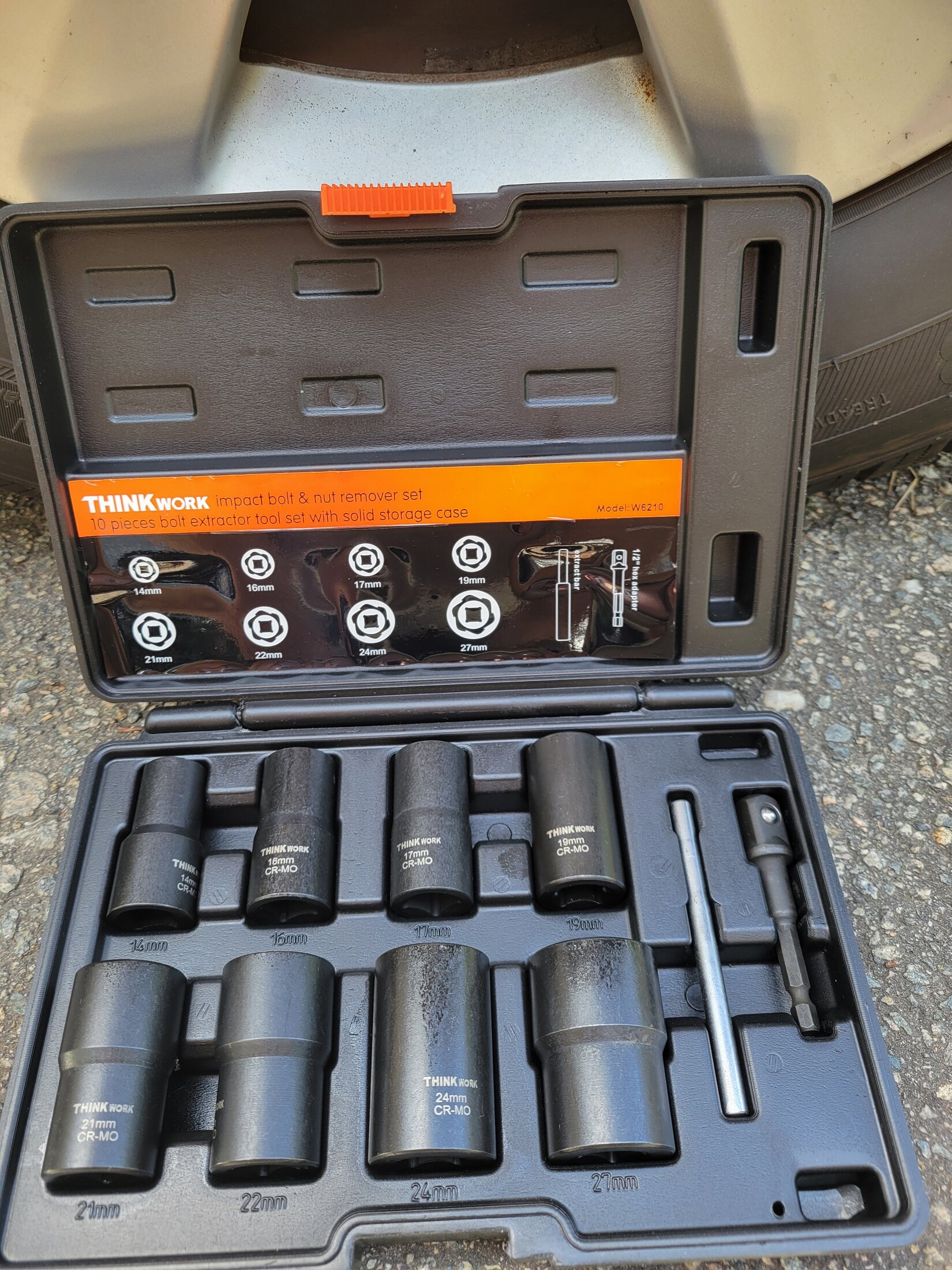

Last time my wife had the tires rotated on the GX, they must have forgotten to return the wheel lock key. She went to get the tires balanced for some vibration and can't find it anywhere. I've cut these off with a die grinder when I worked at Goodyear as a teen, but it sucks. I found this on Amazon and it worked perfectly... once. All the teeth inside sheared right off. Just processed the return... guess I need to order 3 more and return them after the first use 🤣
If anyone is aware of a higher quality tool, I'd love a recommendation...

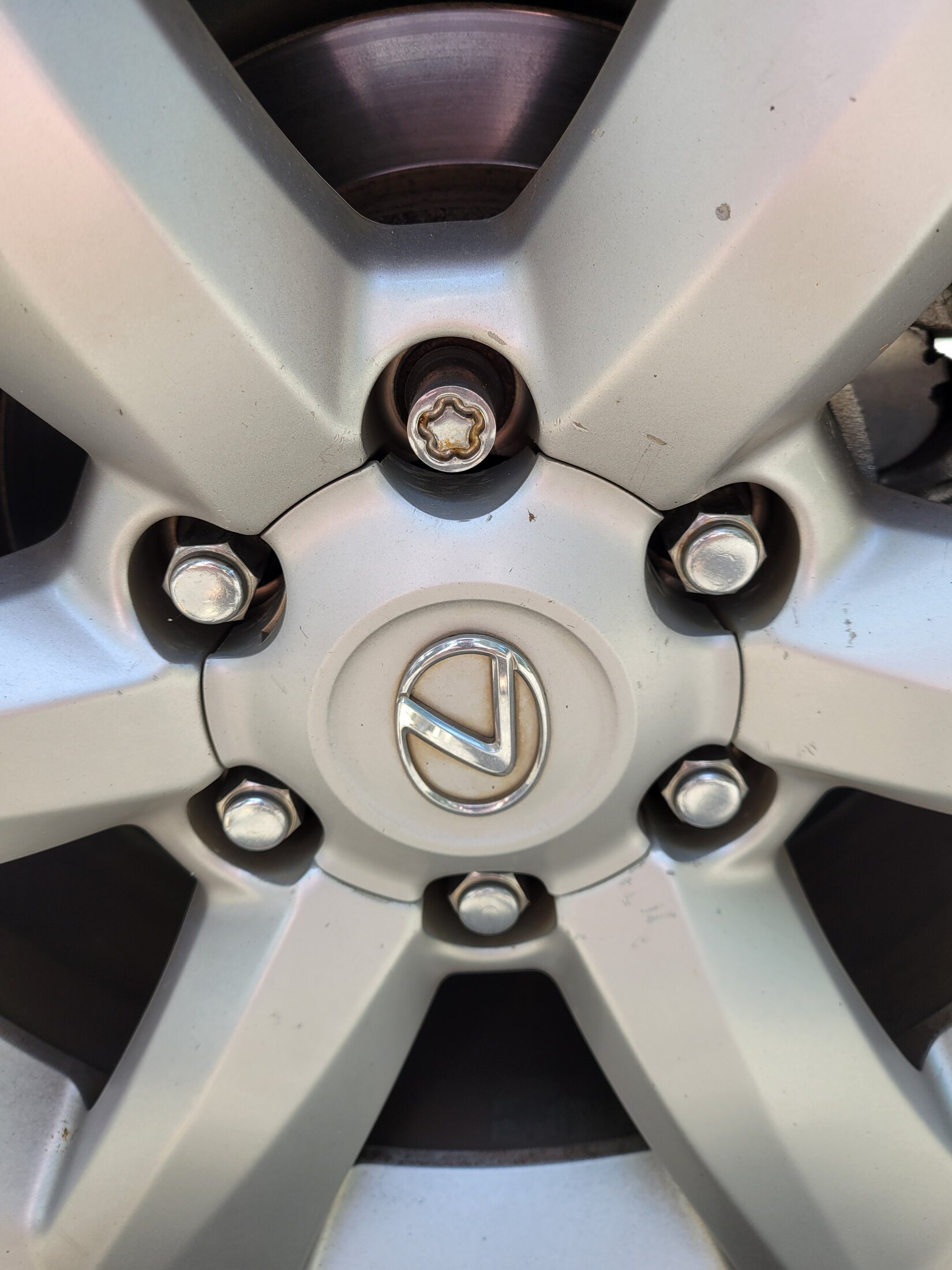

The dipshits at Costco lost or stripped out my key (can't remember, but I'm the dumbass who DIDN"T swap it out when I should have, though).
Someone here suggested simply getting like a spare 19MM or something smaller than a 21, I believe, and beating it on and then zipping off. I can't remember the size.
Worked well for me in the Costco parking lot.

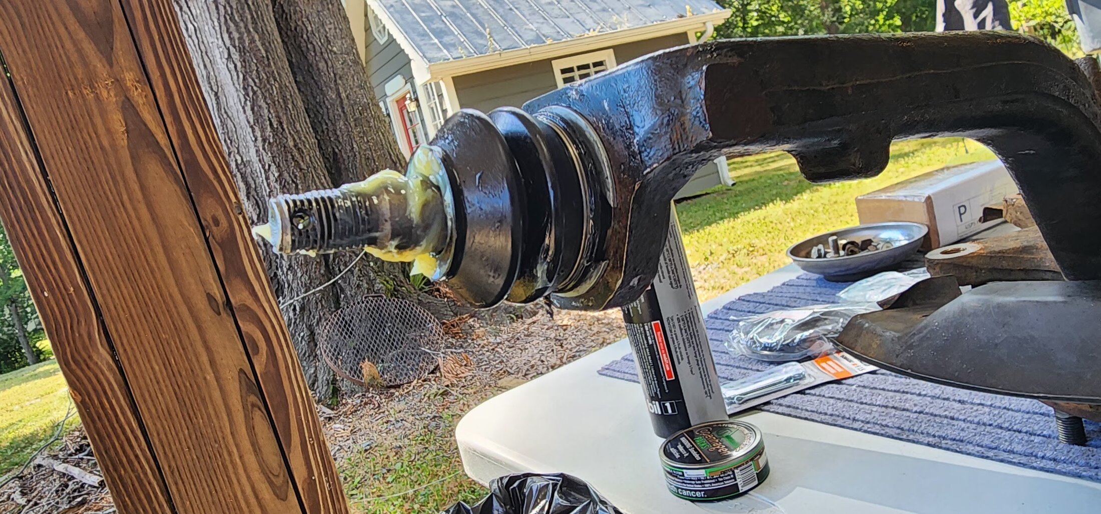

UBJ, LBJ and Tie Rod Ends done. Separated the hub and used the bench/vise to help. Alignment done this AM. Ready to roll!

Yes! And use all your grease - I cleaned her up after this pic, and packed in the rest of the top grease as best possible after pushing boot through.

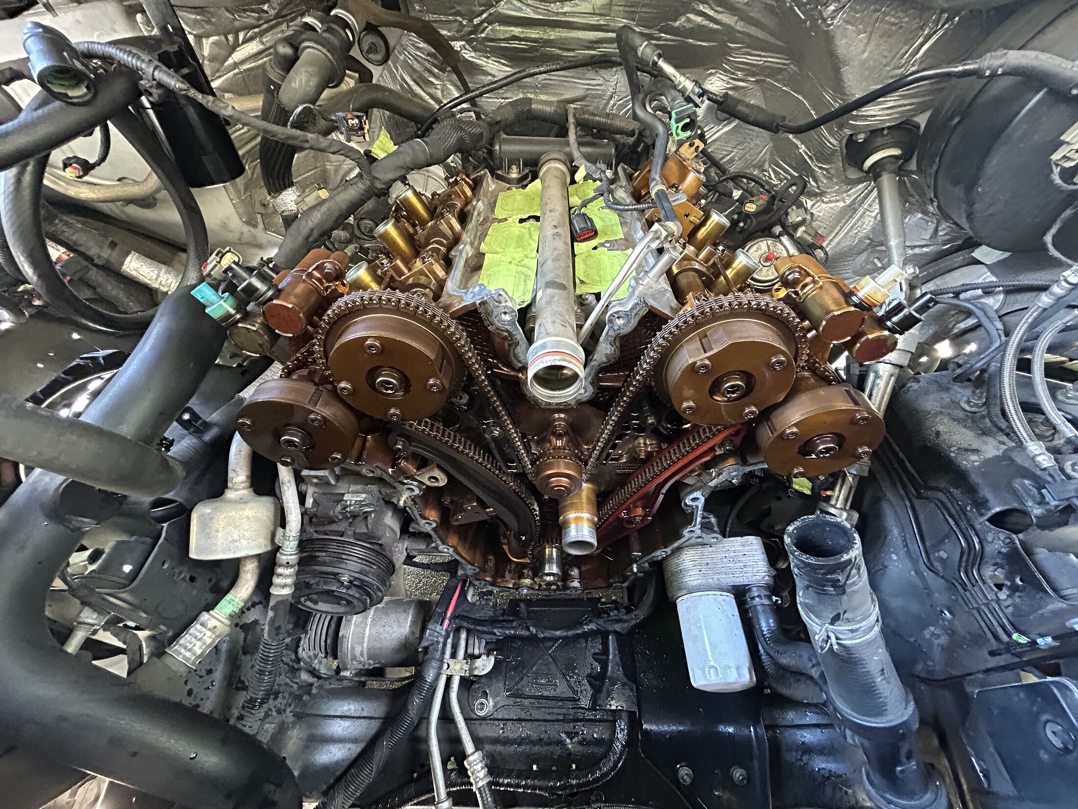

Comet (1997 is a no fly) has a wicked knock that follows idle that only gets worse the more it idles. Trailering home instead of legally putting it back on the road to better diagnose issue. Stan’s offer for a free 1FZ-fe may have been a blessing in disguise for Comet and not for WTF. Lizard brain tells me to keep buying more land cruisers, bride and wallet say thin the herd. Full stop to determine direction.
@open country For those of us with limited knowledge and skills (like me!), can you say what we should be seeing in that pic?
The first audible rattle (canary) is what finally lead me to sell mine. That, and the fact that it was going to cost around $7k for me to get everything replaced correctly. No thanks. I was religious about using GREAT oil/filters. Can’t fix a fundamental design flaw as a consumer unfortunately without tearing it down as you are. Super fast truck (especially compared to the former gen 5.7 tundra), but ultimately performance comes at a cost I guess.
Front cover removed and seeing the primary timing chain with cam phasers along the top. Super common issue with 2011 to current F150's/SUVs/even Taurus SHO with Ecoboost 2.7/3.5 engines, that the cam phasers (oil pressure acutated VVT) do not get adequate startup pressure with age and rattle the timing chain on cold start, which then leads to stretched chain, damaged guides, check engine light, etc. Mine made it to 160k miles on original parts with perfect maintenance history, which is longer than most. Rattle started about 5k after I bought it and I've been pushing it a few months before biting the bullet on this job. Allegedly these OEM parts I'm installing are "updated" and will last, but who knows.
