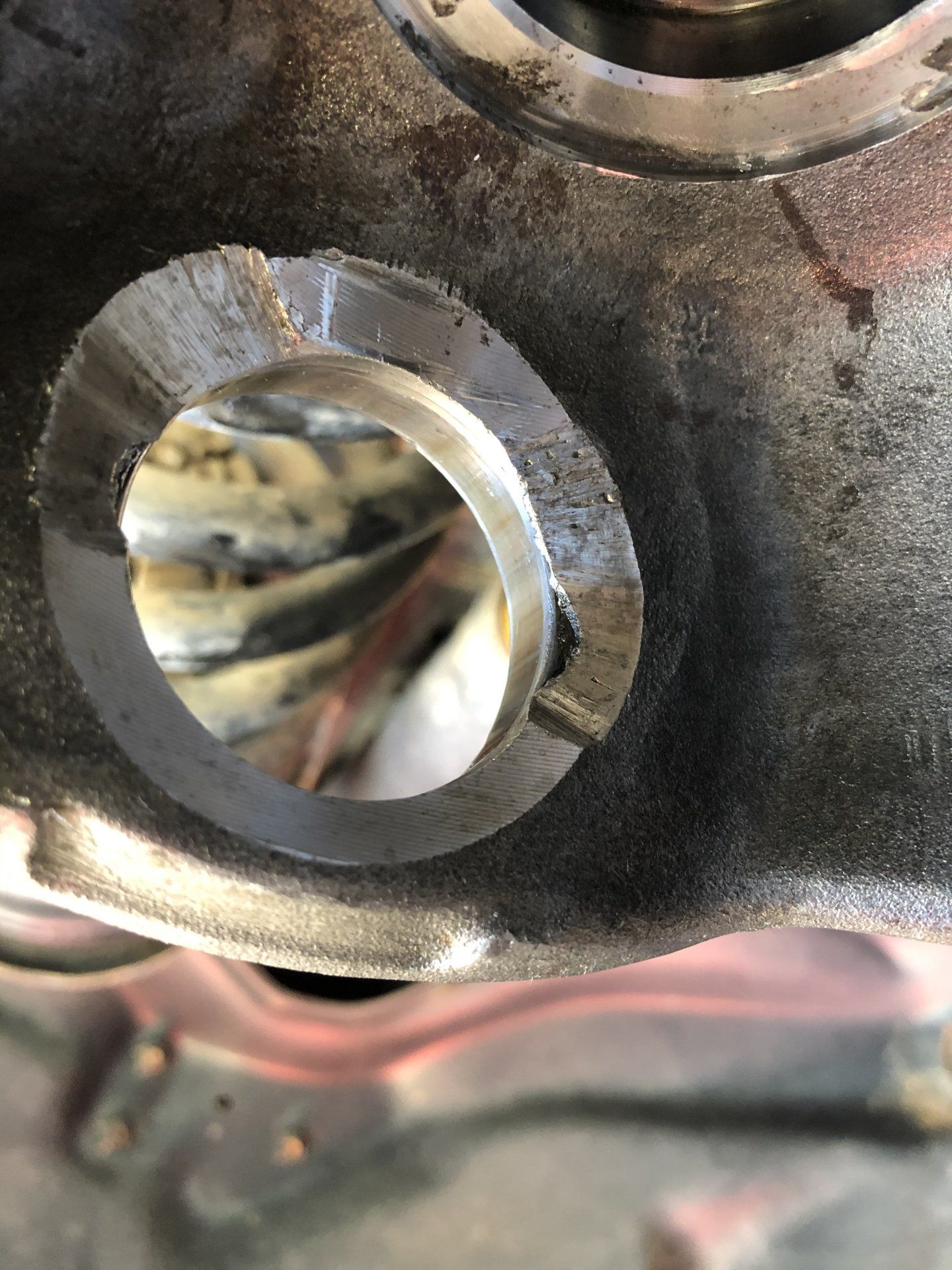

Nothing else broken, has me scratching my head as well. Not what I was expecting to find for sure.
I've heard of drive flanges failing like that, but not diff side gears. Cool!
Looks like I spoke too soon, found this while cleaning the knuckle balls.

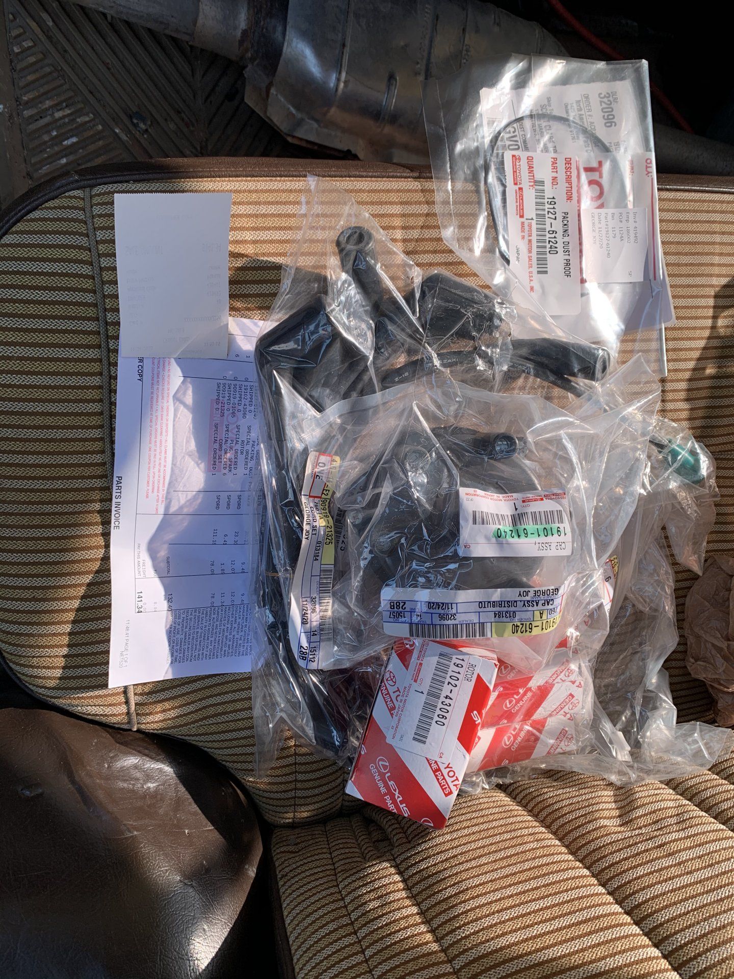

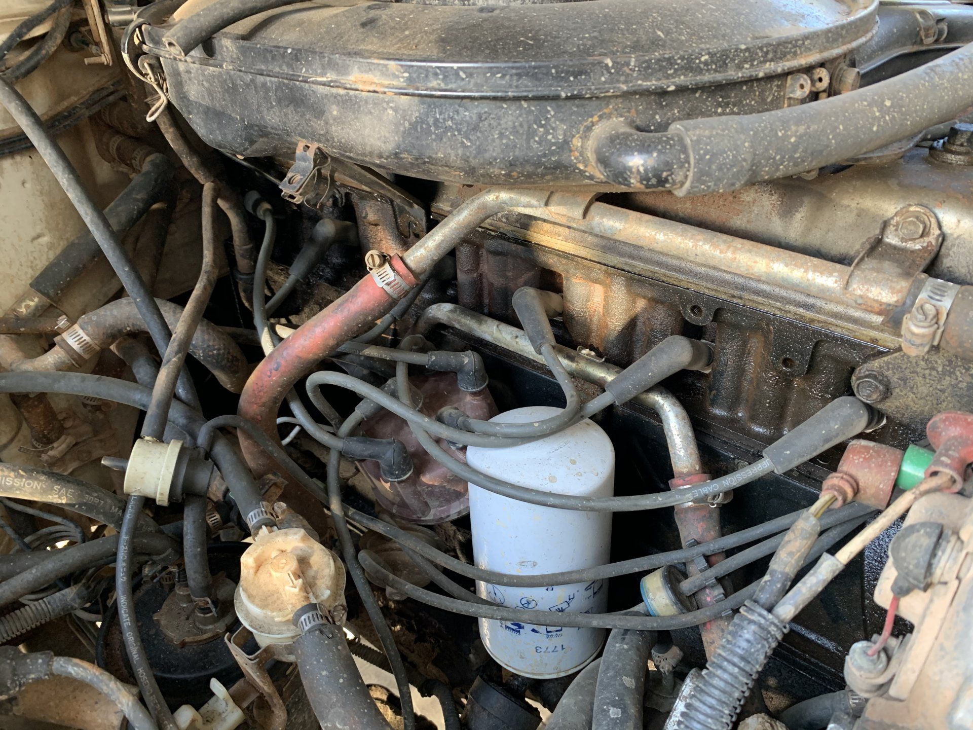

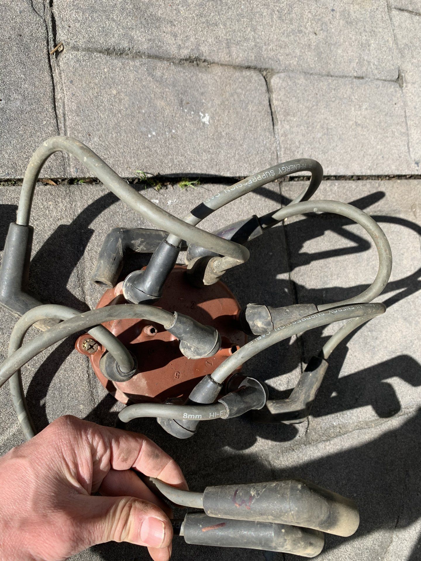

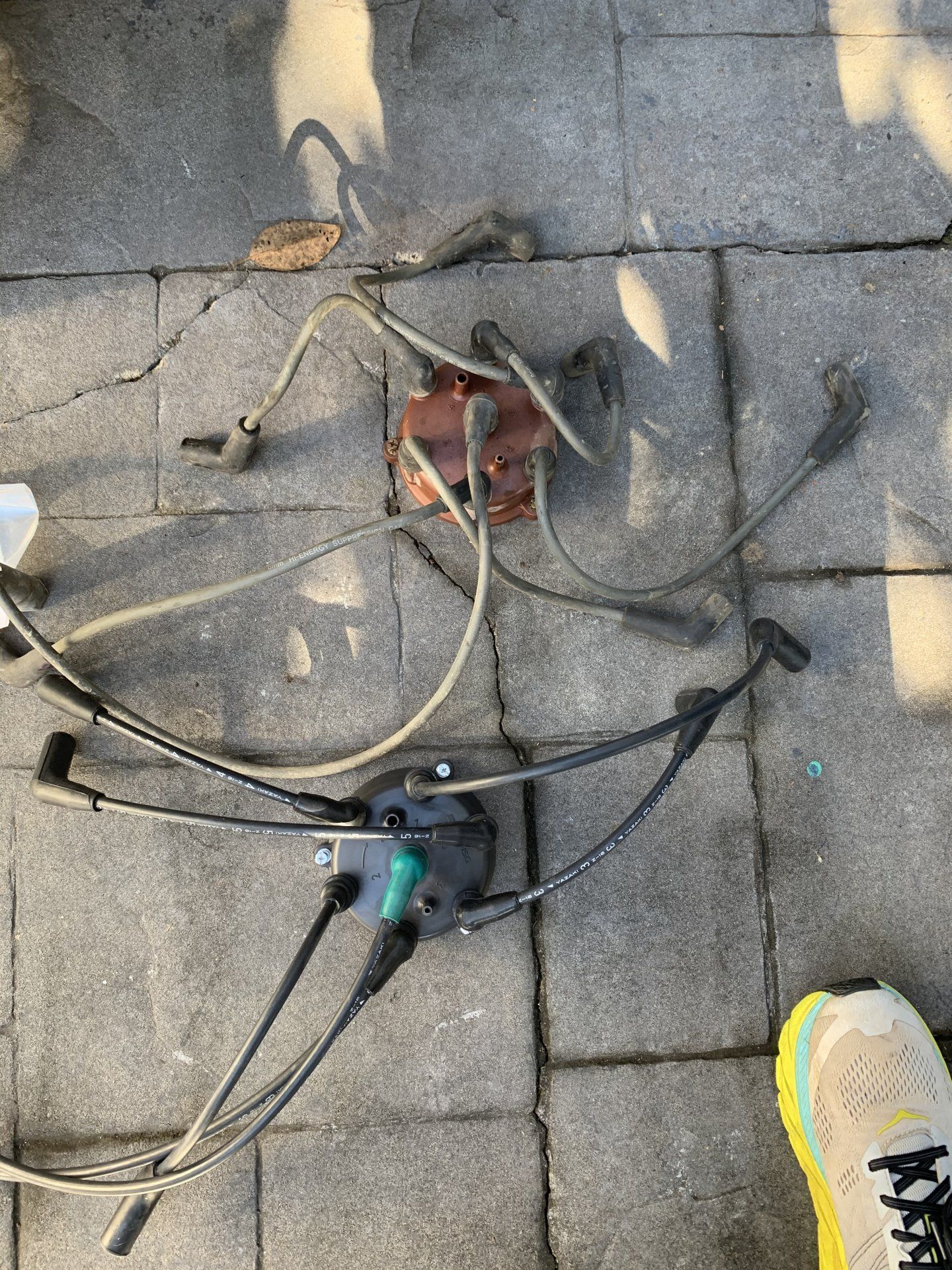

Cured my hard starting issue. Always has taken me many attempts to get my fj60 to fire up, always assumed it was because of putting off the carb rebuild. About 60k miles ago the PO’s PO (original) dropped $12k+ on engine rebuild and lots of maintenance, so just made me think the car had gotten gummed up from bad gas. Well @fj40alex convinced me to do some more baselining first. Realized I never swapped the distributor cap/rotor and wires when I first got it. So ordered up some expensive oem parts from mr T, and thank goodness I did... he literally idiot proofed this job, the wires and the cap are clearly numbered. Thank goodness because that is how I noticed the #1 and #3 wires have been switched ever since I’ve owned the truck!!!!!!! Also noticed the cap was on very loosely with lots of play due to having two of the three non-oem screws stuck but not tight... no prong... cap and rotor and wires were not oem... cap was made I. Italy, not sure if they were bad but doesn’t hurt.
so glad I did this maintenance to uncover such a findemental issu... curious if it’ll now have a noticeable improvement On the road...
didn’t swap in the new plugs since four of the six ones are clean andall are new, plus I noticed the valve cover is leaking oil so will do that gasket and clean things up before swapping in new plugs

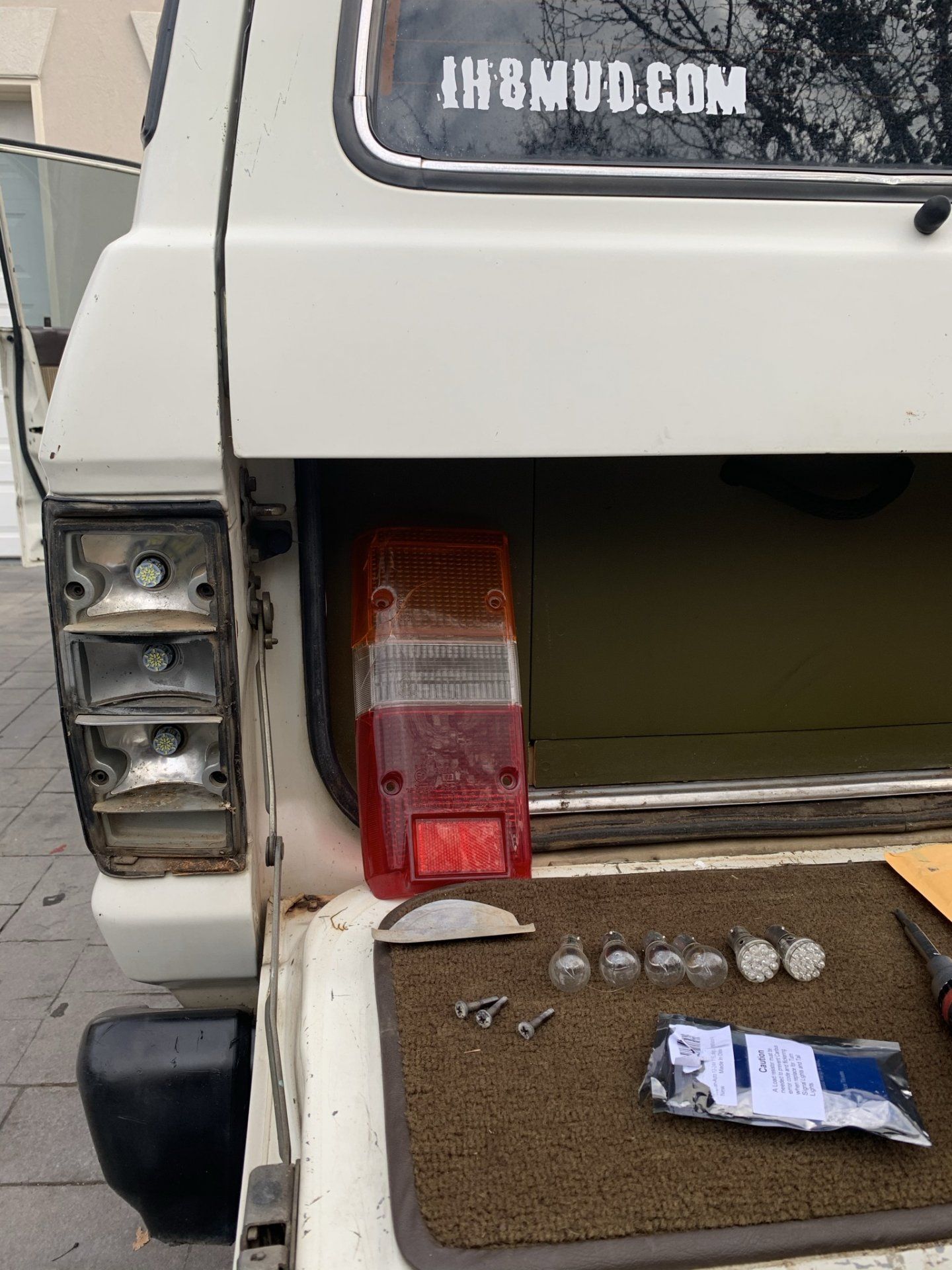

installed led bulbs in the rear, now have hyper flashing turn signals but safety at night has improved.
