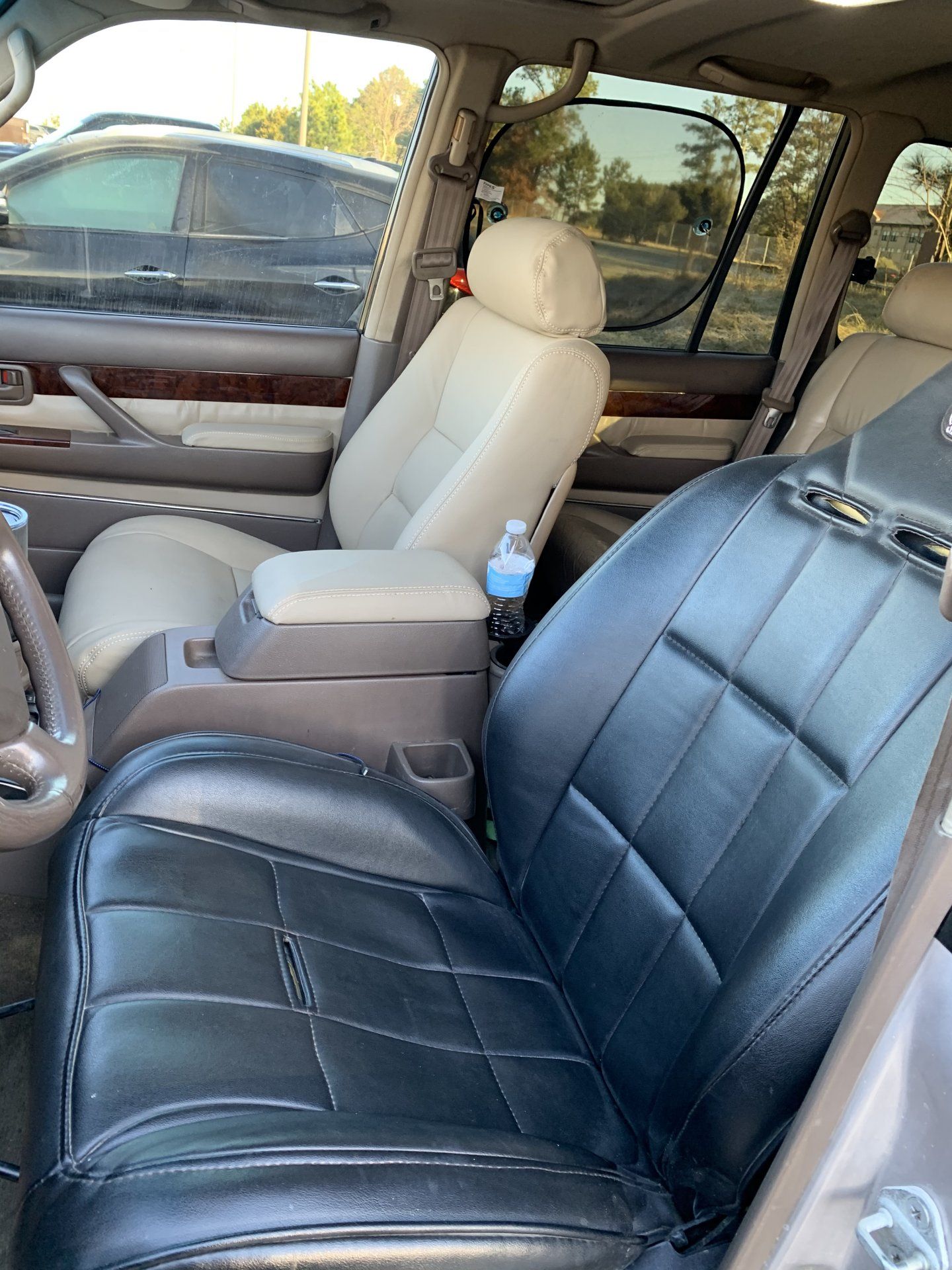

This is my temp solution. Testing this out for the next week before I pull the trigger on a pair. I plan to use SEM tan vinyl paint to math them up to the lx450 interior and call it good. Oh and figure out the seat belt attachment but that’s an easy fix
Corbeau RS reclining racing seats.
They are not as comfortable ( my seats are pretty comfy with the additional material I I stalled in them) as the stock seats but pretty close.

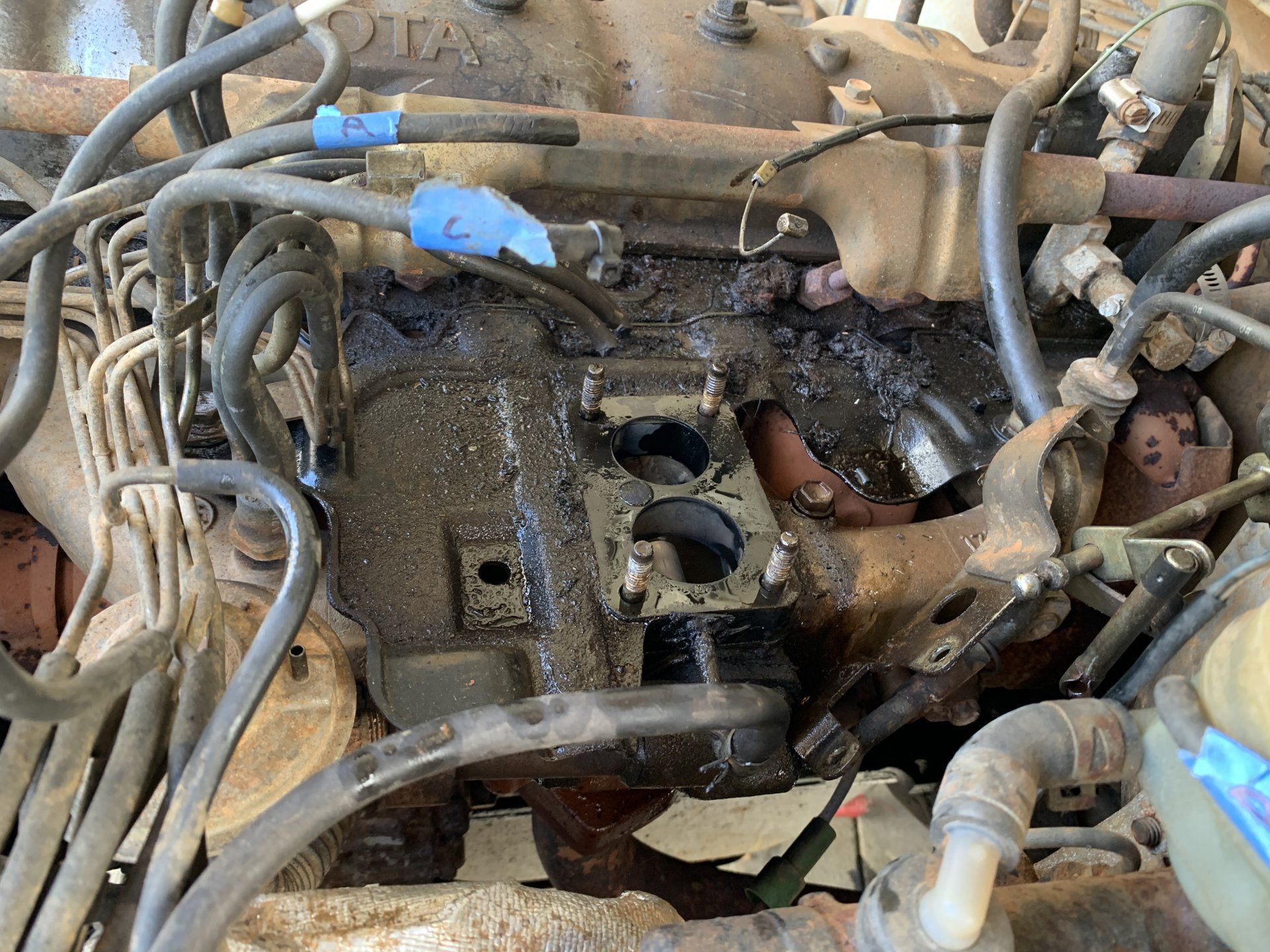

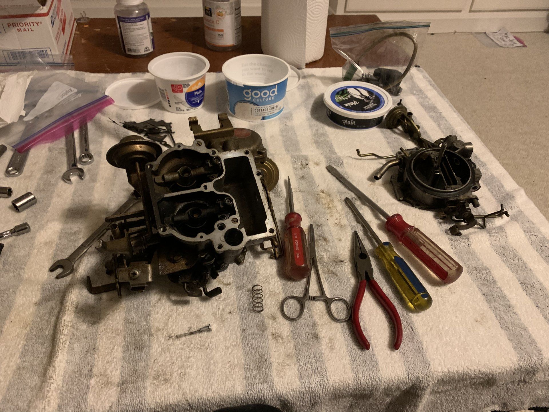

it was on pinhead video #2 when JoyRidaz started to get a bit overwhelmed and struck with a case of the dark thoughts... did I just ruin a good running fj60 in my quest for a perfectly running truck? All these tiny spring and ball bearings look the same... will my hectic dad life cause me to forget my parts in the chem dip causing them to fully dissolve... stay tuned, maybe it’ll run again by Sunday after a couple over night soaks in the toxic bubble bath followed by a couple days of fighting my dislexia ... that is if I can also figure out where all the black spagetti goes back. Overall it def has a good amount of carbon buildup but compared to the carb on my forty a few years back, this is a pretty decent starting point!
Dad have u seen my towel? Honey where is my cottage cheese?
A mouse nest or something from 1992 drenched in black oil from 2010-2020... nasty mess. Ordered a valve covered gasket from mr T which will be a stocking stuffer
So much black spagetti to keep track of... a few near the engine were pretty brittle and stubborn.

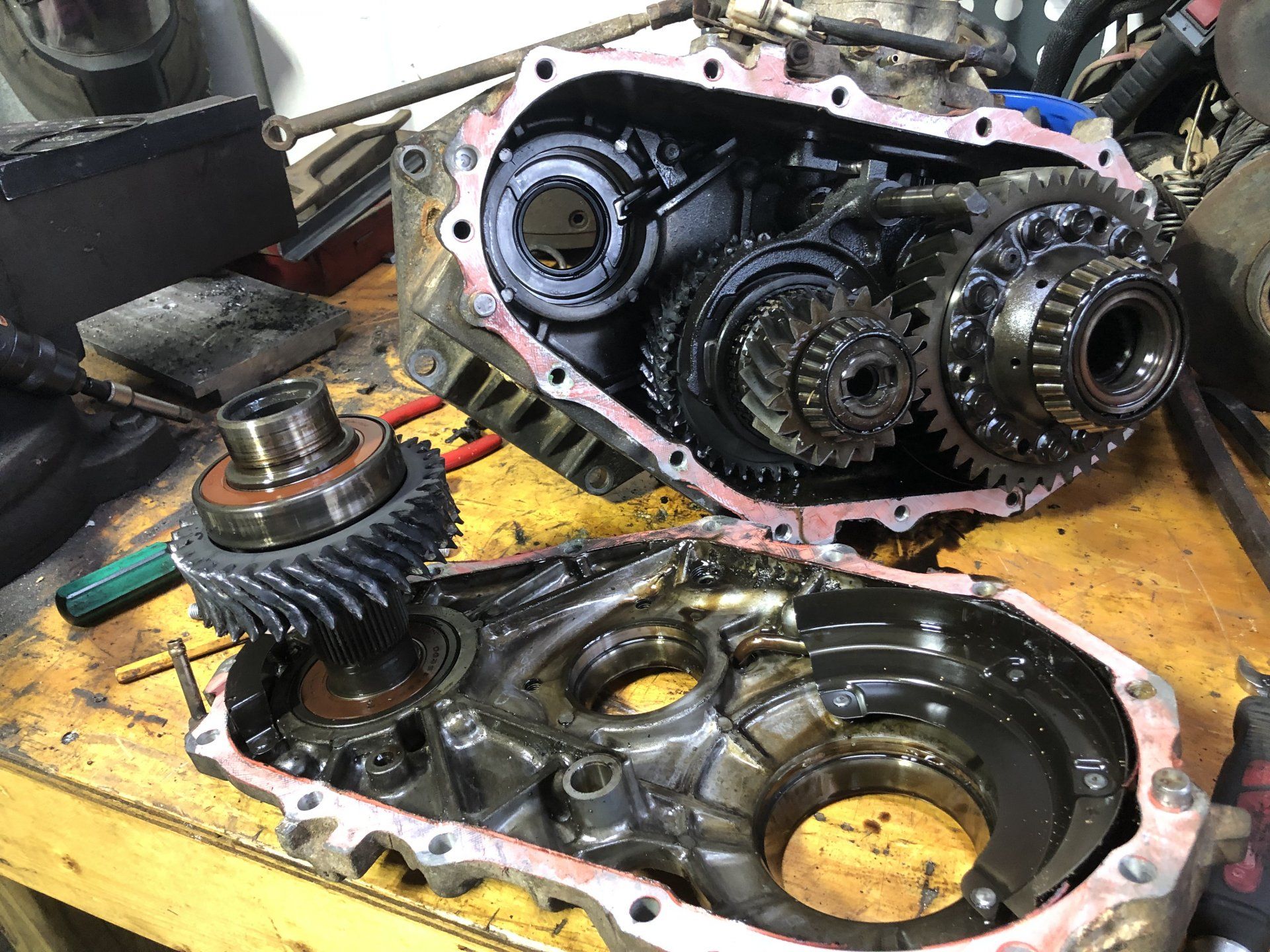

Finally got the transfer case fully in. Finishing the button up and have a question:
Does it matter which bolt attaches the ground strap?
Mine was really badly torn before removal and I don’t remember where it was originally connected.
Nope, just needs to connect the driveline to the body (or frame depending which one) with a bit of slack.

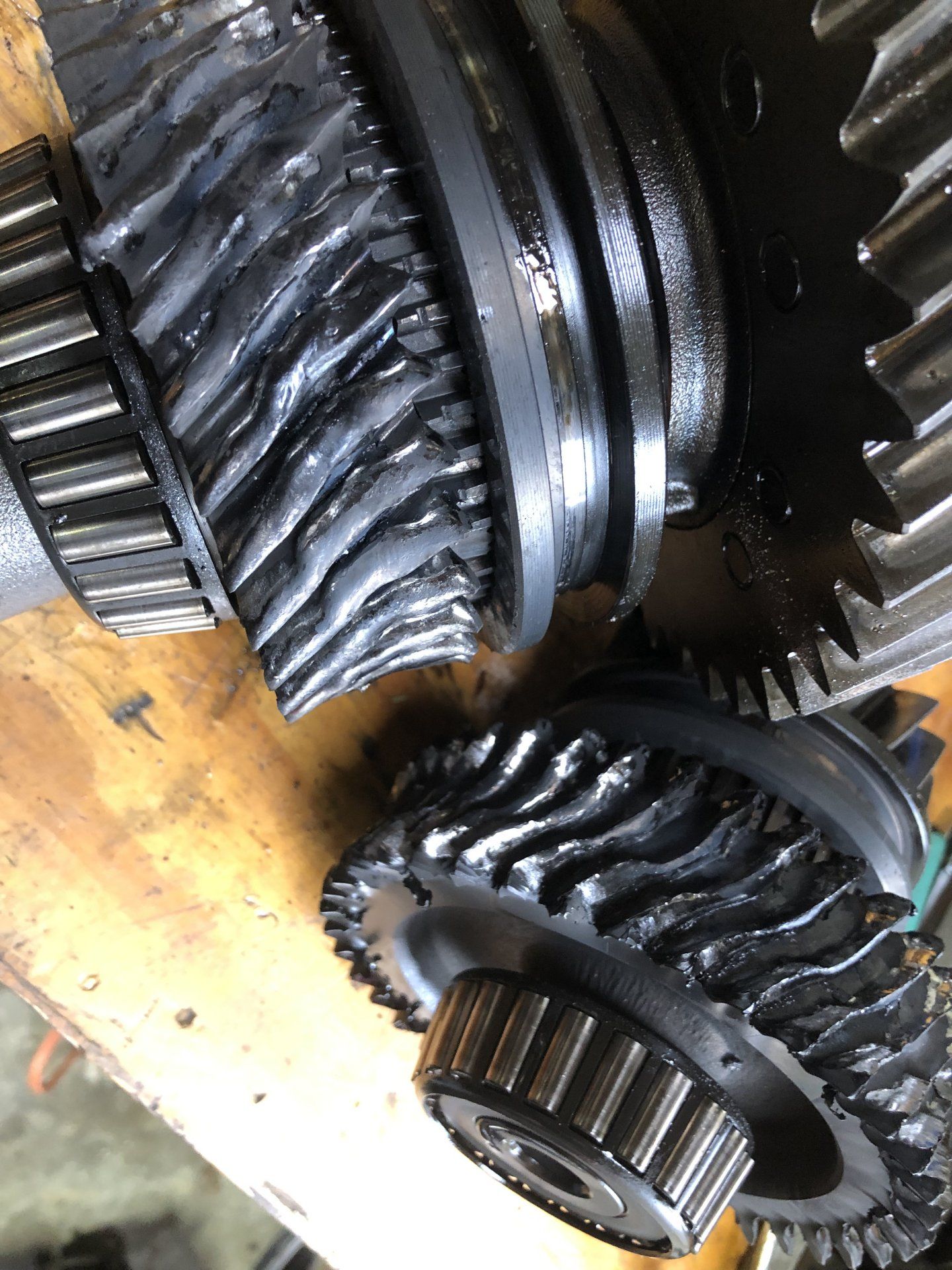

Guys- today is the freaking best. January will be two years since I killed my transfer case. After many days of procrastination, anxiety, anger, hopefulness, frustration, and thoughts of giving up, I was able to drive my cruiser!
@GLTHFJ60 helped so much along the way. Even letting my crap sit in his garage for so long without progress. Thanks to @NC LX for hooking me up with a used case that I used for clean gears. I’ve enjoyed laughing with so many when they saw how I ground those gears.

How did you manage that??
Believe it or not, the transfer case needs oil to keep running effectively. /s
I hadn’t been keeping up with it as well for the previous year. We sold our house and lived in an apartment while house hunting; then it got cold and didn’t want to deal with stuff outside.
Turns out that even a tiny leak will take a toll if left alone.

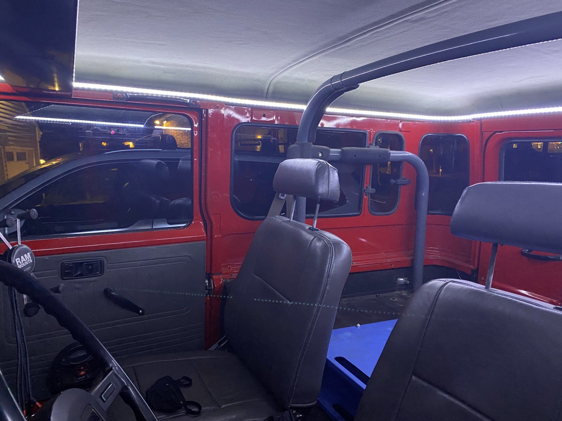

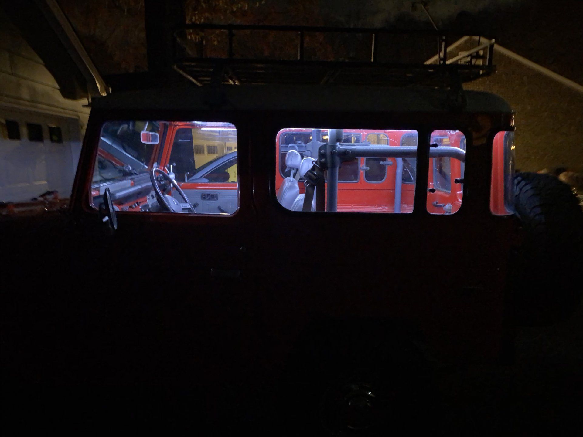

Always was annoyed with the 40's feeble interior light - even with an LED bulb. Basically required a headlamp to actually find anything in the truck after dark. Stuck some cheapo 12v LED strip lights around the interior, wired to the factory interior door switch, and "let there be light". Huge difference. The strip length was nearly perfect - from driver windshield corner, around the side, rear, other side, and to passenger windshield corner. Zero splicing. Also can undo it all to factory in about 10 min. Highly recommend.
