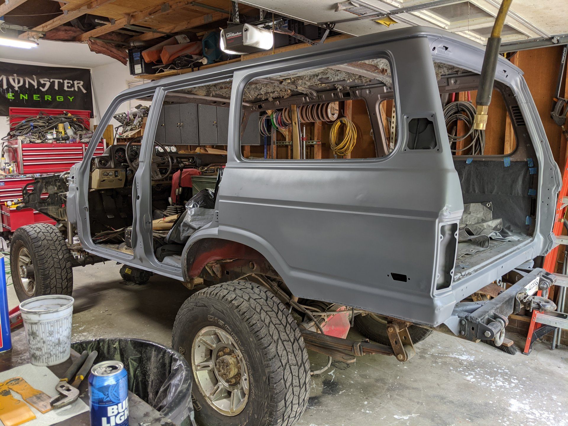

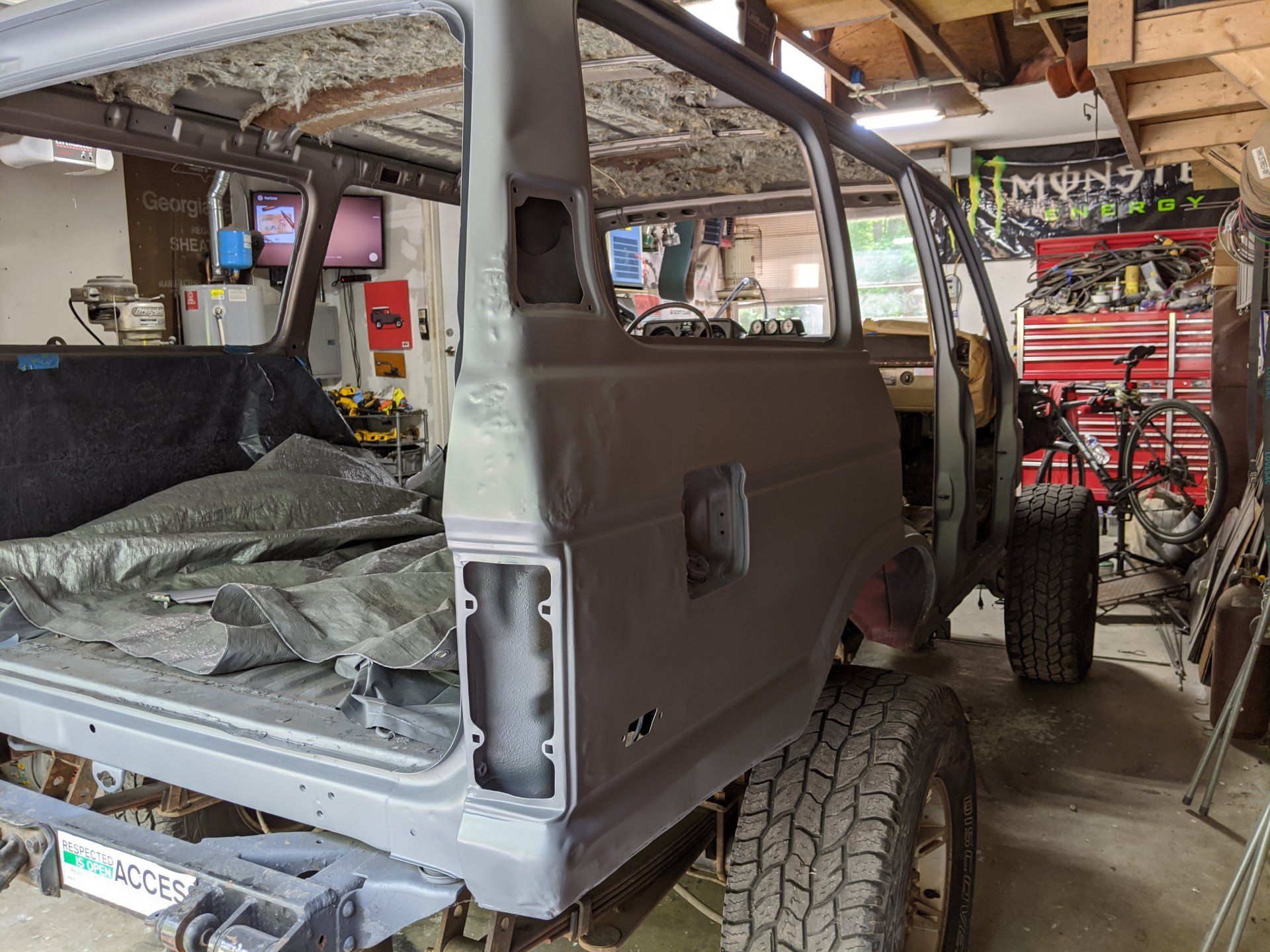

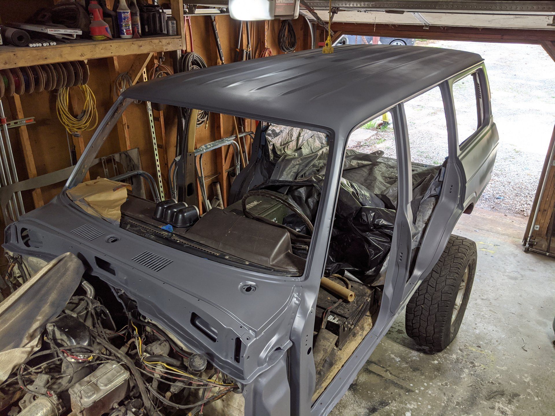

Frame is on primer after sandblasting

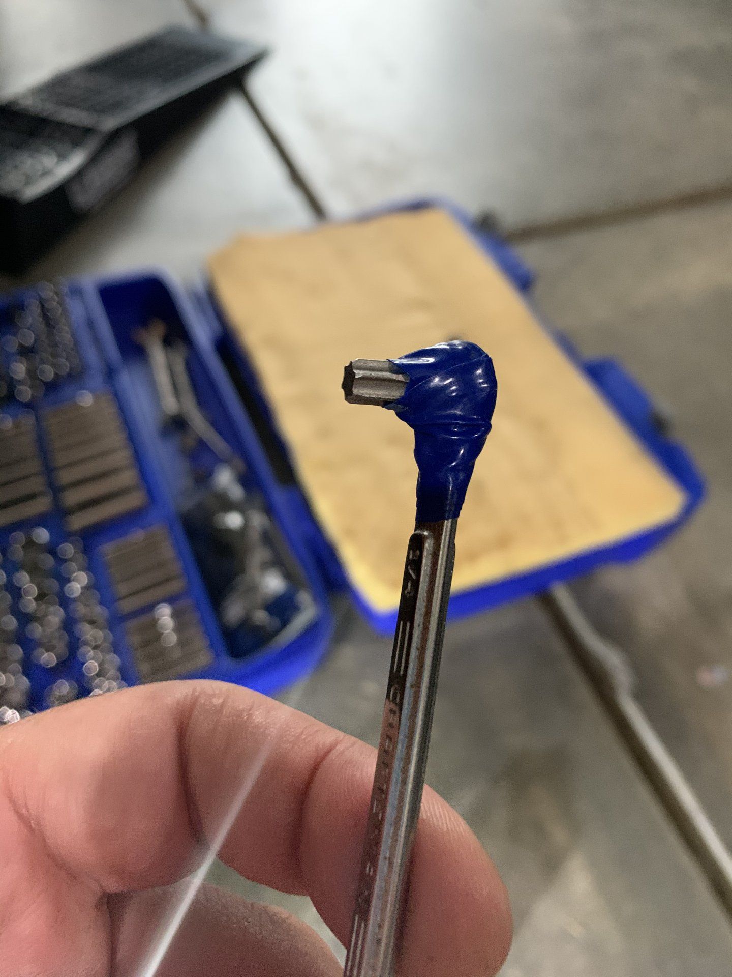

Okay, not as impressive as Stan (go Stan!), but since I know many others drive VWs, some insight. The new turbos, the IS ones, use electronic wastegates. And they fail. My son's golf (which is APR tuned) had the failed actuator code, so we got into tearing the area around the turbo to remove and check the actuator. Had to made a "special tool" to remove the T30 bolts that mount the actuator body, the rest was tight but simple unbolting stuff.
Anyway, VW wont sell the actuator, they dont show a part number for it. But of course there has to be one in the BOM, they just wont tell you, so it is made by Cooper Standard in China, part is 06K145614G. The letters may be off as they have superseded parts, but the numbers are the same.
My son got a CTS replacement which at least "looks" better made than original, and he already had the CTS downpipe. Then easy setup with the Ross cable and software and good to go.
Dealer told us they had to replace the Turbo for $2000. The CTS actuator is $185, and you can buy the original new from Alibaba for $100, same markings and stickers.
wastegate looks like others, nothing different
Get a Torx30 screw driver bit, cut off some of the end and secure it to wrench, it is very tight to get mounting bolts out

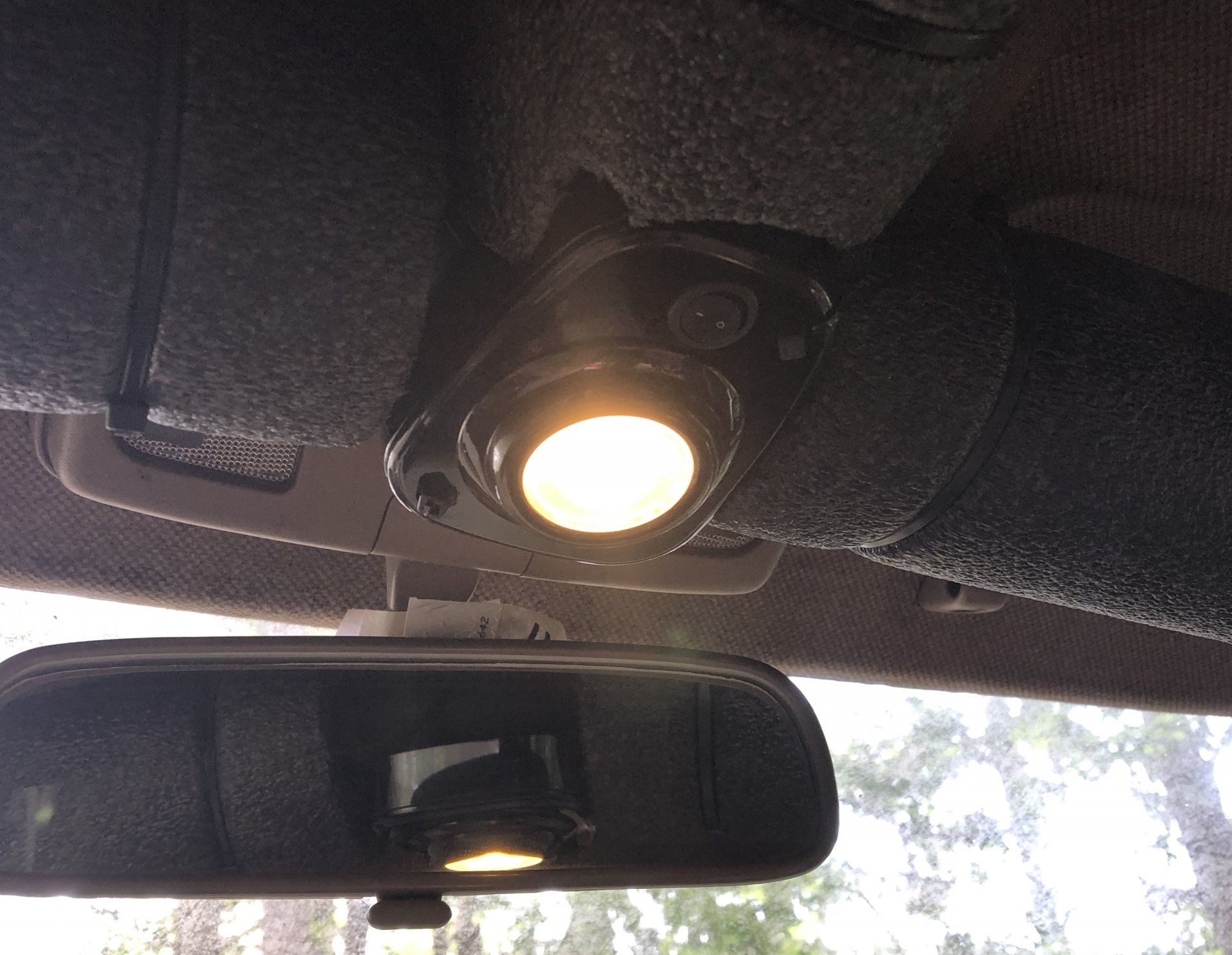

Not exactly “wrenching”, and definitely not difficult, but finally checked off solving my lighting issue in the 4Runner after the cage install. The map lights still work, but they’re extremely dim and what little light they do put out is blocked by the padded roll cage bar. This should help light up the front seat area. The light swivels left/right and up/down. Super simple, other than my hatred for working with really small gauge wire.
