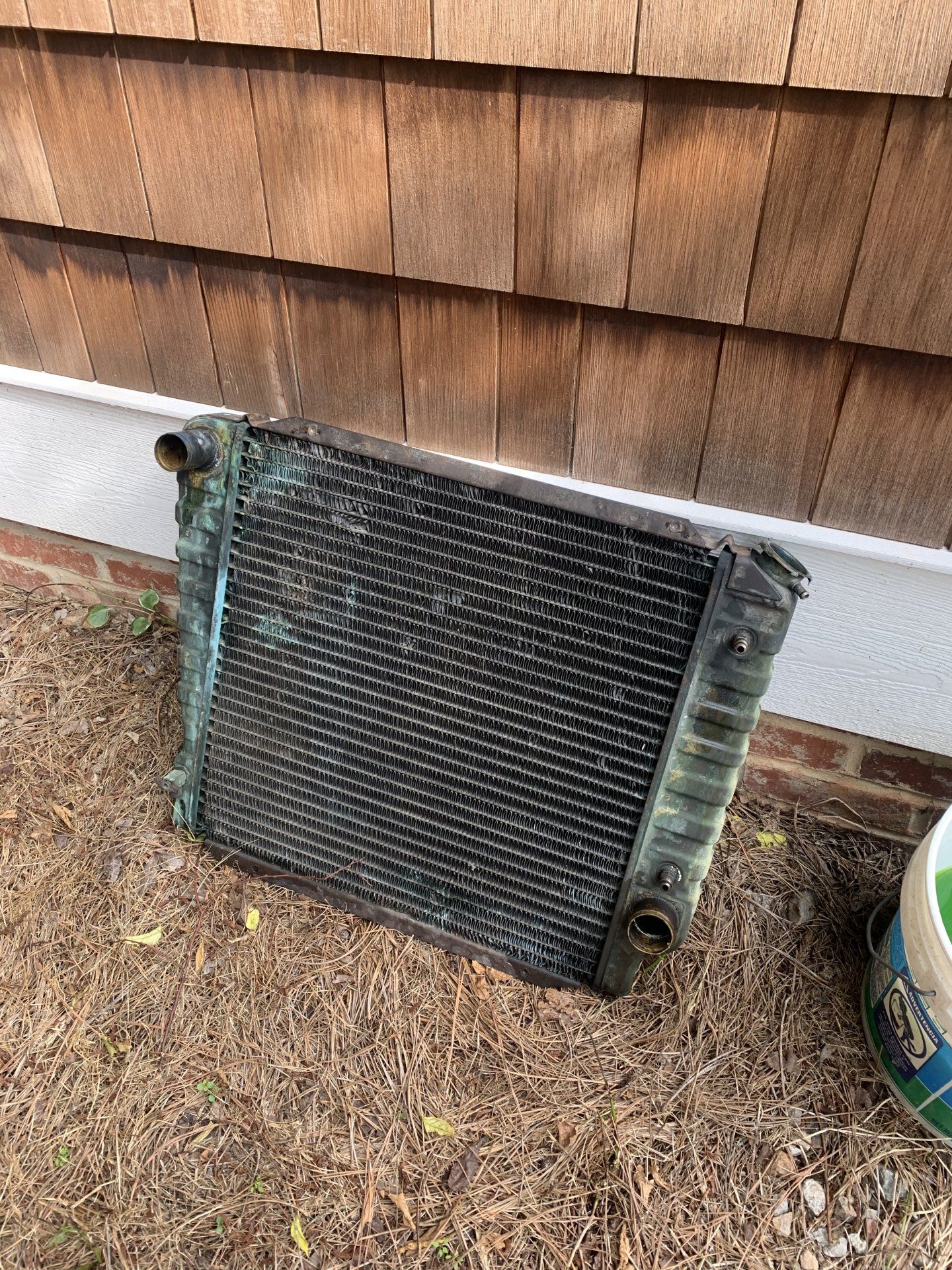

Radiator rebuild after 46 years.

In making preparations for some upcoming upgrades and after noticing the upper part of the radiator needed repair, I pulled the radiator, heater, related hoses, blower, and the related in-dash controls. I also planned to paint the radiator grill/mesh and a broken stud when removing the emblem meant an unexpected order from the dealer. An unfortunate mishap at the radiator shop after they’d fixed it meant adding a new radiator to my order. @roadstr6 hooked me up with a part I temporarily misplaced and I was able to get it all back together this weekend. It felt good to get back behind the wheel yesterday.

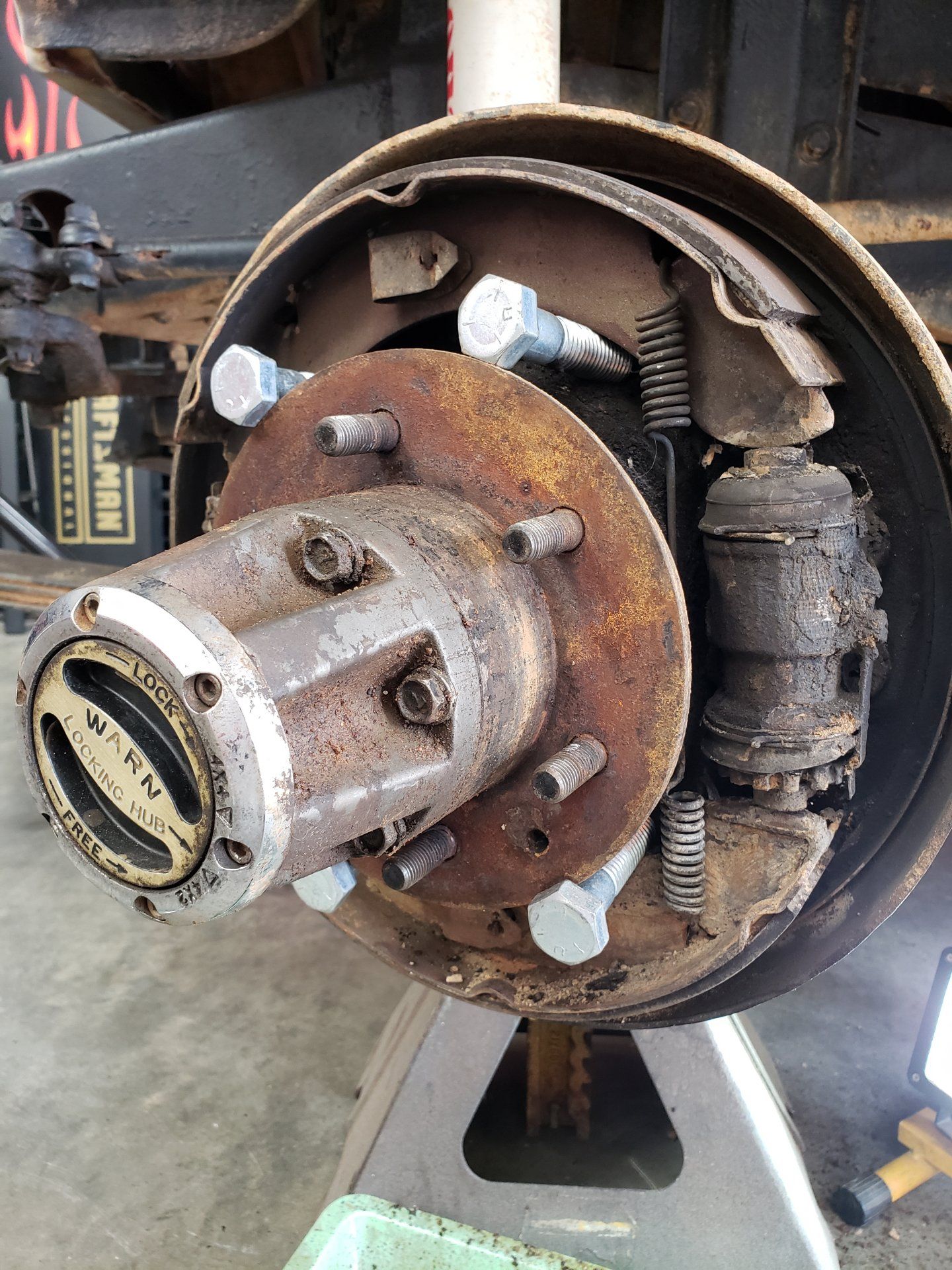

Quicktip ... if the shoes are okay and all you wish to do is replace a slave cylinder, wedging the shoes apart will keep you from having to pull them off.
The hell of it is that the bolts @Rice is using are actually old used ones from his junk drawer. Cleaner than anything I have by the time they go in the bag at the store!
