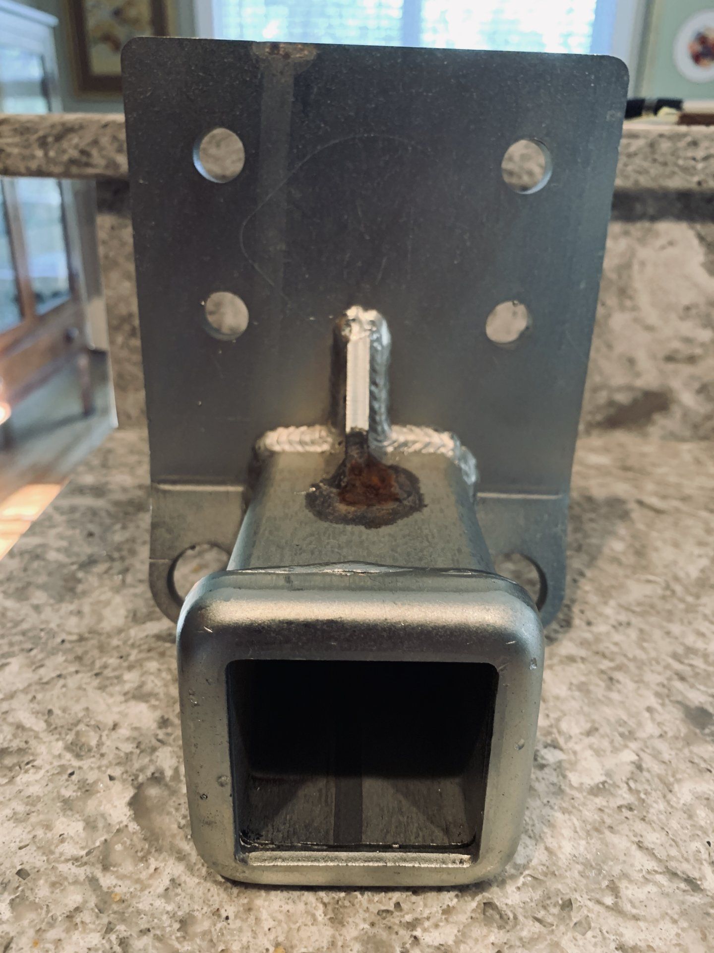

I had a friend from IH8MUD placing a big order with Mark’s Off-road so had him order for me a hitch to replace the tow ball hitch set up from the factory. It looks well made to me and I’m happy it appears I may be able to leave the step in place. I was going to run out and buy etching primer but decided to try a 2-in-1 paint + primer product from Rust-oleum I had on hand. I’ll try to do a follow up on the product’s long term performance. The paint went on really well and the any-angle spray seems legit.

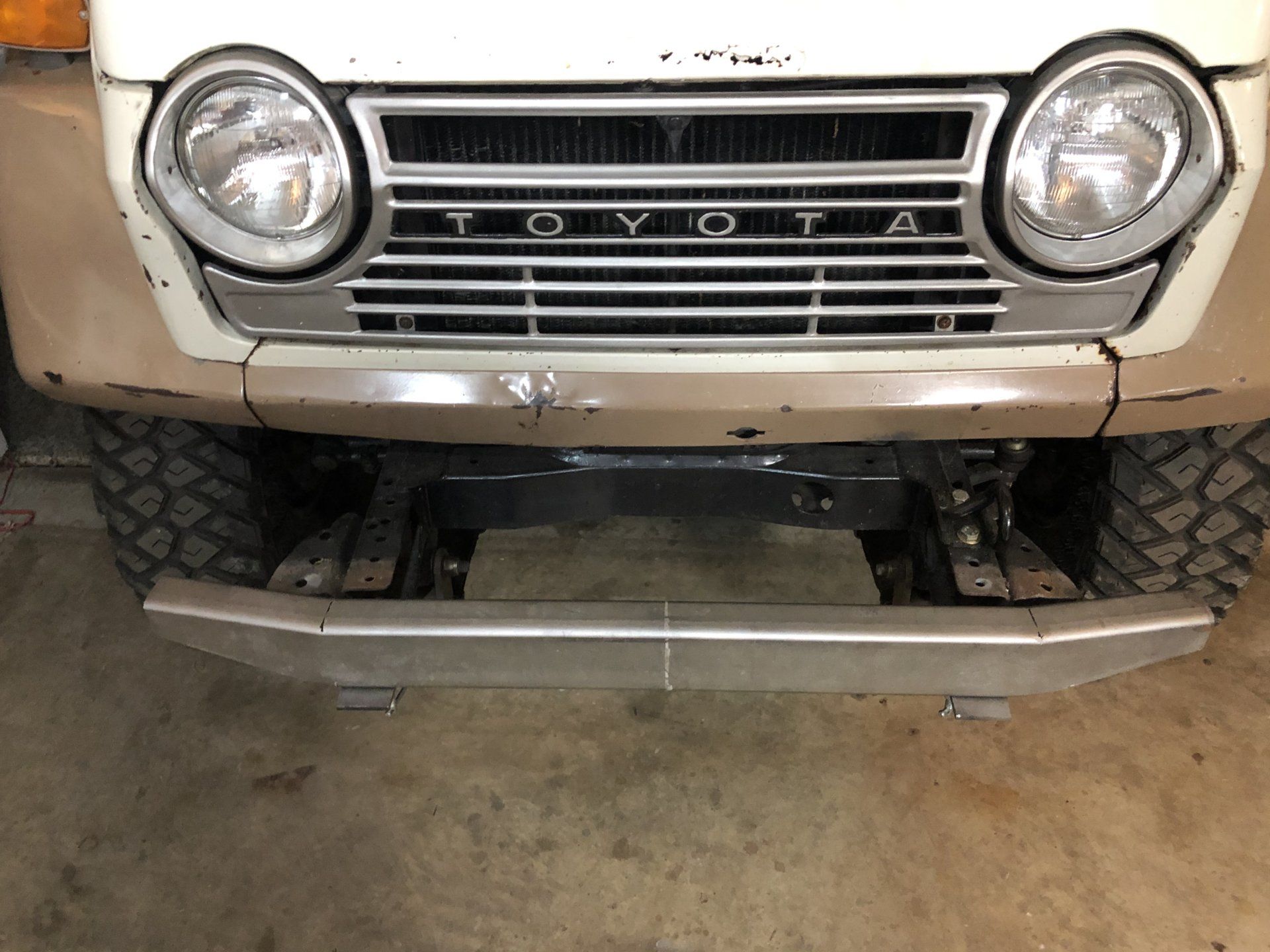

Making a new bumper for Bucky to install an 8274.
Original bumper is pretty beat up.
New bumper is fabbed from a piece of scrap 2x4 tube. I decided to make the new bumper a bit shorter. I tapered the ends and bent them back 10 degrees. I plan to cut out and weld on a winch plate, box in the bumper ends and add weld through clevis points.

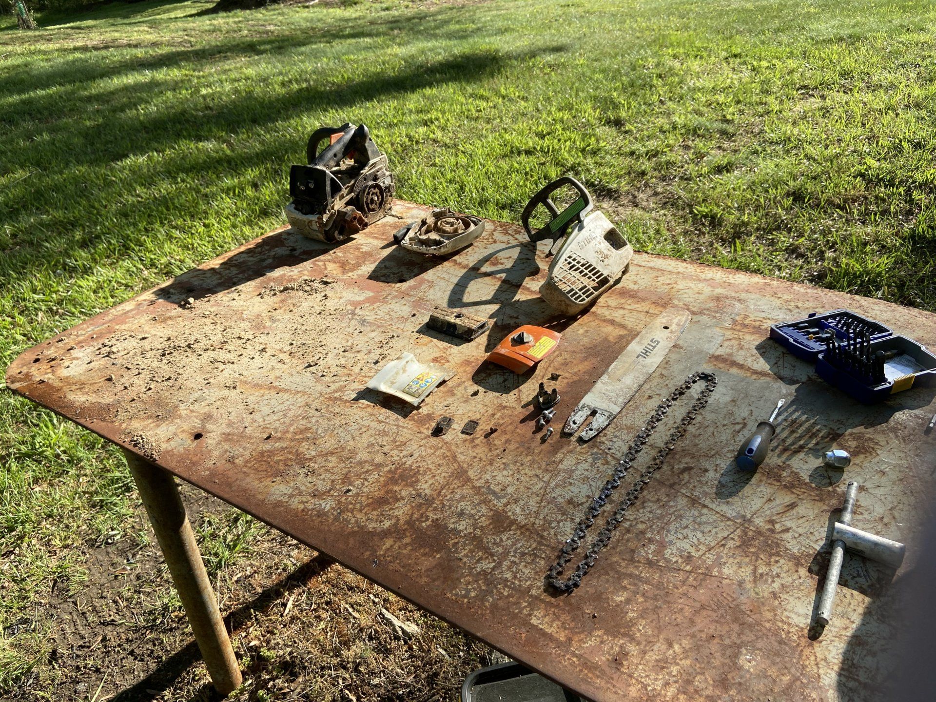

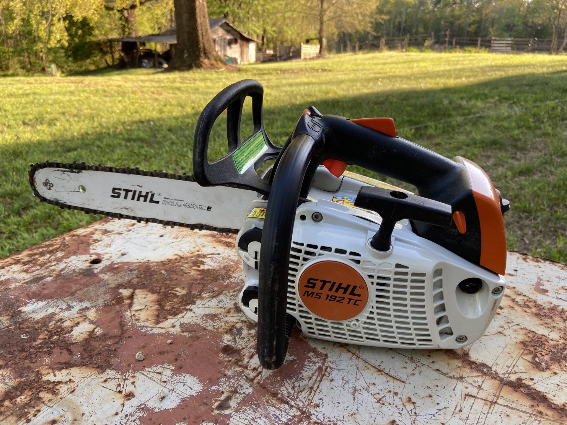

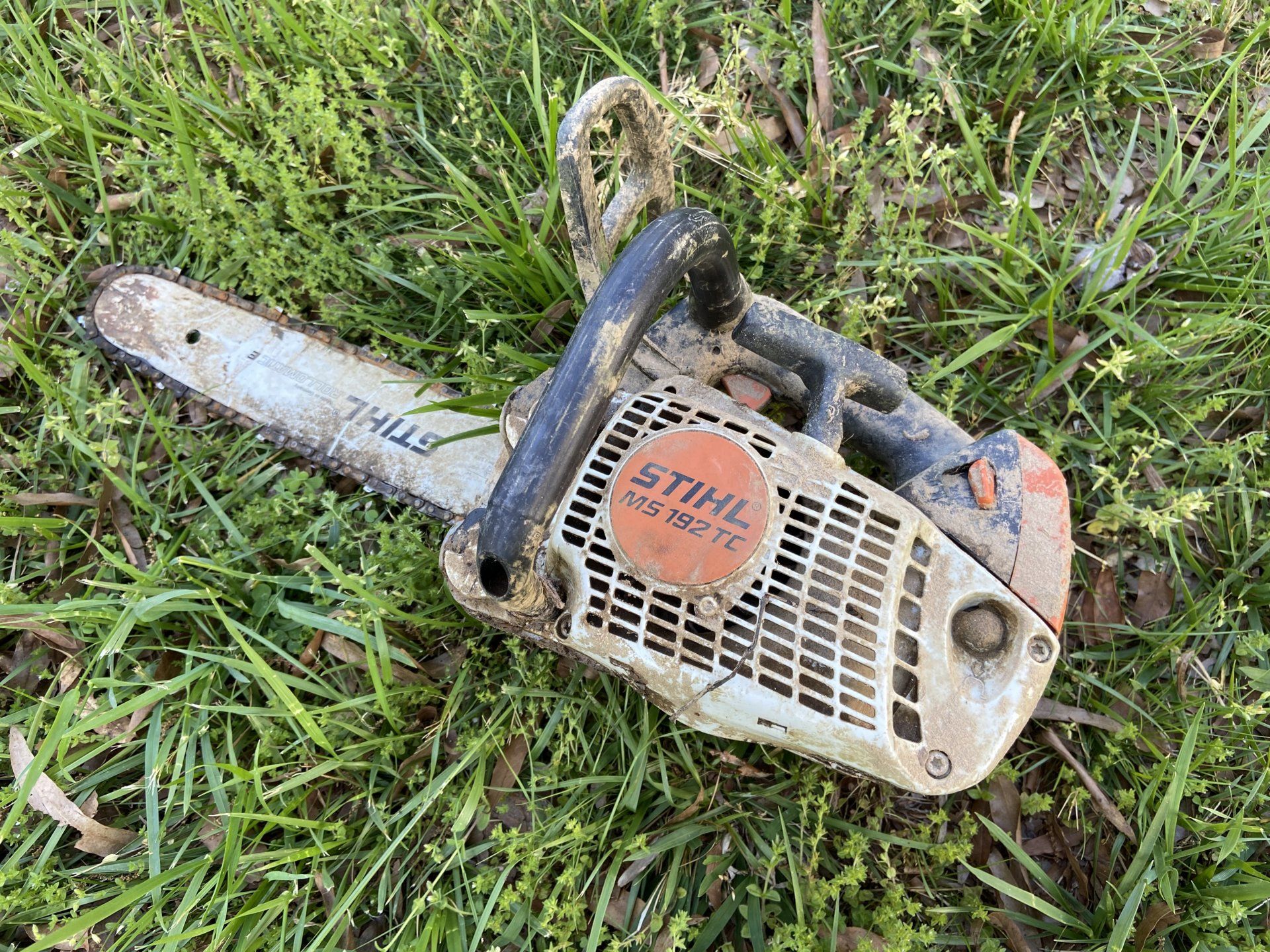

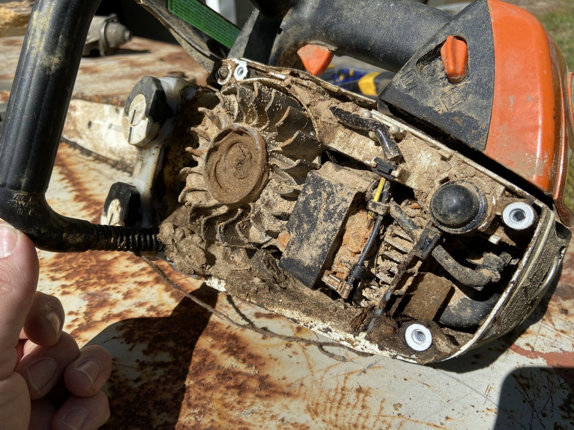

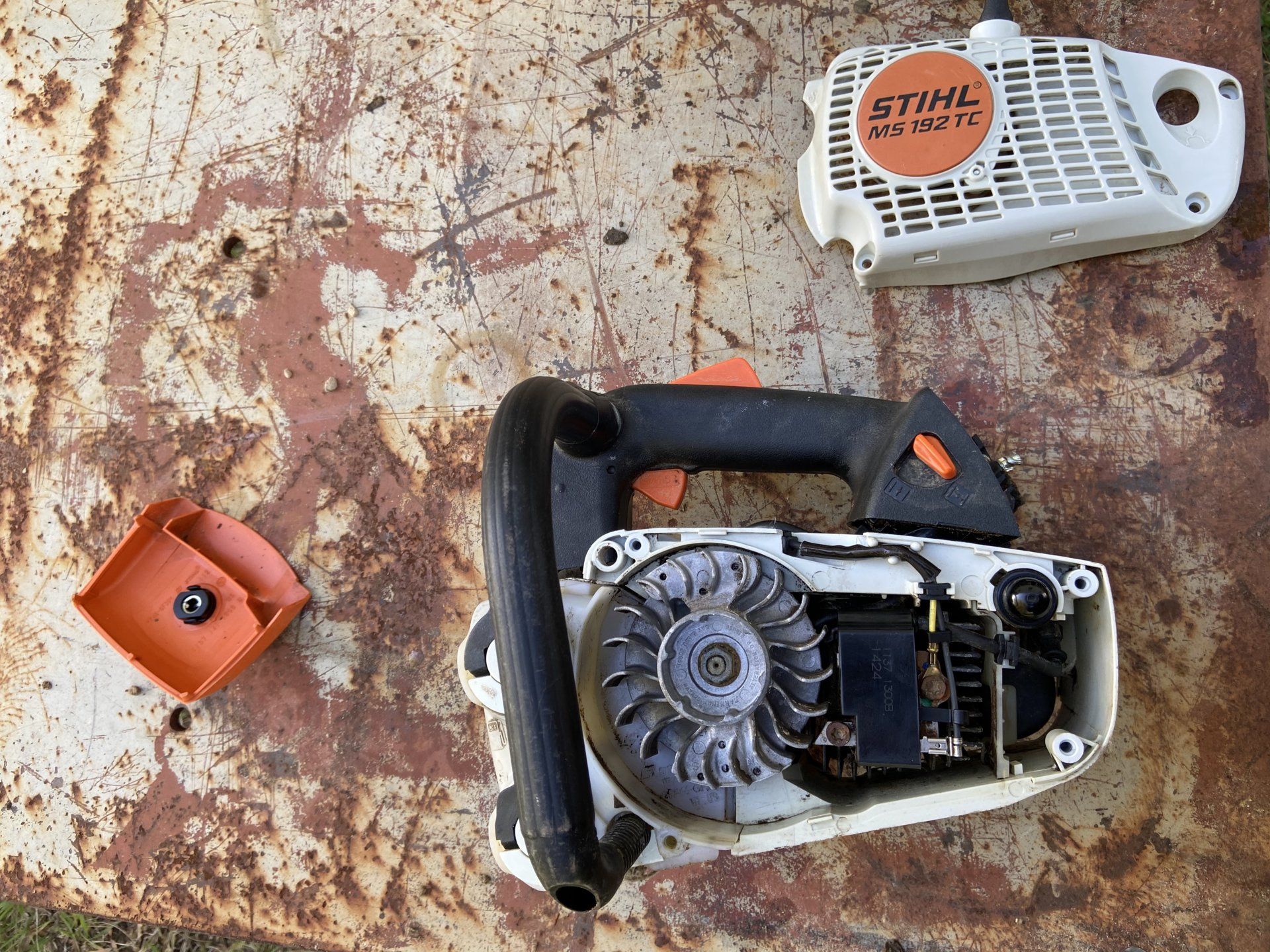

This one is carried over from the fishing thread.
Cleaned up nicely. Will dig into carb tomorrow and grab some fresh gas and cross fingers. At worst case I saw a tune up kit with carb, bulb, plug, air filter for $60 online.
Thats nuts! Is the motor free Or locked up?
