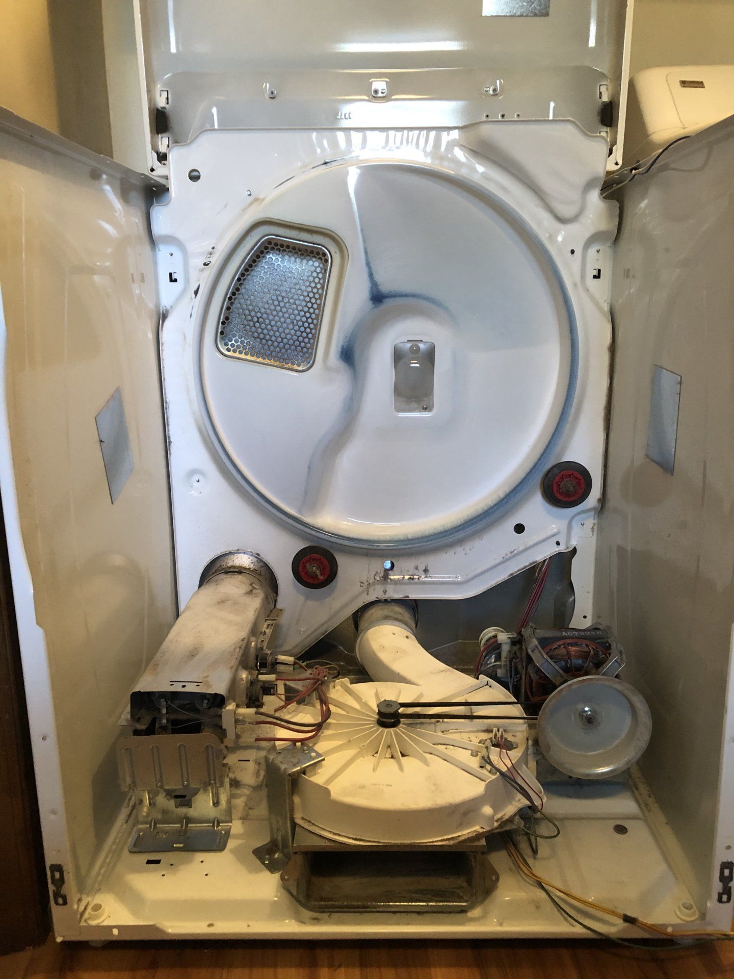

Does this count? Since I couldn’t make it to the M&G this weekend, I decided to make myself useful and replaced all the rollers, belt, and idler pulley in the dryer to get rid of a horrible squeak/squeal. Vacuumed a couple pounds of lint out of the dryer, so it may be time to clean out the ducts.

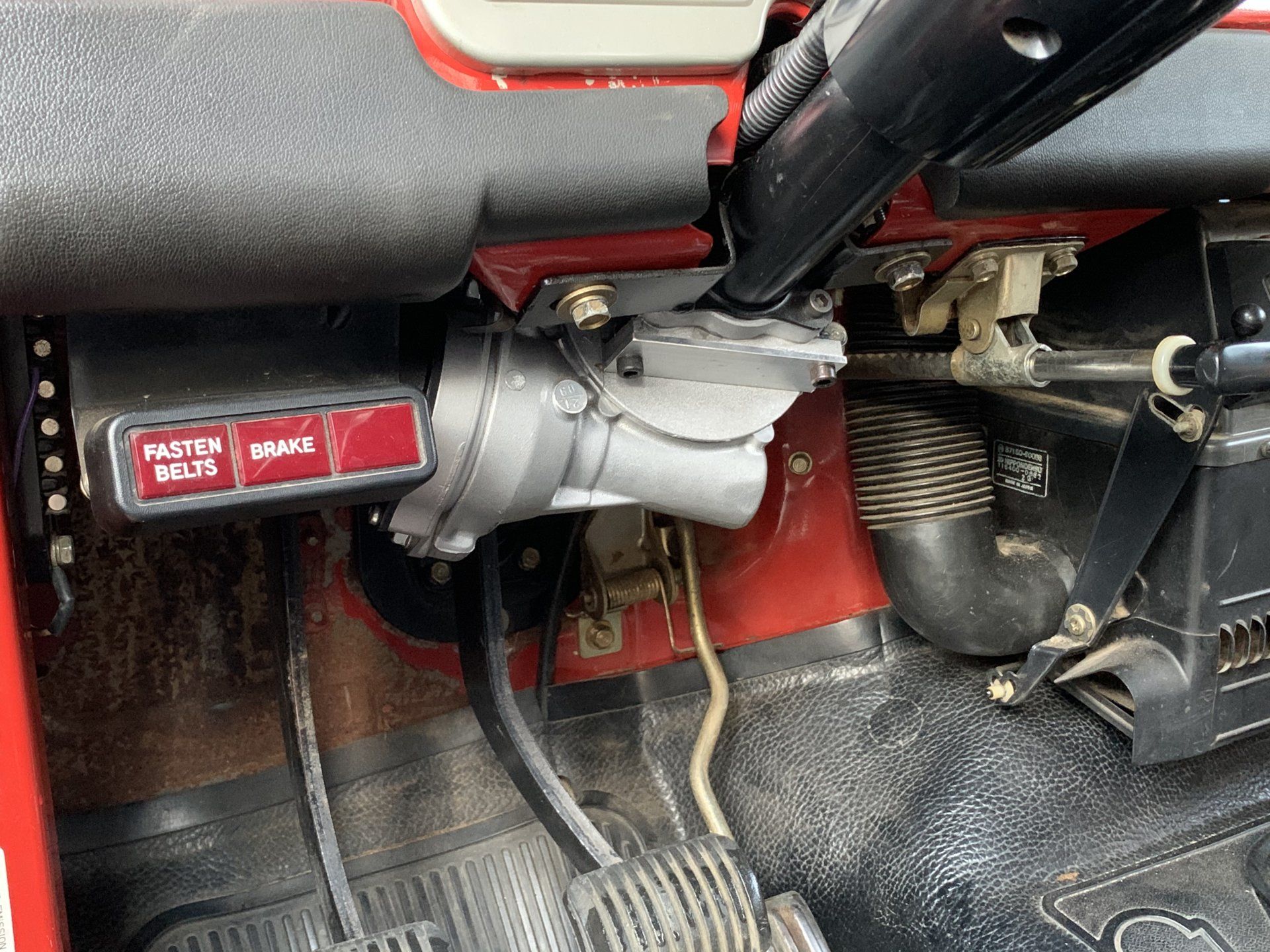

My 40 has received a lot of love in recent weeks. Thanks again to @roadstr6 and @forrest5000 for their help, advice and support, @Roxx for organizing the small group buy for the suspension and @Trollhole for fitting me into his already full schedule at the shop. Dobinsons suspension, 16” wheels, Yokohama Geolander tires, new hubcaps, and electric power steering. The wheels and bezel were repainted Cygnus White to match the top.
More improvements to come over time but for now, here is how she looks.
Looks great and nice choice on tires. I hope to enjoy the same ones someday...when I get around to finishing my yellow truck.
I saw where you did the Toyota H4 headlight upgrade and took that as an endorsement. I did that as well since I already had the bezel off. The combo of that and the LED gauge cluster upgrade a while back makes night driving more enjoyable.

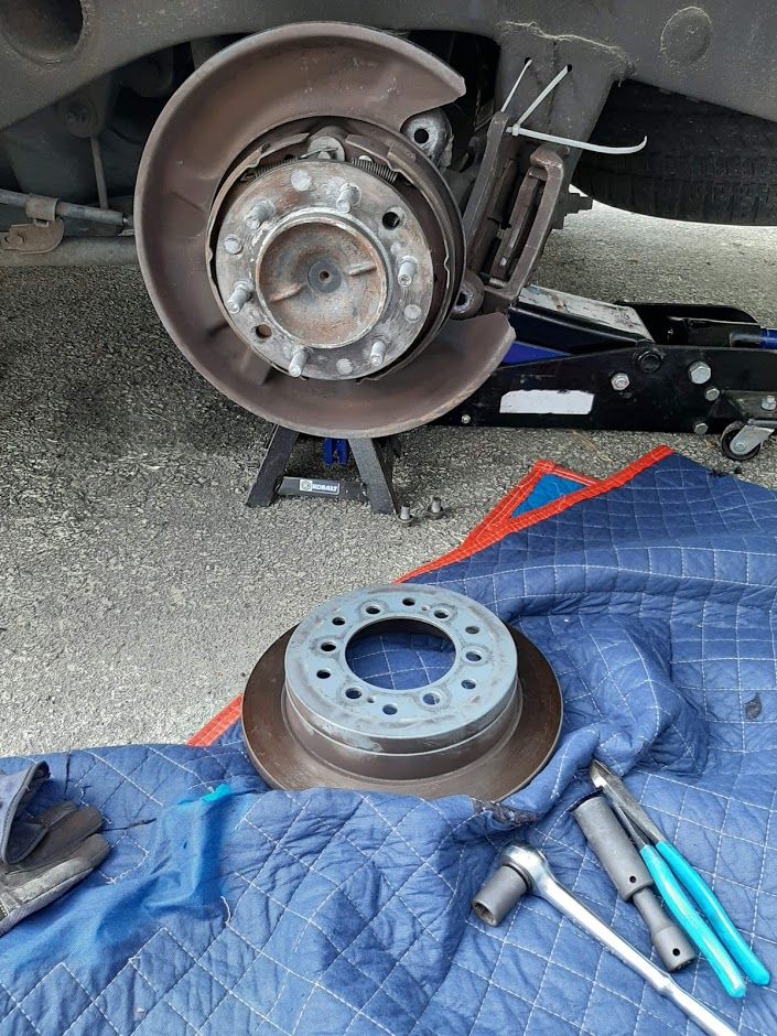

rear calipers swapped yesterday, and started on the front end. passenger side receieved new hub bearing assembly, power stop drilled/slotted rotor(to.match the rears), new caliper, power stop towing pads. capped off with new Rad Rubber fender trim to replace the broken OEM.
today was drivers side loving, same stuff as above. also sucked out the front diff gear oil. could not get the drain plug knocked loose, even with pb blaster, heat, heat heat, electric impact, air impact, and floor jack with high lift handle could not breaking loose.
to do list is still rear axle bearing assemblies and seals, and parking brakes

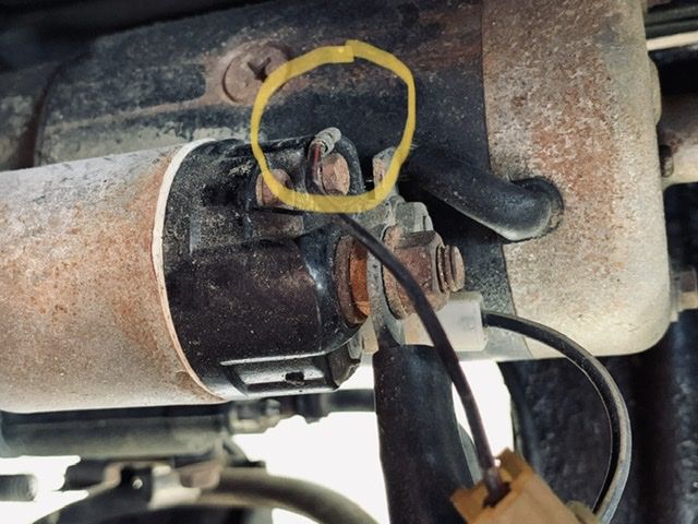

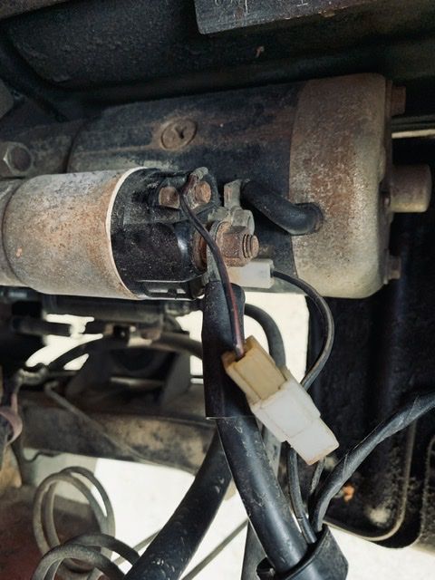

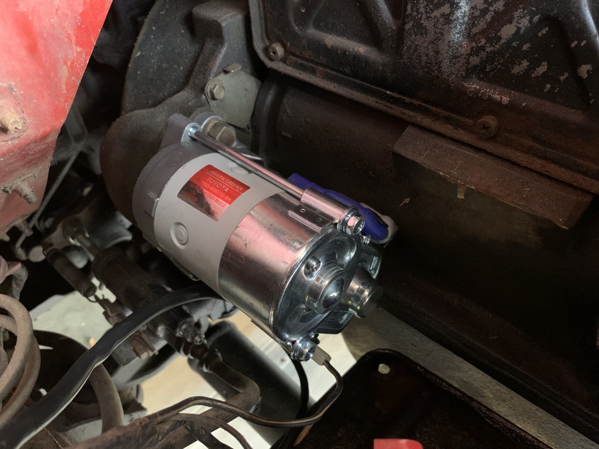

As I have had to hit the starter with a wrench more than a few times over the last few years, I decided to finally replace the starter. I read on mud that a 60 series gear reduction starter would make a great upgrade. I got a rebuilt one from a Toyota dealer and had to get a new battery cable as the one from the factory was 1-2” short given the new starter is remarkably more compact. Started right up after installation and sounds like a newer vehicle. Ended up not reconnecting one of the wires (red/black) off the old one (circled). No clue what it was for. Any guesses?
View attachment 2253776View attachment 2253777View attachment 2253778
The wire you are referring to goes directly to the ignition coil. It sends 12 Volts to the coil during startup to increase spark output. When the key goes from the "start" to "run" position the coil then runs on 6 Volts via the Ballast resistor.
