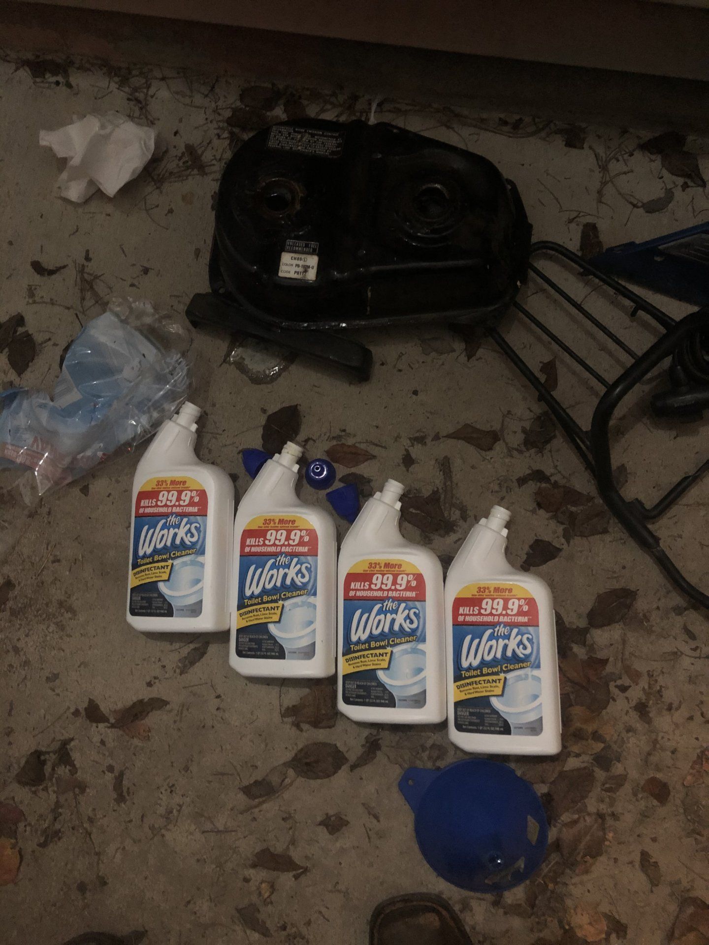

While trying to diagnose the fuel delivery issue of my moped, I discovered the gas tank was rusty. After doing some research I found a great trick to clean it that worked great! I bought 4 quarts of “the works” toilet bowl cleaner. I filled my tank up to the brim with it and let it sit over night and it worked wonders! My tank is now completely rust free. The cleaner is 9.5% HCl which is what allows it to eat rust, it was $5.50 for 4 quarts at Wally World and I think it presents itself as a good economical rust eater for many projects. Just thought I’d share that with y’all.
I’ll get one when I get home from class, I just barely had time this morning to look in the tank before I had to leave.
I tried to get one yesterday but couldn’t get a good picture of the inside. I couldn’t seem to hold my phone right again. But it was almost completely bare metal except for a few small spots of flash rush I guess I missed with WD-40.

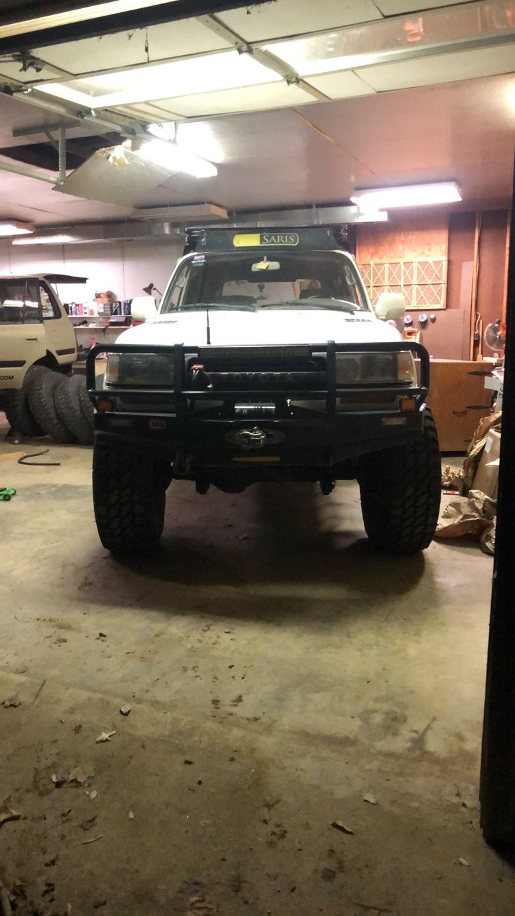

Also tried 40s on Dipty to see how it would fit and clearance. I see 40s in my future after minor trimming.
Nice work. You will break that truck in half with 40s the way you wheel, lol.

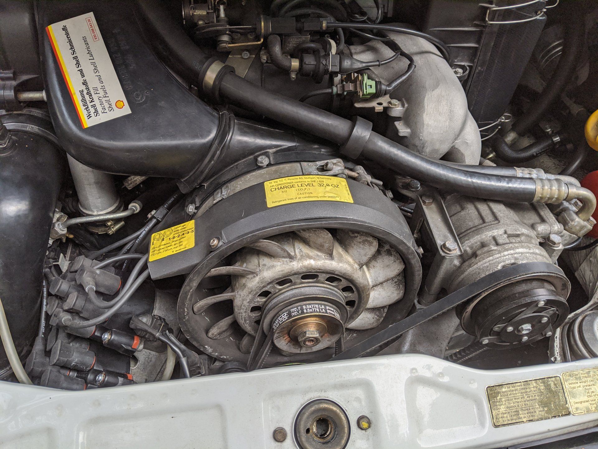

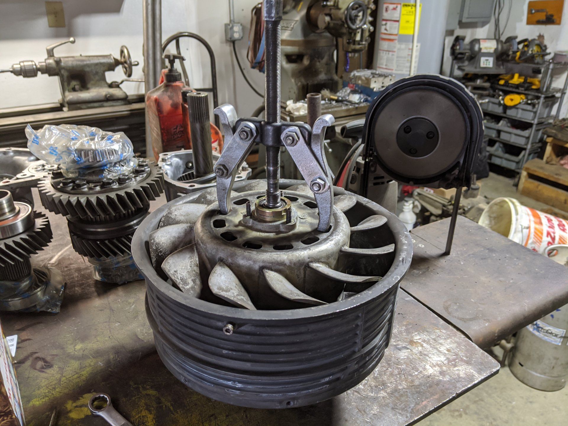

Wrenched on a buddy's German iron on saturday, after he lost an alternator pulley on the way to my house. Had to take the alternator out to reseat the engine fan on the alternator, then put her back together.

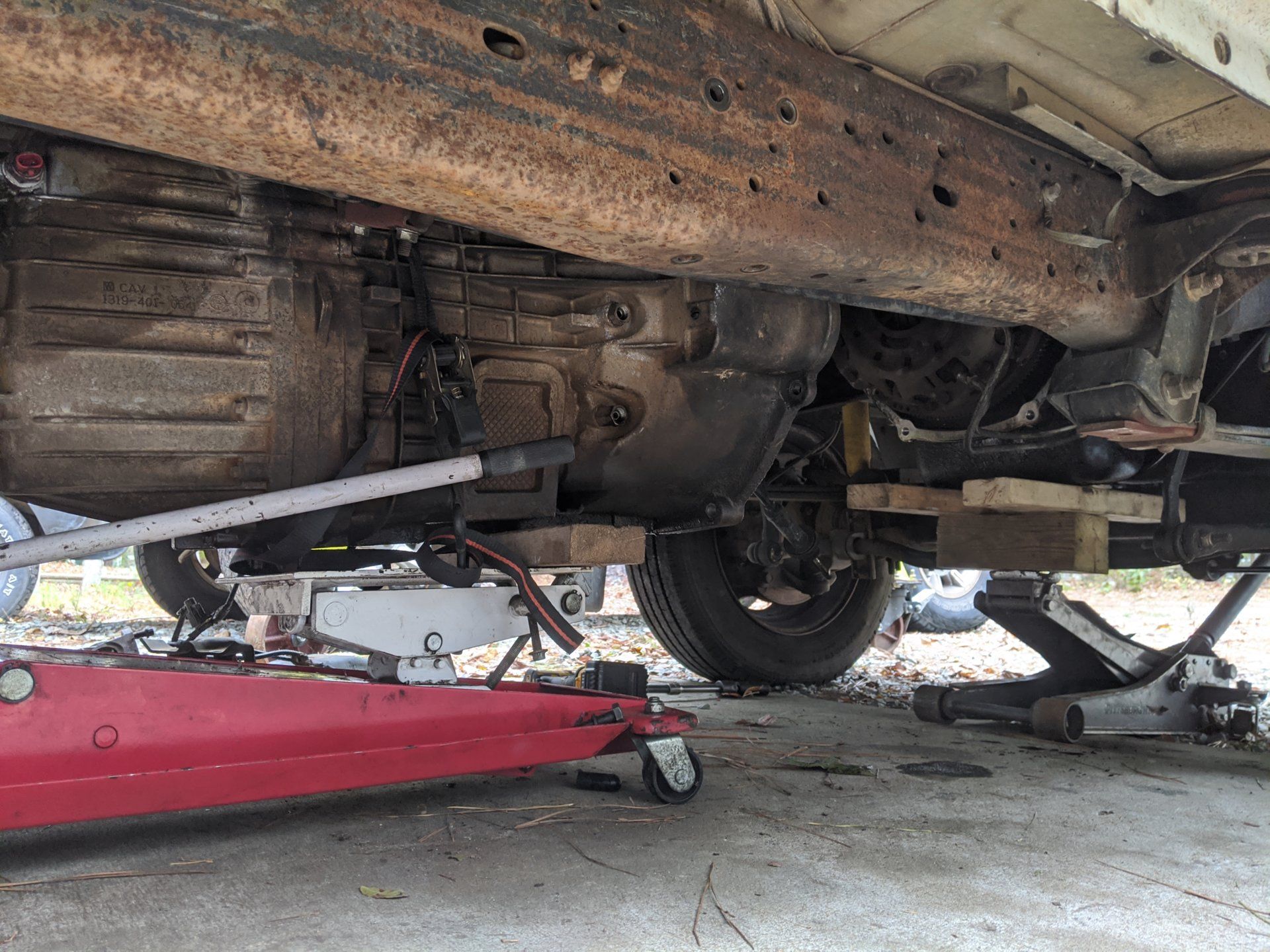

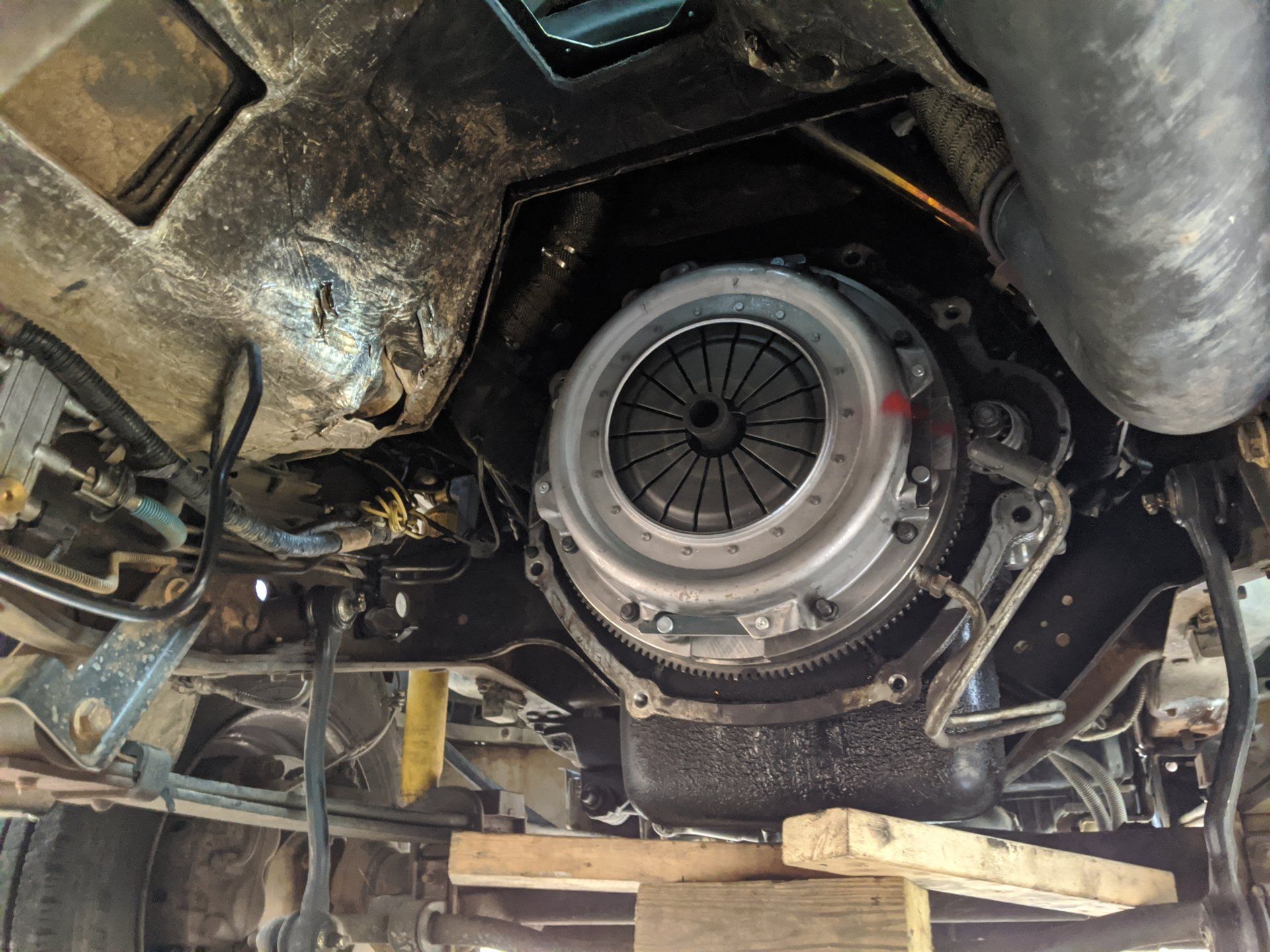

Today I got a good start on the ferd's clutch today before being chased back inside by rain. Thanks to @DeeRex for bringing my transmission jack back home :D

That ford trans is big, eh? Any surprises so far or just straightforward swap? Did you decide to upgrade the disc?
Flipping enormous, but surprisingly easy so far. Upgraded from stock single disk to a dual disk organic clutch from valair.

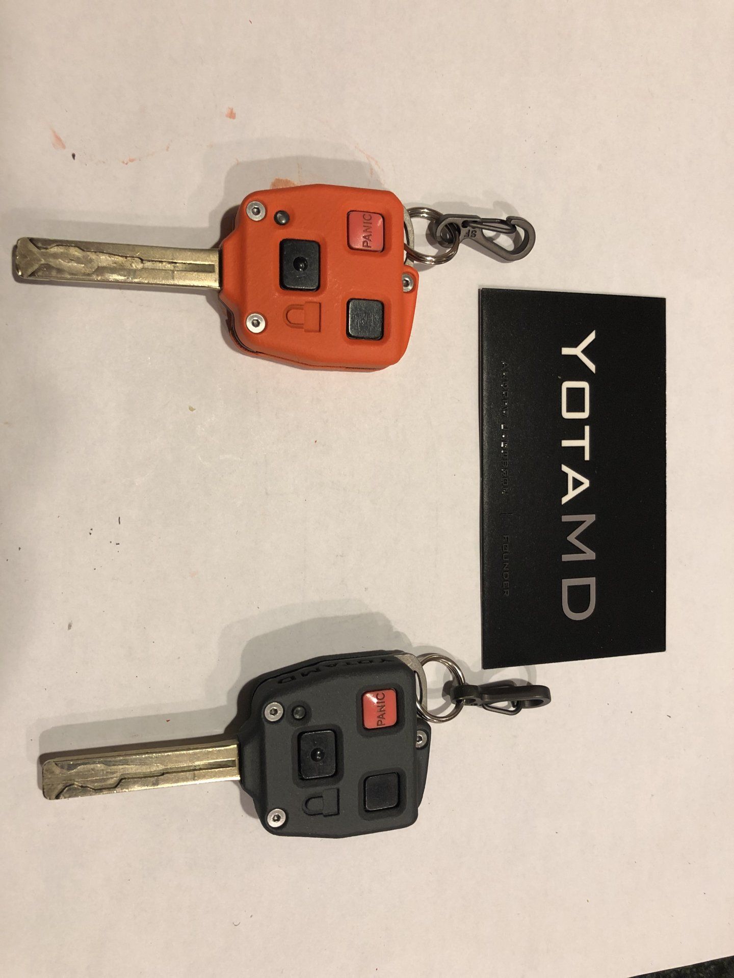

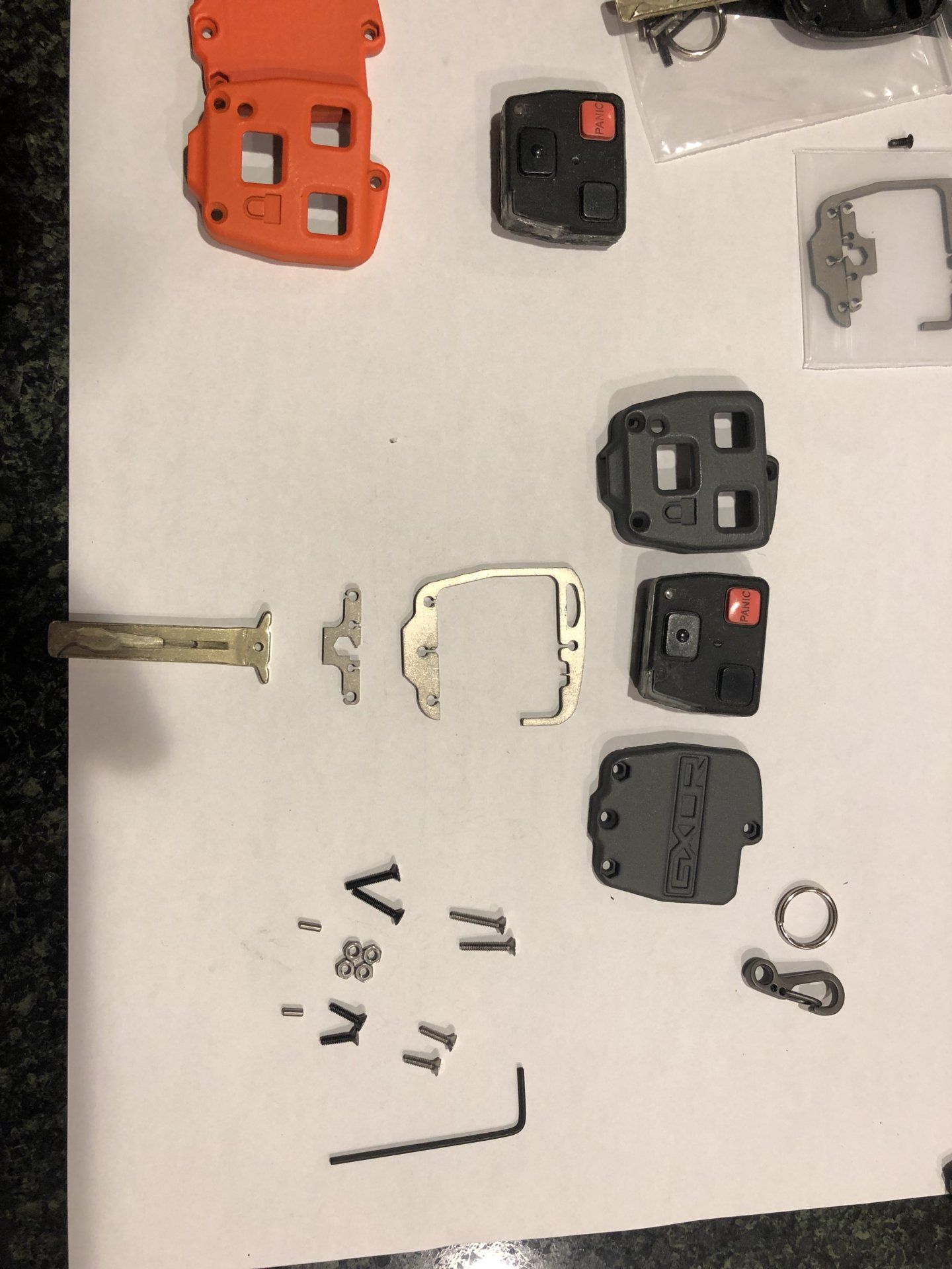

His and hers key bodies from YotaMD.

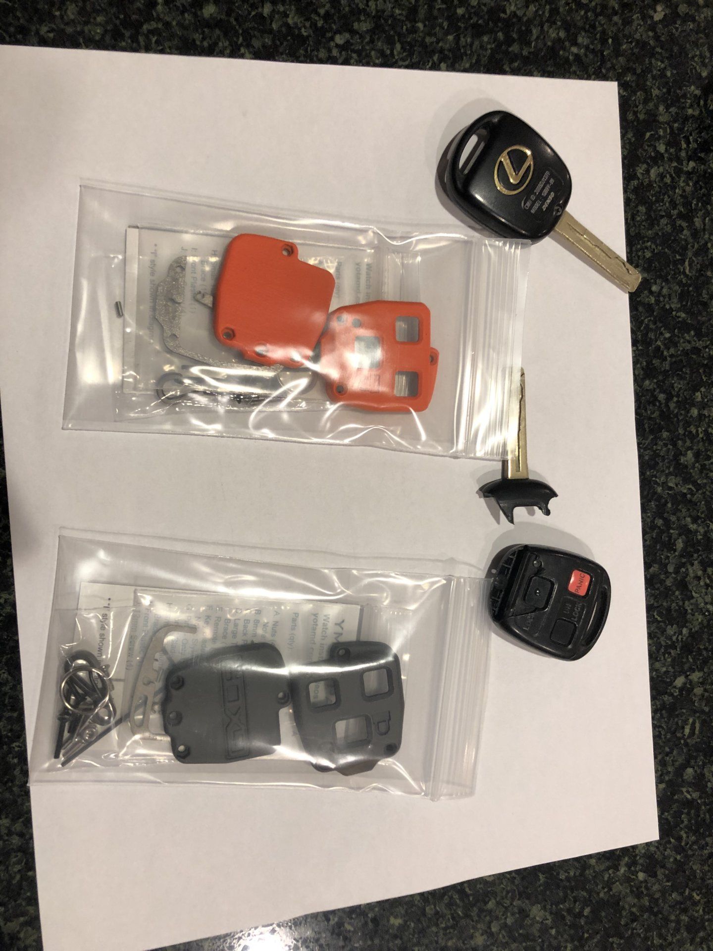

For those who don’t know, Lx470/100 series keys are not designed as robustly as the rest of the vehicle. The big square body gives you plenty of torque to crack the crappy housing. Over on the 100 section YotaMD is selling 3D printed bodies with fancy Ti reinforcement. YotaMD Titanium Integrated Remote Key Fob Shell
One of my keys had failed and I could feel a failure coming on the 2nd, so I ordered up a few kits.
Digging in, it’s a nicely made kit, with metallic or black oxide hardware (both included), and a few extras you can keep in the parts bag and toss in the glovebox just in case field service is required. The body is a tidy 3D printed design, and there are 2 laser cut (maybe water jet) Ti pieces that act as a reinforcing frame and hold the key blade very securely.
I got safety orange for me, cuz I’m an idiot and I lose stuff, and a stylish gun metal grey for the wife.
I did the wife’s key first, and everything went together great. Feels way more solid, and she was pleased with the looks.

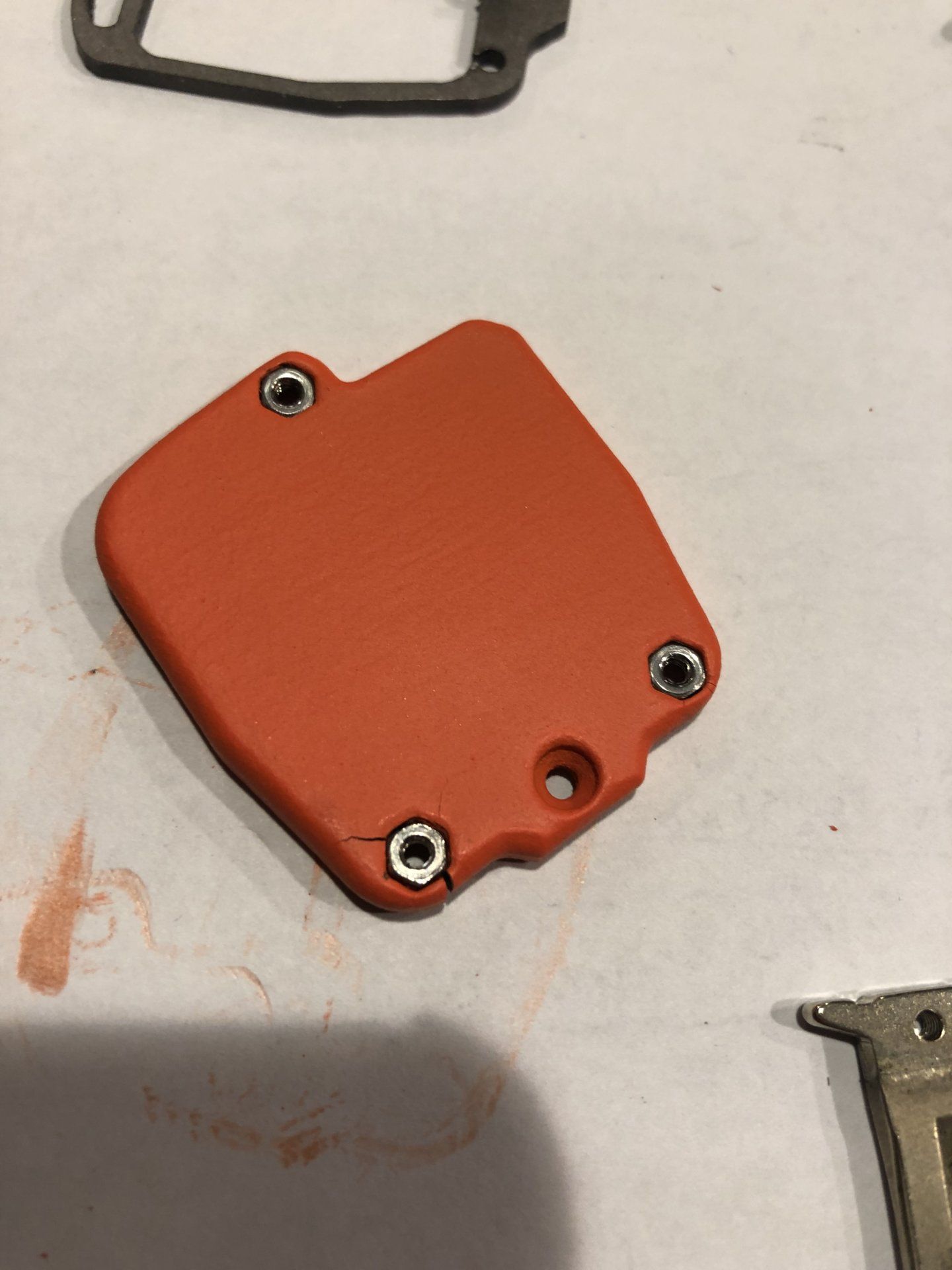

Mine was a bit tougher. All the recesses for the nuts were very tight and sadly one corner cracked a bit getting the nut in. I think is due to 3D printing not being wildly precise.
Even with the crack, it’s way more solid than stock. I dabbed a little superglue gel in there to mend it. -before anyone jumps in here- I have NOT brought this to the attention of @suprarx7nut so he has not had a chance to respond or add any comment.
All-in-all this seems like a nicely made product by a small mud vendor. They aren’t cheap, but you can tell a lot of design work went into the product and now I won’t be worrying about another key coming apart at an inopportune moment.
If not for the cracked housing I’d go 9/10.

Well that's a first. Weird. The cerakoted nut recess can vary a few thou in width due to coating application variance and I'm guessing that yours was real tight. Too tight, apparently.
Regardless, hit me with a PM with your name or order number so I can get you a new back! That cracked back is no good, we gotta get you squared away.

Got the clutch install wrapped up last night. Easiest clutch install of my life. Was able to slide the transmission all the way into the clutch on the first try, no issues, no fiddling, no alignment problems, no cursing. Currently in the break-in period, but everything seems good so far! Fingers crossed.
