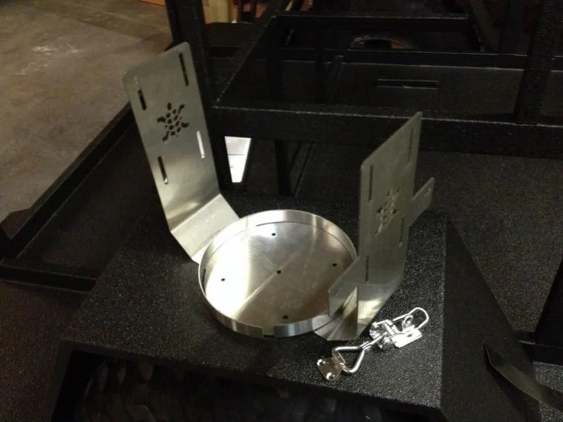

Hi Lou,
Here's the standard propane tank/hose/regulator. Yours will have the Squatty 11# tank. I use a bolt together adjustable regulator rather than the crimp together tin unit. The hose is high pressure propane cloth covered for uv protection and is stainless reinforced. The hose ends are serviceable with standard wrenches if there was ever an issue the tank fitting is o-ring sealed, hand tightening that works on old and new tanks and is all brass.
The polished stainless latch on the bracket is padlock able and adjust for short or talk tanks.
Just some more goodies.
Dave
Where did you get the propane bracket?
Pete, second page has a few different shots of the bracket which you'll notice has the turtleback logo... All the metal work is from Turtleback Trailers
Lou
