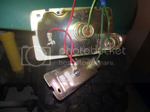

Turn signals won't blink?
So I have 2 blue one connects to a blue and red wire that connects to a 15 A on my fuse box, the other connects to a green wire. Which do you want me to test as left at the switch? And I am assuming this is my switch box:confused:.
no, your turn signal switch is at the steering column where the lever is
I put the part number 83260-60010 into a Google search and it said "speed marker" - nothing to do with flashing
I don't know offhand what the part number for the flasher relay is, but in my recollection, the relay is flatter and black, and it's higher up in the driver side footwell, at least on my '72
also, if I recall correctly, there is no B/G wire in the turn signal wiring circuit
have you looked at Coolerman's wiring diagram for a '71 ? that should answer it all
