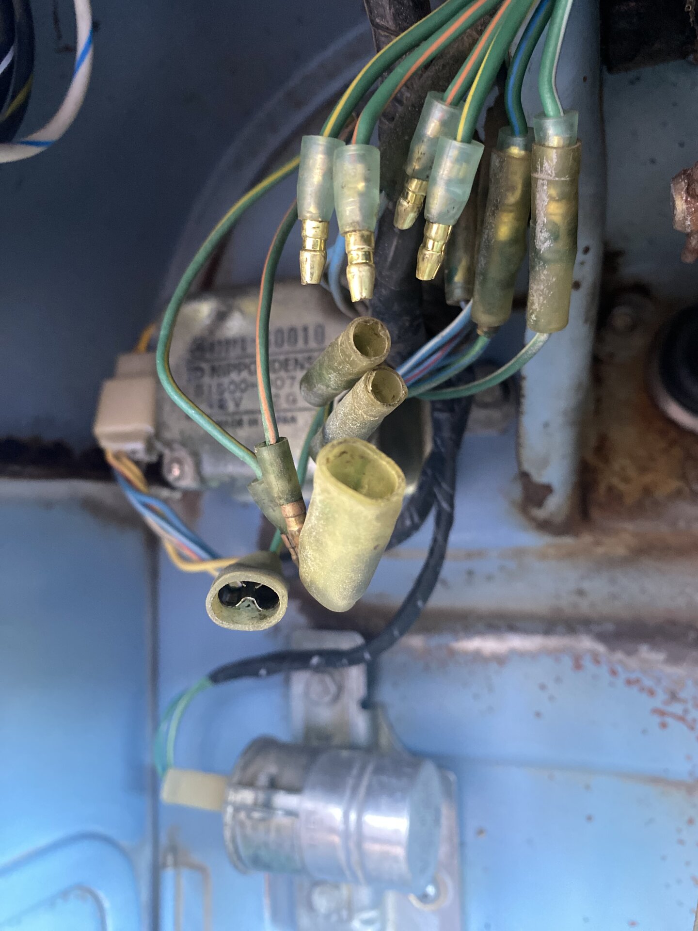

I can go check in a couple hours on my 65.
I’ve gotten them kind of sorted.
The dash lights are still backwards but the right side (front and rear) blinks (no dash light, but I know it works because when I hook them up ‘correct’, it comes on with the left side).
The left side stays on but all the lights come on.
The flashers don’t work anymore, after replacing the turn signal switch (they did prior but I don’t think both the dash lights did).
The dash lights no longer come on with the brake pedal.
According to my meter, each pair of switch wires put out 12 volts when told to (left or right).
Right now I have:
Each long switch wire (GY, GO) going to its respective single connector at the body.
Each short switch wire (GY, GO) going to its respective double connector, with the (swapped) dash light wires coming back out.
Not sure if this is helpful. They are like you said. Long goes to single terminal. Short to the double. You can see the dash bulb indicator wires going to their respective double connectors as well:

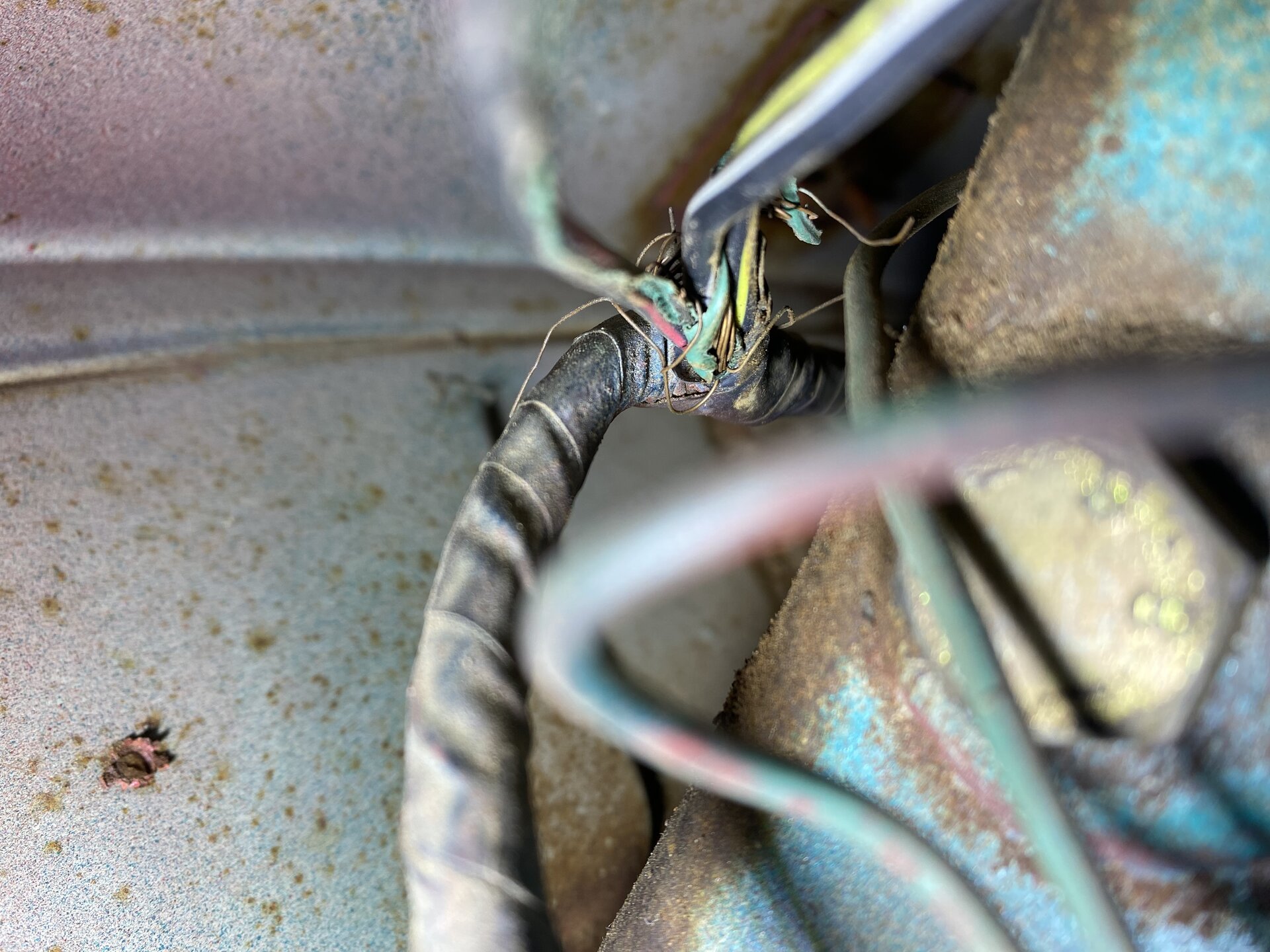

Also, I’m glad I checked this area because I noticed this super frayed wire up there as well. :doh:
Edit: happy to report it’s not live under any scenario. So must have been bypassed at some point. Not sure what it was hooked to originally, but happy it’s dead.
