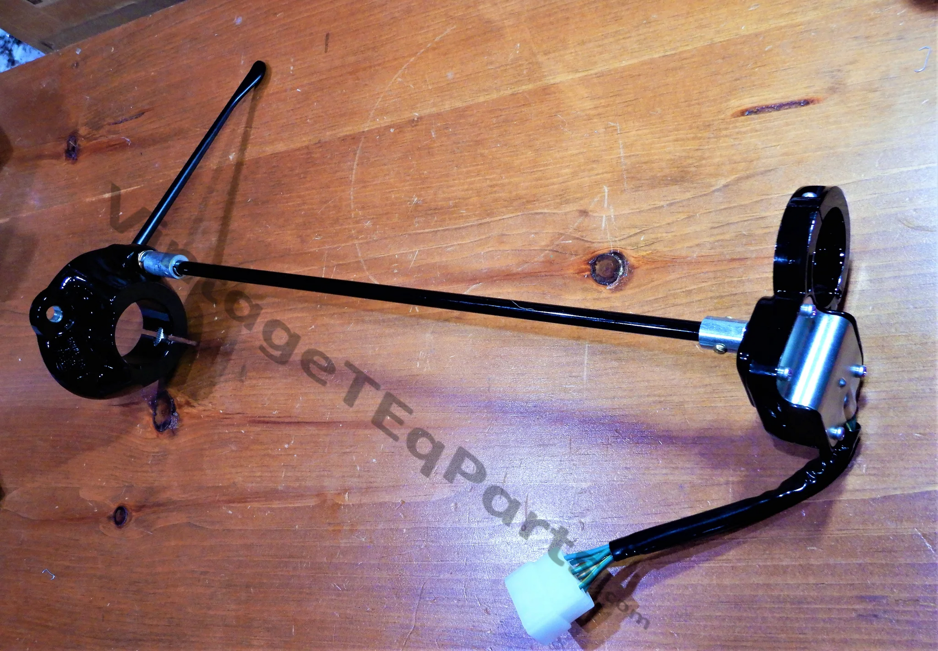

I'm not sure what the date of manufacture is for your truck, but according to Switch & relay for Toyota Land Cruiser FJ40LV - Genuine parts - https://toyota-usa.epc-data.com/land_cruiser/fj40lv/3677/electric/8401/84310/ an OEM replacement is available for manufacture date 03/1969 P/N 84310-6002.

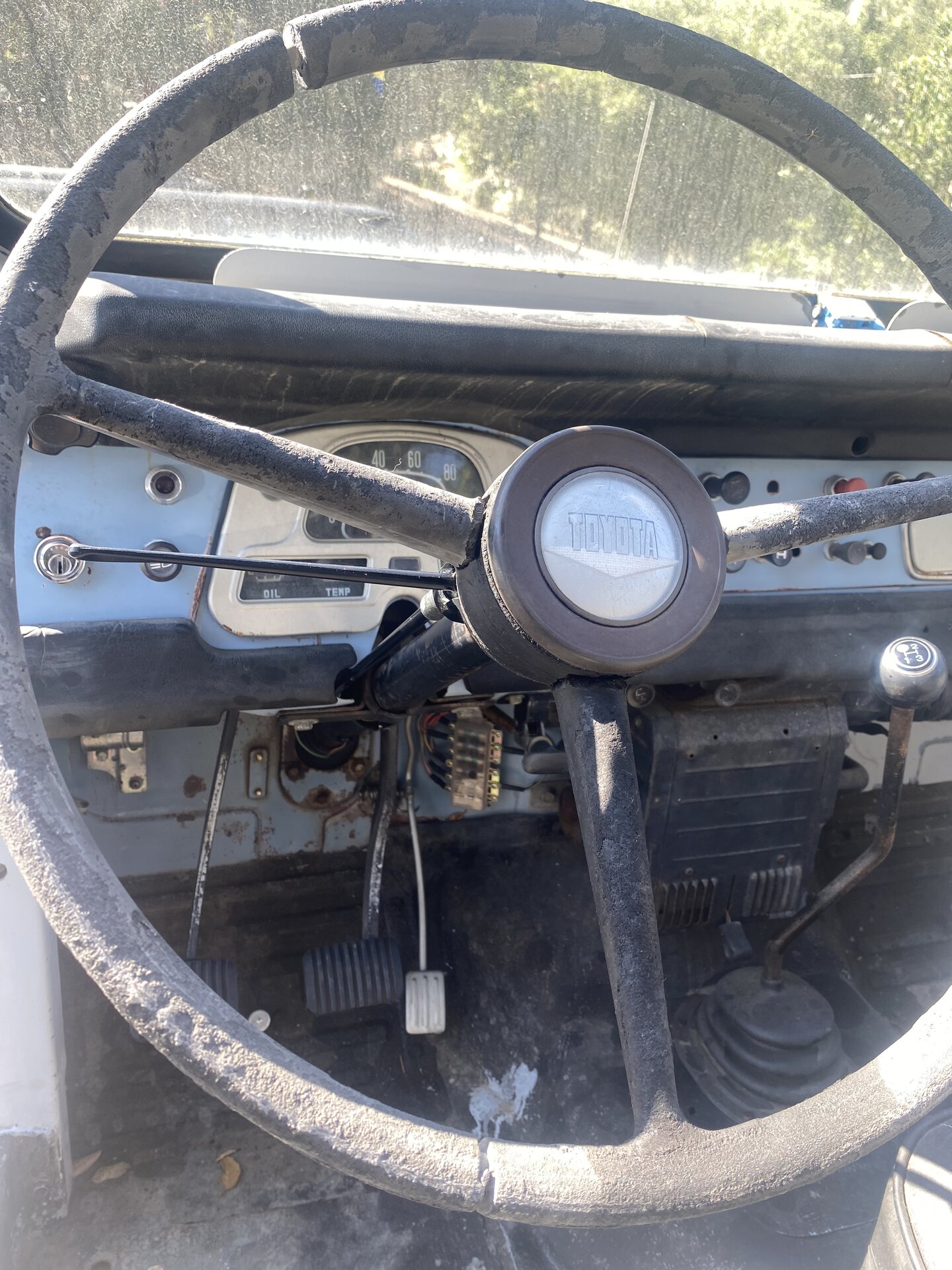

Minor wire routing question—
Does the harness go above the brace, or below like shown?
Probably makes no difference but it seems like it rubs on the stopper bolt thing.

I think the only real difference is that OE early arms were chrome while the updated unit has a black lever. This same unit even works on '72 up to the new column design in '74 but you must cut the bullets and put the plug with spade terminals on or otherwise make an adapter harness. I think Coolerman sells the adapter harness
Or you could get the one @ToyotaMatt sells with the plug on it.
I think mine only has one 😕
It should work with one, but I have found on my '72 that the canceling only works well and all the time turning to one side. The other side does not flip the lever up but does at least switch off the turn signal light.
