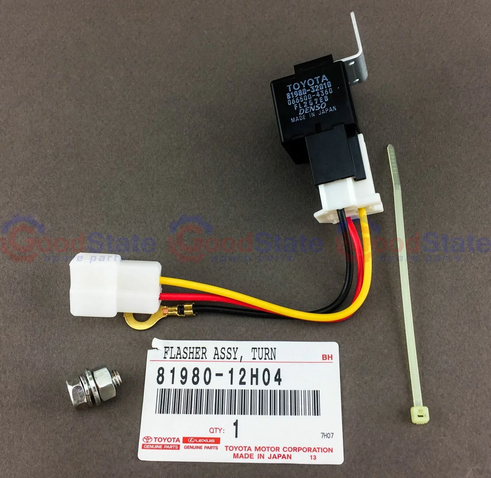

I tried combining the two L-terminals and got mixed results. The turn signals worked fine, but once I switched on the hazards, I got nothing.
I did notice that the two solenoids in the old relay were electrically tied together via a capacitor. Is the capacitor (draining/charging) what generates the flashing/blinking?
So you attached the Green and the Green/Blue wire from the harness to the L of the new flasher and got nothing on the Hazard side? That would indicate an issue in the Hazard switch...
Yes the capacitor ( and a resistor) are what creates the timing of the flashes. Normally it is the capacitor that fails causing the flasher to stop working. Unfortunately I have never located a replacement. The value of that cap is a mystery though I bet a 2200uf 16V cap would be a good place to start.

Hey guys, just rebirthing this thread as I have some slow flashing indicators (turn signals) and hazards. They flash close to normal when the engine is revving higher but at idle they're far too slow. And they're getting slower...
I'm assuming a new relay will fix the issue but does anyone know how the new 2 wire (+ earth) relay can replace the original 3 wire (+ earth) relay?
