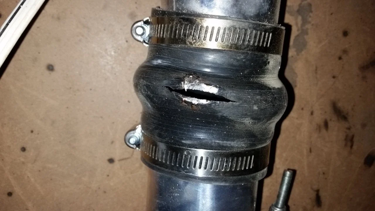

-Hole burned in silicone coupler that was in contact with the turbo blanket (somewhat expected and planned on re-routing)

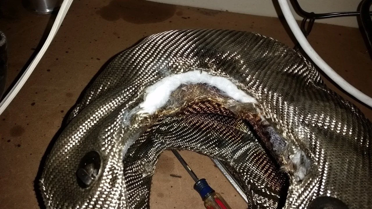

-turbo blanket itself is burned through and unraveling already (cheapest blanket money can buy lol)

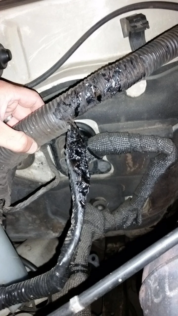

-heat damage to wiring harness nearest to downpipe

Busted coupler
Shredded blanket (still ok to use?)

Very close to melting important wires

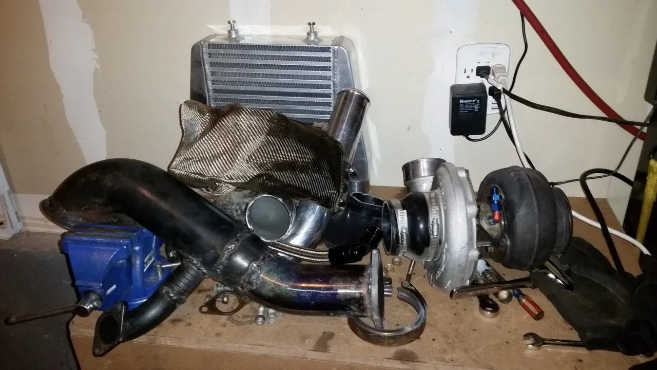

"Turbo kit" sitting on the bench with all the tools required to install. It all came apart in about an hour and a half
Damn dude, yeah the exhaust moving could easily translate to leaking v-band connections. Put a straight edge on them when you unbolt them just to make sure they weren't bent.
The turbo nuts you knew about, you just didn't want to have to take things apart again... :doh:
Even the cheapest turbo blanket should not have any issue with how little you are pushing this turbo! Hopefully you can get a replacement.
Yeah I double wrap everything near the downpipe. Check your A/C line as well.

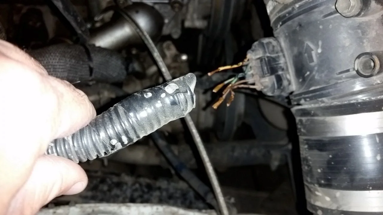

Oh yeah, I pulled apart my MAF wiring trying to get the valve cover ventilation hose off
