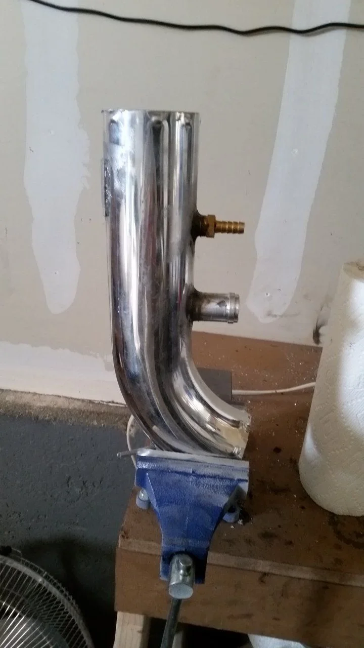

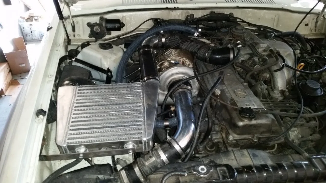

Got a lot done today. Sealed the oil return line so it should definitely not leak anymore, clocked the center housing away from the manifold a little bit to keep the oil return a little cooler (was pretty much touching the manifold), got the downpipe wrapped and painted again, and all bolted up using copper gasket maker in addition to the gaskets. re-routed charge pipe so it doesn't come in contact with the turbine housing, heat wrapped said charge pipe for good measure, re-worked intake since my BOV recirculation hose is now going to route towards the passenger side. Didn't quite get finished up, but a lot of progress!
New charge pipe routing:
Intake (plugged old recirc fitting, moved to other side)

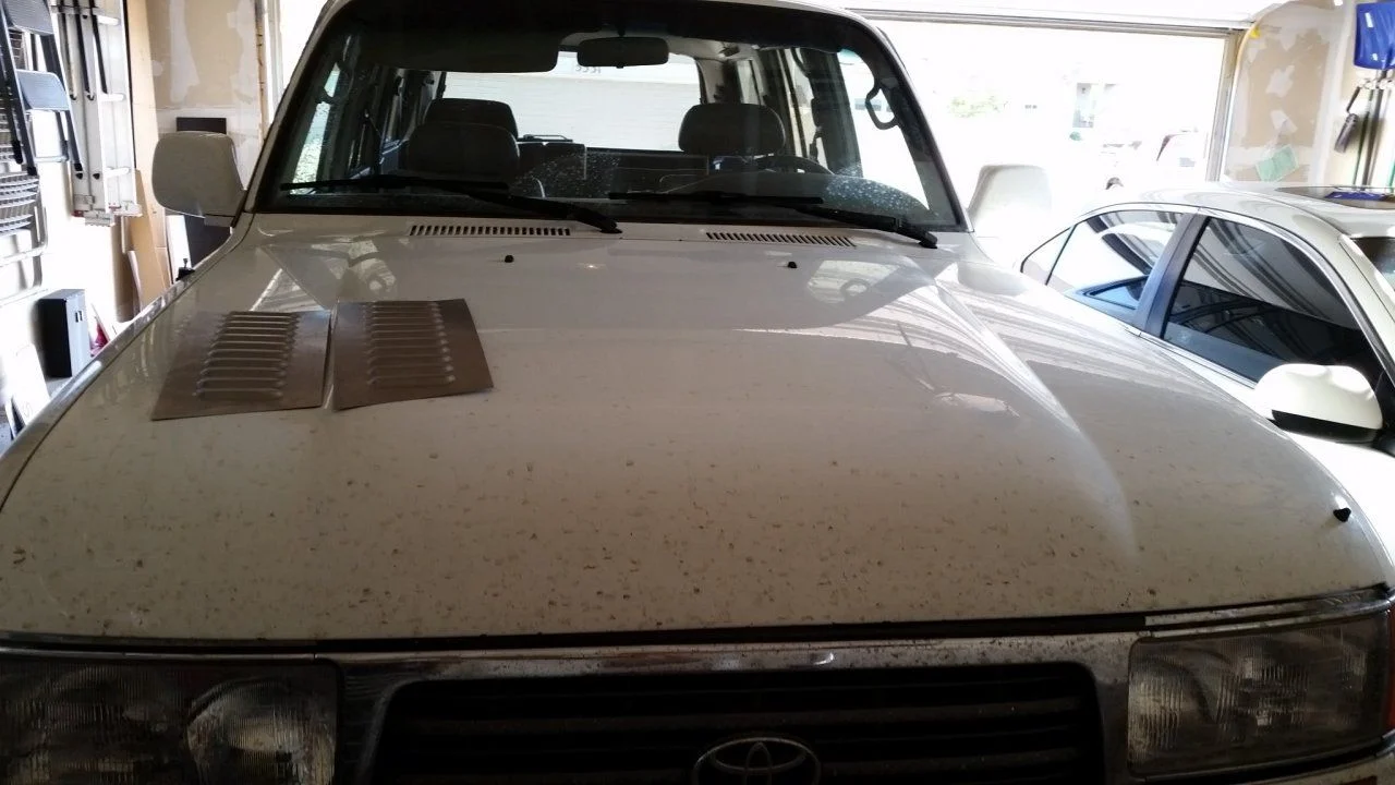

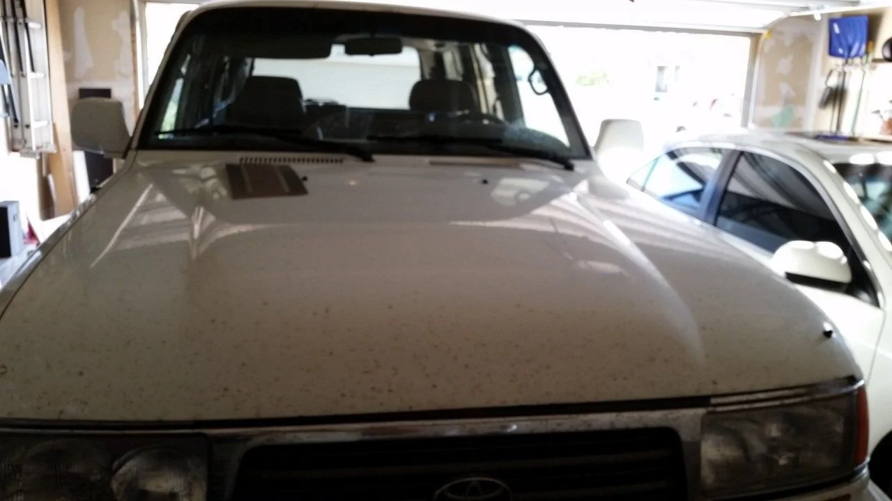

Played with the louvers a little bit.
This is how they would go if I go blinker duct route:

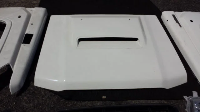

This is how they will go if I go hood scoop route (just one on the hot side.. might order a mirrored version for passenger side). The hot zone is basically right where the windshield sprayer is:

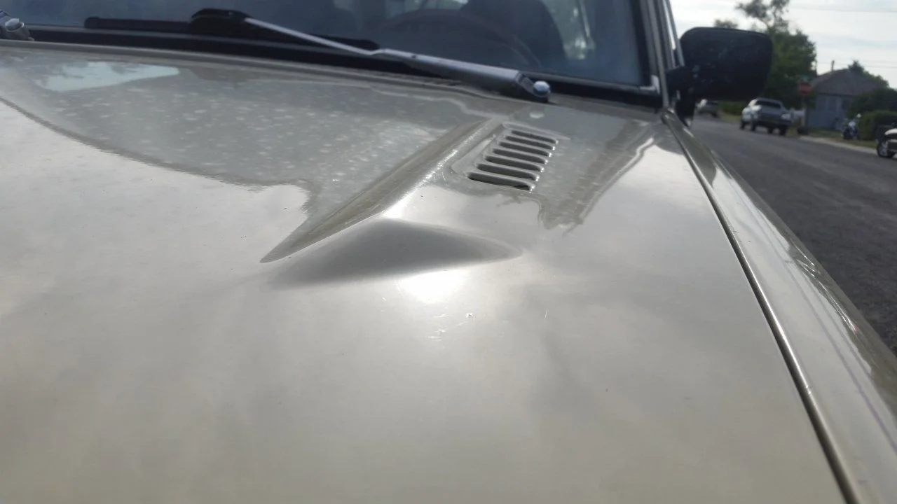

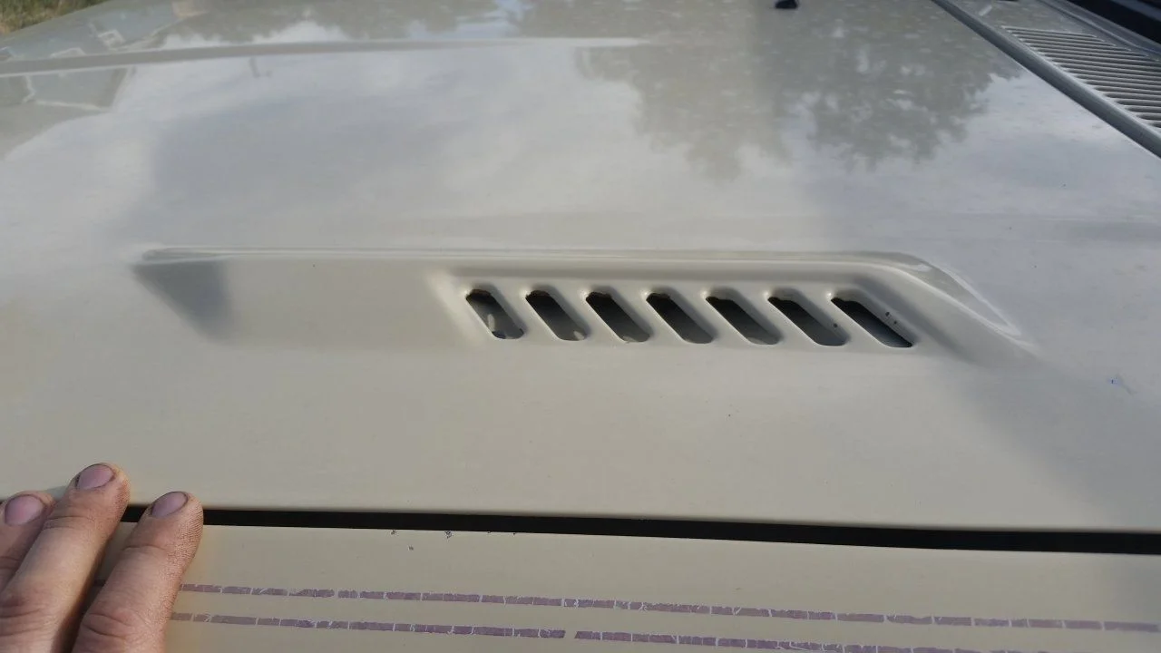

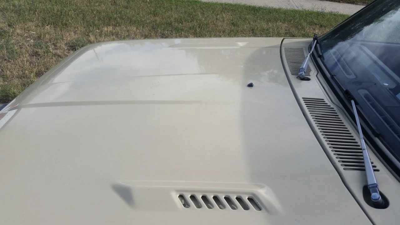

I've been really liking the look of these hood vents on my dad's 78 brat
Some more pictures
I think blinker duct has the potential to work really well. Cool air in from the front of the car, up through the intercooler and scavenged out the hood from the air flowing over the vents.
The hood scoop always has me scratching my head. It works great if it's like a shaker hood going directly into the engine but as a cooling method, you're trying to force air into an area that already has air being forced into it through the "ram air" effect of the grill and the engine fan. Your system is a little different since your IC isn't on top of your engine but for Subaru guys looking to make power that is one of the very first things they change.
wow, is that a TRD pro brat? :hillbilly: Full body shot? I've always loved old school japanese. My parents had a 79/80ish GL when I was a kid.
These are the only pics of it I could find on my phone. I'll take a few later today.

Buttoned up. All that heat wrap is smoking like the dickens! Pulled over to check under the hood and there were some very concerned-looking bystanders. Seems to be running much happier and I can really hear the turbo spool now that the exhaust is patched up.

Well, I guess it's official, I will be going hood scoop rather than blinker duct for "quick and easy" factor. I'm already sort of regretting the cut as I'm like 80% sure that I will eventually do a FMIC. :/
Yeah its really freaking hot on both sides. I did a short drive to Home Depot with the hole in the hood and not much change (maybe *just* perceptibly less hot on the "cool" side).
I'm going to add some ducting around the hole on the underside of the hood and line with weatherstripping of some sort to make sure the air gets forced into the core.
