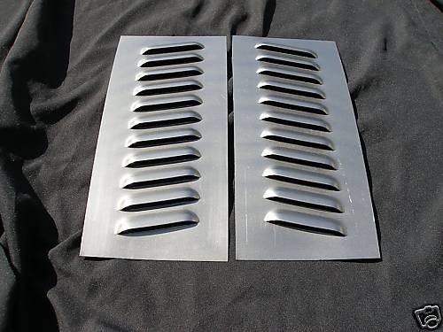

Ordered some of these to vent out the intercooler through the hood:
Pair of Angled 11 Louvered panels 4" - Rod Louvers and Sheet Metal design
In wrapping my head around the ducting scheme, I've come to wish I had taken a fluid dynamics class in college. A couple thoughts:
1) Should the air exiting the hood (after its already been through the intercooler) be ducted or will just placing some ventilation above the IC be good enough? I have already decided not to duct, but I'm a little curious if it would make a difference
2) How much would it matter if my duct is restricted down to a 4" diameter round dryer duct before expanding again to the 11" x 11" IC core size
3) How much benefit would opening up the blinker hole add? I assume the more air I can squash through this thing, the better. And my lower valence is already pretty fubar, so aside from the asymmetry factor, there's really no harm in cutting a bigger hole
4) There is an AC line that is in the way of what I'm wanting to do. I'm going to try bending it like the one in the engine bay, but it still probably wont be ideal. I'd love to get an AC shop to just completely move it, but that's probably not in my budget.
Ducting through the blinker hole should be quite a lot of air. If I remember correctly the hole is just over 12"x3" that is twice as much air as a 5" tube. So necking down to 4" will back that flow up a little but it is in a high pressure area, the front of the truck is literally ramming air, hence the term ram air for those old 70's intakes. In fact necking down to 4" might be slightly advantageous as you are speeding up the air as you push it through the intercooler.
Ideally you would have some type of blinker hole to 4" round casting, then run a 4" tube up to the IC, and then a 4" tube to intercooler core duct that fit securely to the IC so all of the air had to go through it. At that point just having a few open holes on the hood would be plenty, because the air sitting behind the intercooler would be pushed out but the cold air being rammed in.
