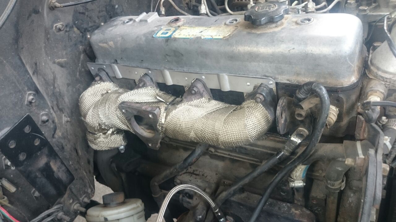

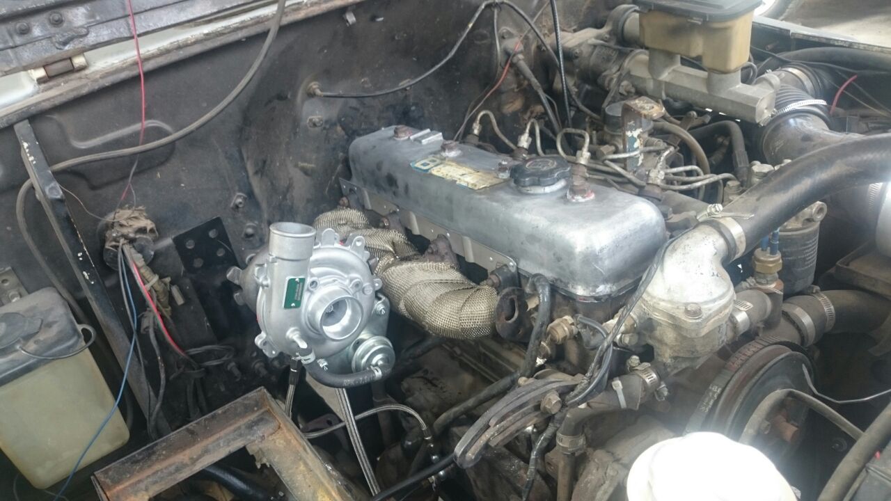

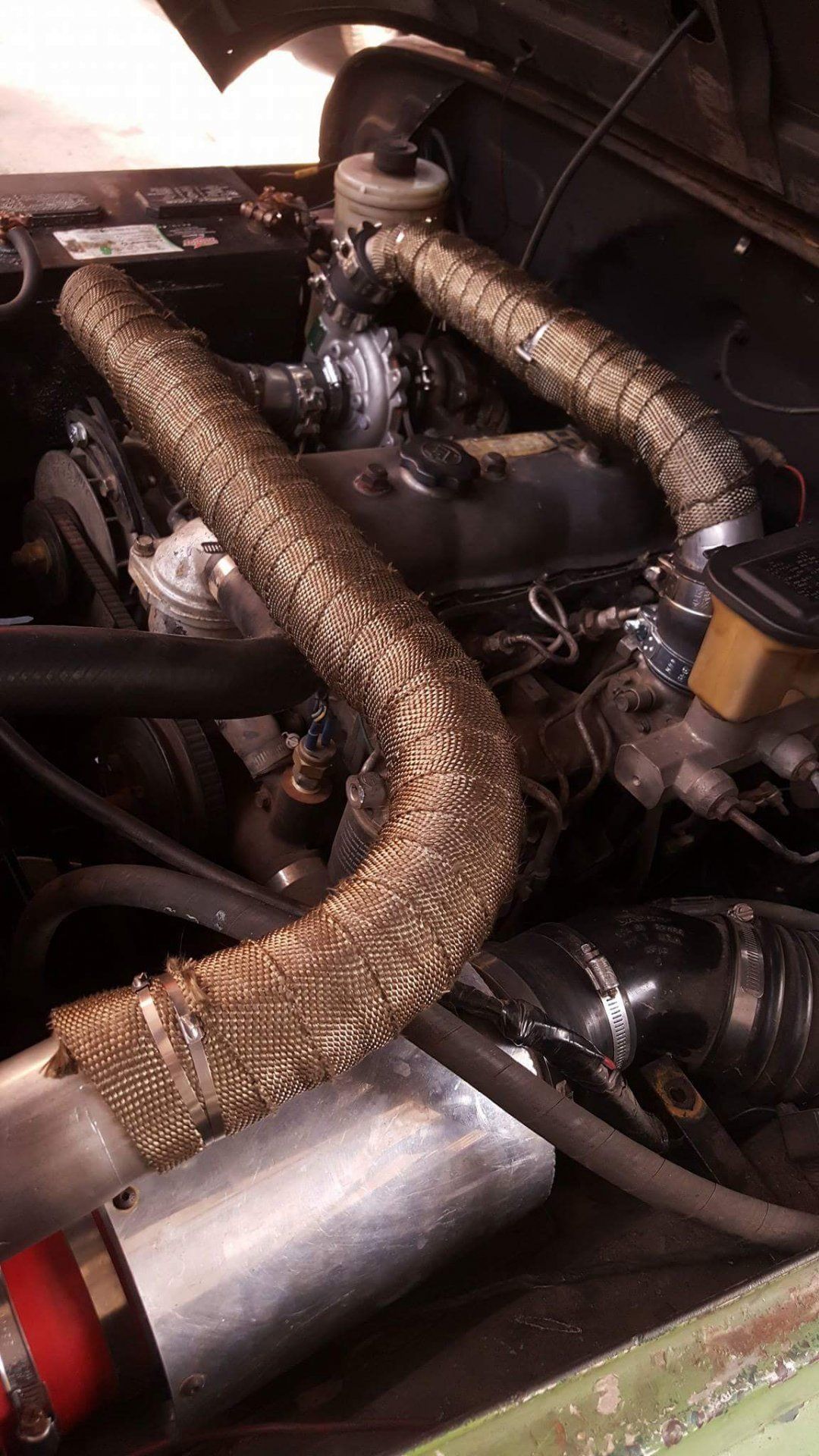

Finally, I finish my project.
Here is the final result:

Why did you go with the ct12 turbo.

I choose the ct12b, because is the one that the 1kz engine has. The 1KZ and the B engine are both 3000cc, but the 1kz has pistons able to handle high pressures, B does not, thats why is not recomended go high on the PSI. From factory the ct12b turbo comes with 10PSI, and the B engine is a robust engine, able to handle that pressure.
Definitely, the engine is stronger than before. It handles better on low revs. The turbo kicks at around 2000RPMs.

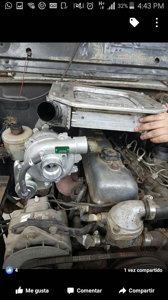

This is my set up. Not finished yet, but it's looking good
Wow! Nice! Good job there, is looking good.

I am using a 2KD engine turbo (i think it is a CT16) but is throwing around 14 or 15 psi to the engine ( too much for an old b engine ), so i bought a new wastegate actuator to drop the boost to 8 psi (i am still waiting for this part, maybe i will have it on the next week)

No intercooler so far since temps are great, one thing that I found was that I had to move the Air Filter and it was not getting cool air and my water temps used to increase to 3/4 on the highway at 80-90KM/H, I fixed this by reposicioning the air intake of the filter.
