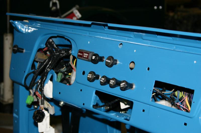

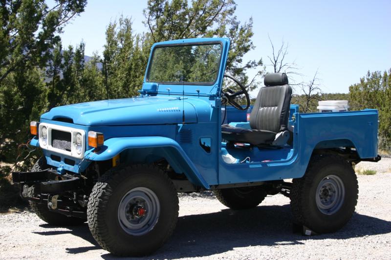

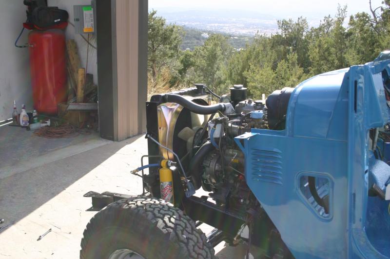

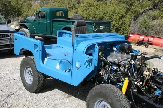

I spent most of today cleaning/tapping holes, getting the wiring harness in, and bolting up all the hard to reach stuff. Doesn't look a whole lot different, but if that turbo were to show up tomorrow, I'm confident I'd take it for a spin...
For the record, don't ever buy a 79+ 40. not only is the square bezel ugly, the sheet metal thinner and more prone to rust, but getting the fuel tank in is positively AWFUL (it's done though). :bounce:

Update for today: turbo is not back yet, but the wiring is all plugged in, and everything except the gauge cluster and glovebox are installed inside the truck. If that turbo were here, I would have taken it for a spin around the neighborhood--no joke.

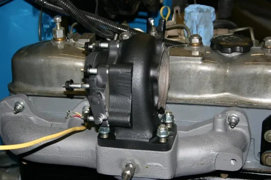

Yes, that is a ceramic coated turbine housing, and exhaust manifold. ;) In retrospect, they should both be black, or at least the manifold. But, that's just nitpicking on my part.

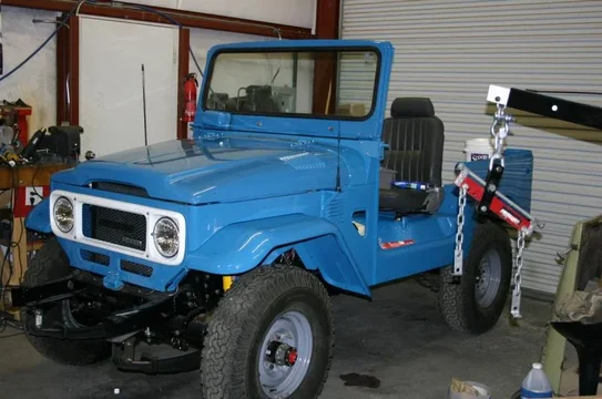

Jon, I'm sending you a PM about trying to do the nutserts tomorrow.....
I have to put a coat of clear on the roll cage tomorrow, and once the cage is in (depends on how early I can put the clear on, and if we can get folks to lift it in) the top can go on...

Monday. The cage will go in monday night. Should only take three of us to lift it (it's the same cage as Jon's).

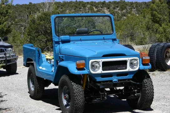

C'mon turbo! Get here please!
