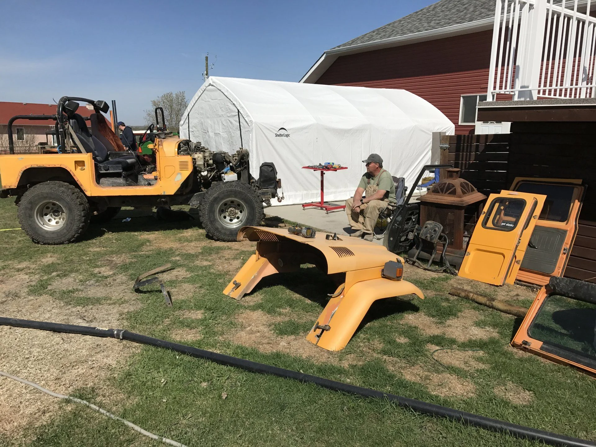

Hopefully this isn't all due to the time we pushed in to warner lake ;)
I'll be up on the weekend and you can do mine!!
-Kidding gotta work

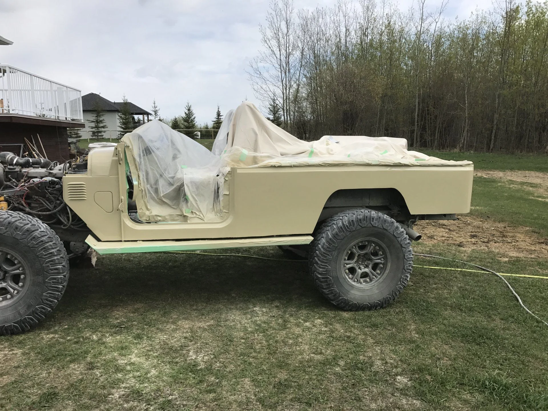

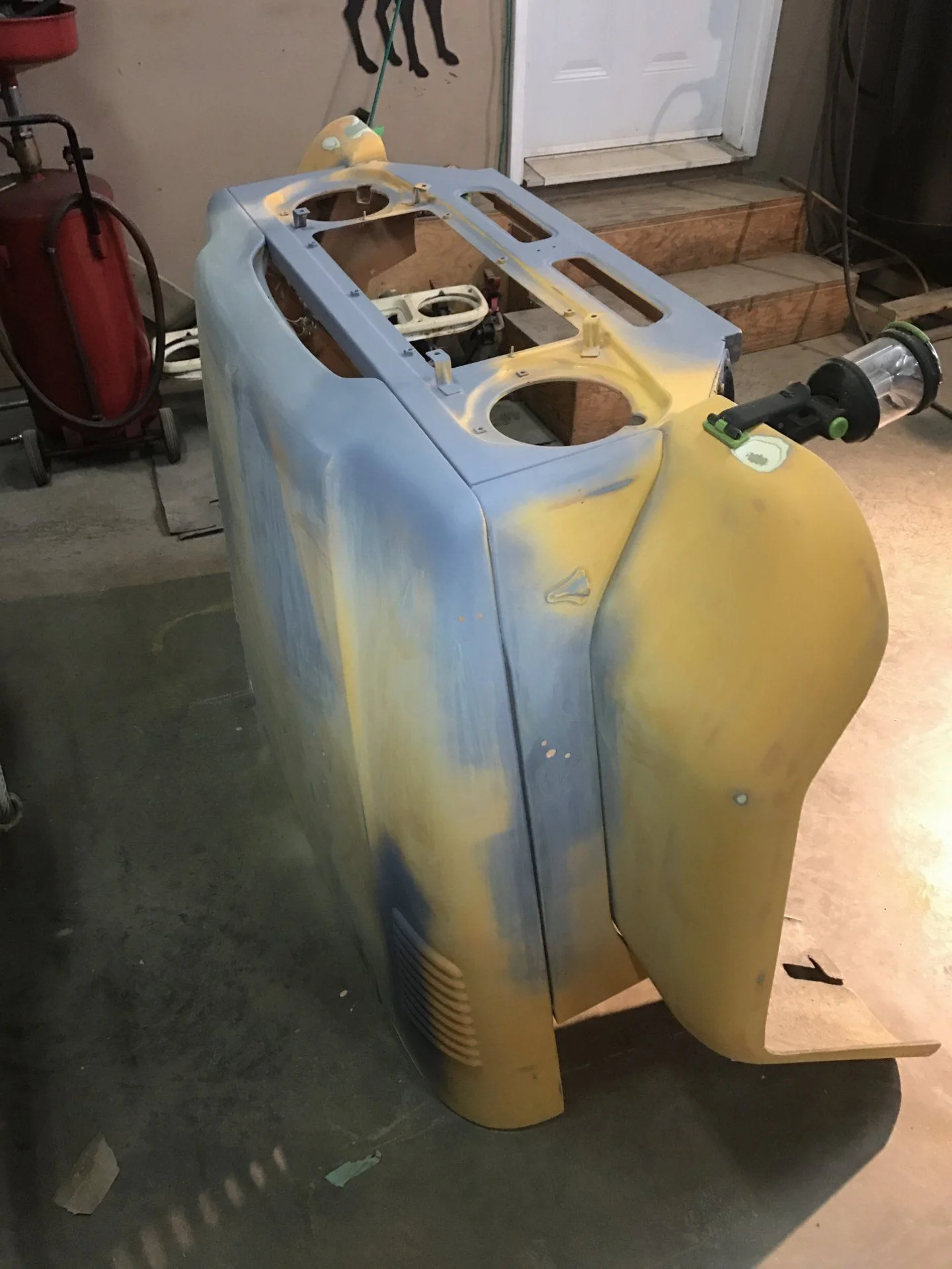

Agent O is next in the que. should be ready for paint this weekend if the whether plays along. Again these paint jobs aren't restoration quality but more of a refresh and clean up.

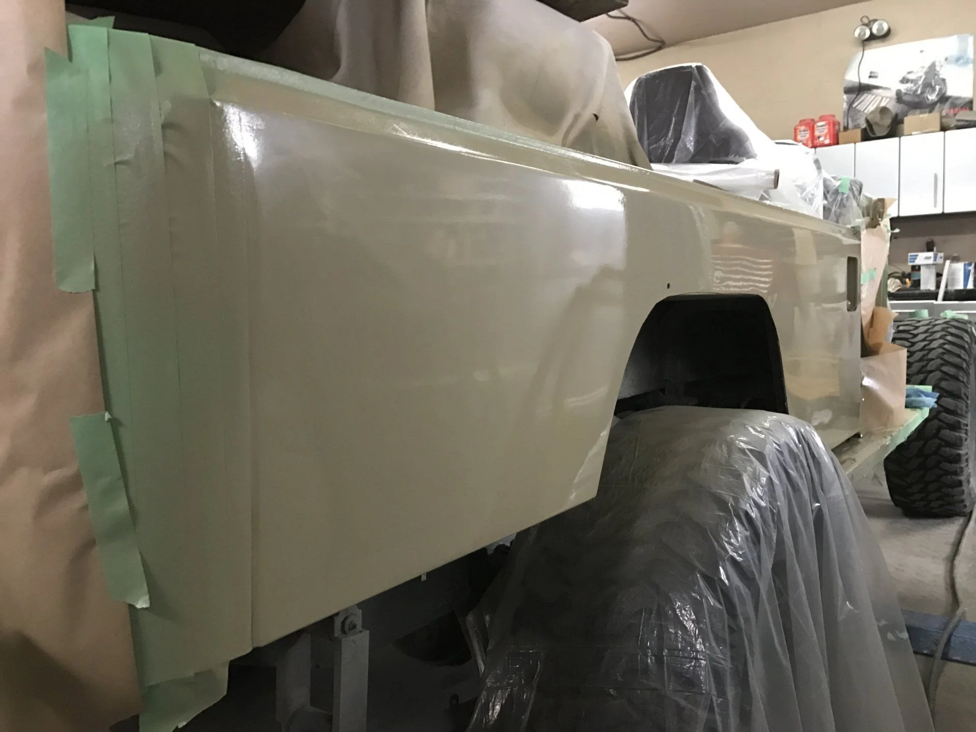

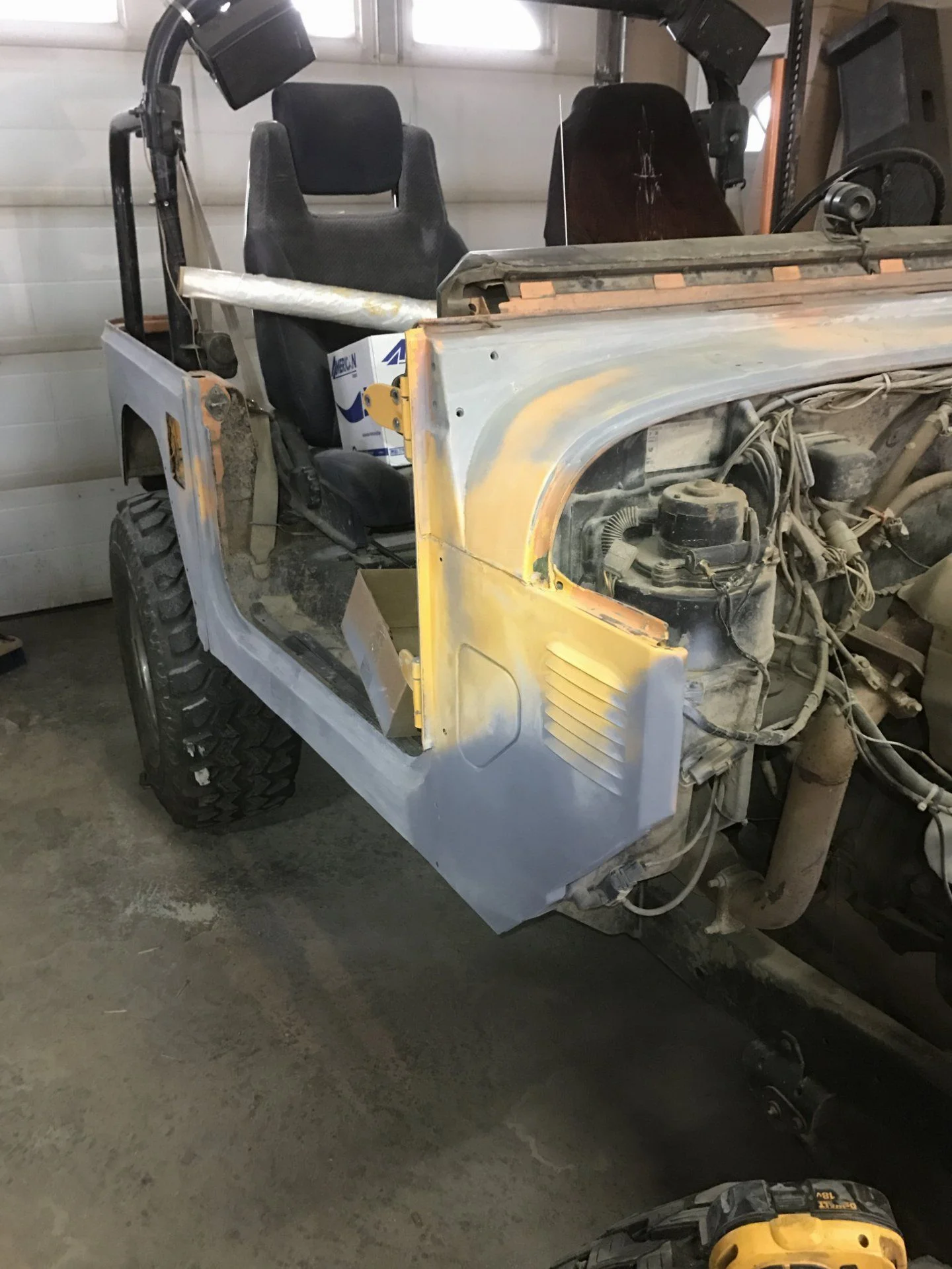

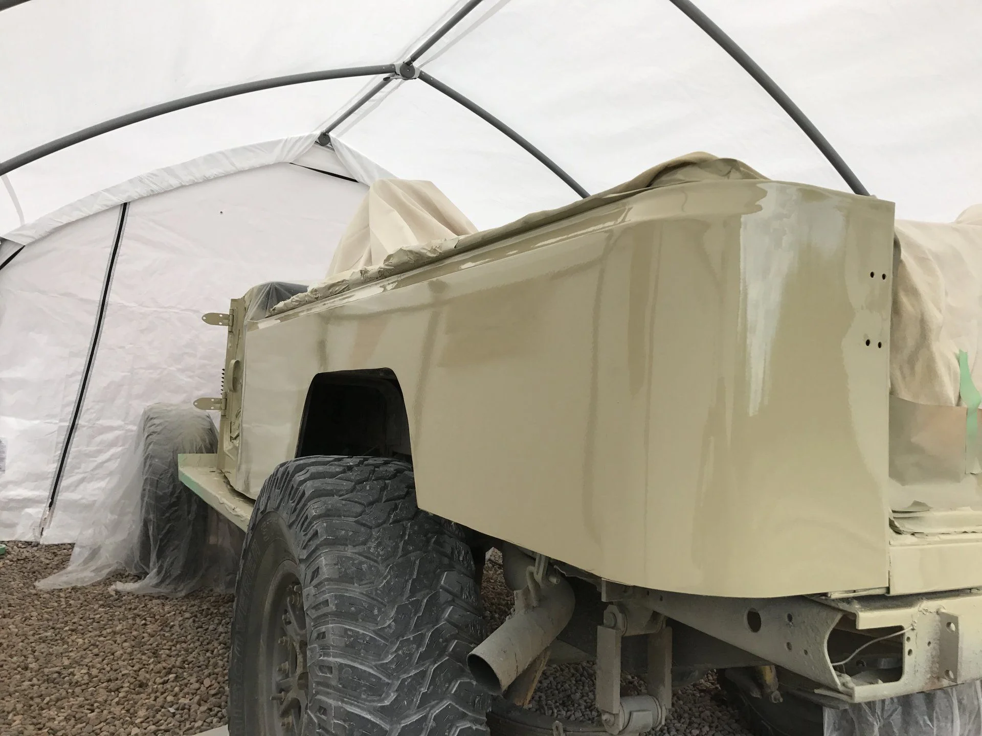

On troopy during my first coat I had a few runs in the drivers quarter. It was off as it was the second side I did and the first went great. Re sanded it last night and will have to spray it again.....
Troopy only needs his front fender underside painted. Maybe tonight or tomorrow.

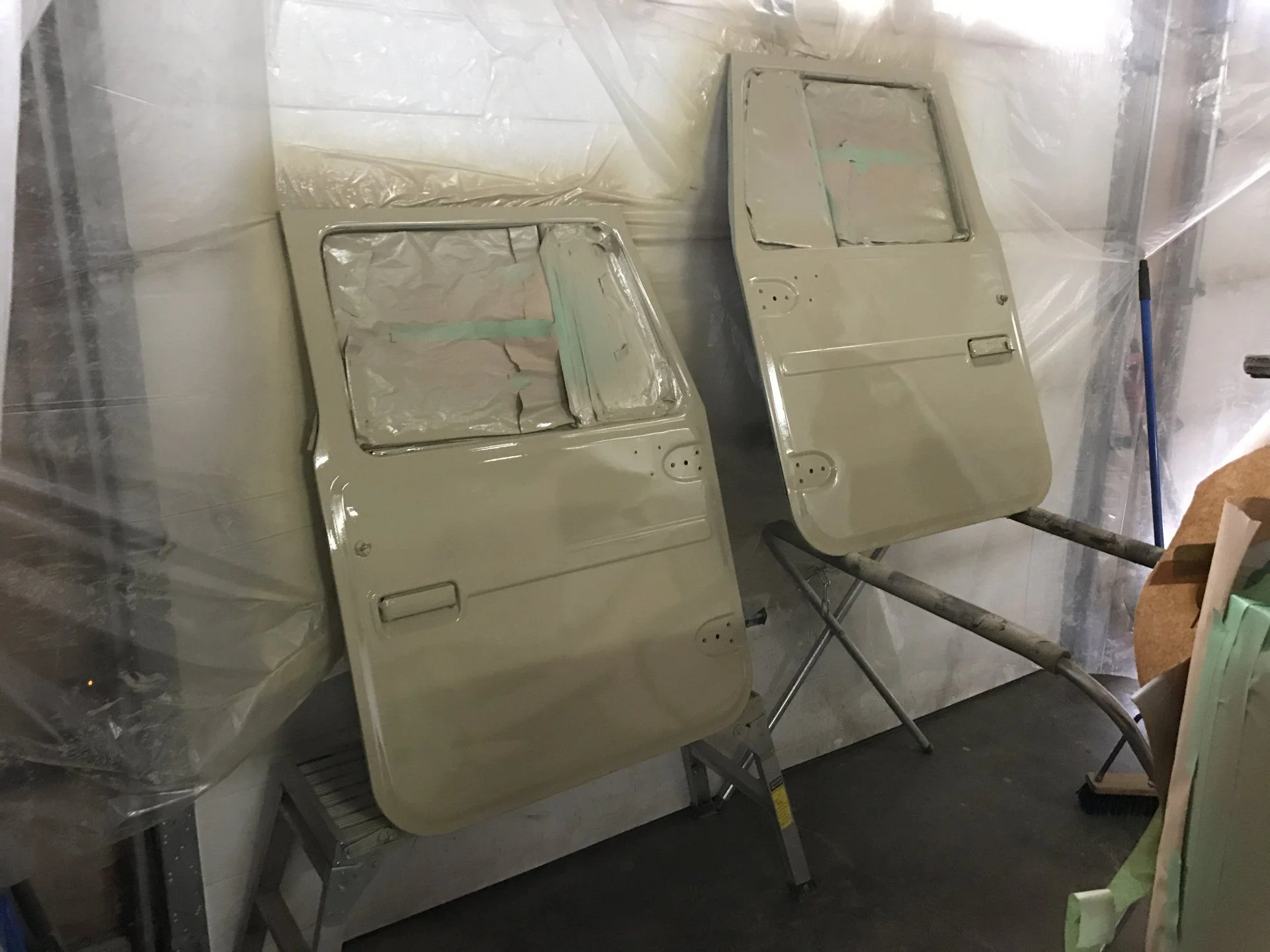

The respray on the side and doors went great. Came out even little better than the first time around.

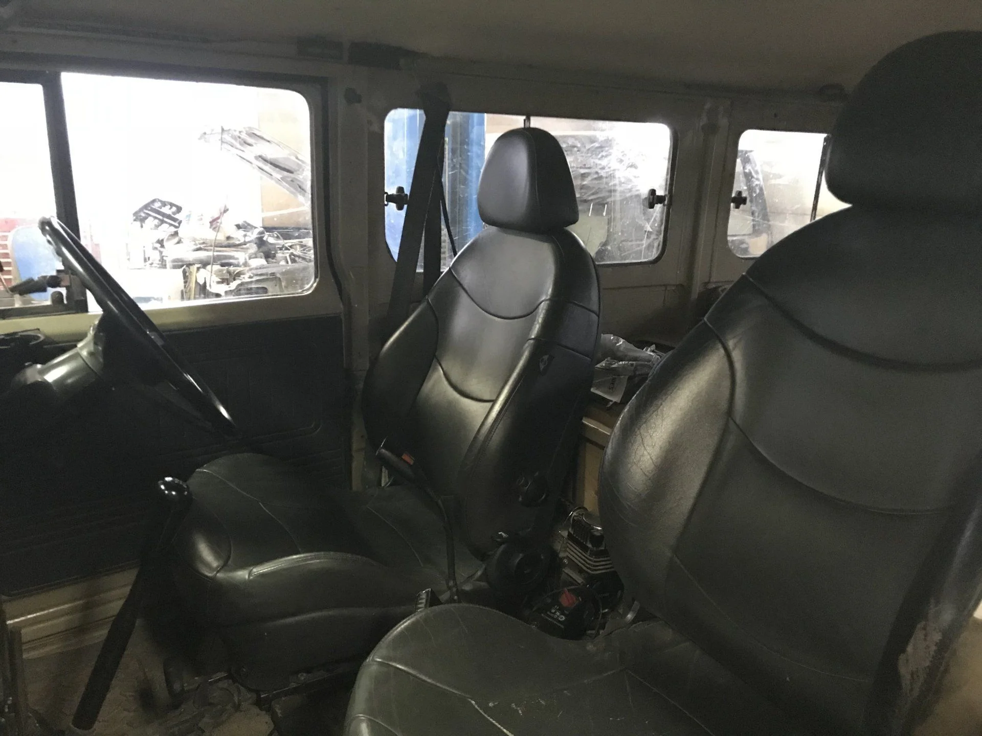

Next was seats. The seat that came with it sucked. Not sure they were factory but they were lame. Pulled the buckets out of the parts mini. Super adjustable, heated and in better condition.

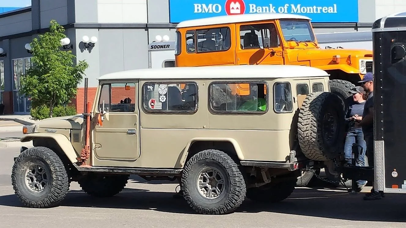

One of my favourite pics of Troopy and Agent Orange...(@arnott1t, @potlatch4805, @RockDoc, Steve, Chris, Justin, John, and myself). Only one of us hasn't daily driven a cruiser at some point. Sincerest thanks to all the cruiserheads who were there for us over the years and especially on our big day! :steer:

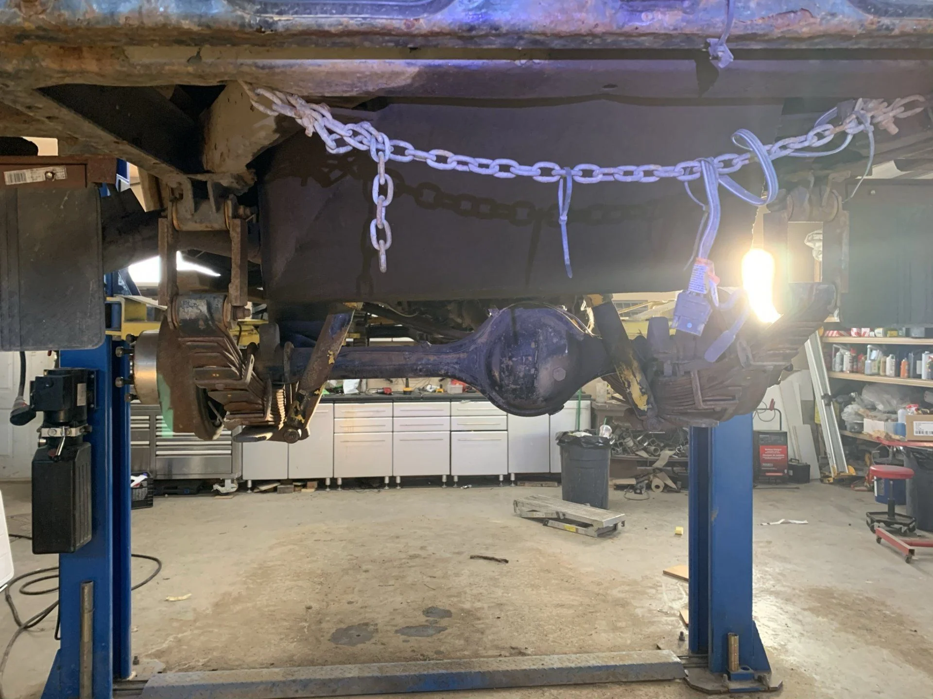

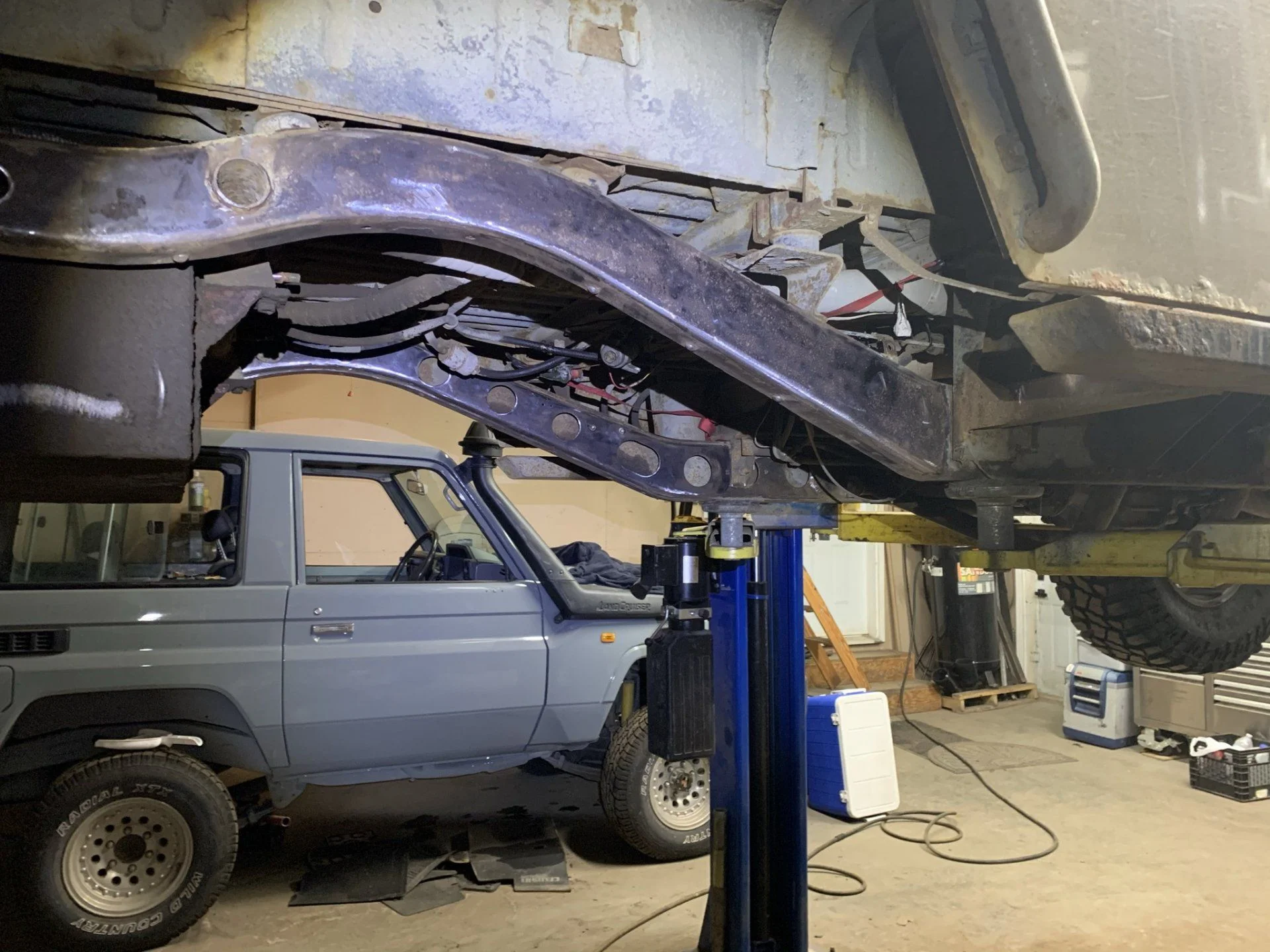

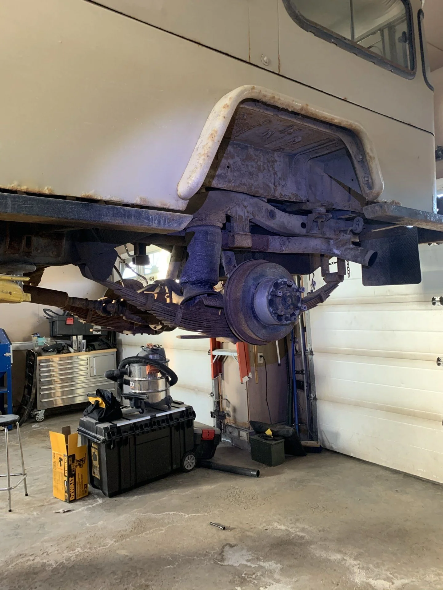

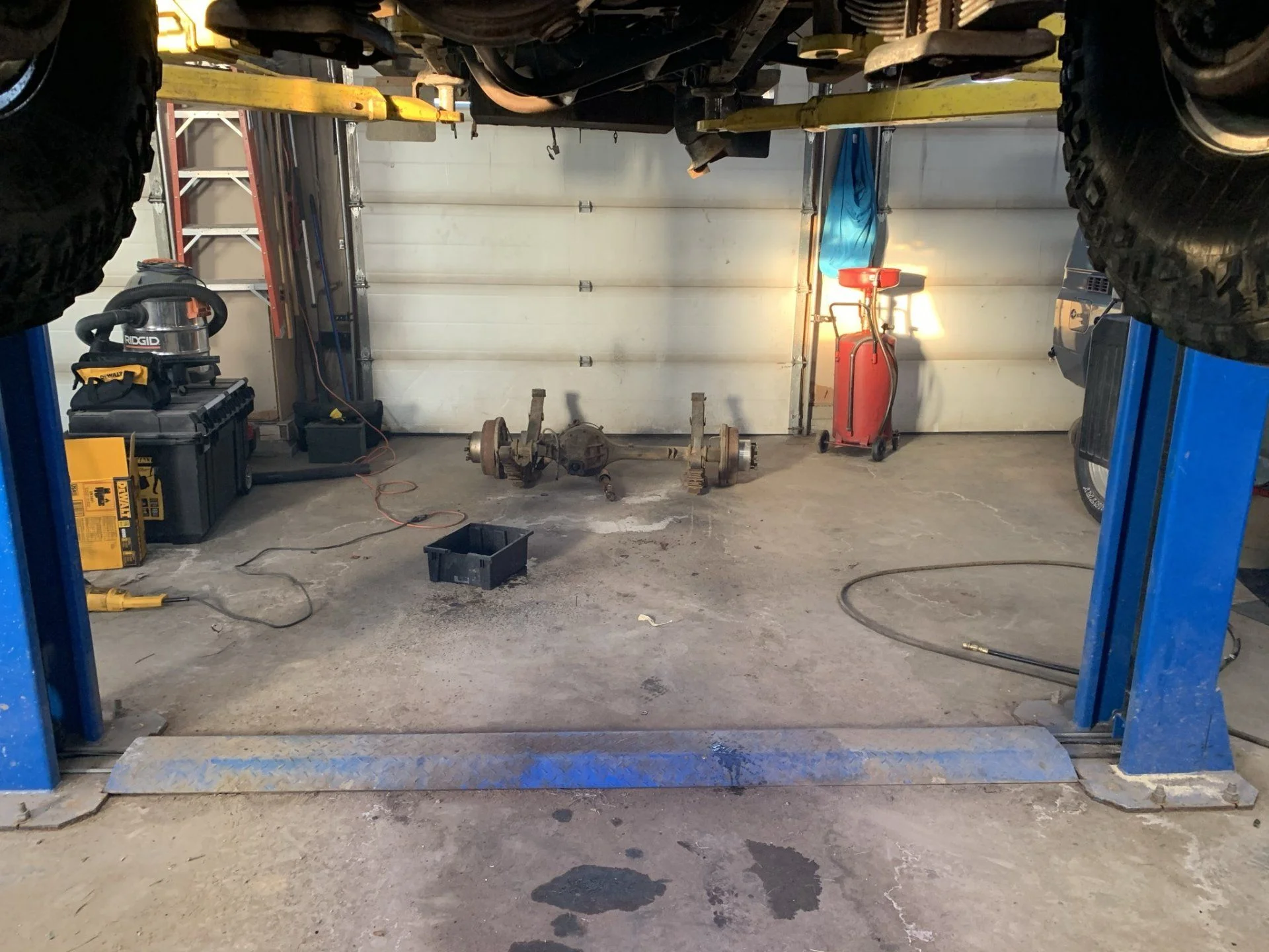

After what seems to be a very very very long time I'm finally digging back into this thing to try and tackle the suspension.... one axle at a time.
Spent a few hours yesterday stripping most of the old stuff of the frame and got it all cleaned up not to bad.
Also found a pending disaster. The idler shaft on the t case has a little lock tab and bolt that had nearly fallen out. When this happens the next thing to happen is the shaft slips back letting the idler gear drop and ...... Kaaaabooom
So that was a good bit of luck :)
