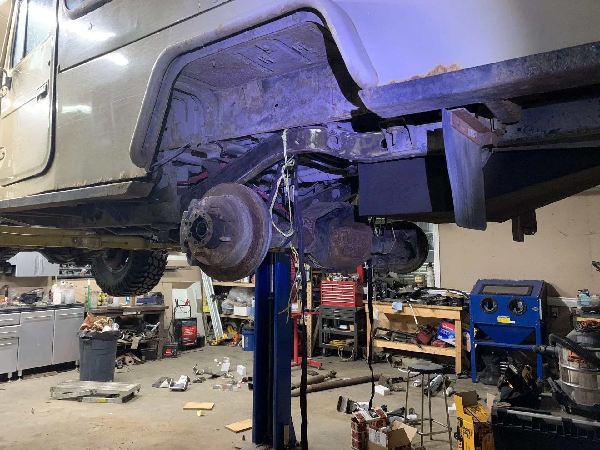

Got axles in garage.... ouch my back.... frig even empty that 14 bolt is a pig.
With the shave, full width truss and all the link brackets, I can barely pick up one end of the axle. Its shocking the weight difference between a 14Bolt and Cruiser Diff

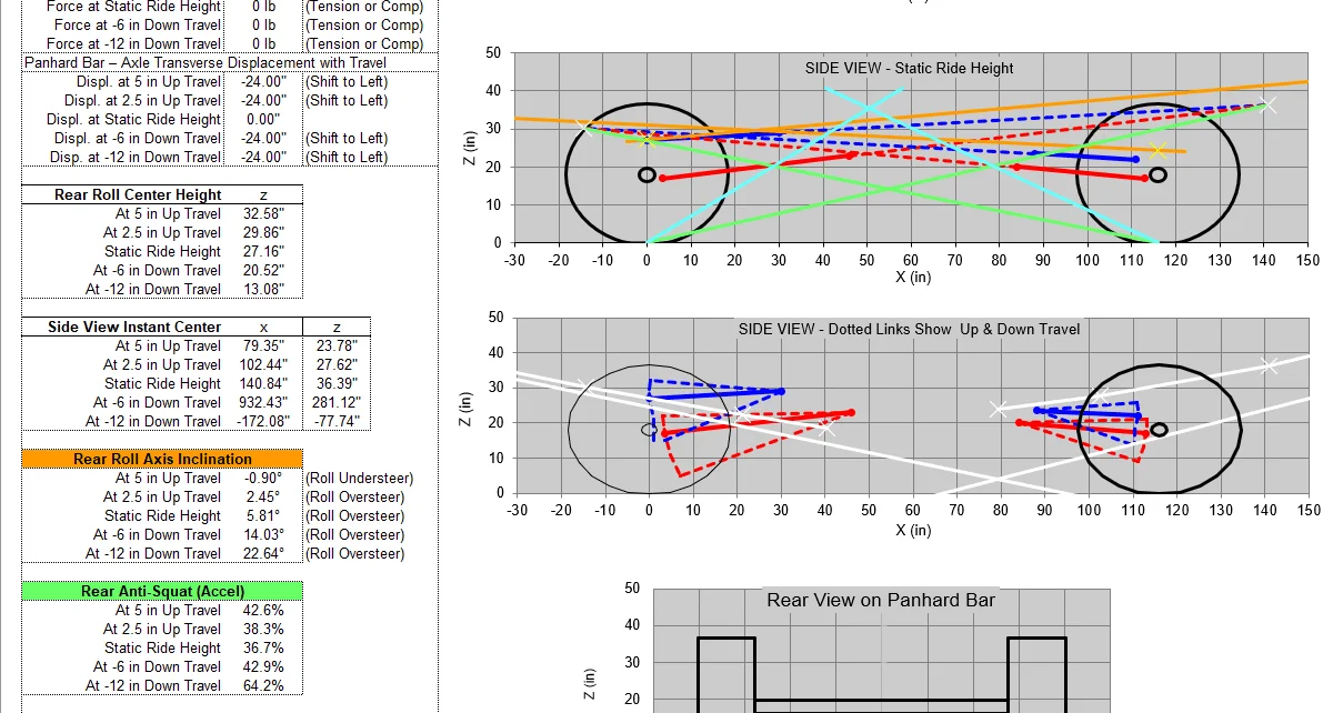

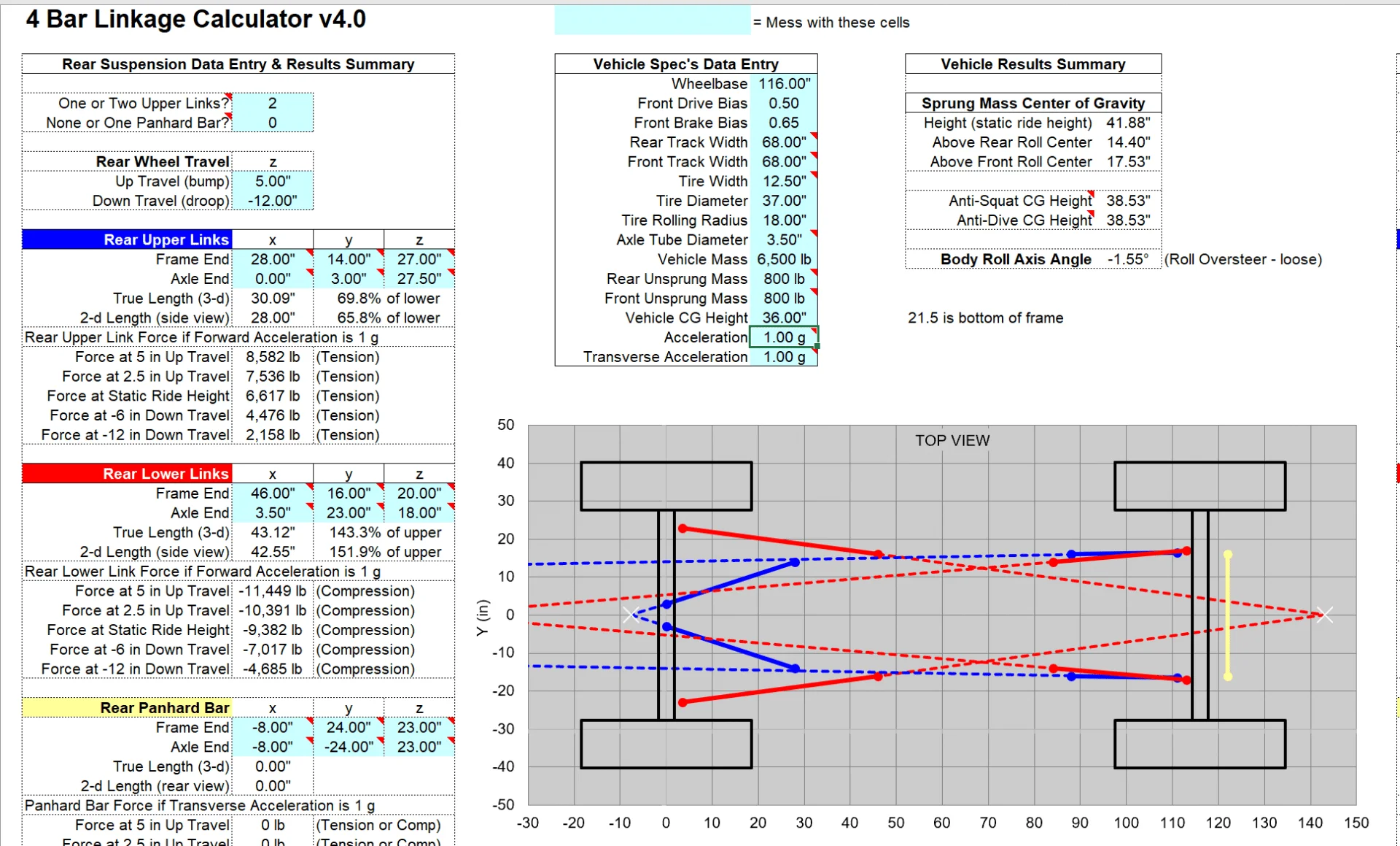

Here is what the suspension geometry is looking like for the rear.
My leading plan is to narrow both axles to 64" or so which is what the 14bolt will be with two short factory axles. That should give me room for stuff but also not really be much wider than I am today....

Roll oversteer in the above links is bad... I've reworked them some more to get to understeer and a better spot. I think I've done as much work as I can until I start making more firm mock ups and tack things into place....

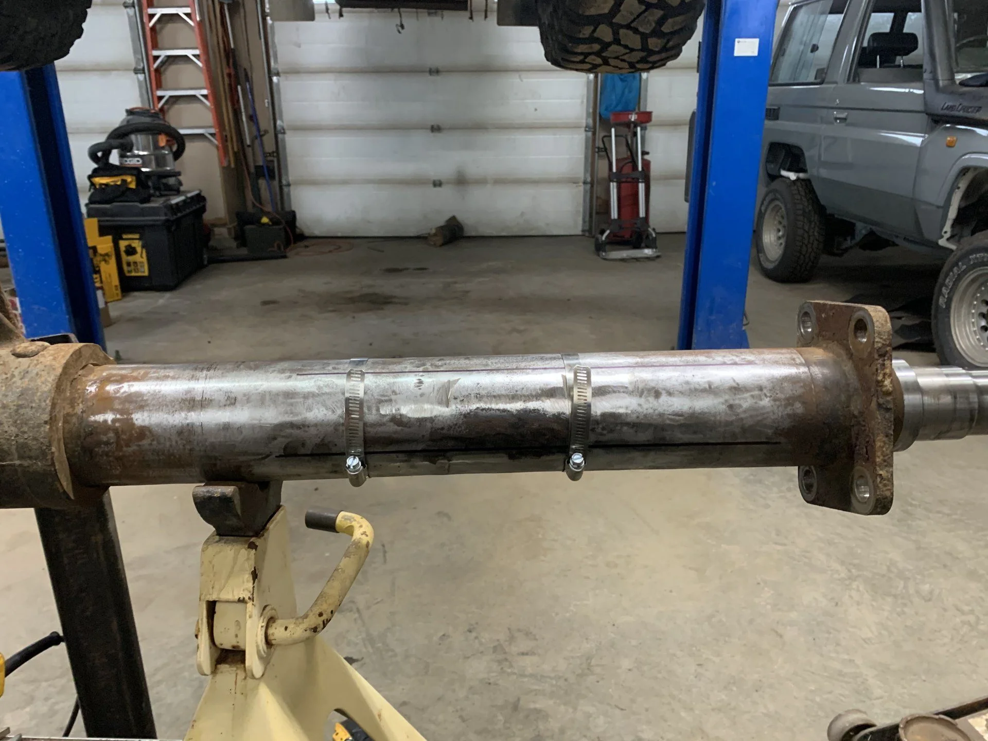

This means I need to first narrow my 14bolt. Couple options here:
1. Go and steal @Behemoth60 alignment bar and pucks to get this thing deal eye stright
2. Use and internal sleeve to align the 2 sections of axle tube
3. Use a external guide (Read angle iron holding each side in with clamps to get it straight
Scanning the youtube for seeing what others have done an all 3 methods are covered and seem to be used. I'm sure Peter's alignment rig would be the best but also the most 8 hours worth of driving to get and use. Shipping a 6' bar wouldn't likely be possible....
So I think I'll take it step by step.... re measure everything a good 12 odd more times to be sure on my numbers. Cut up the long side of the axle tube.... eye ball it and then decide..... I feel like I can get it close enough for a troopy.... but .... we'll see.

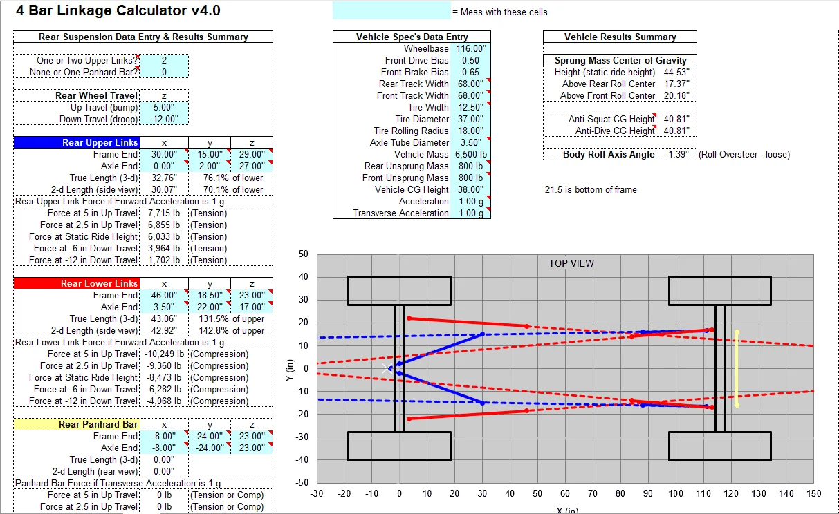

The revised link design after doing more reading and tinkering. My squat is lower than maybe I hoped but I can tune it a little with some adjustment in the upper frame mount. The thing I was trying to get was the roll understeer number at static ride height. This is supposed the truck feel more stable and predictable. One description was something like a skateboard. When you lean on a skateboard it naturally turns to try and get back underneath you. That is what understeer in a truck will do. at least according to people on the internet....

Tyler, In your 4 link sheet, set you Front Drive Bias to 0. That will change your rear anti-squat number, and give you a number for anti-squat when you are in 2WD.
I am guessing your AS is closer to 50%.
This internet guy says you want a higher roll center height in the rear, than in the front, just like you have.

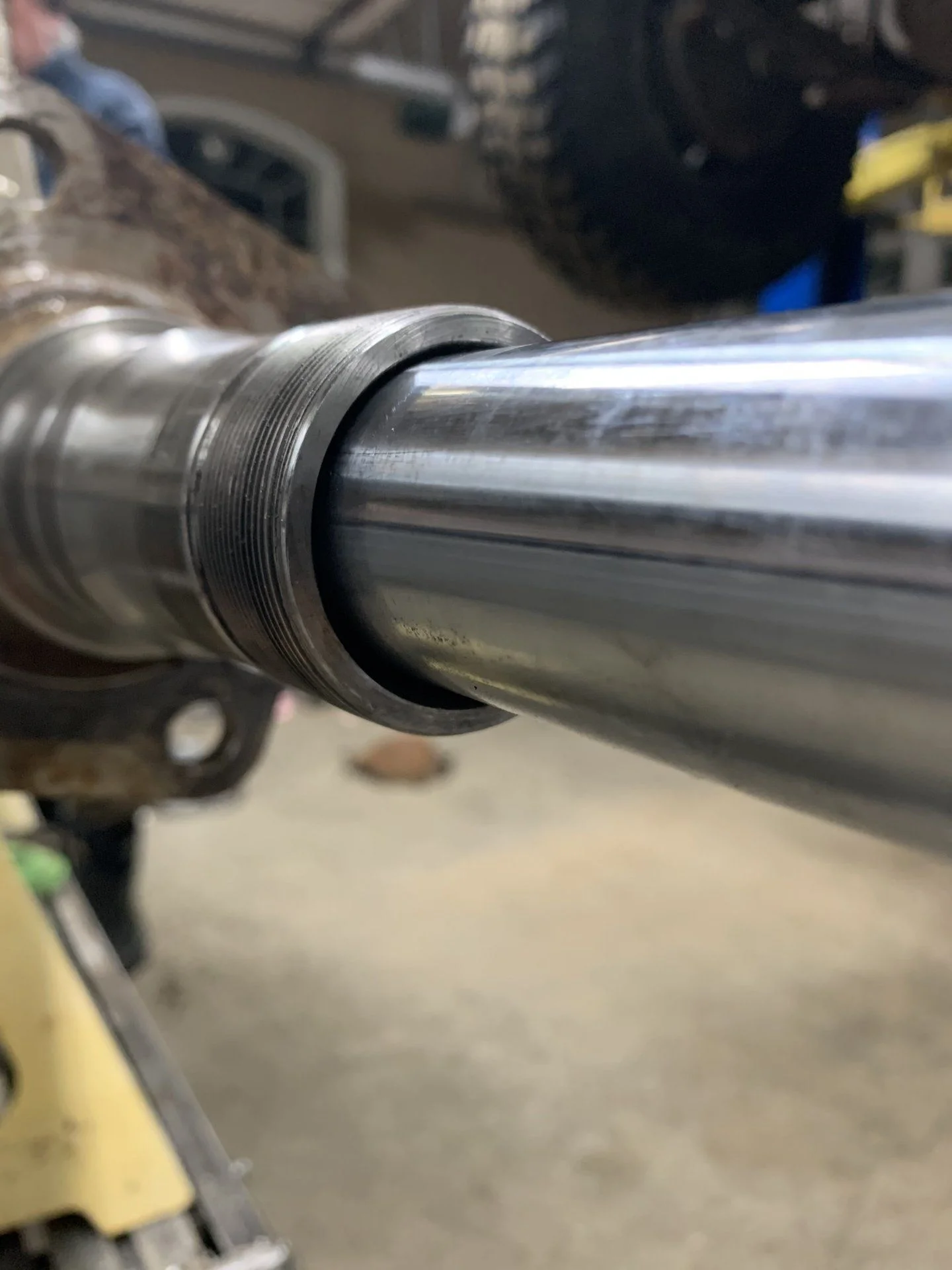

Mine has threaded ends that screw onto the spindles, as well as the 'Puck's' that hold the alignment bar through the Center diff section.

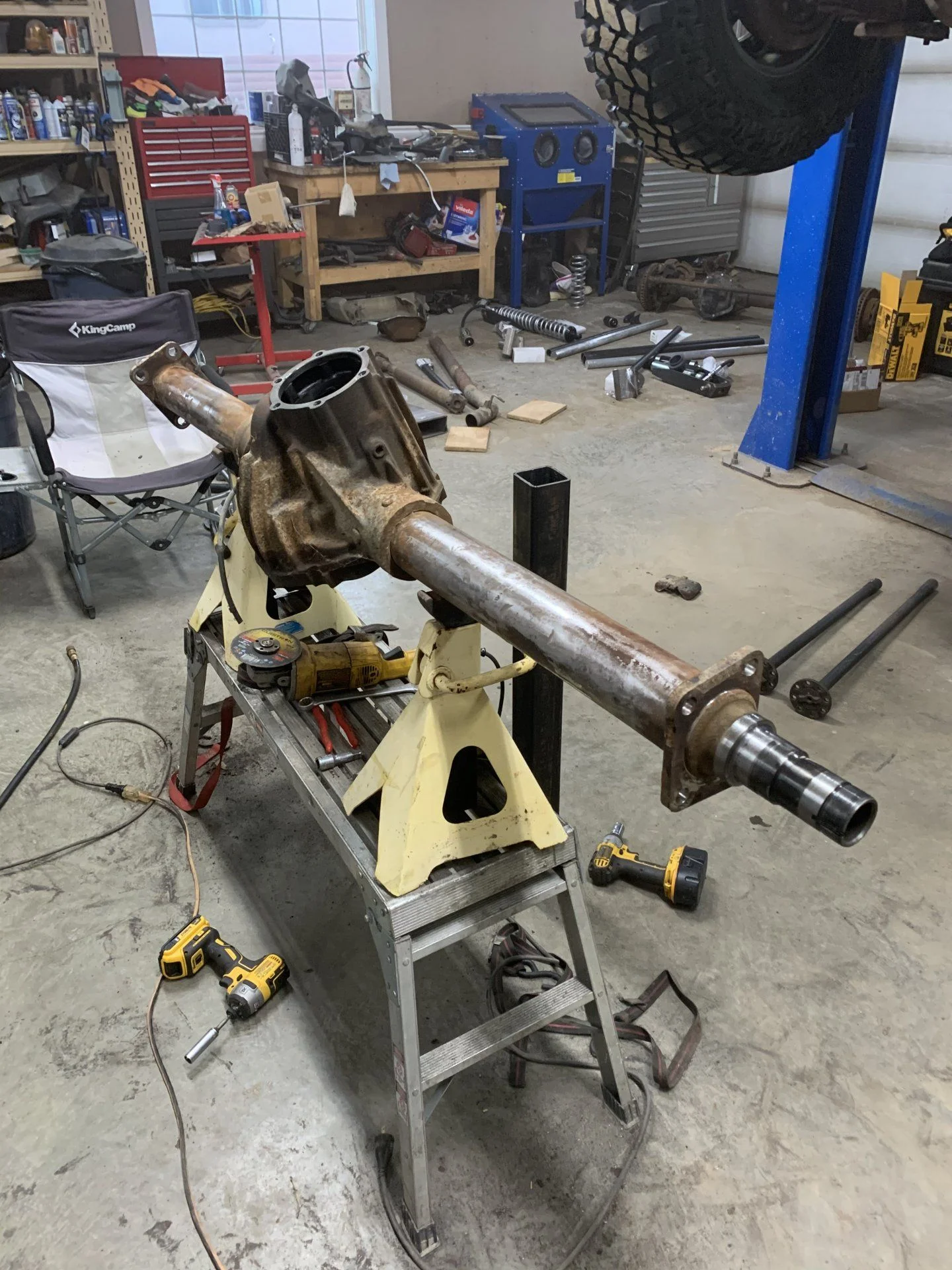

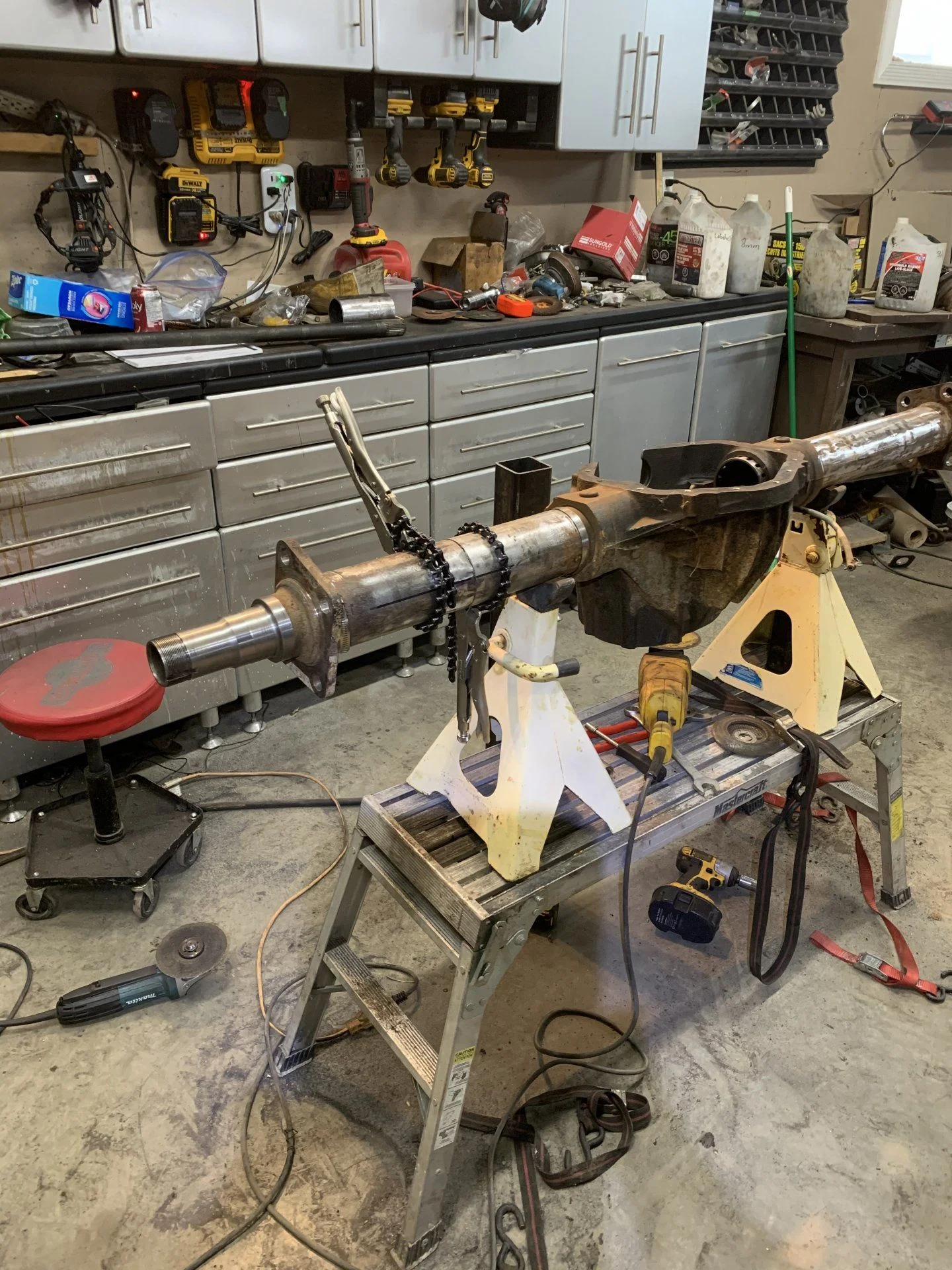

Some pre surgery prep today.

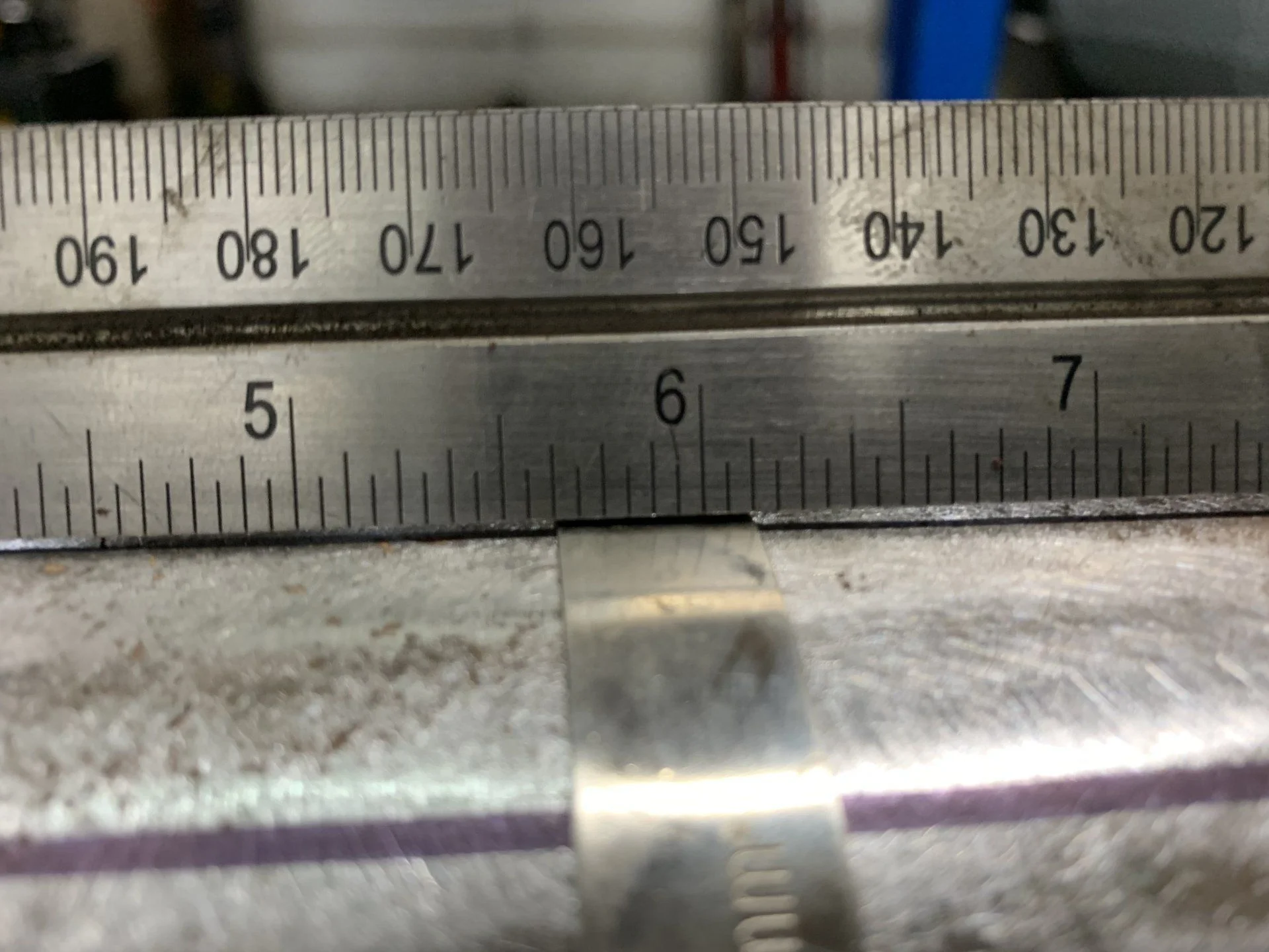

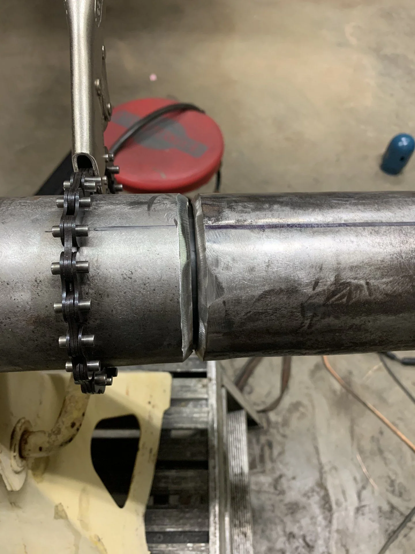

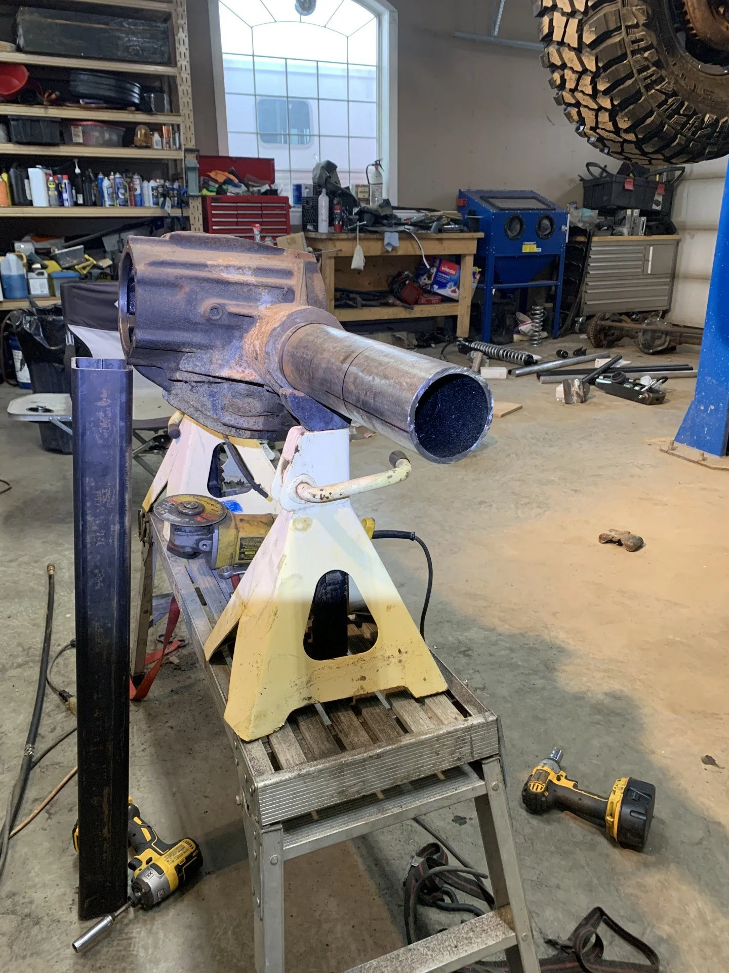

Took my measurements and cut the axle...
Now I basically have a bit of time to prep for
Tomorrow. Which will be weld the shave kit day. Need a new mig gas tank for that though. I’ll pick up a length of 3” dom tube too for an inner sleeve of the axle. Then get the alignment bar Saturday and weld this all together again. If things went super well I might have it back under to build link mounts Sunday or Monday!

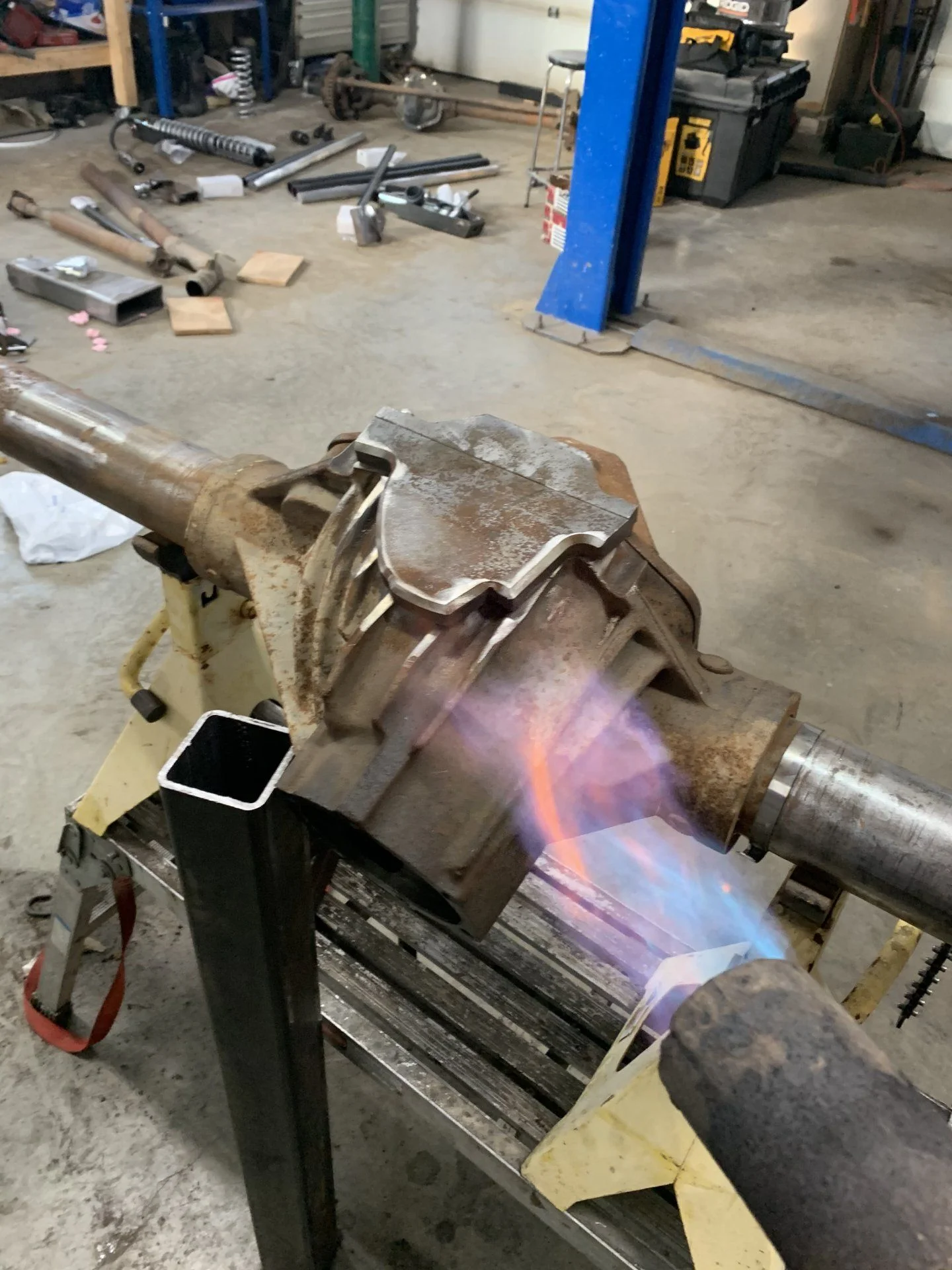

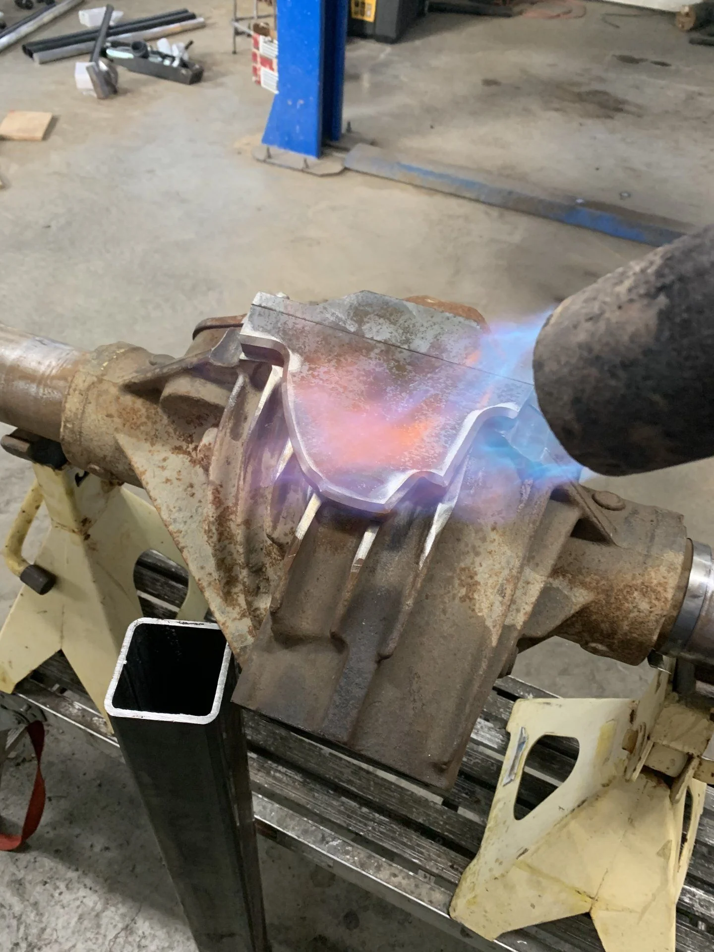

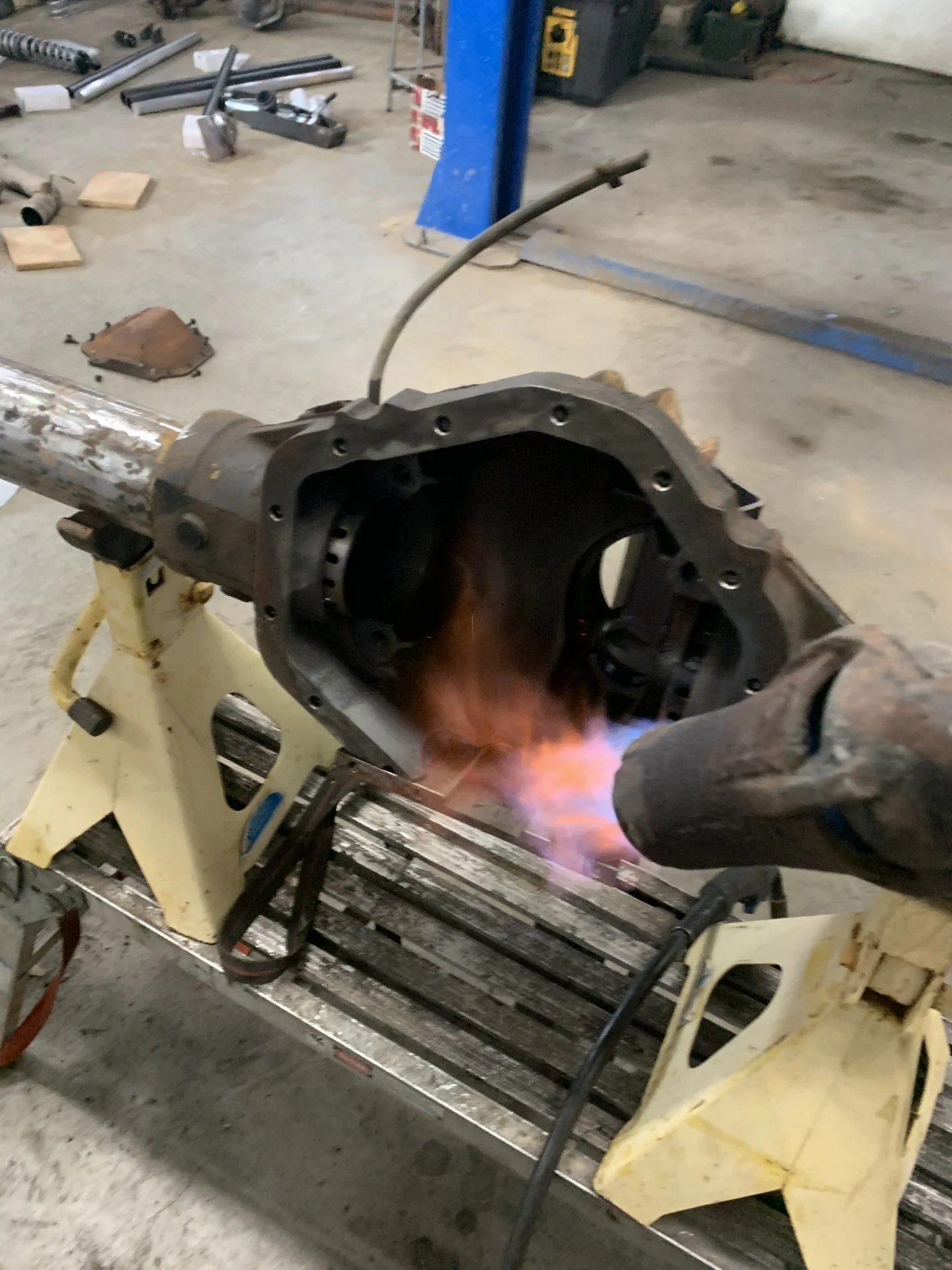

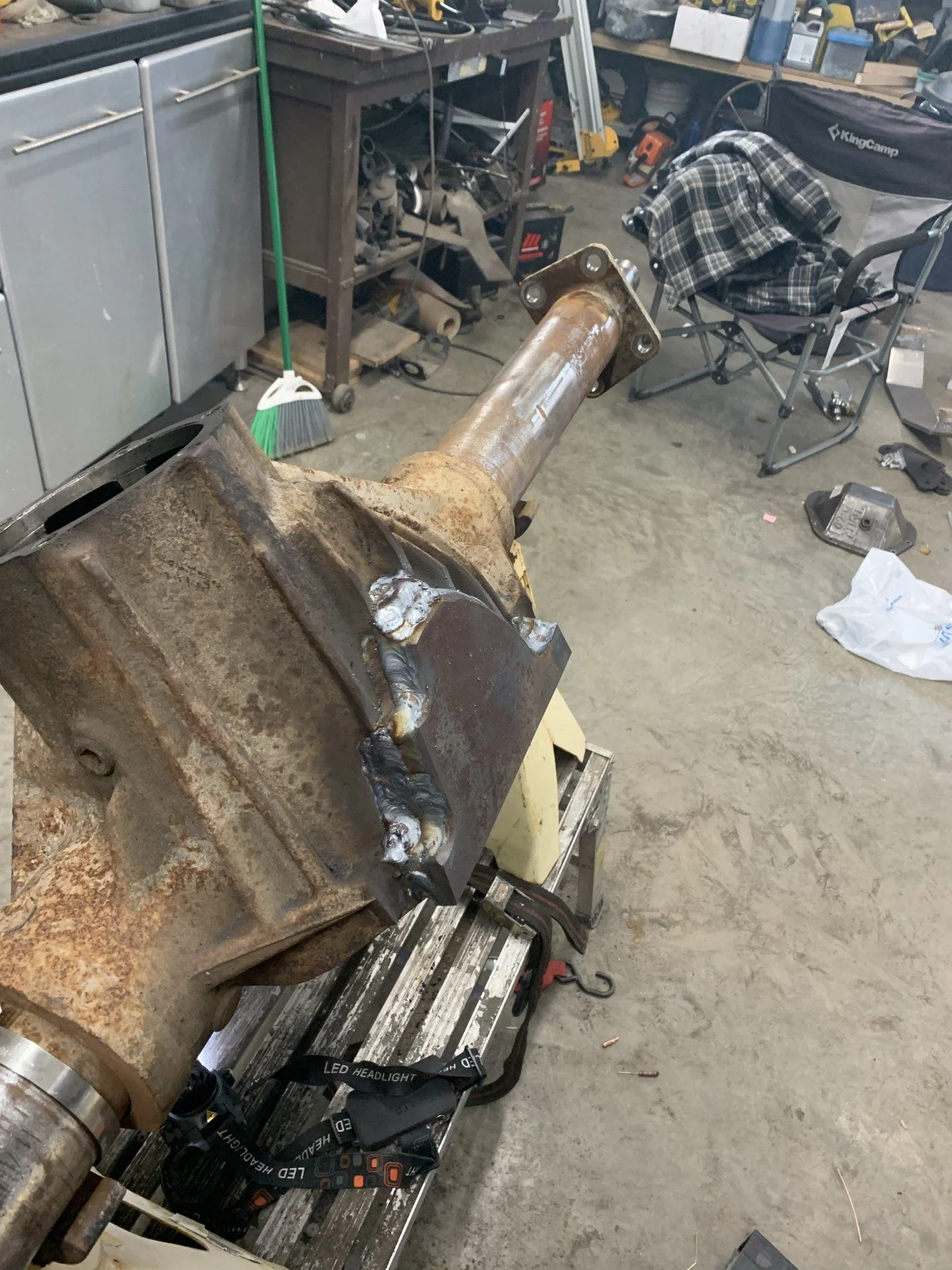

Well I got the gas and went to work welding in the shave plate. And I found some tube to sleeve the axle.
Pre heat the entire assembly to 400 f or so. Tack on the outside using the cover to hold the shave plate.
Remove the cover.
Heat again back to 400

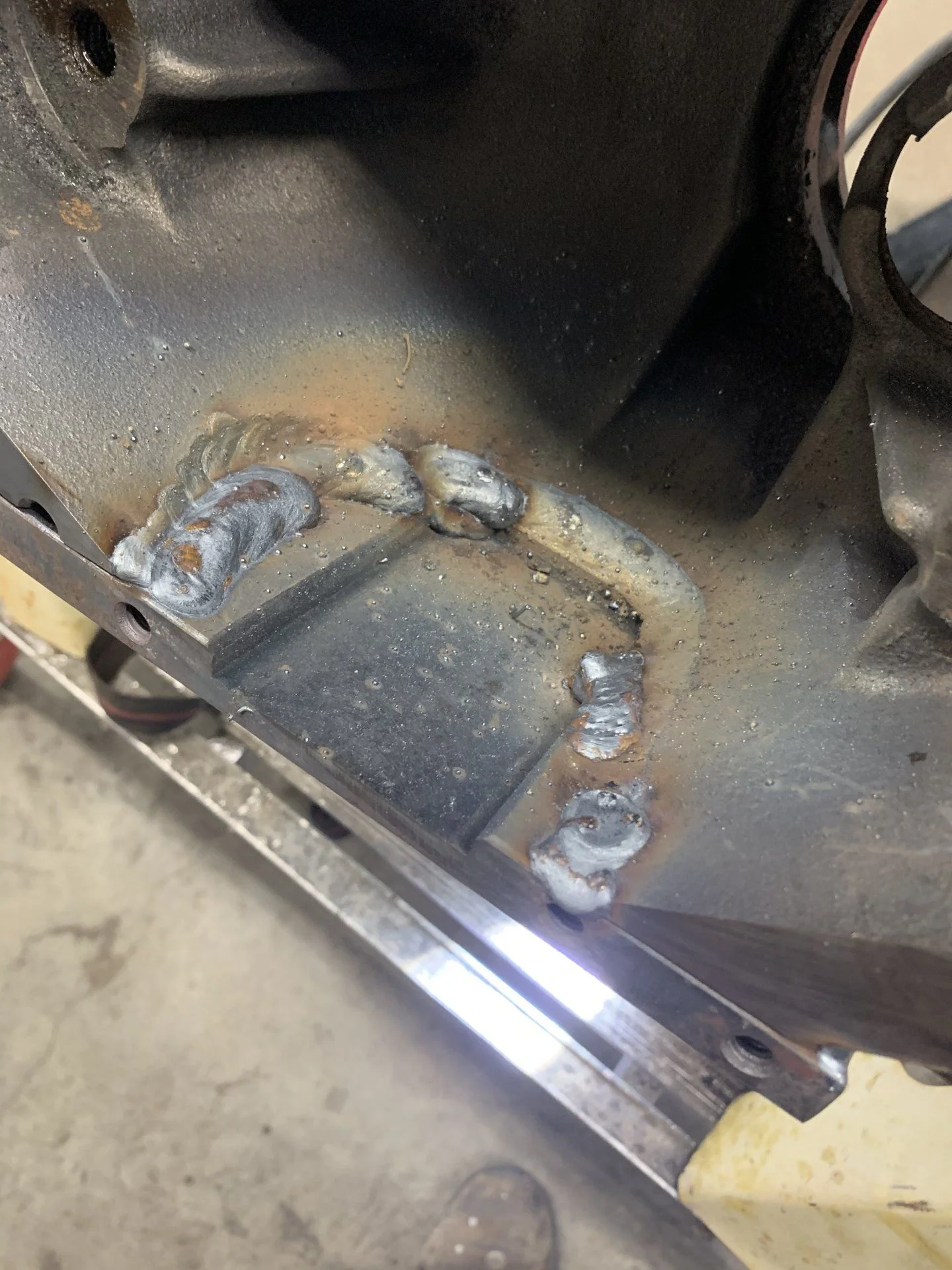

weld the jnside
weld the outside.
Heat it up again and wrap it to cool it slow.

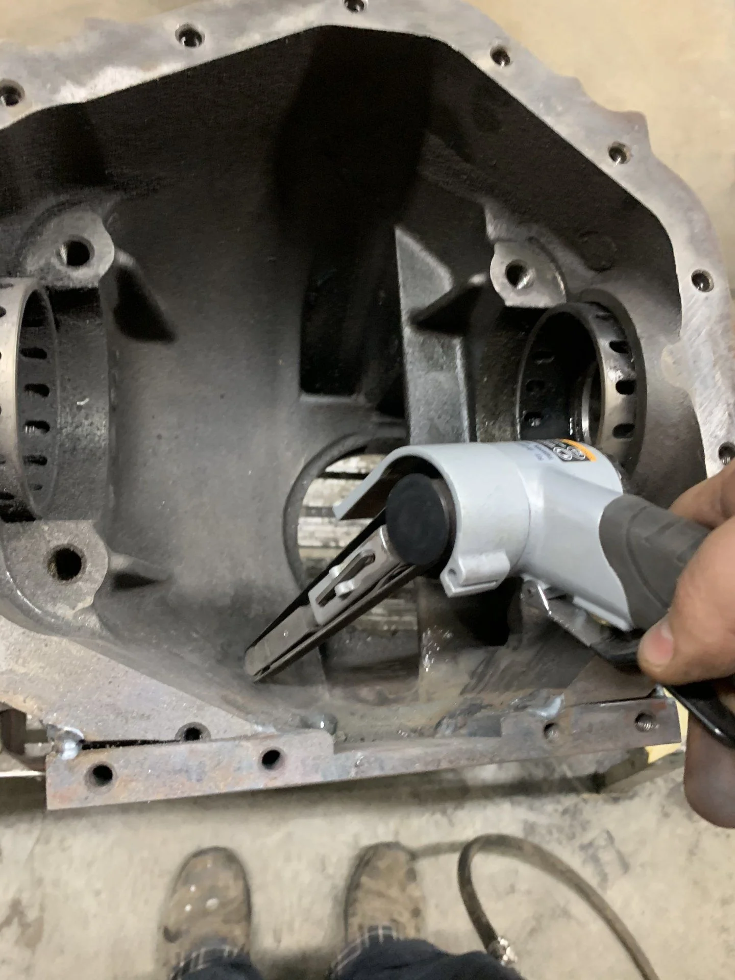

So after all that welding I needed to clean up all the spatter. My 1/4” air belt sander inspired by Jon banjovi was exactly the thins for such a thing
prepped the weld joint too. Looks like it all came in to exactly the right width... who knew
Bought a new non consumable cutting disk. Seems a little slower but was over all impressed. They were like 25 bucks so they need to outlast 5 Walters and I’ll be money ahead.

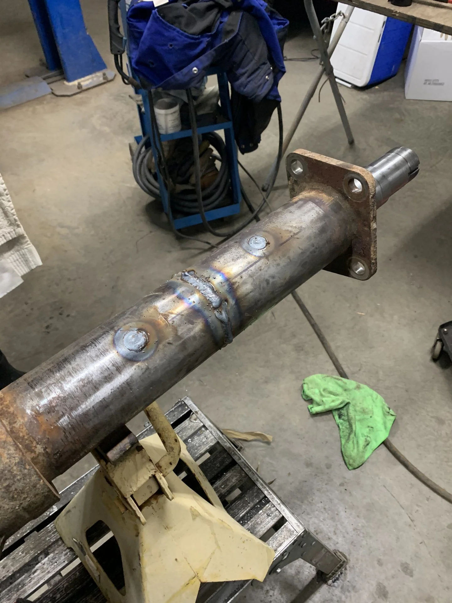

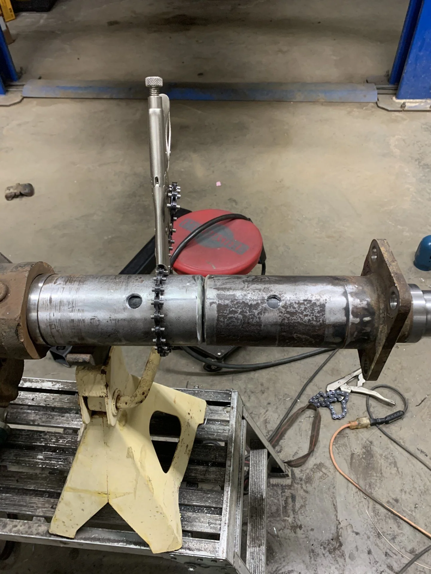

Lastly I drilled some holes for some spot weld for the sleeve and clamped everything up.
My plan is to see just how far off this is compared to the alignment bar. Then all us rednecks will know.
Well it’s all welded up. The alignment bar was clutch!
this was the before the last alignment puck. You can see it has more gap on bottom than top. So the old angle iron wasn’t as arrow straight as I hoped
the after

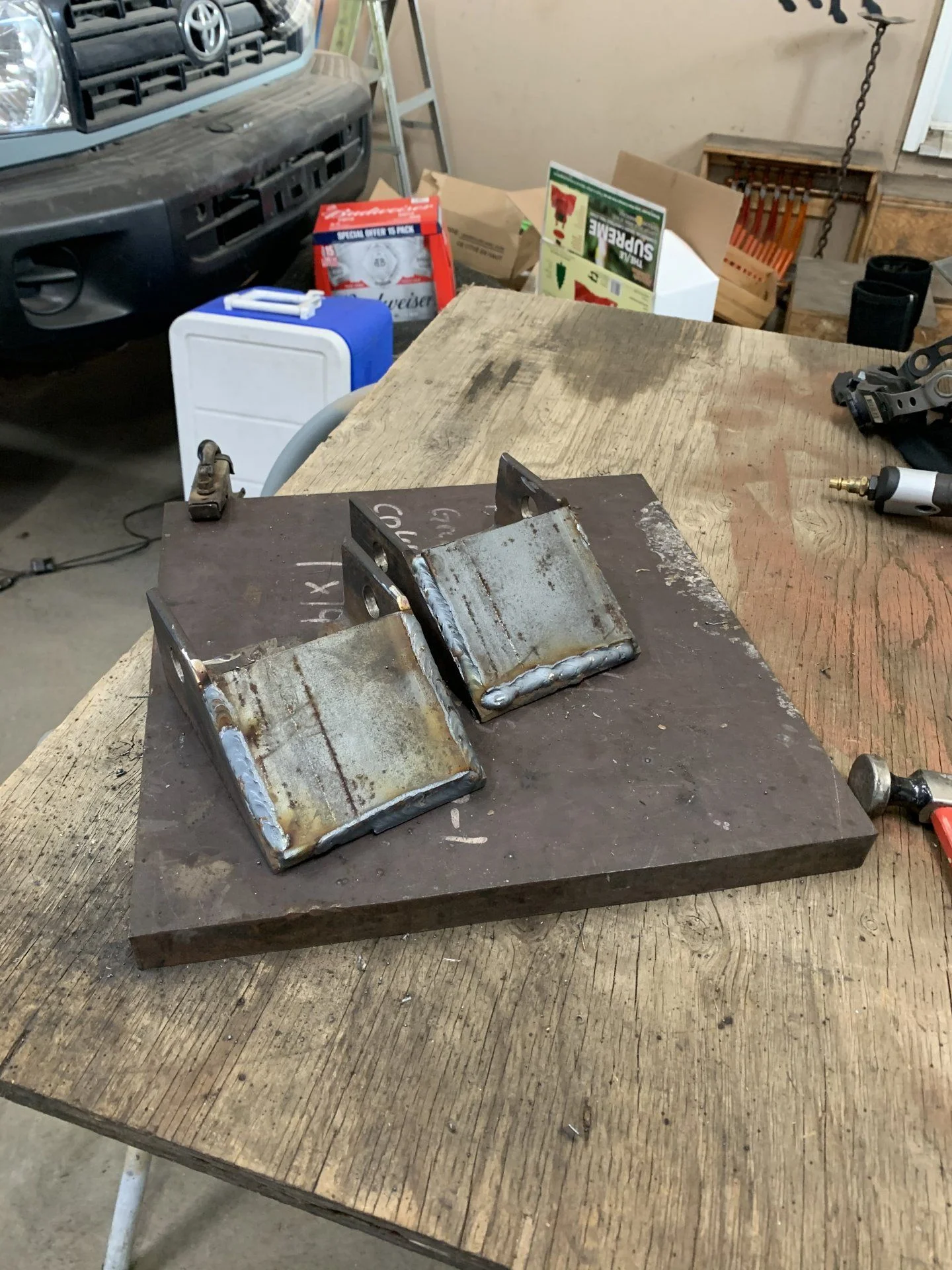

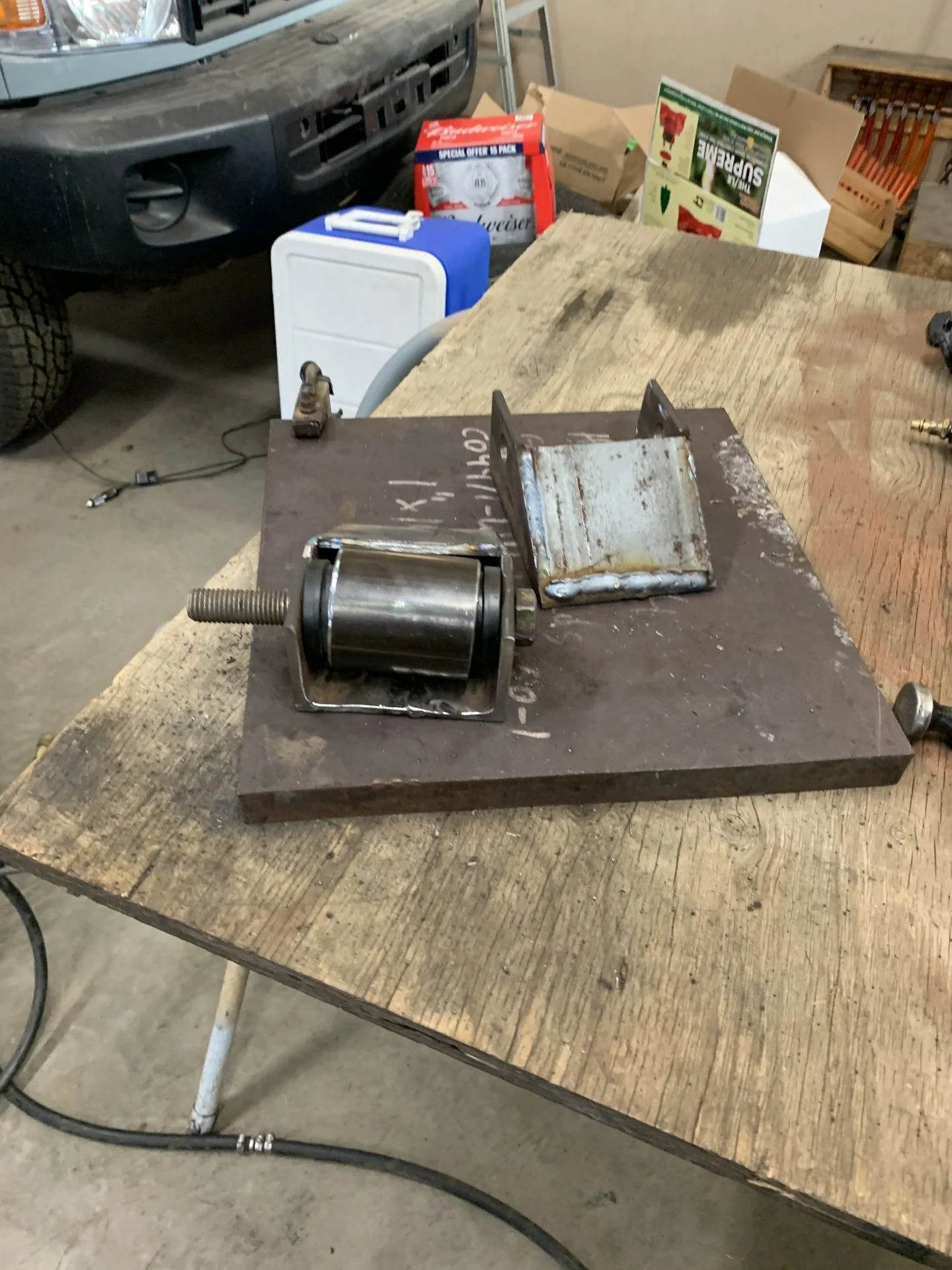

Made some lower link mounts too for the anitwobble end of the trailing arm
