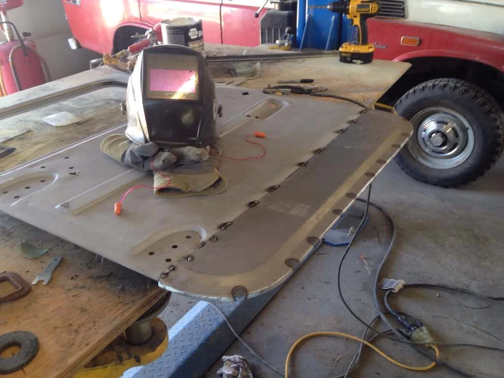

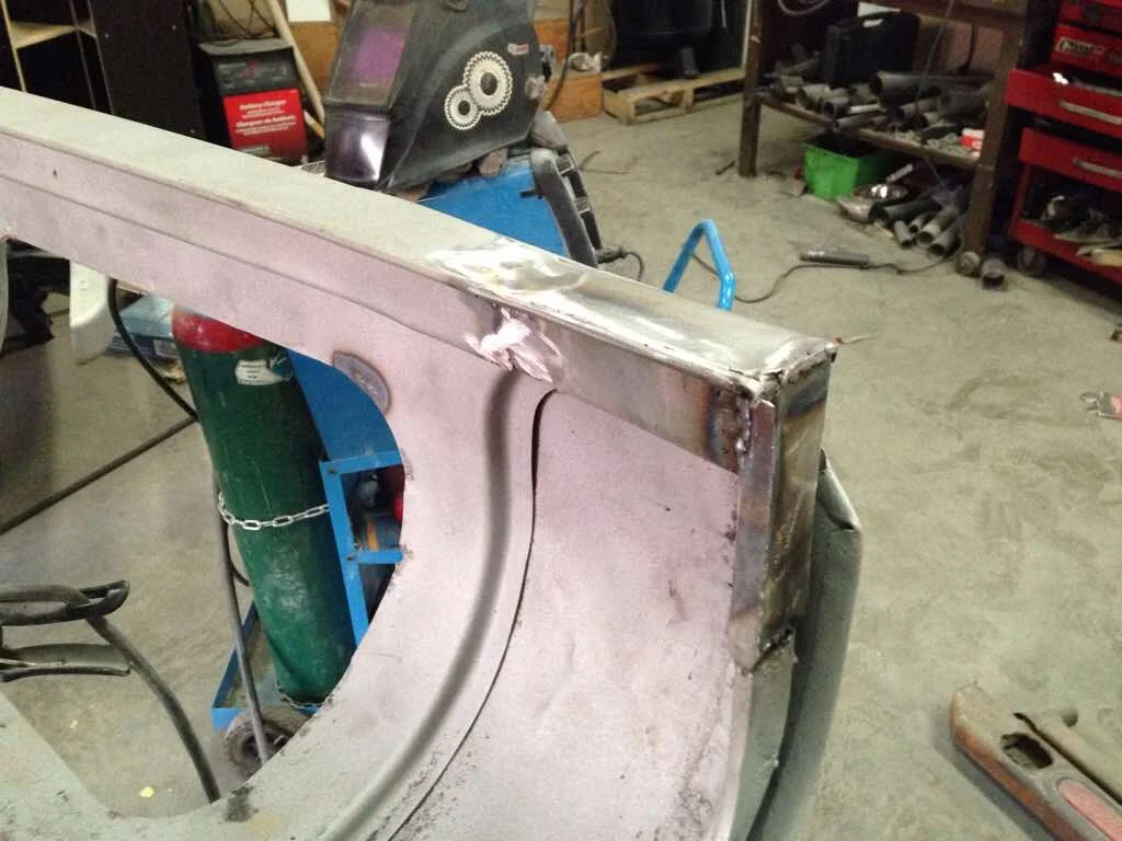

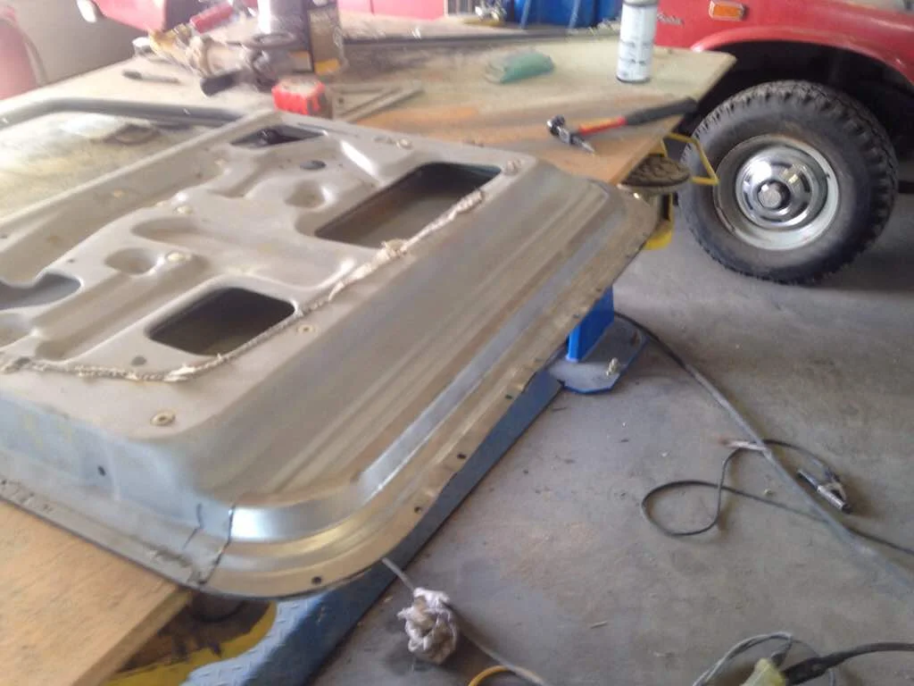

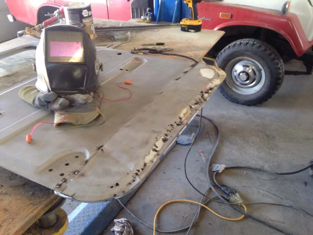

So now metal work on door is done. It needs some massaging by someone better on the hammers than me. A little disappointed on how it turned out. Was hoping it wouldn't be so dished...

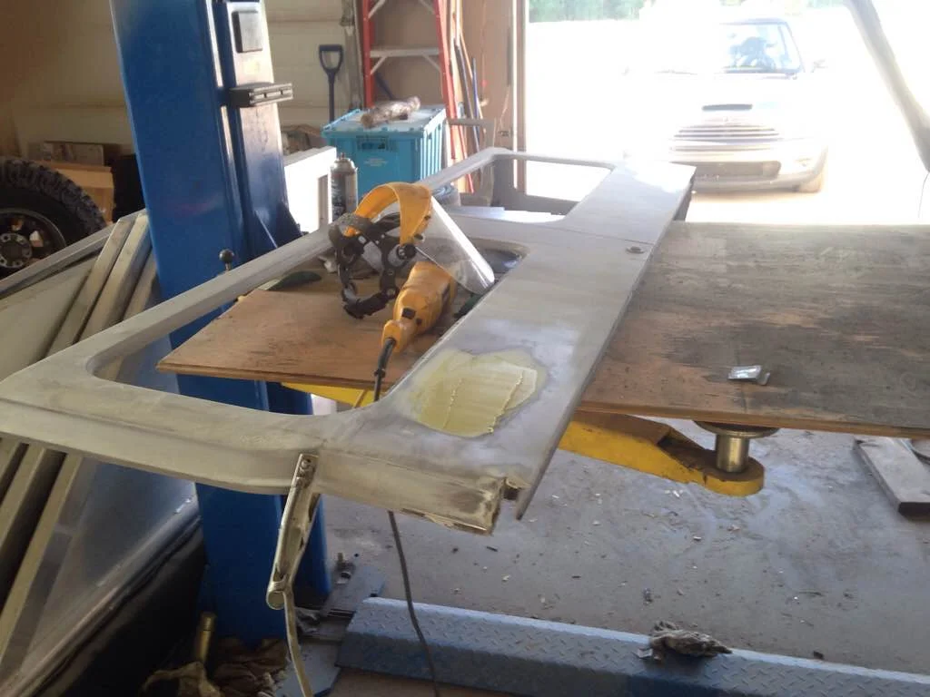

Anyhow. Hard top side are back from blaster. Shouldn't take to much patching. Hope they are done early this week.

Those doors are near impossible to get flat once you weld on them. I ended up tacking a couple of angles across the inside.

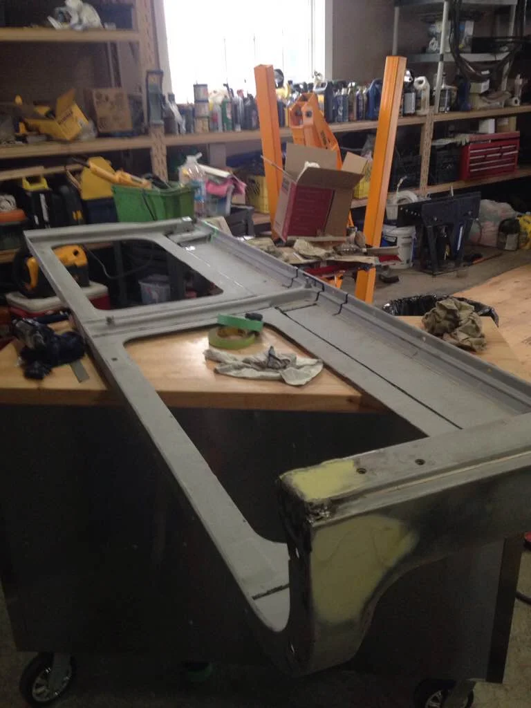

Then I started into hard top sides. One need another coat of filler and the other still has some steel work... Progress anyways

Hard top side are done done done
Well as done as they will get until Paul gets ahold of them. He may have a few touchups as he does usually.
Had a little more metal work and then a bunch of filling.

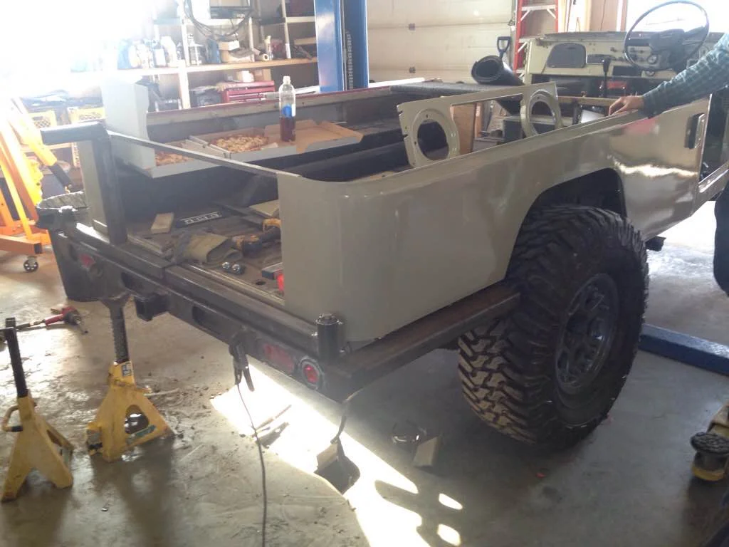

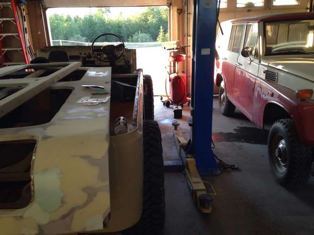

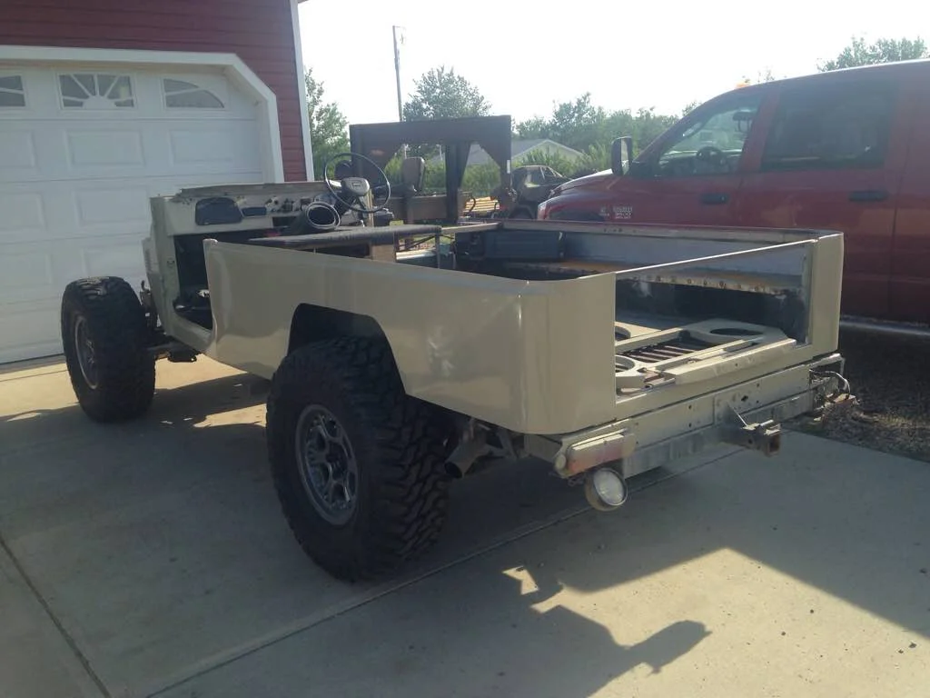

So here are some pics of the wheel stick out. Think I'll need those flares?

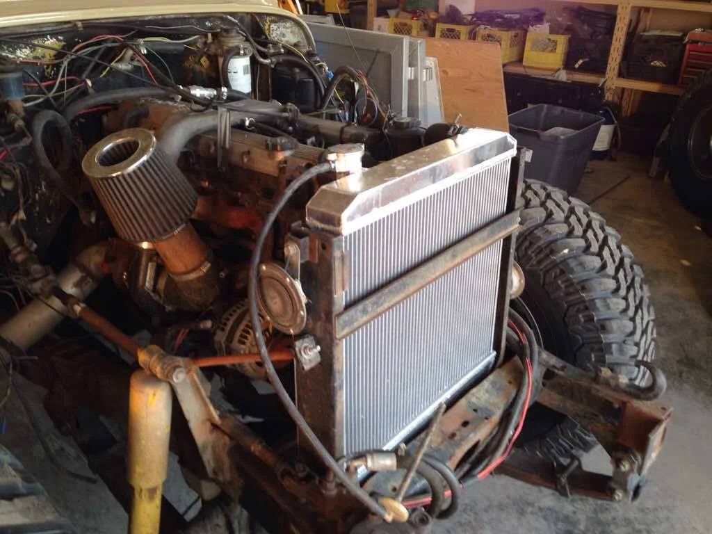

Also was able to get the aluminum rad installed while waiting for filler to harden. This also gave me a chance to install heater hose anti kinker things on the feed to the webasto

Epic mess and move this beotch back into the garage. Now the bumper and slider builds can start.
