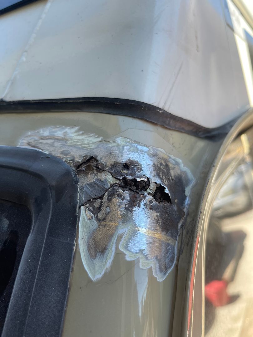

Now, since I bought the truck I've had some rust creeping in the A pillars like every damn 70 series. My windshield got a crack so having an excuse to pull it, I finally got the rust fixed. Cut out and repaired.

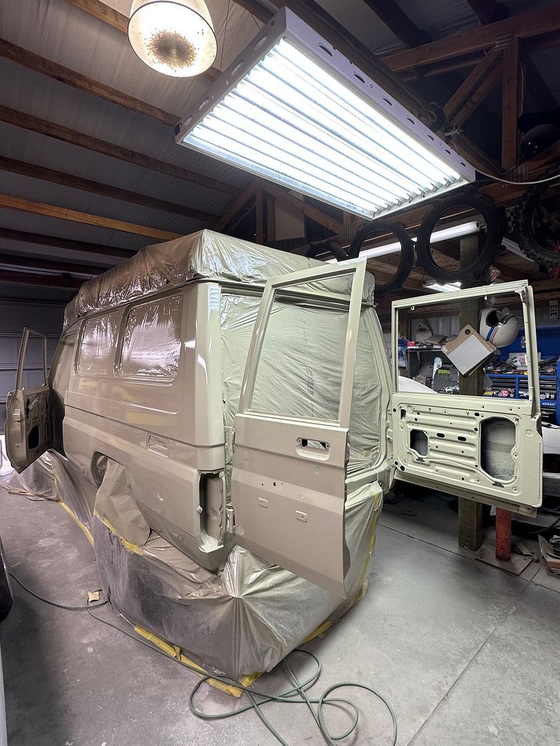

The painter wanted to tackle the whole front end.
IMG_5464.HEIC
And then I got my truck back with half a different shade. So it goes.
71381311749_163C8A94-6E38-499D-AC09-65BDC5DE278D.HEIC
In for a penny in for a pound, I tore all the windows out and got the whole thing redone.

It came back nice. I like the new color a lot better.

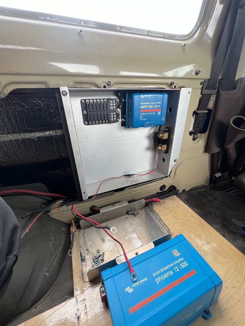

Also used this time to redo my house electrical. The old setup was pretty "cowboy".

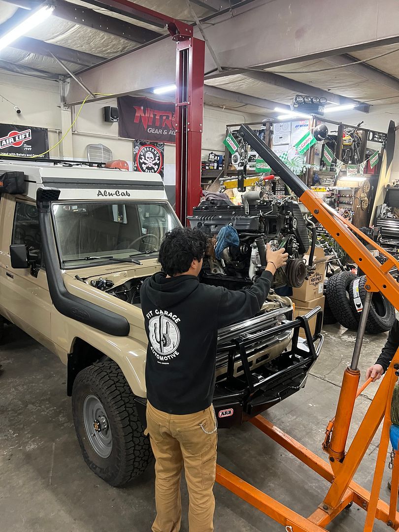

All while this is going on, we were struggling to get a customers 1HZ to run correct. We threw the book at it. So since my truck at this point was basically a parts rig, I pulled my engine and installed it into the customer truck. This is going to be confusing because the customer's truck looks exactly like mine.
Here's a movie
ENGINE PULL
Got parts swapped over and installed into the customer's truck.
