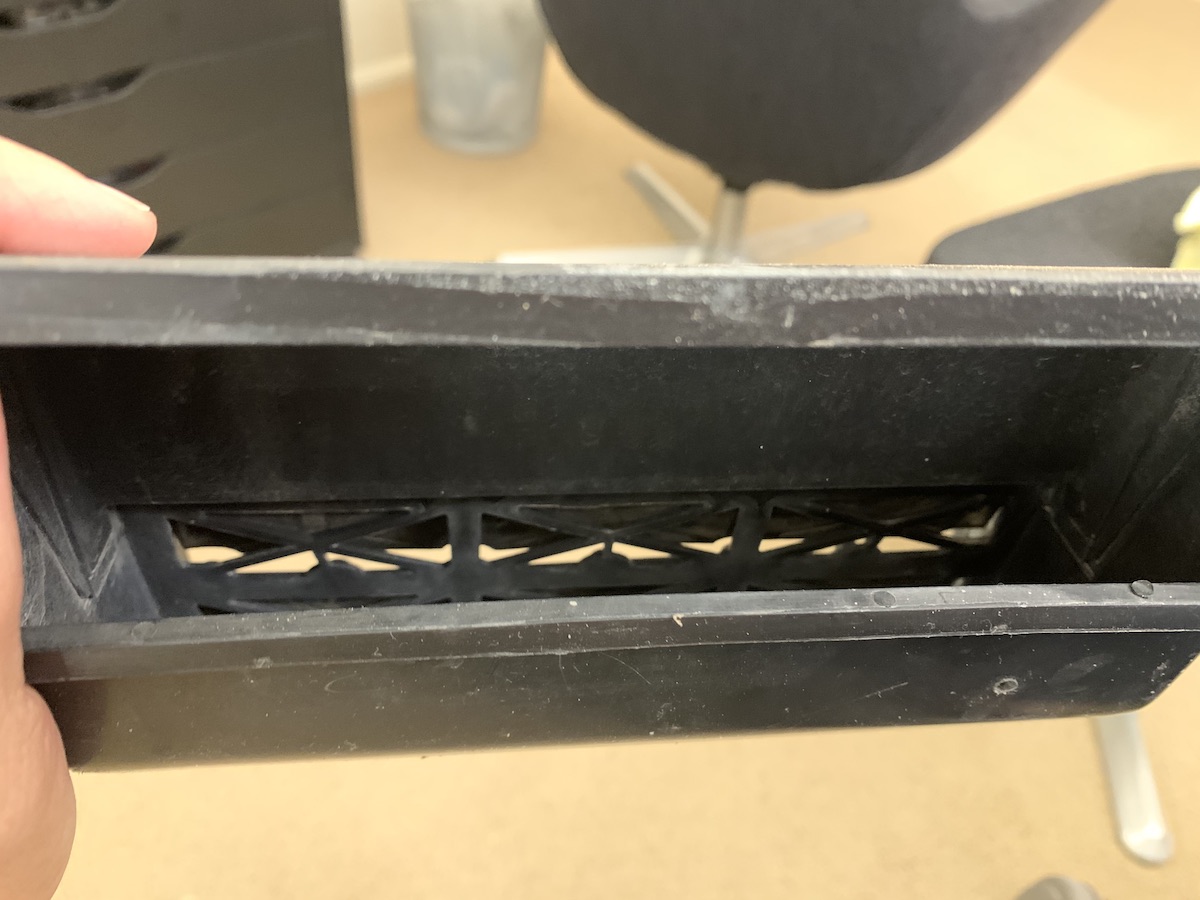

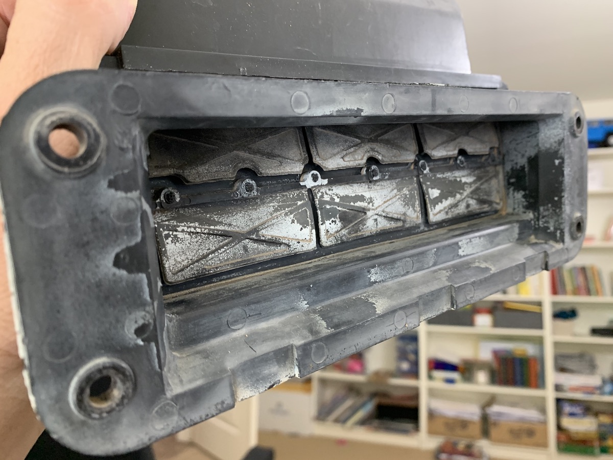

Okay, so the Troopy has those rear ducts that vent to the outside. Mine are not in an airtight condition anymore... but beyond that, they aren't weatherproof. Their design allows for water/moisture/debris to enter the truck through the three depressions/grooves along the bottom edge.
I'm curious what people have done with these? Eliminated them? Just dealt with ingress of water/moisture/debris? Blocked off the vents?
Or if I buy new ducts, with flaps that actually seal as intended, is it mostly a non--issue?
Mine are in the same condition. Since the plastic interior extension curves up, I don't think you will get any water inside the car, unless you are fording some real deep water...
During a hard rainstorm, mine were actually leaking water from the edges, and not the flaps. I used a thin butyl tape to seal around the outer edge. No more leaks inside.
But if you are going to order new ones... let me know. Ill take a set. :) My 3F fumes do get in through the flaps with the right gust of win.
I'm not worried about water getting in the flaps... but rather getting in around the edge (like you've pointed out). The mating surface of the duct, by design, allows water to get into the truck. The three depressions in the lower lip mean that road spray will gather in front of the flaps and drip down into the panel. Now that I've painted my body cavity with Spectrum I want to avoid stuff entering.
Good idea on sealing with butyl tape... I may do that. It still leaves me with a concern that gunk/debris/moisture.
I THINK I'm going to order one replacement duct... and then blank off the other side to eventually use as a service port for compressed air and water supply.
Hello,
This duct is intended to function as a check valve, letting air out but not in. Same with water, provided it is properly installed.
The rubber flaps open from the inside out.
Over time, dust and dirt build up in the lip between the duct and the flaps, causing them to stop sealing properly. The rubber seal becomes brittle as well.
Butyl tape is a good idea to reinforce an aging seal.
As for the flaps, it helps to clean/wash the whole duct. This is a way to make them work again, at least until replacement.
When installing, it is good practice to make sure the flaps move towards the outside -but not the other way around- before tightening the nuts.
Hope this helps.

My issue isn't with the required function of the part. I fully intend to leave one of them intact for it's desired role.
That said, it was clear from the interior of my panels that water had made ingress where these meet the panel inside. If you look at my first picture in this thread the part is designed to allow water that gets past the exterior vent to dribble down through those three gaps... presumably so it doesn't pond against the body panel inside the duct. Stuff gets in, even with the flaps shut.
Of course the butyl tape I used to seal up those gaps will probably allow water to pond and debris to collect now... also undesirable.
