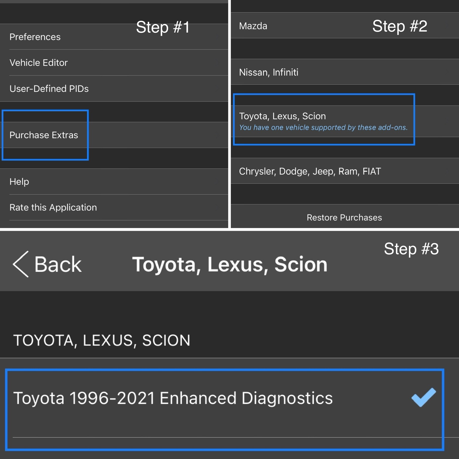

I have OBD Fusion but don't see anything like AT Oil Pan or AT Torque Converter. Can you advise how to add those displays? Everything else you're showing here
looks familiar. I'm reading off a 2006.
I had to purchase the extra PIDs to get that function in the Settings of the a;
Hope this helps.
