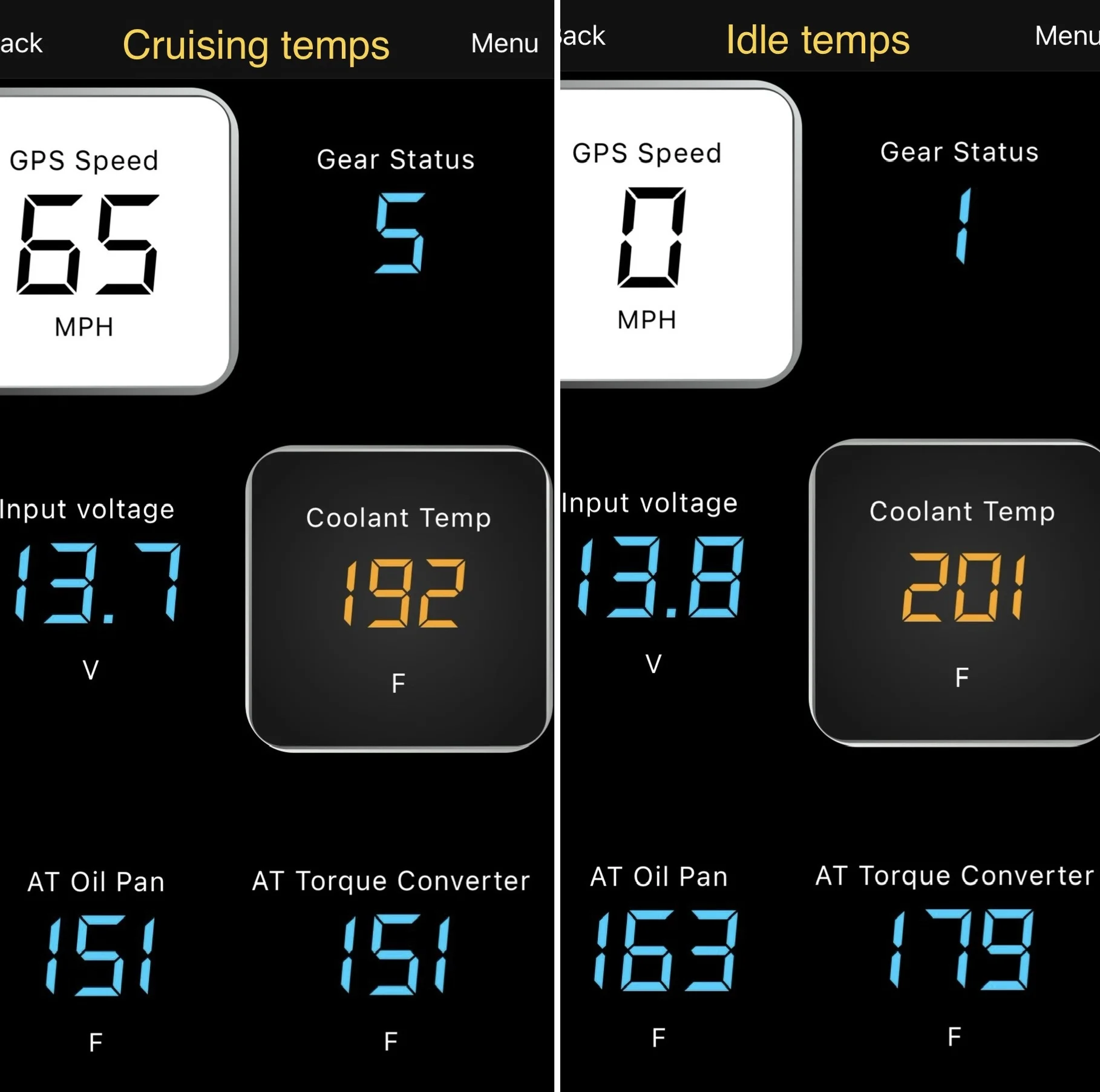

I check mine on the Bluetooth app I have. I hit 194-198 in summer in central Texas. Yesterday it got to 100 and I was driving all day on a gravel trail run and then 2 hours home on 70-75 mph. Never got above 197 yesterday.

Highest I got was 203°F on a long stretch of mild uphill pass at 70mph, went easy on gas and stayed at 65 and temp dropped at 199°F. 253k miles on the radiator (original still I think). Oem Thermostat, TB, WP (aisin), oem coolant was replaced 8k+ miles ago.
