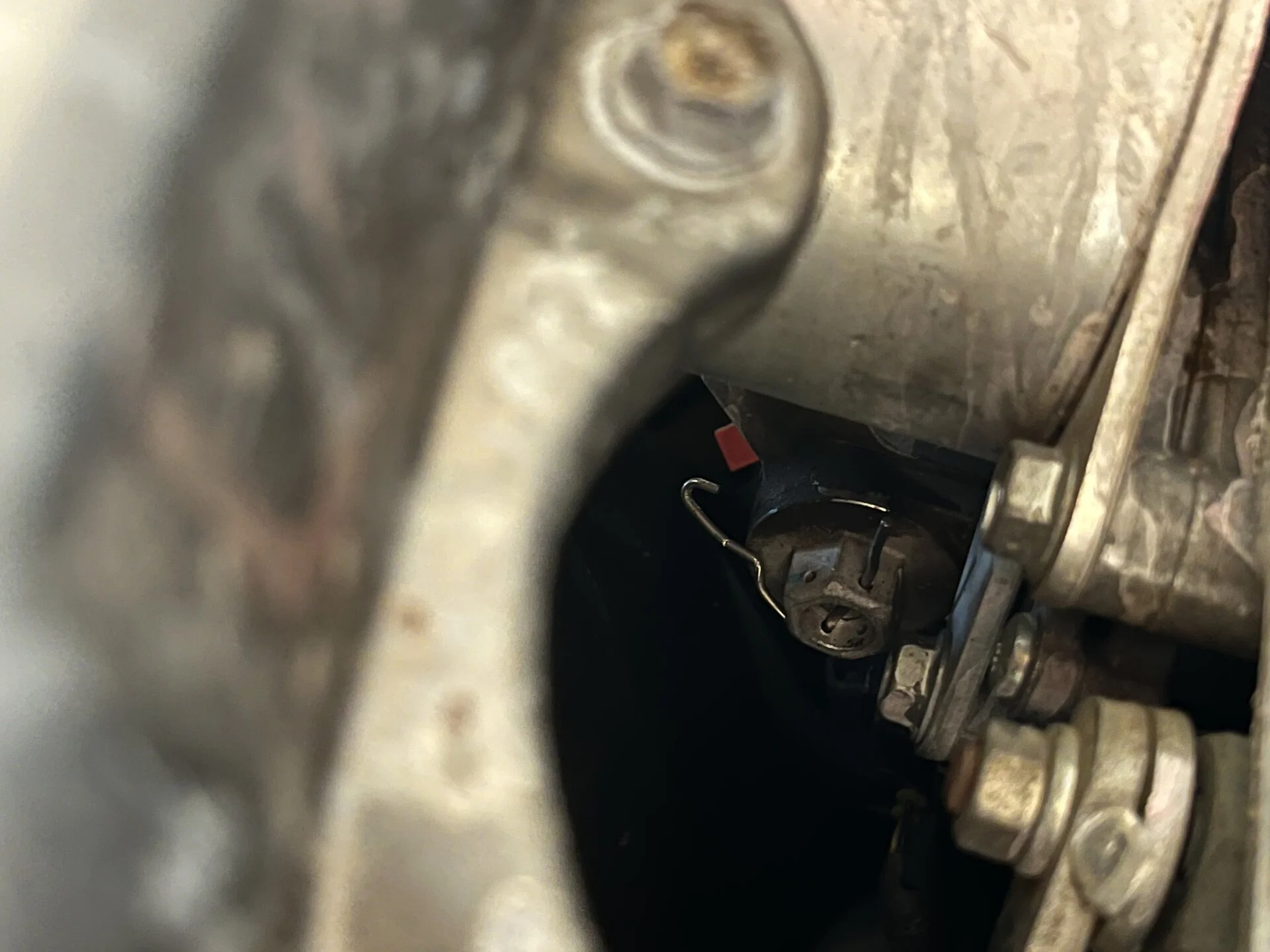

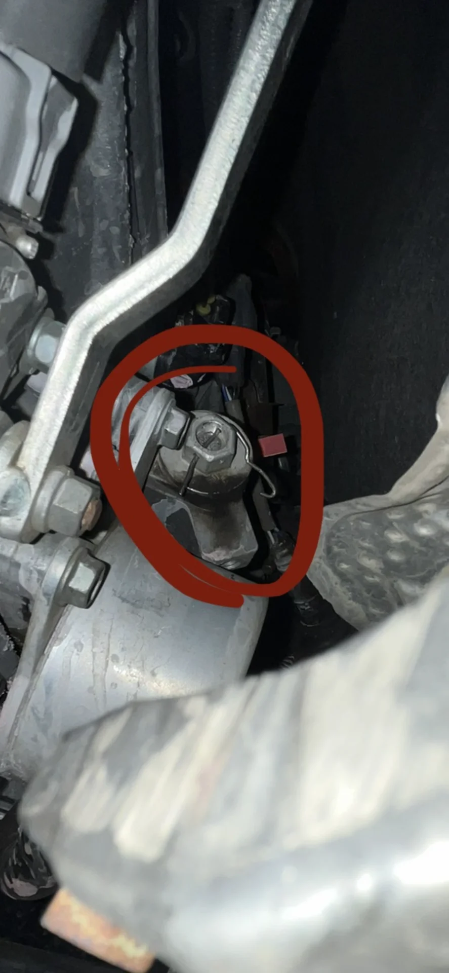

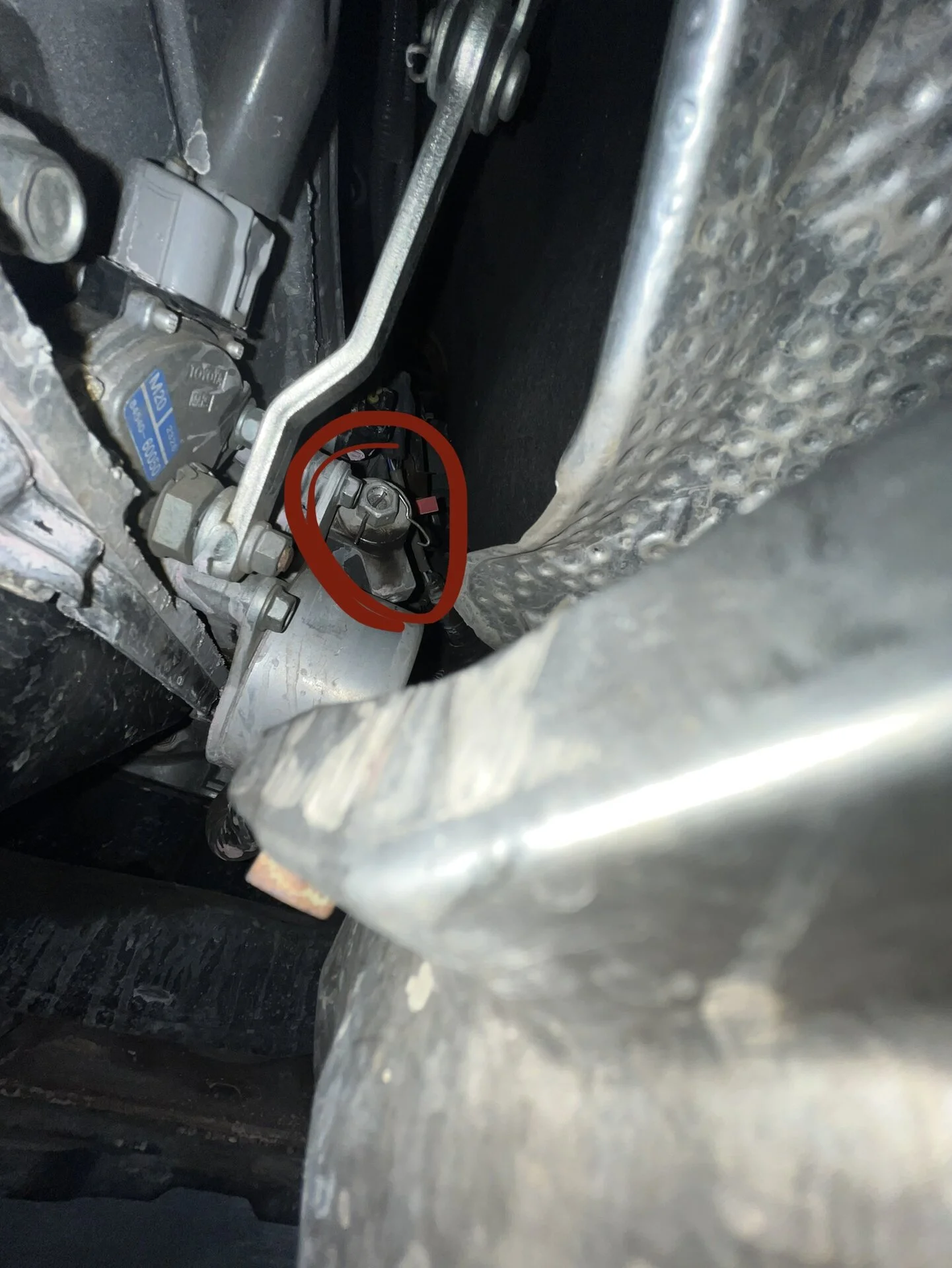

I took a trip to Death Valley eariler this month and while descending this gnarly mountain I tripped a P2716 code for my shift solenoid in the trans. This lead to a flashing 4Lo and CEL and my trans hard shifting. Manually activating the solenoid got it to start working again and cleared the code. But before that fix, I was under the truck unplugging all the connections and I noticed a spring loaded metal button with a metal wire hanging off of it. The button is recessed into this hexagon shaped housing. And on each face of the hexagon are holes to allow for a cotter pin to go through and hold the button pushed in. I figured the metal wire hanging off of it was supposed to be pushing the button in, so that’s what I did. Does anybody know what this button is for? Should it be pushed in at all times? Or should I take that wire out? I’ve looked around and haven’t been able to track down what it does. Pictures are attached. Thanks guys! And hopefully this is being posted on the right spot. I’m hopeless with forums lol
I believe that's the transmission cooler thermostat. See this thread on doing a transmission flush and it will show the part and describe its function. Depressing the button overrides the thermostat and forces transmission fluid through the cooler all the time I believe instead of only opening when above the set temperature.
That is the transmission thermostat housing. When the pin is in place, fluid is sent through the trans cooler. Unpinned and it will bypass the cooler until the thermostat opens completely. For vehicles in cooler climates, the pin is removed so that the ATF warms faster.
Perfect! So living in SoCal, I should probably just leave the pin in place? I’ll probably graduate from sketchy wire to an ACTUAL cotter pin though. lol

Did you buy your rig used? If so, I 100% guarantee the previous owner had maintenance being done (or did it himself) to flush the transmission fluid and they simply forgot to remove the makeshift pin. (I personally use a paperclip, which that looks similar to).
Just remove it
Just remove it
Yeah I did. I had a transmission shop in my area do a flush and filter change around 10k miles ago though. When I FOUND the pin it was just hanging around there and wasn’t in place. I put it in because I figured it was supposed to be there.
Yep...you can just remove it. Thermostat will open naturally
